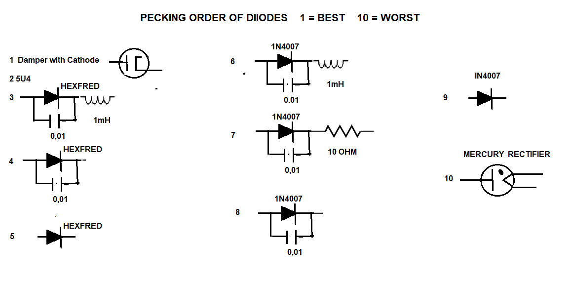

here's something I posted

I've looked at this possible problem in my home brewed vacuum tube amplifiers and basically, it's a nothingburger.
It was shoe-box compact cassette recorders that used to pick the noise up in the head pre-amps back in the 1970s.
Fast diodes are so cheap and mass produced that there is little point in using slow ones these days.
I have never seen a ceramic cap fail when it is being used to bypass an old diode.
Just fit them and forget resistors and chokes.

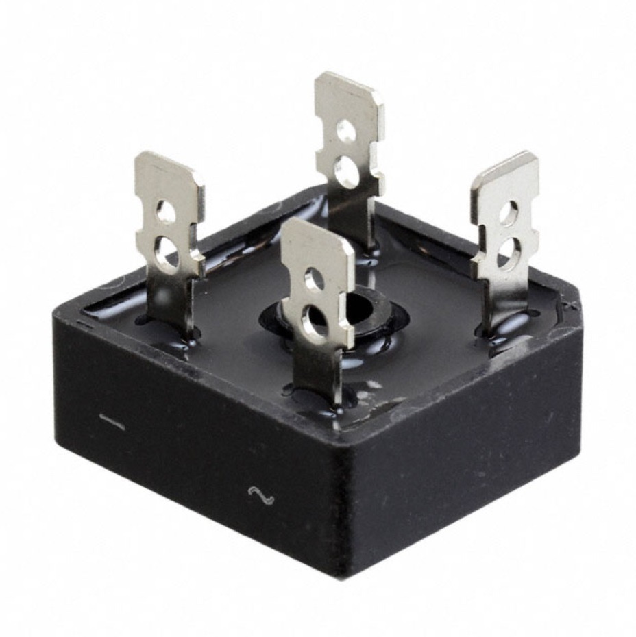

Solid state power amplifier equipment very often uses one or more bridge rectifier assemblies, usually rated 35 amperes continuous or sometimes 50 amperes(!), packaged in a "GBPC" package as shown below. The diodes inside these bridge assemblies are just as "slow" as their 1N4007 little brothers: reverse recovery time of 2000 to 3000 nanoseconds. For those applications, "just use a fast diode" is not useful advice, since that increases both cost and heatsink area.
Luckily, the Quasimodo approach tolerates "slow" diodes quite well, and a lot of DIY power amps here on diyAudio use GBPC bridges + QM derived smootheners.
