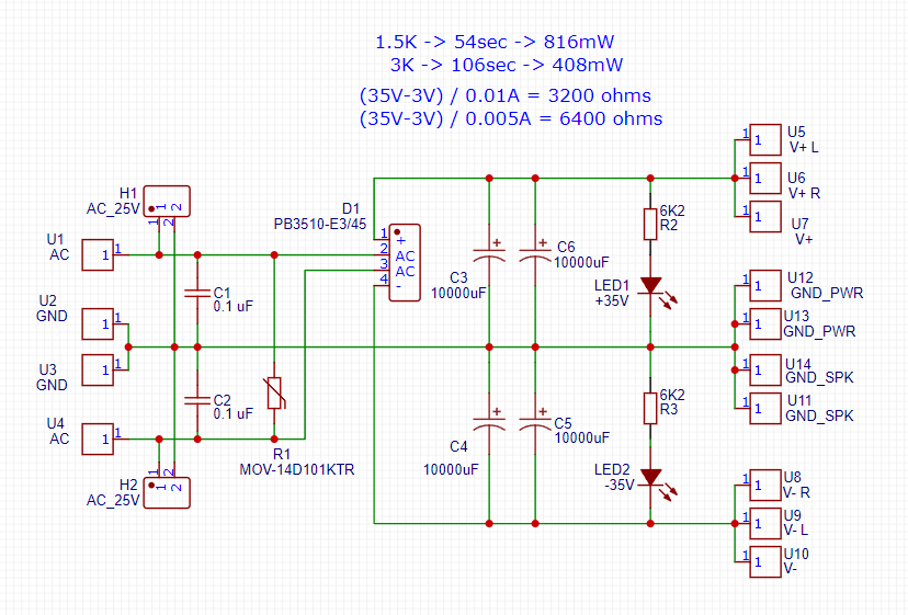

Hi everyone! I have a question about snubber capacitors. Do I put those before or after the rectifier bridge?
Another question is about varistor. I have transformer that outputs 25v-0-25v. I was thinking to put varistor rated at 60v across two coils. Will that work?
Attaching schematic.
Thank you all!
Thank you all!
The snubbers are always between the power transformer & the bridge diodes. Using Quasimodo gives you the exact values;)
