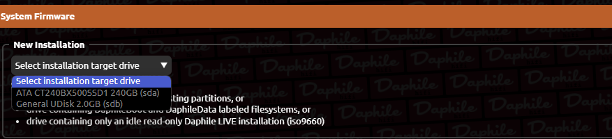

Good morning, I can't install Daphile, my HD doesn't see, can anyone help me?

You can install to your notebook's HD but be aware it will erase everything on that drive and replace any OS with Daphile.
If that is what you want then as the live version boots there is an option to configure..you will see an instruction to press F1 for setup.
There you can toggle through settings and change any you wish..
When you reach the one that allows your to 'clear an existing drive' for Daphile it will present the options and your Notebook HD will be one.
Select that and continue..the HD will be fully erased and readied for Daphile.
The Live Daphile will boot and when you look for the installation drive you will find your drive and can complete the install.
as @pitbul posted..read the installation manual...it is downloadable from the Daphile webpage.
