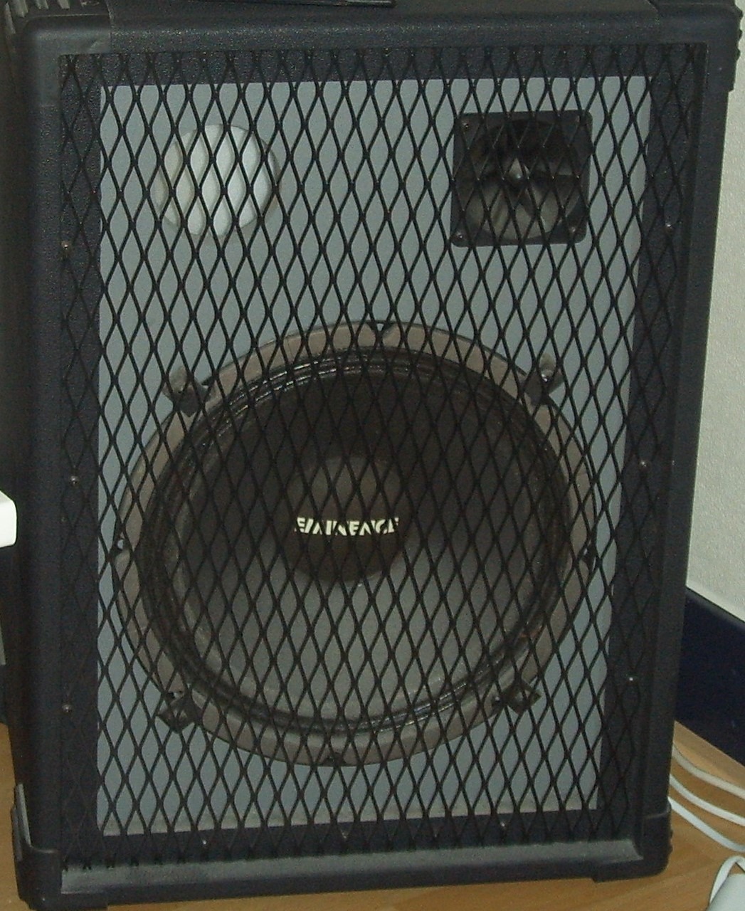

So I had these on my desktop, and they are deceased after 2 decades of loyal service. Also a tad large, but I liked them a whole lot.
So after a lot of searching and reading (sitting close and phase, open baffle and wall, imaging, that tweeter has ehm questionable reviews apparently), I think the best and easiest option is a nice fullrange in closed box, either a Fane or a Sica, this is (probably?) as large as I can get away with next to my screen. But I'd like to avoid an absolutely huge box.
What is the smallest housing for either of these that I can get away with, is 45-47 liter good? Is it stupid to even ask and am I then better off with 10 inch drivers? About 50% music, 50% games if relevant. I just want to get rid of these crappy Logitechs. Recommend other drivers if a lot better for a small box but try and cap it at say 2×-3× the price.

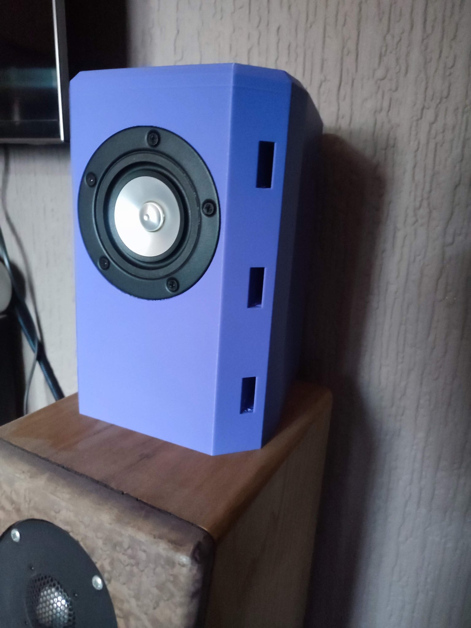

When i saw the title, i thot these pictured, or a Baby Lab.
And this the first one to come off a printer.
I have done this particular shape from the 2.5 litres here up to 135 litres, and the size you suggest in the rectangualr version.

Pretty much that. Baby Labs https://wodendesign.com/downloads/Woden-BabyLabs-241018.pdfWhen i saw the title, i thot these pictured, or a Baby Lab.

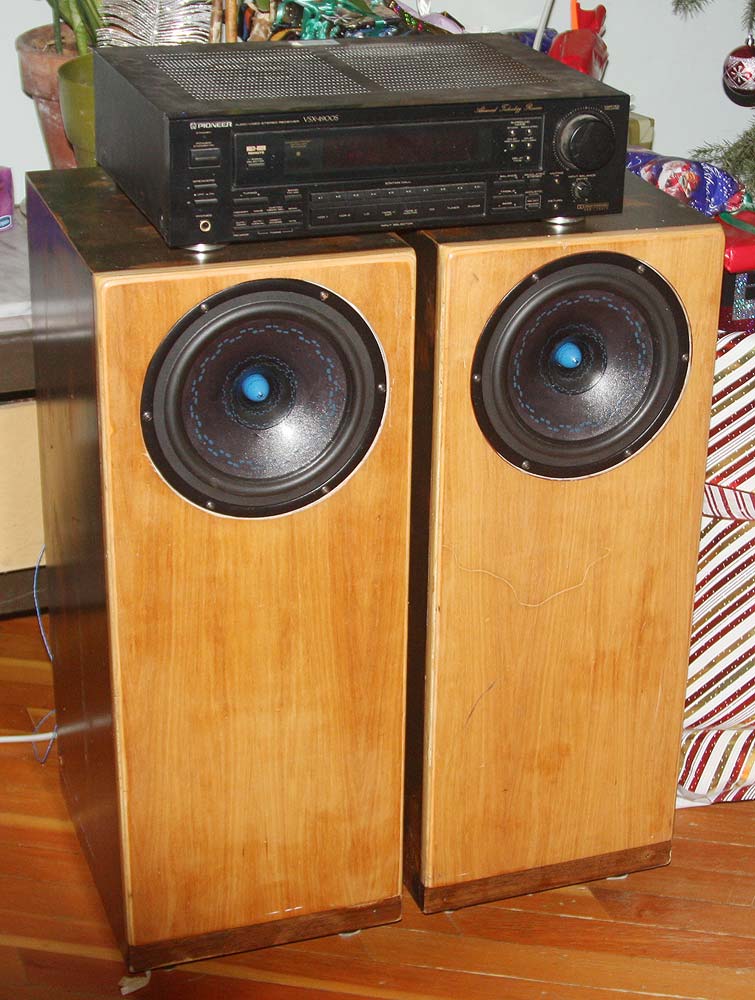

I also built these ones right here from the forum 2-3 weeks ago but I need to fix up the cabinets and a few rough edges. I can get some pics tomorrow but do not judge too harshly, the woodworking is not stellar. I really like the sound quality wise so far but I want to try and build a large pair to see if that gives me back that sudden attack with preferably enough low end, not overly boomy but just good and with balance.
