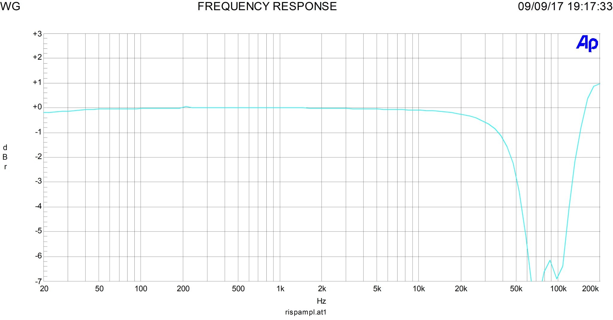

One solution i the use of KT150 in UL with 1627
This is a circuti I used
the E88C is a single triode
Walter
This is the frequency answer at 10 w with 6 dB od Feedback
There is a resonance at arount 200kHz but is not significative
