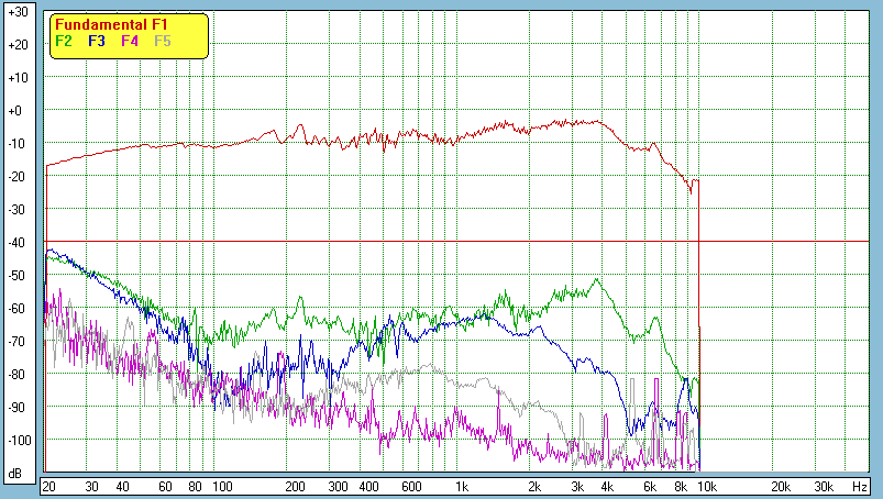

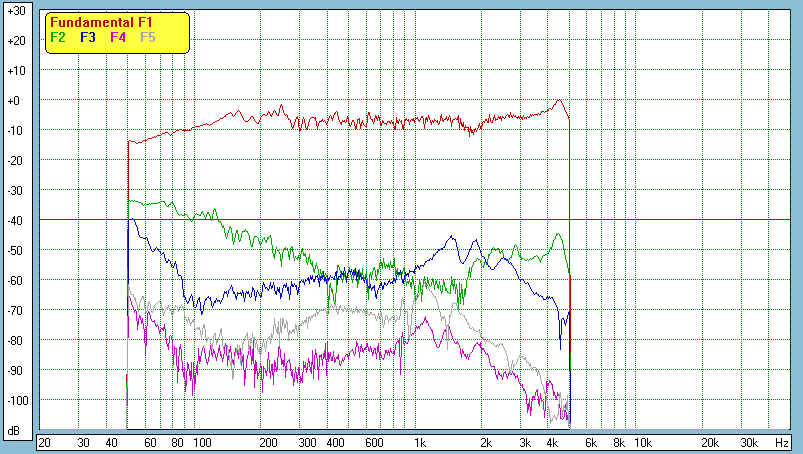

Actually that is dependent on design, and execution of the driver itself mostly, not Kevlar. The data added below from the B&W LF00264 done by Zaph audio.
Also take note of the sensitivity compared to most 'hifi' midranges.
Yes there is a breakup and slight resonance at 3,5k, that deserves a gentle notch.
To me that is already out of the midrange.
Overall though it is cleaner then 99% of the "competition" even with that artefact, all the way to 10 k.
And that is with a 6 grams cone on a 6".
A 4" cone wil have that breakup Even higher in frequency.
The need for the heavy and damped cone is not really existing ?
Most people would be crossing that driver to match the directivity of a tweeter 2-2,5k. And not stretch it to 3,5k with a low order xo ala B&W.
And the sensitivity opens up for some interesting driver combinations in some cases.

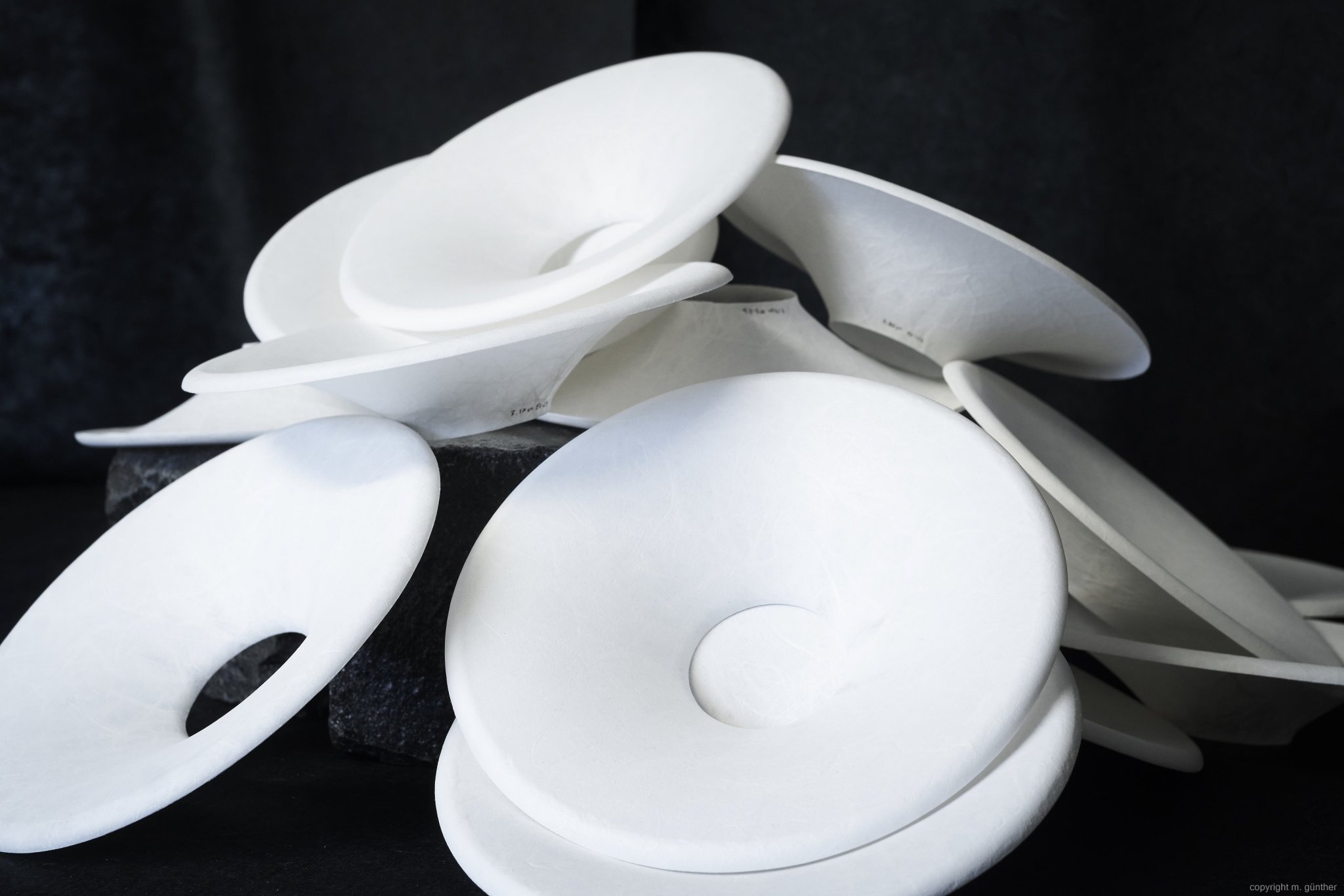

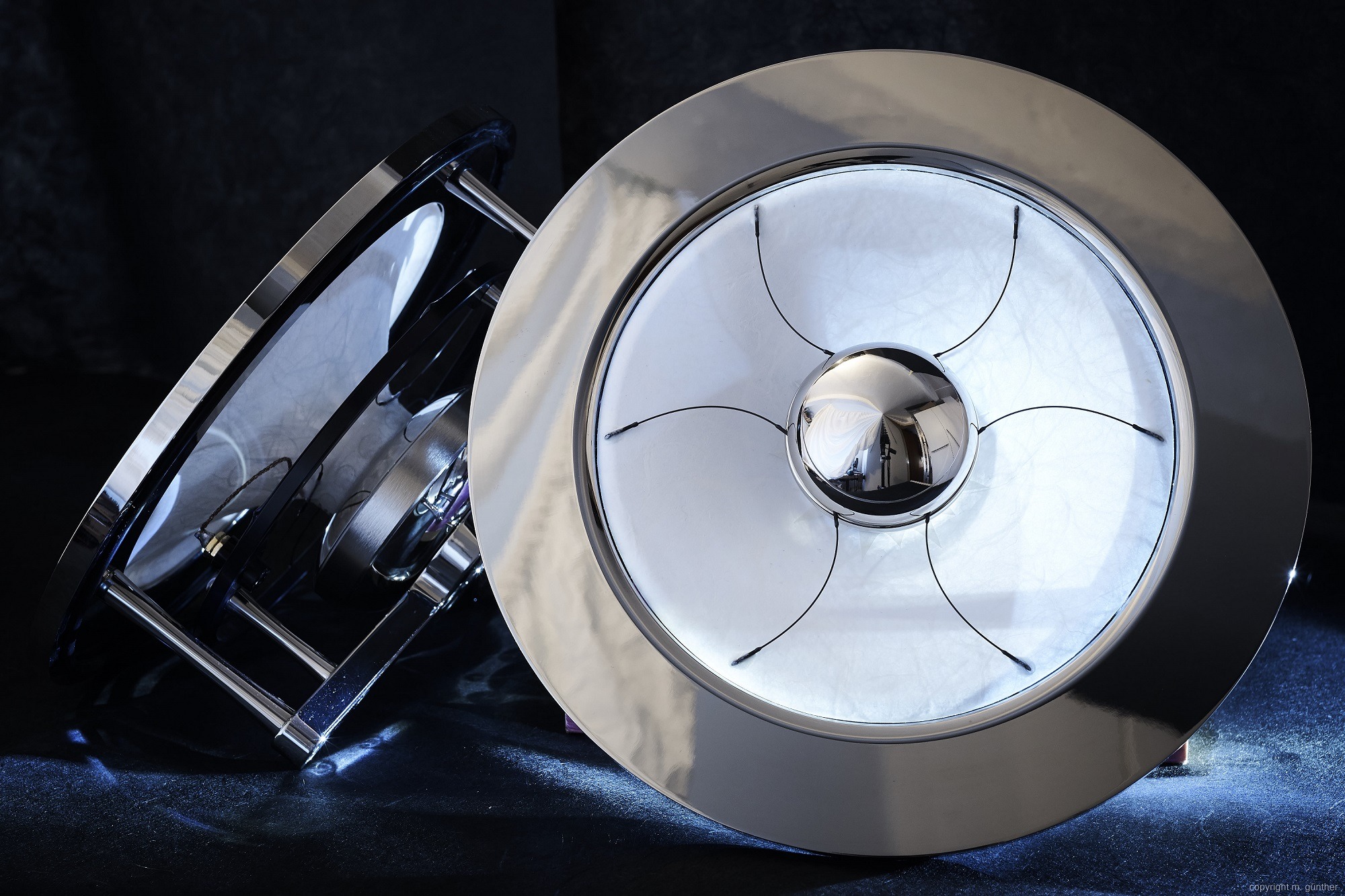

MeeToo! I make my own drivers as well.
Just to add some comments:
Yes, Lars, FEMM is great and if used correctly, delivers very realistic results.
And Mark is right with his thoughts on cones, shapes and so on. As I couldn´t afford FINECONE, I had to make R&D on my cones in the more traditional way, and every detail will alter the final driver´s behaviour.
All the best
Mattes
