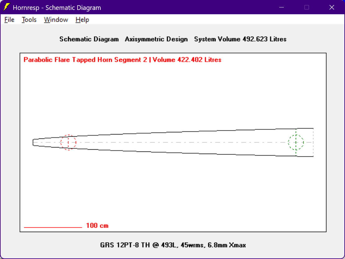

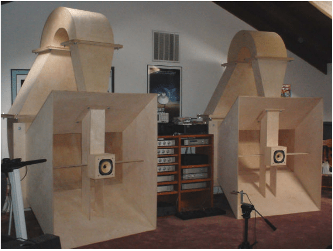

Mr T65.: LBNL was wonderful if only for the view from the 88" shop of the bay. Nelson Did the Kleinhorn, check out that build over on Pass DIY for a sense of scale. We had to back the Kleinhorn with the El Pipe-0; (also on PASS DIY ) and that was all just for fun; but the text does point to the physical limitations of horns. and transmission lines. And yes size does matter: very much a go big or go-home sort of deal, A Tapered quarter wave / TH might be more practical For fun it would be hard to beat a dozen or more 12" woofers in an IB

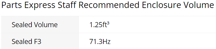

I bought a pair of the currently available Tang Band unit at Parts Express and hope to try them.

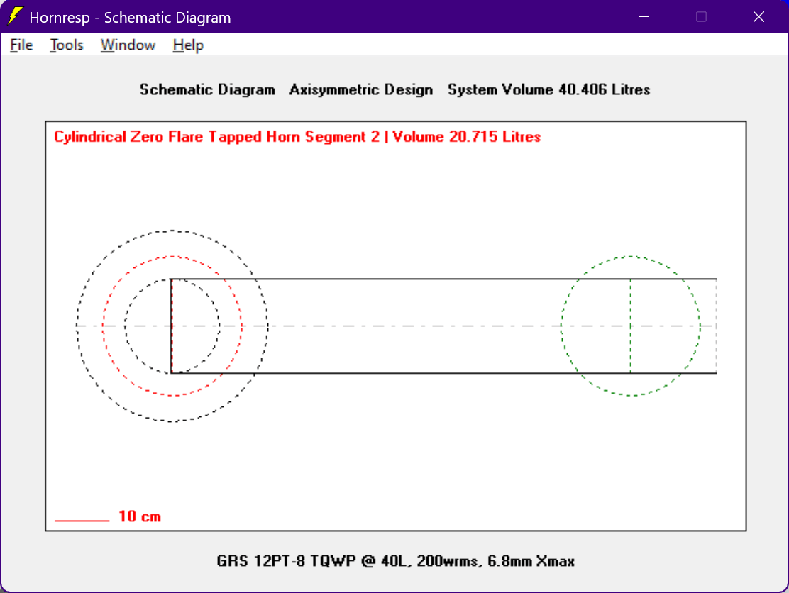

@BP1Fanatic - how about you design cheap and cheerful - like a tapped pipe with small footprint for the $50 (on sale) GRS PT12 (fs-35Hz) - a solid 35Hz or so could do some good. A 6th order reflex is a small and good option but needs the peaking EQ. A low tuned Karlson with boost at Fb sounds really good but don't know "why" as the front chamber should not be doing much - might be the Altec magic. K15 is a bulky thing for a 12x12 room.

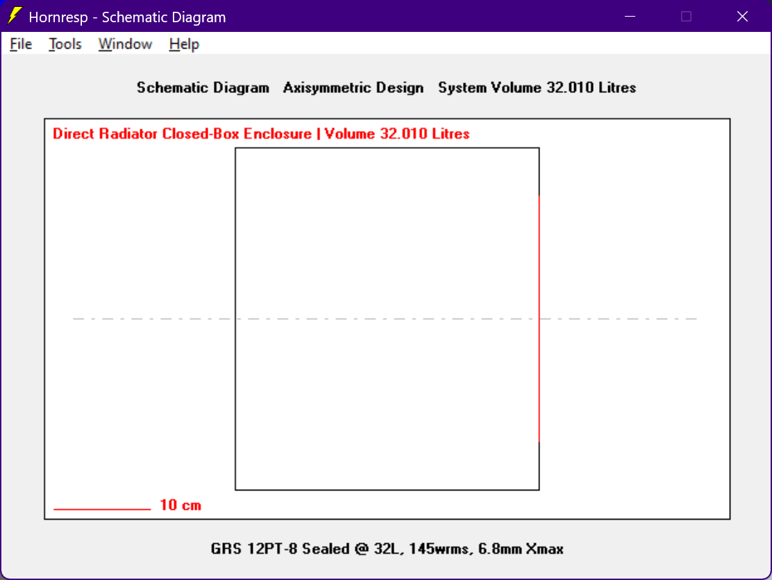

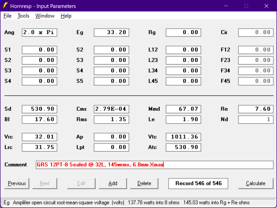

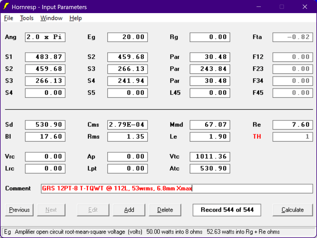

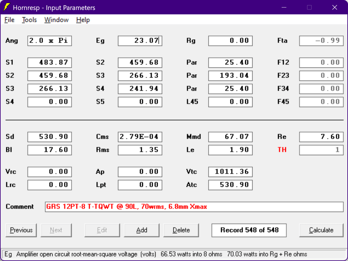

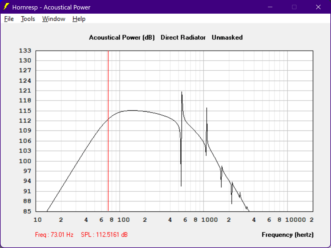

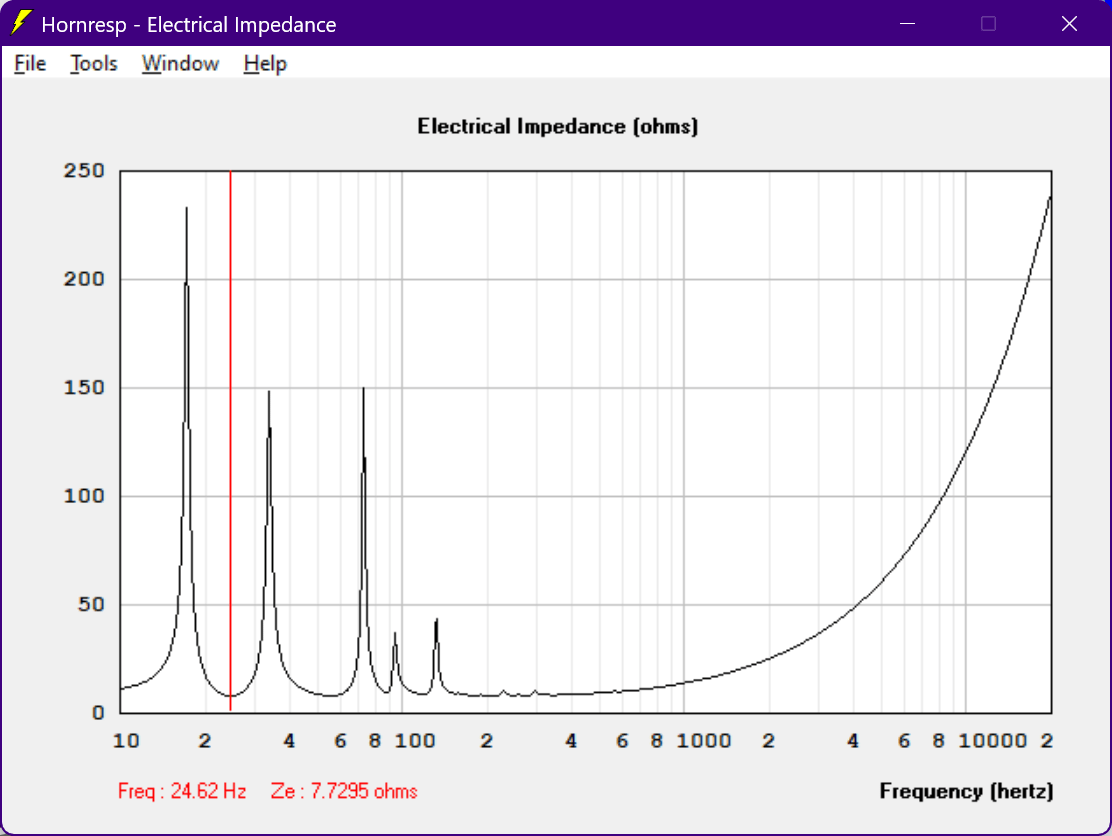

You can plug the GRS 12PT-8 into the same models I did for the Dayton Audio PA310-8 for your "audiophile" enclosures.

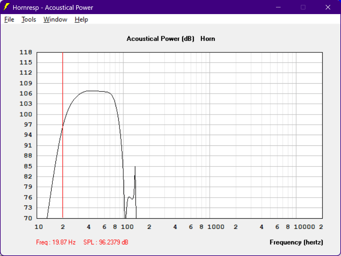

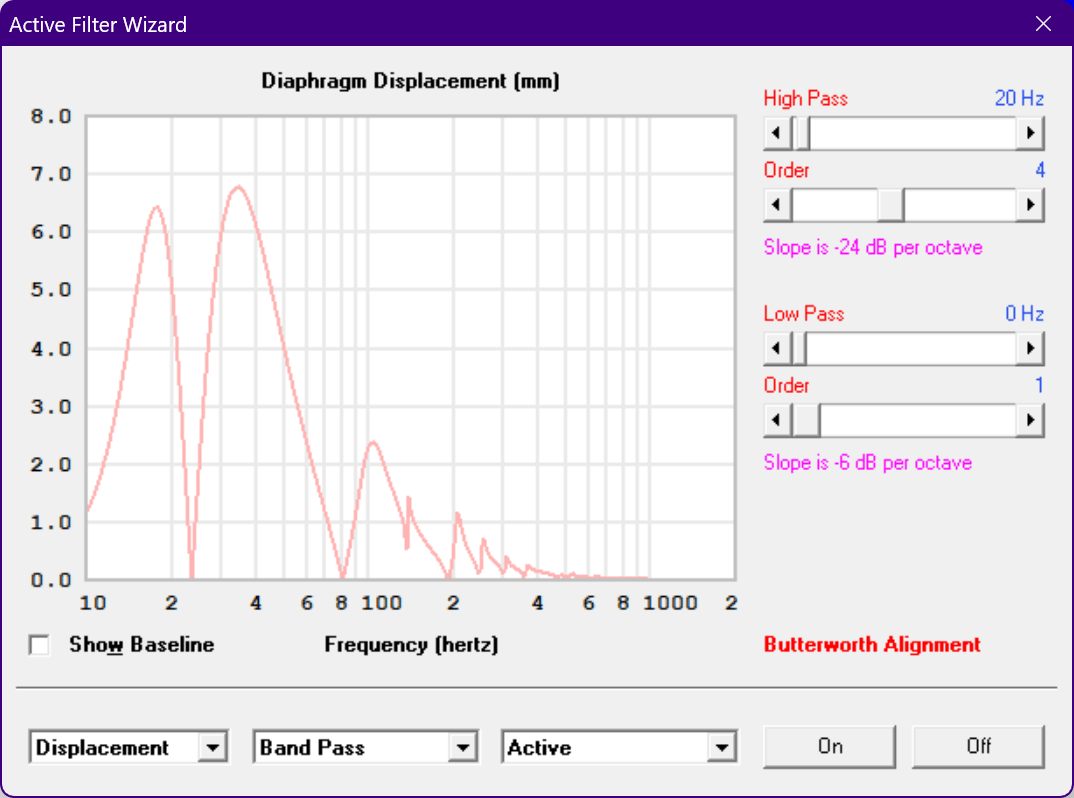

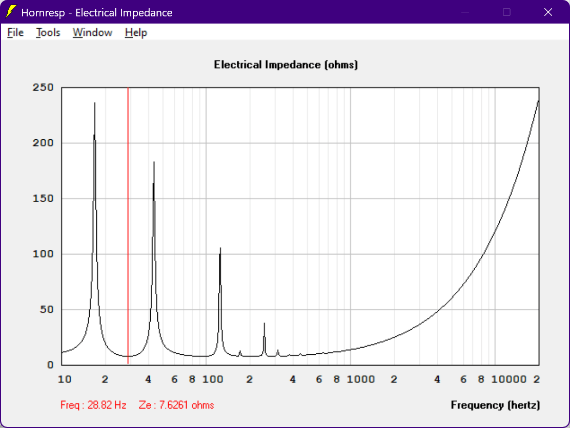

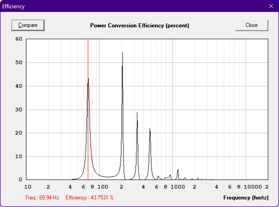

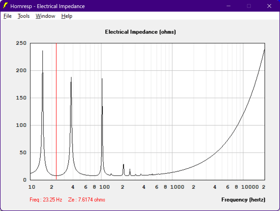

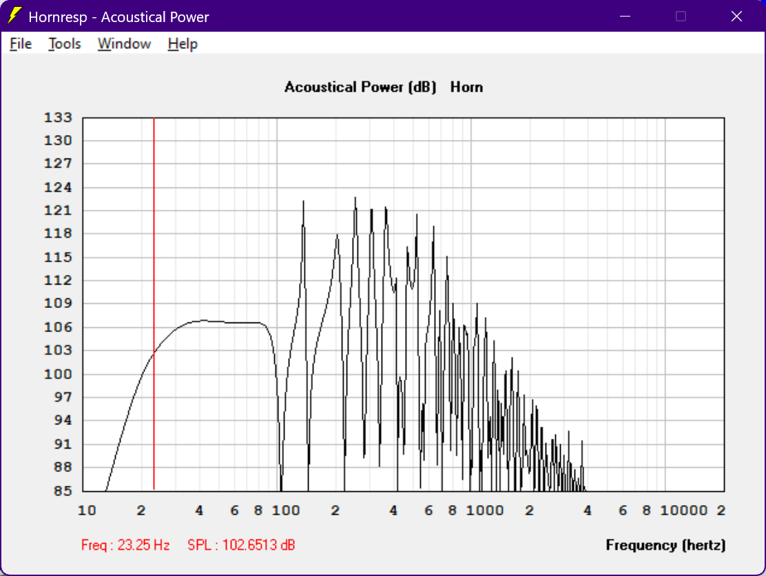

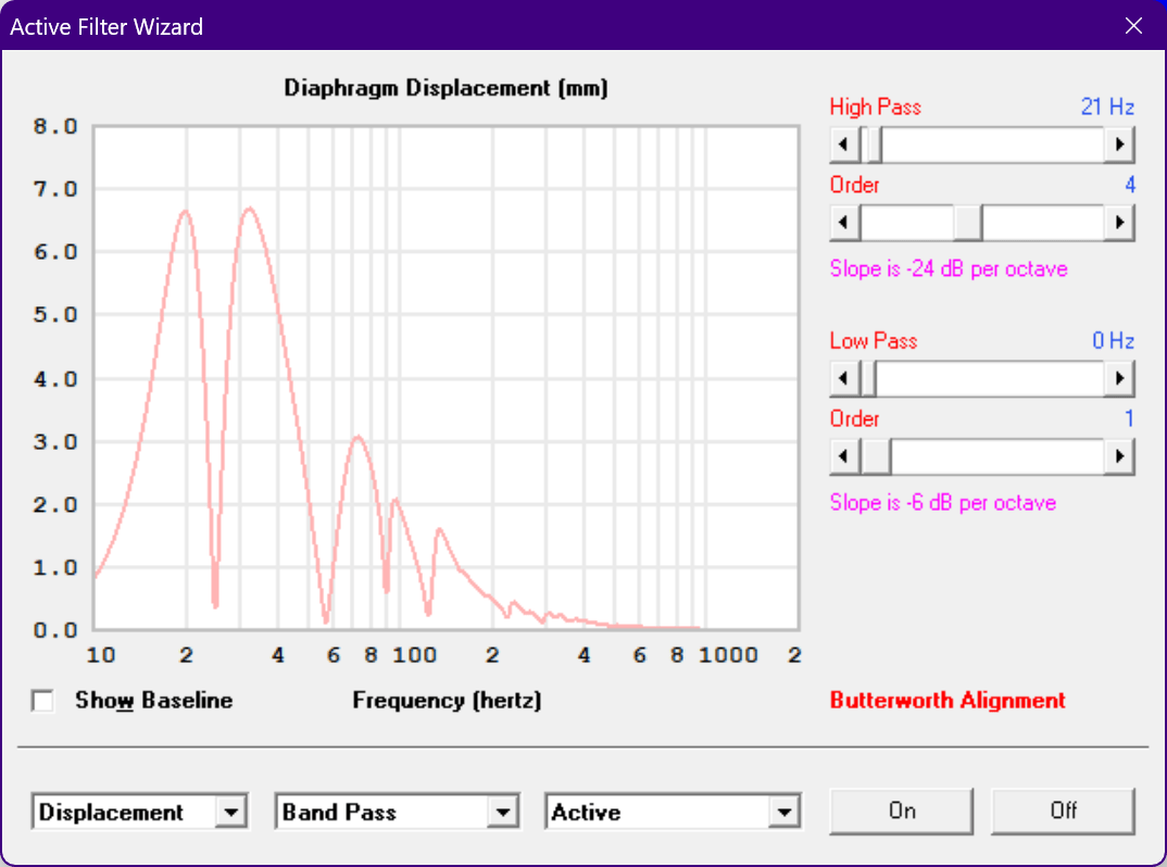

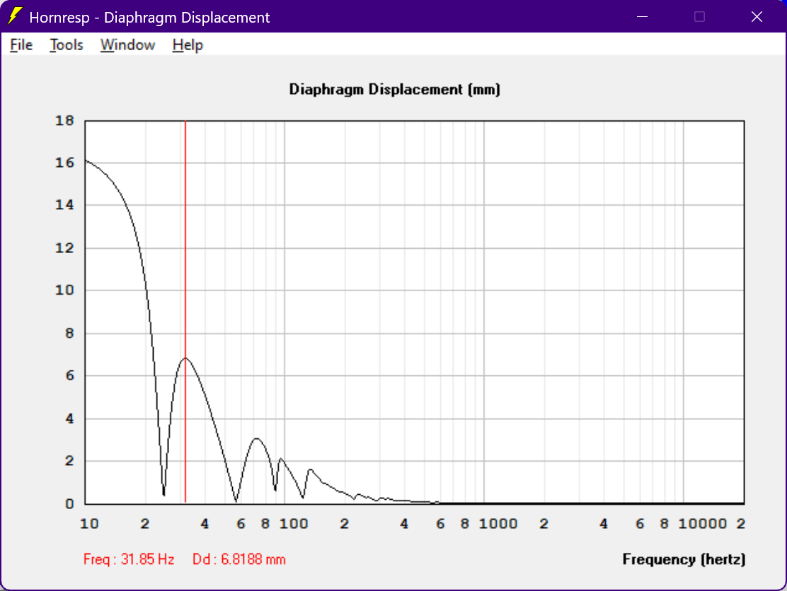

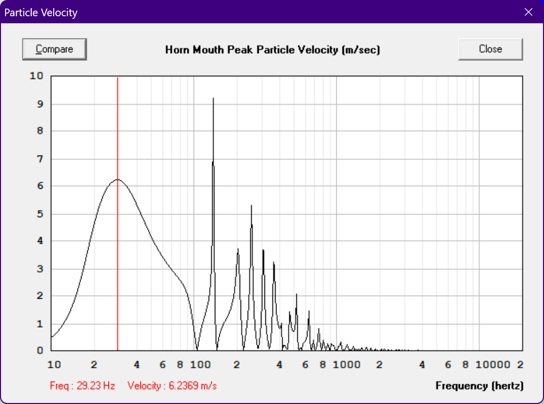

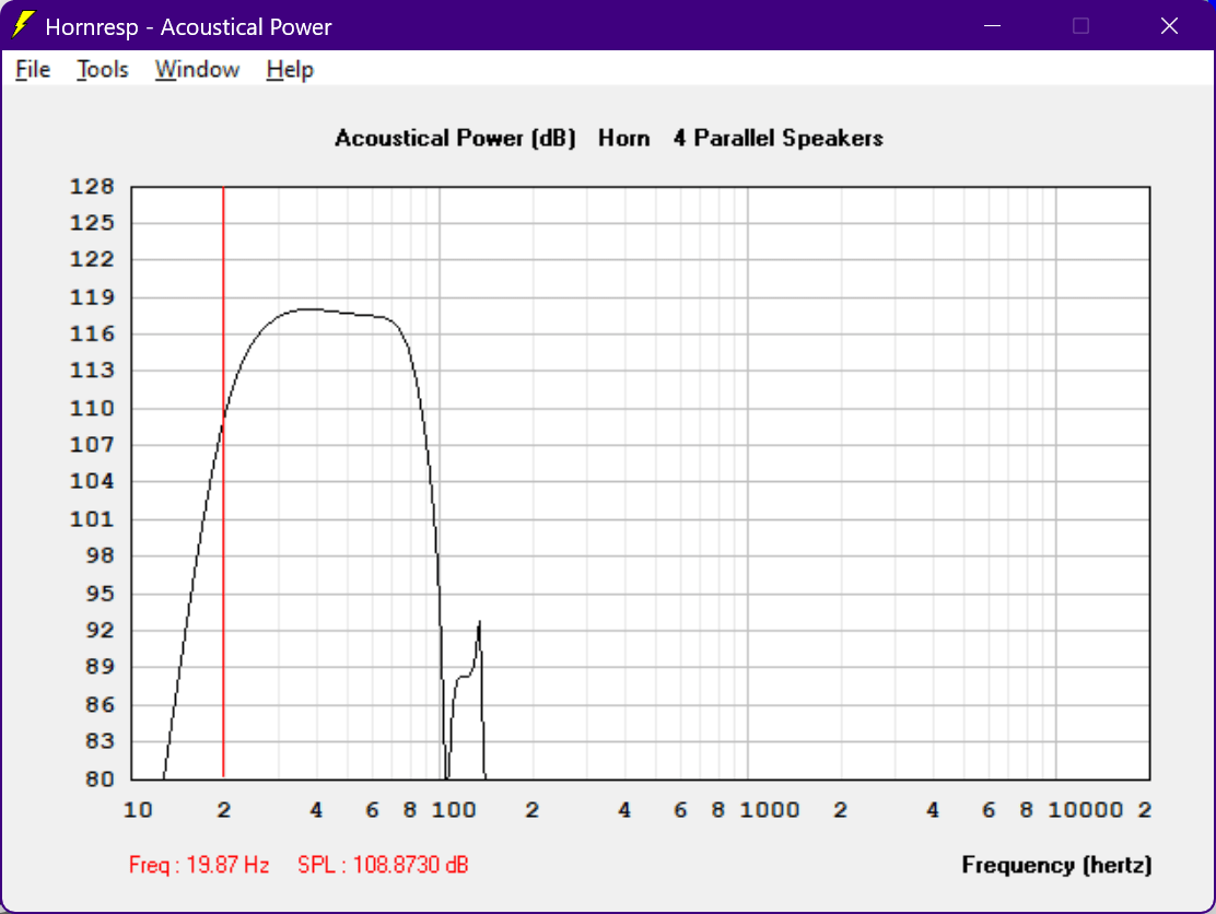

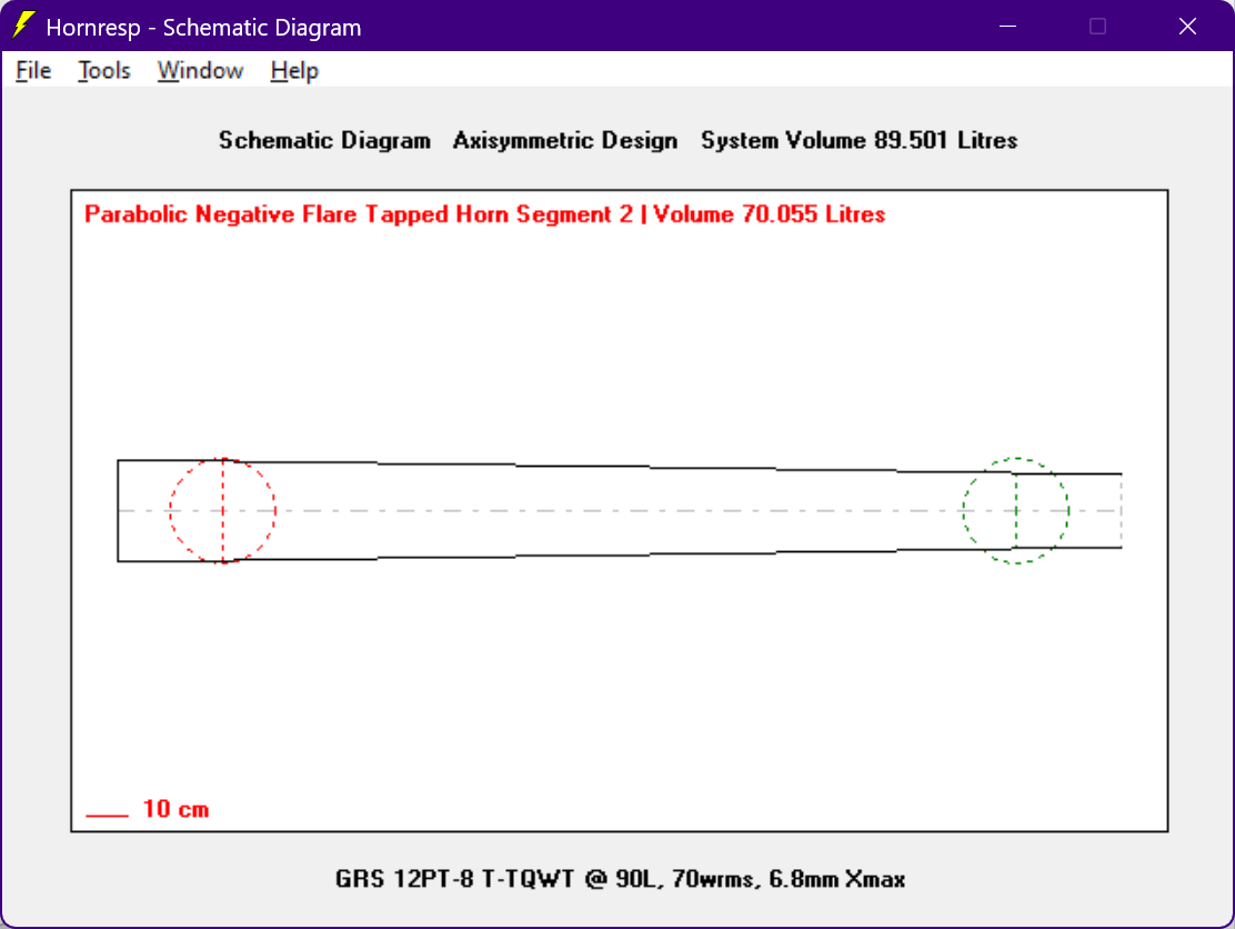

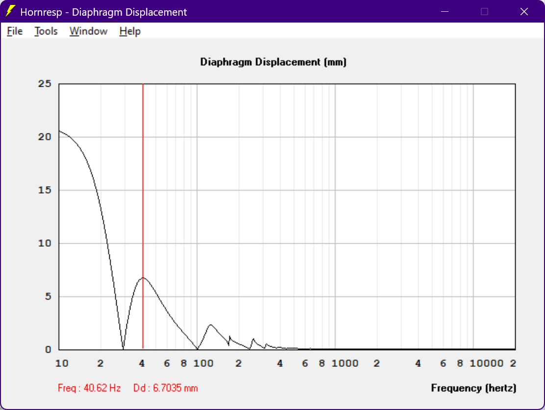

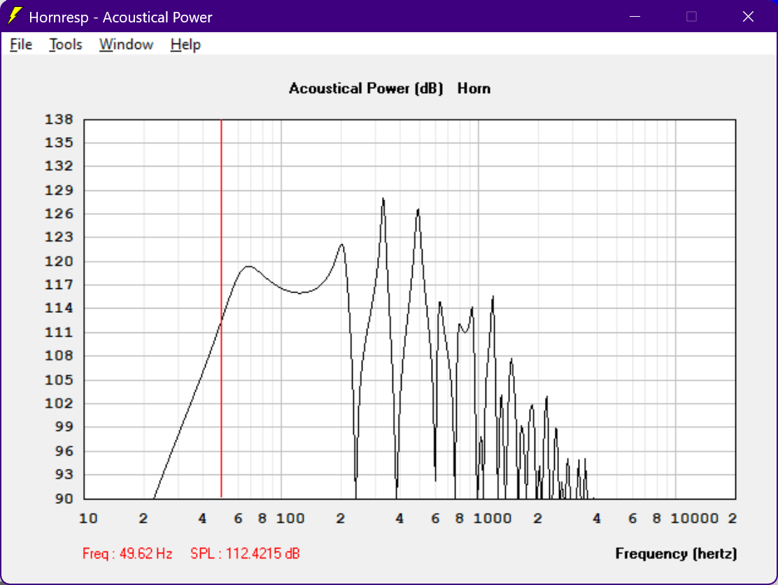

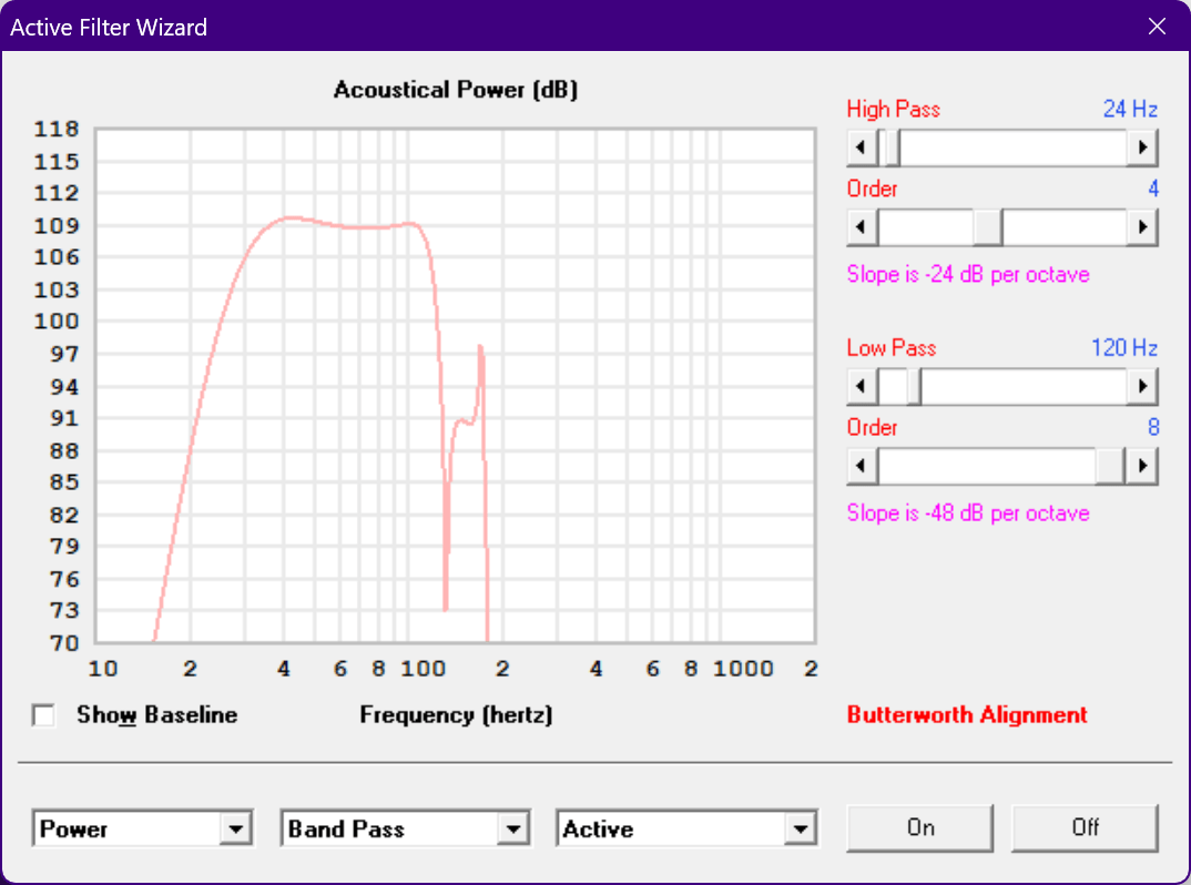

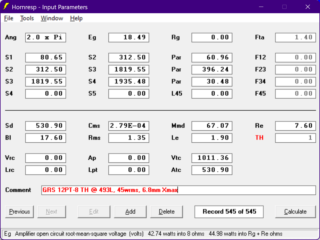

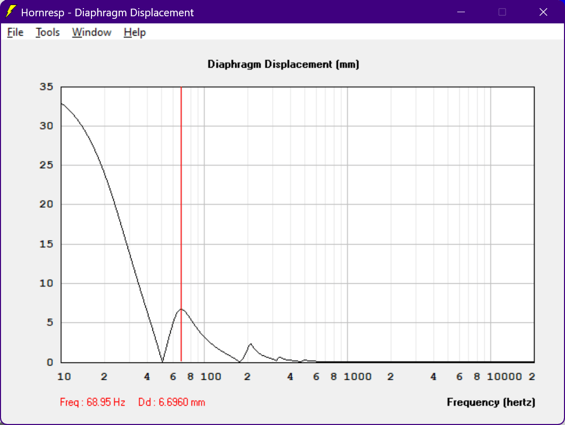

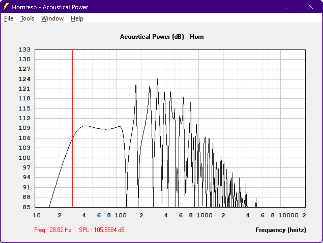

For home theater, here you go.

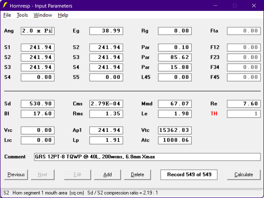

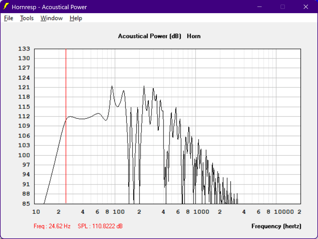

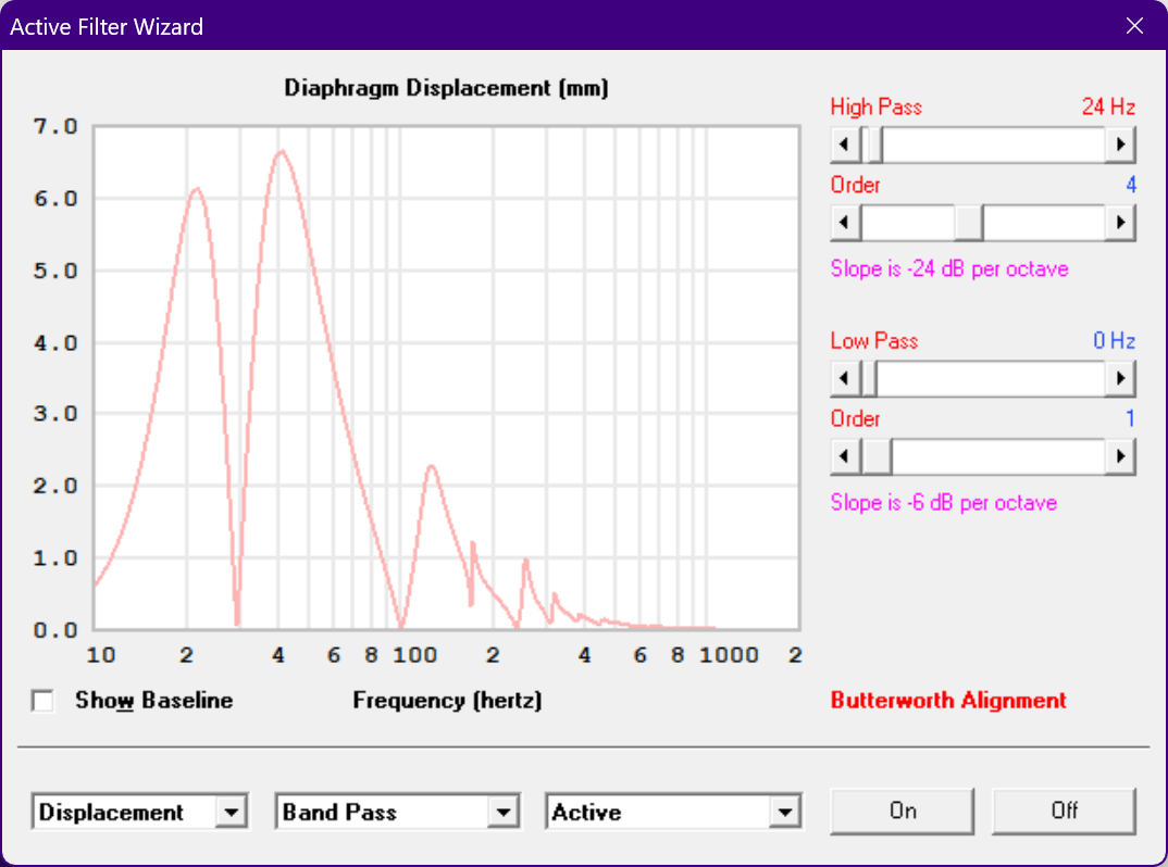

10 foot negative flare TH (Tapered-Tapped Quarter Wave Tube or T-TQWT).
112 liters for 1 x 12" driver!
Tap points are at 12"!
12.5" x 6" throat.
12.5" x 3" mouth.
Hofmann's Iron Law, I picked low and small.

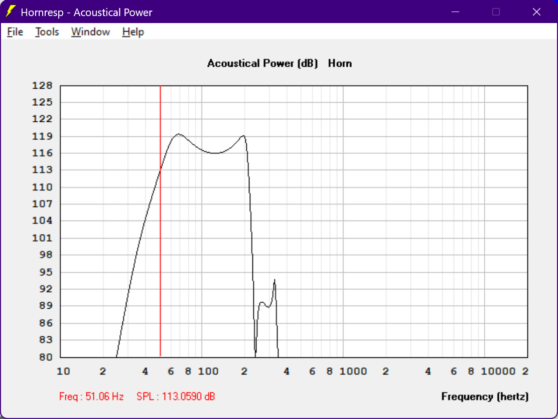

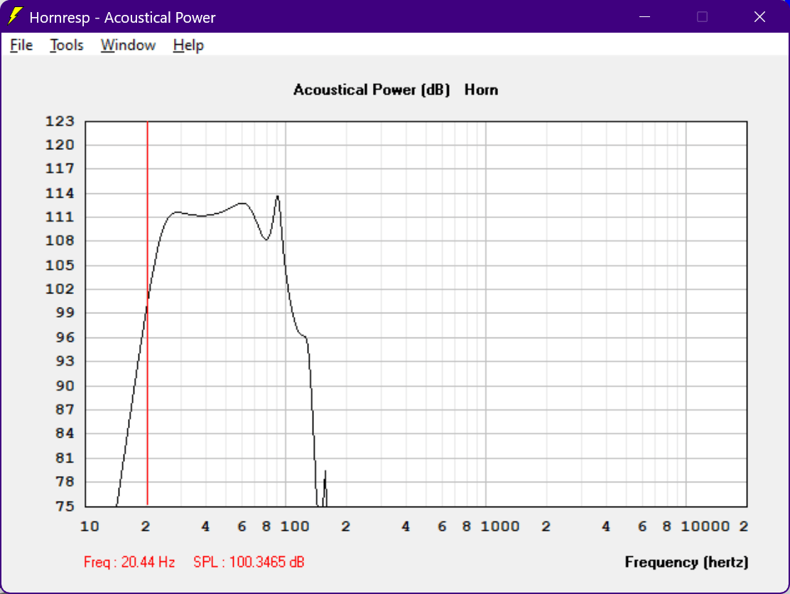

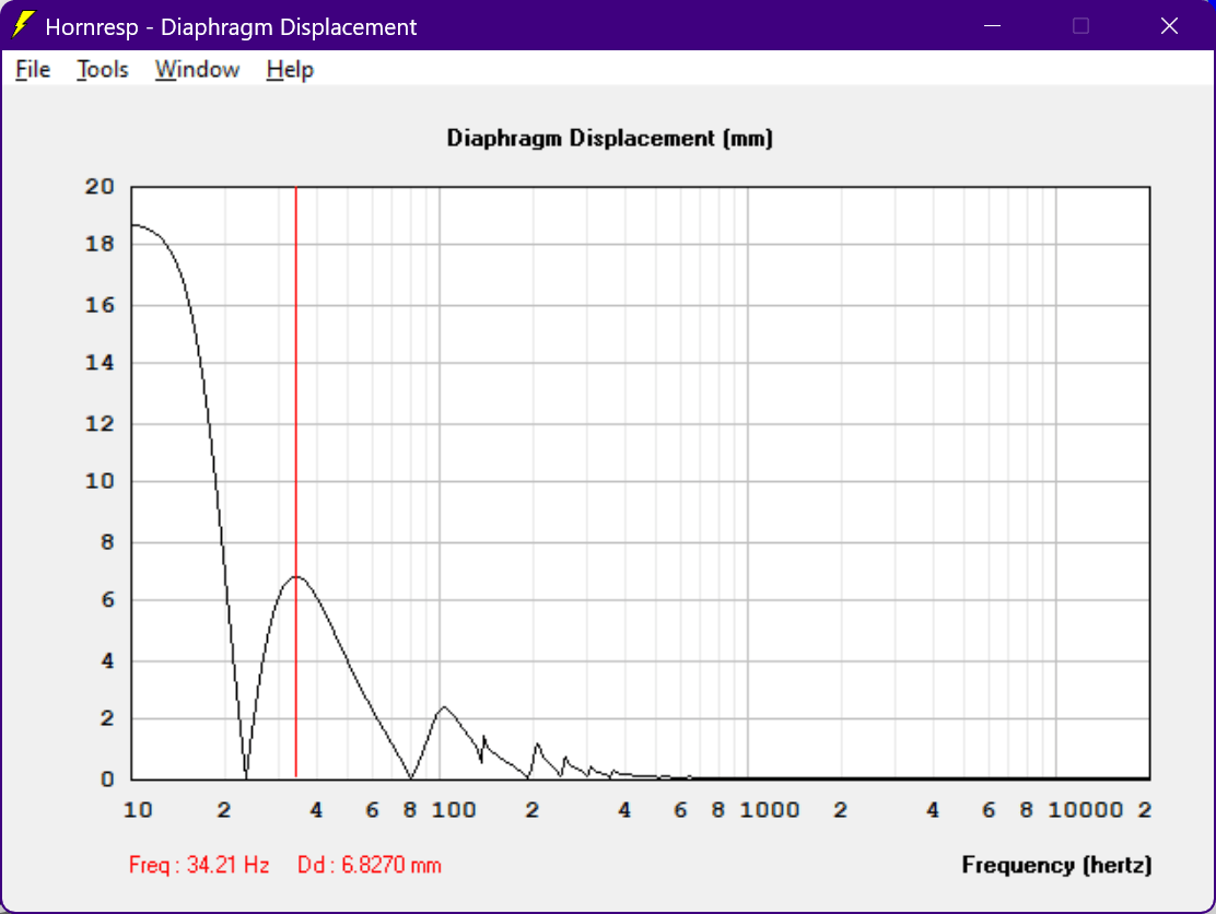

@BP1Fanatic - re: the 111 liter version, how much of that style will fit into a 4 foot tall one fold pipe - I see ~30Hz cutoff at 93 liter and total length 224 cm.

Here's a one fold pipe I uploaded 14 years ago made of badly warped plywood. Ideally I need some clean output around 120 or a bit higher to support LORDSANSUI's "smallhorn3" - -.
some offset to fix that 100Hz dip would be good ss may not be able to get a decent DSP
Absolutely PERFECT ! - and should be an easy - cheap project for the Heresy owner.

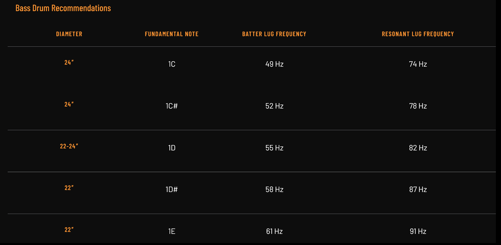

What could one do with a shorter line to specifically support kick drums with the GRS 12PT? Karlson are amongh the very best I've heard for "hit" but an X15 sized Karlson, tun ed to 53Hz has only about 2CF rear chamber, and rolls off below 80Hz. Maybe an XKi absed on series 6th order?
What with a pipe can be one which beats a dumb old reflex for this chart ?
CUBO kick are tuned to enhance an octave above these Tune-Bot bass drum tuning frequencies. I assume Mr. CUBO knows what he's doing.
