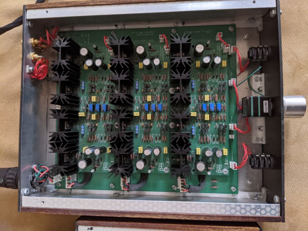

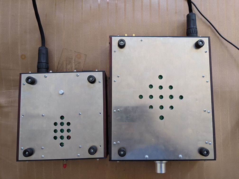

My beta22
Built my beta22 years ago. Enclosure is home made with aluminum sheets and mahogany sides.

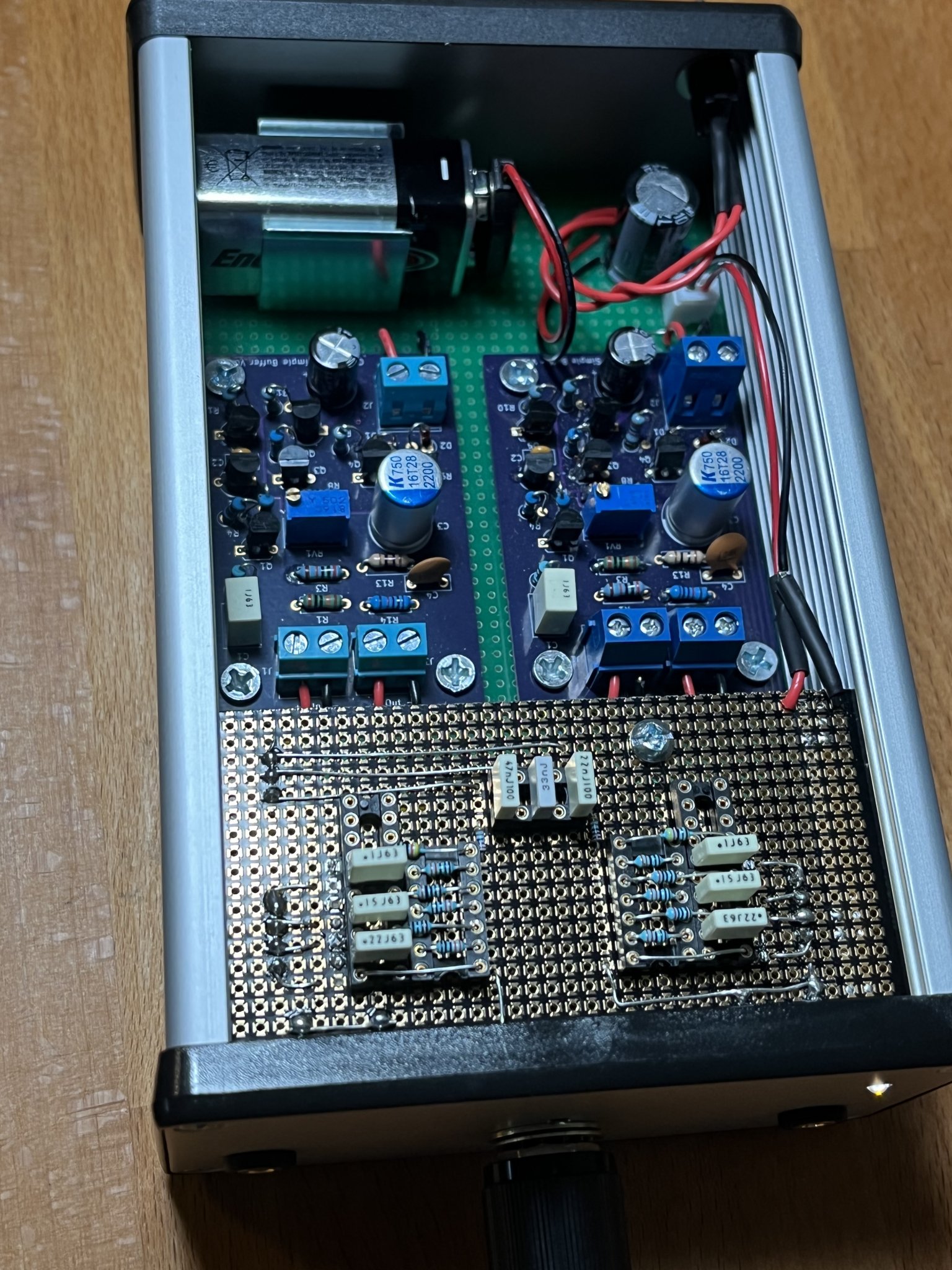

This thread has gone stale, so here is a recent project. I think of it as a Crossfeed Sandbox, since it includes three Meier-style (enhanced bass) Crossfeed settings, all in sockets so I can play with different resistor/capacitor values. The simple discrete buffers are my own design.
The top does fit on this, but I leave it off so I can easily swap crossfeed components, and because I haven’t yet installed a battery door.

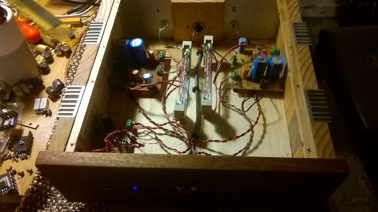

Here's my Zen Lite HPA with IRFZ44N, idling at around 0.7A.
Also capable of driving 8 ohm 90 + dB speakers.
PSU is external 48V plus on-board CapMx.

Nice looking amp, can you share schematic/gerbers of the discrete buffers ?The simple discrete buffers are my own design.
It is basically the schematic inNice looking amp, can you share schematic/gerbers of the discrete buffers ?
https://www.diyaudio.com/community/threads/a-basic-discrete-buffer.374389
One issue with the buffer is that the passband is too large, so I did need to add an input low-pass filter to reduce EMI-induced noise. I used 1.5k resistor and 330pF capacitor. It is soldered on the green pcb and not visible in the photos above.
I can post the gerbers - I will try to do that later this weekend in the thread about the buffer - it will take some time as I will need to make sure I include enough information with them (parts list, schematic with correct labels, etc) so that they will be useful. However, this is the first board I have ever designed, so I'm sure I made many rookie mistakes. For one the traces are very thin - not sure what I was thinking with those! I ordered them from Oshpark and just shared them so you can see for yourself:
https://oshpark.com/shared_projects/5WctCoeP
By the way the $20.80 US price included delivery inside the US and 3 copies of the board.
jason

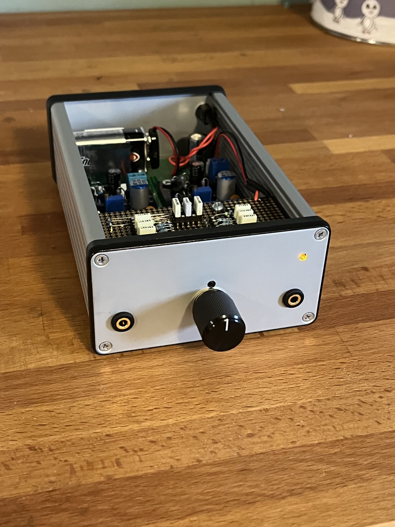

I guess I will revive this thread...
Here are a few portable discrete amps/buffers. Each includes crossfeed, uses a single-supply design with class-AB output inside a global feedback loop, and draws around 12 mA idle.
Brief descriptions
1. bipolar complementary-feedback pair; gain = 1.
2. actively-loaded LTP input that directly drives output (2-stage opamp); gain=1.4.
3. JFET common-source input that directly drives output; gain=-1. Has high H2 distortion but I like it anyway.
Playing with simple designs like these is a fun way to learn more about transistor circuits. I use them all the time because of the crossfeed.
jason
Brief descriptions
jason
They all have output capacitors with 1k bleeder resistors, so DC shouldn’t be a problem. I should have added that detail to the ‘single-supply’ part of the description.
The jfet-input device might not be the best for sensitive IEMs. I don’t have equipment that allows me to measure the noise floor, but it uses shunt feedback with 51k resistors so will be noisier than the others. I wanted the high resistance for input impedance after the crossfeed, and as a bonus it improves stability with capacitive loads. All of the units have <20% overshoot in square-wave response with pure 2nF loads.
On the other hand, both the jfet and the ltp amps have an optional output attenuator (33R and 3.3R volttage divider) that can be enabled with a jumper visible in the photos. I don’t listen loud so like that option, and it only makes the output impedance a maximum of 3.3 Ohms. For sensitive IEMs perhaps other voltage-divider values would be better to give a lower output impedance.

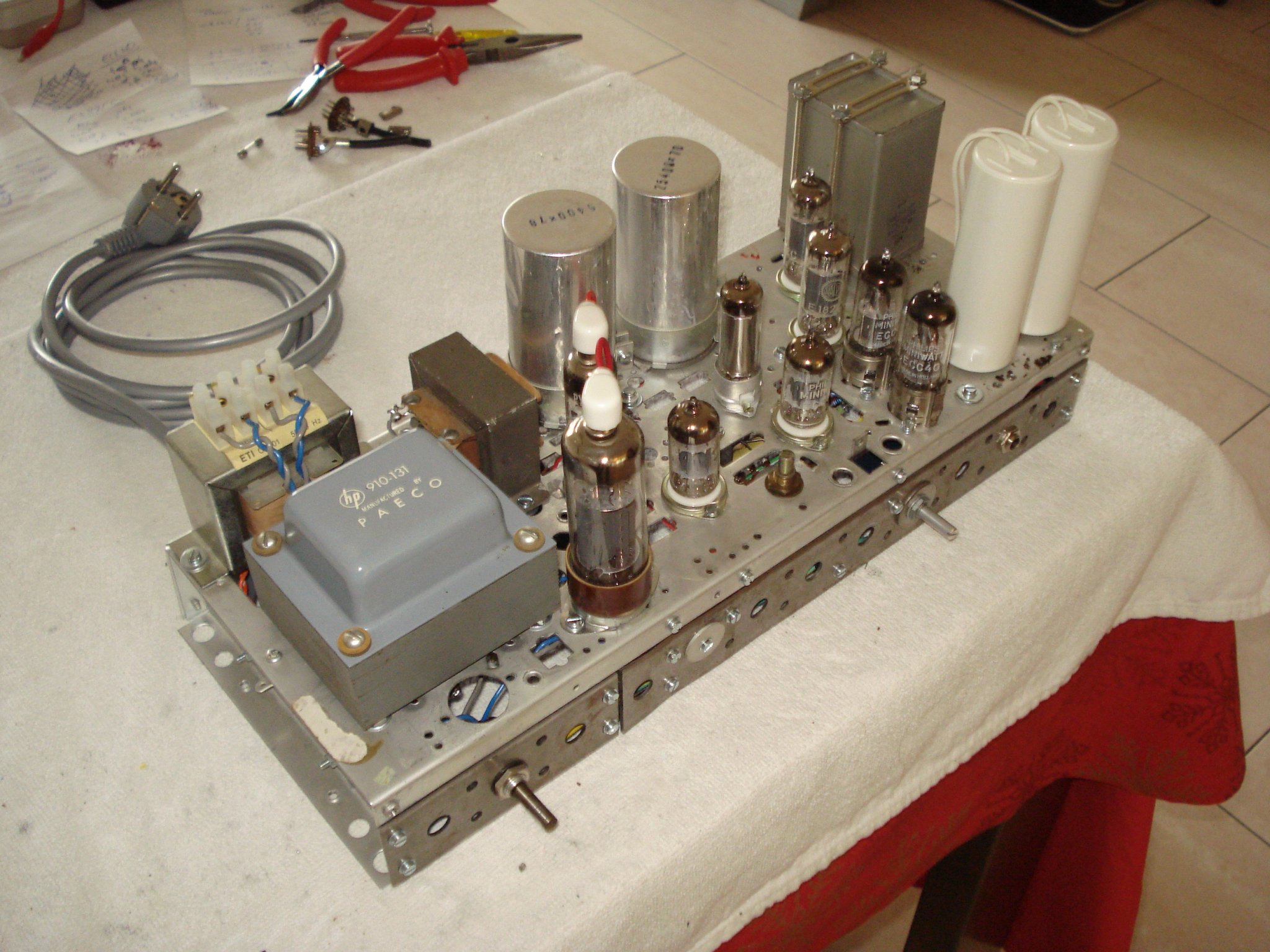

Since the thread is coming back, I will add my amp to the bunch. It has been a long time ago now, but I built this Glassware Audio HP amp using an old power amp chassis that I thought would be thrown out. Took a lot of work but the result was the best sounding HP to date for me. Uses 6GM8 tubes for the input and I don't remember the model but it uses voltage regulators for the output! I just had to try it out.
