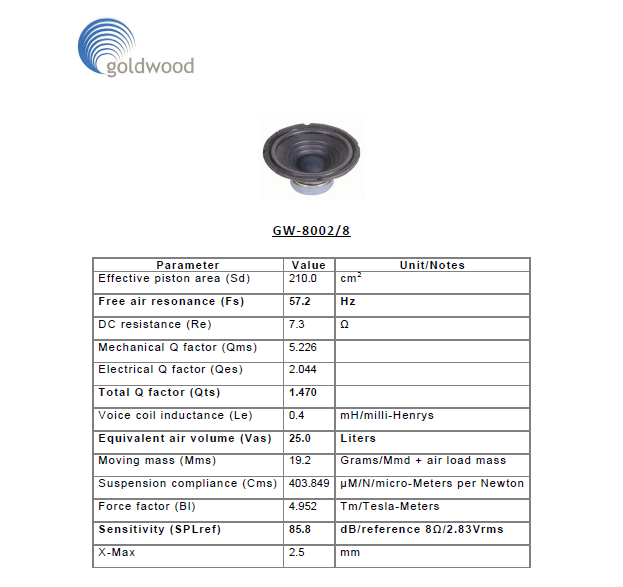

I'm just starting to study this world of hifi, I apologize and please be patient for any mistakes I made...
For example, I found this woofer on the internet and when I put it in WinISD, in the cone excursion graph, if I put 6w on it it already exceeds its Xmax and could cause damage (This is in a 30hz box).
I intended to put a maximum of 30w on it...
Even doing it in a sealed box the result will be the same
