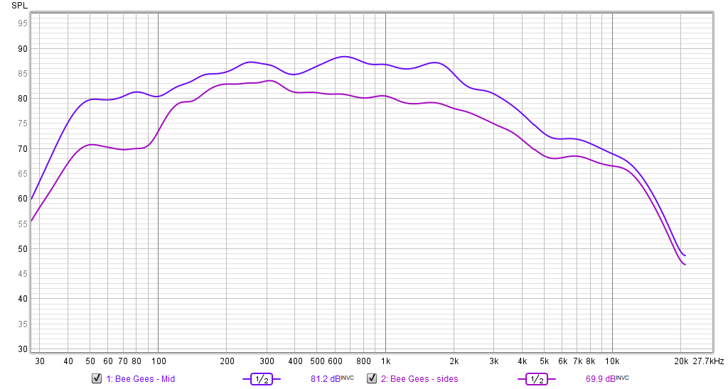

Here is an analysis of the Bee Gees song "How Can you Mend a Broken Heart?"
The file is converted to Mid-Sid format, then run through frequency analysis to plot the FR of the mid and the side channels. For those of you not familiar with Mid-Side encoding, it's a format where in channel 1 you have the mono information, that is the information that is common to both left and right in a stereo recording. In channel 2 is the Side info, which is all that is NOT common between left and right. There is much more info available on the web about this format if you care to search.
E.G. https://en.wikipedia.org/wiki/Joint_encoding
The basic idea is to show the mono part of the signal (mid) vs the stereo part of the signal (sides) plotted over frequency.
Below is a frequency response plot of "How Can you Mend a Broken Heart?" showing the levels of mono (mid) vs stereo (sides). You will see that in almost all recordings the stereo portion of the recording is lower in volume than the mono portion. At least for most of the spectrum. This is shown below.

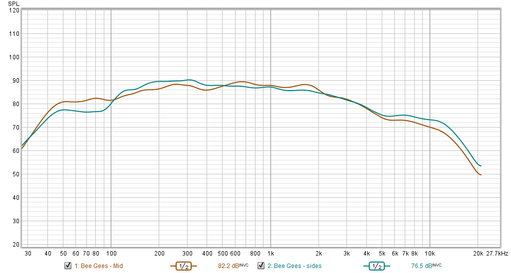

Below is a normalized view of the same file. On this plot the mid and the side channels have been matched in RMS value. For me this makes it easier to see the relative levels of mono vs stereo. We can see that stereo seperation does drop about 4dB under 100Hz, but that seperation rises above 5kHz. A good argument for not using mono tweeters!
How would you prefer to see the mono vs stereo difference plotted? Actual levels as in the first plot, or the two signals normalized as in the second plot?

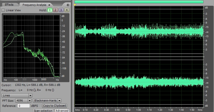

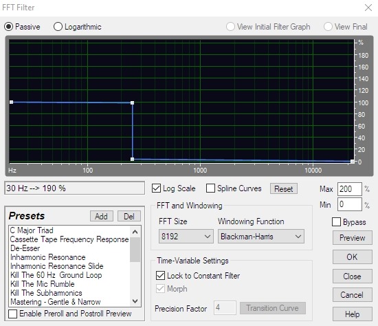

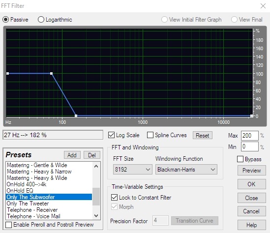

I played a bit with Light My fire, as mentioned in the other thread.
I made two files, with an FFT high cut filter.
The first one starts to cut at 75Hz and steadily rolls off to 150Hz
The second one is a sharp cut at 250Hz.
I included two minutes audio of both files and screenshots of the waveform and FFT analysis.
You will hear a nice distorted left channel in the 250Hz (bass12m.zip) file :)
The bass guitar is on both channels, the bassdrum and snare on the left.
This is the CD version, not the LP.

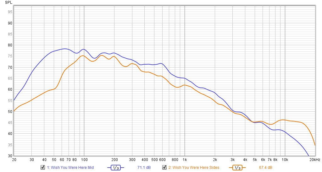

I've been looking at a lot of files and it seems best just to plot the mid vs side at their normal levels. The reason is that it shows how much, or how little stereo effect there is in the recording. Let's look at two examples from Pink Floyd. Below is "Us and Them" from DSOTM. You can see that the stereo effect is very strong across the spectrum.
Next we see "Wish You Were Here" which has less stereo effect and not much stereo in under 100Hz. Definitely a near mono bass there.

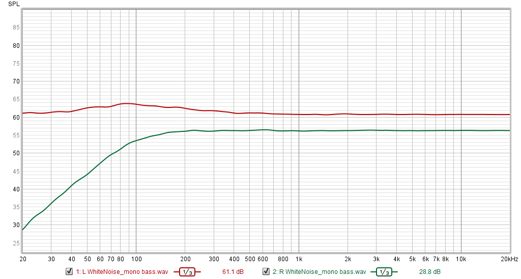

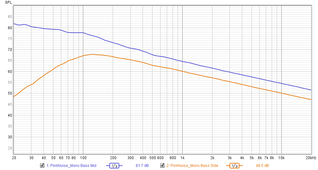

This shows uncorrelated white noise that has been mixed to have stereo at 6dB below the mono. And also the bass has been blended to mono under 100Hz.
A recording with mono bass would look like this.
And pink noise the same mix.

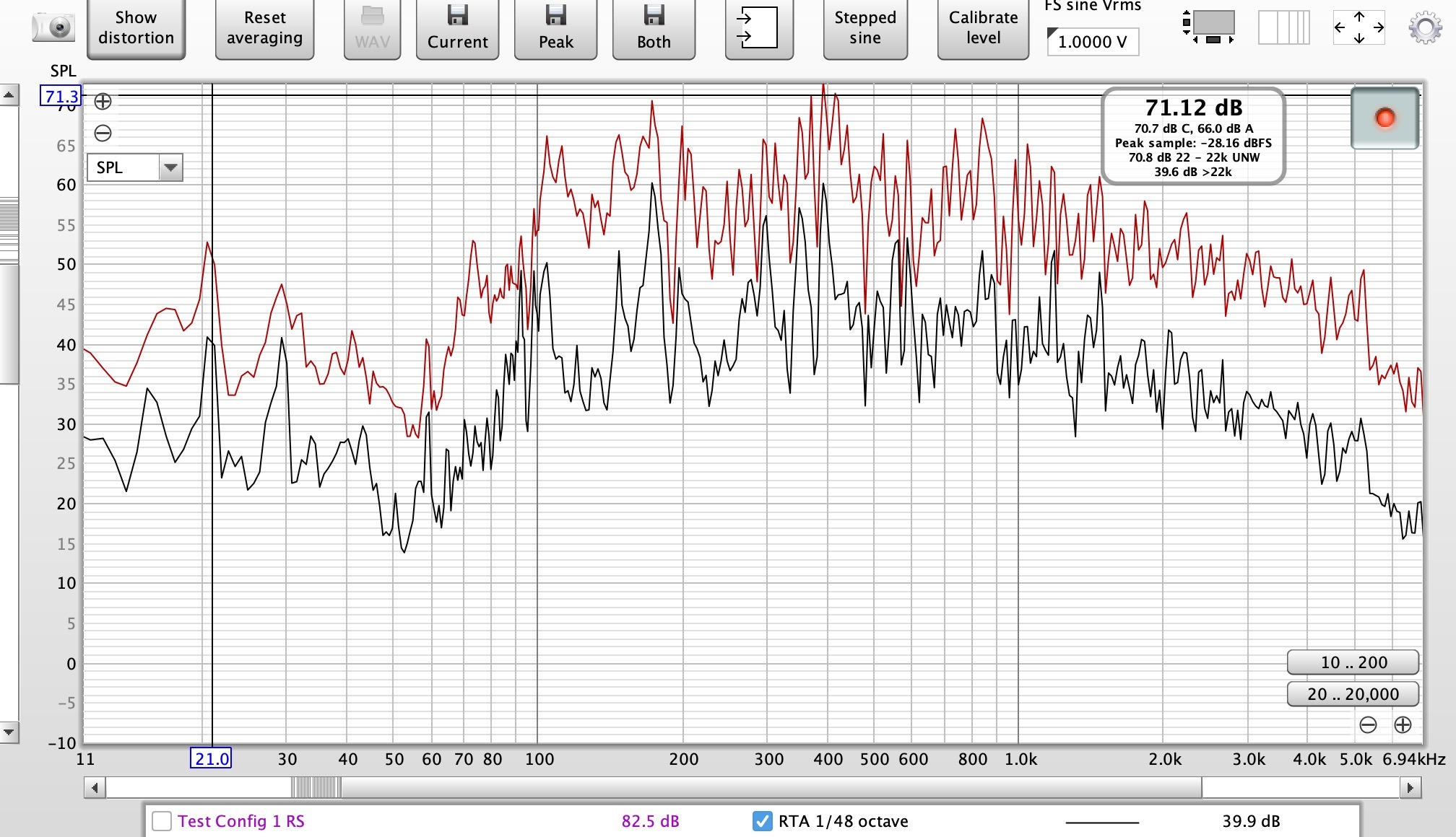

Analyze "The Kraken" by Hans Zimmer. (I'm playing it from Spotify)
I'm hearing what seems like the majority of the song even with the null test. It sounds much more impressive in normal stereo, though. I'm not sure how they managed to escape the null test? But this might be better case for stereo subs. The context where I first heard about stereo subwoofers was reproducing pipe organ music.
I hear a little sub frequencies, but mostly it is above 100hz according to the RTA.

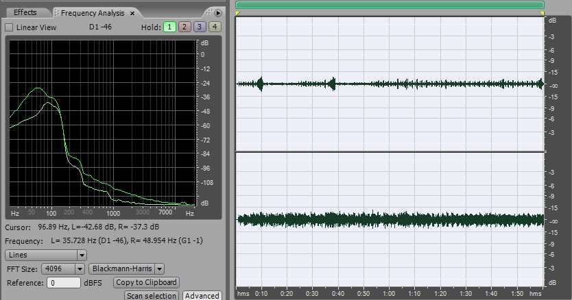

What are we looking at here? Looking at the waveform to see any differences in the LF?
It's only the bass from both channels of the song. First only what normally goes to the subwoofer, second the full bass frequency bands up to 250Hz.
Kick and snare are panned to the left, bass guitar (or synth) a bit more to the right. It only confirms your findings about that particular song that the bass is not centered.
