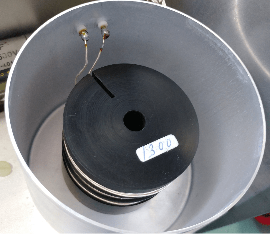

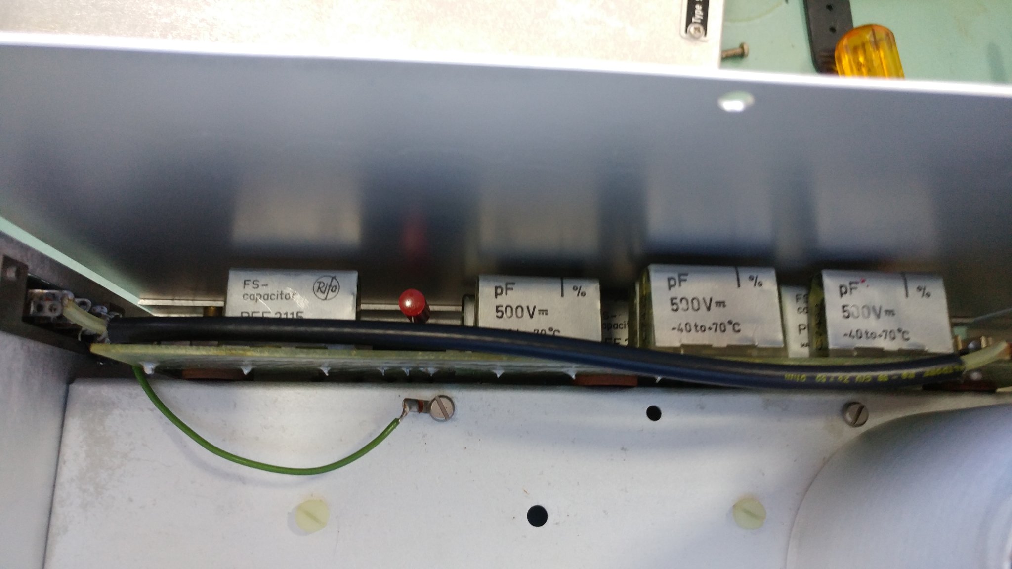

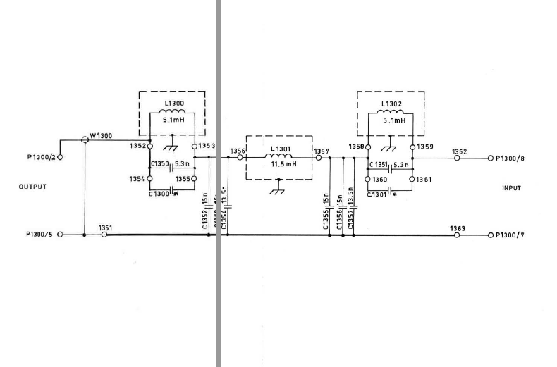

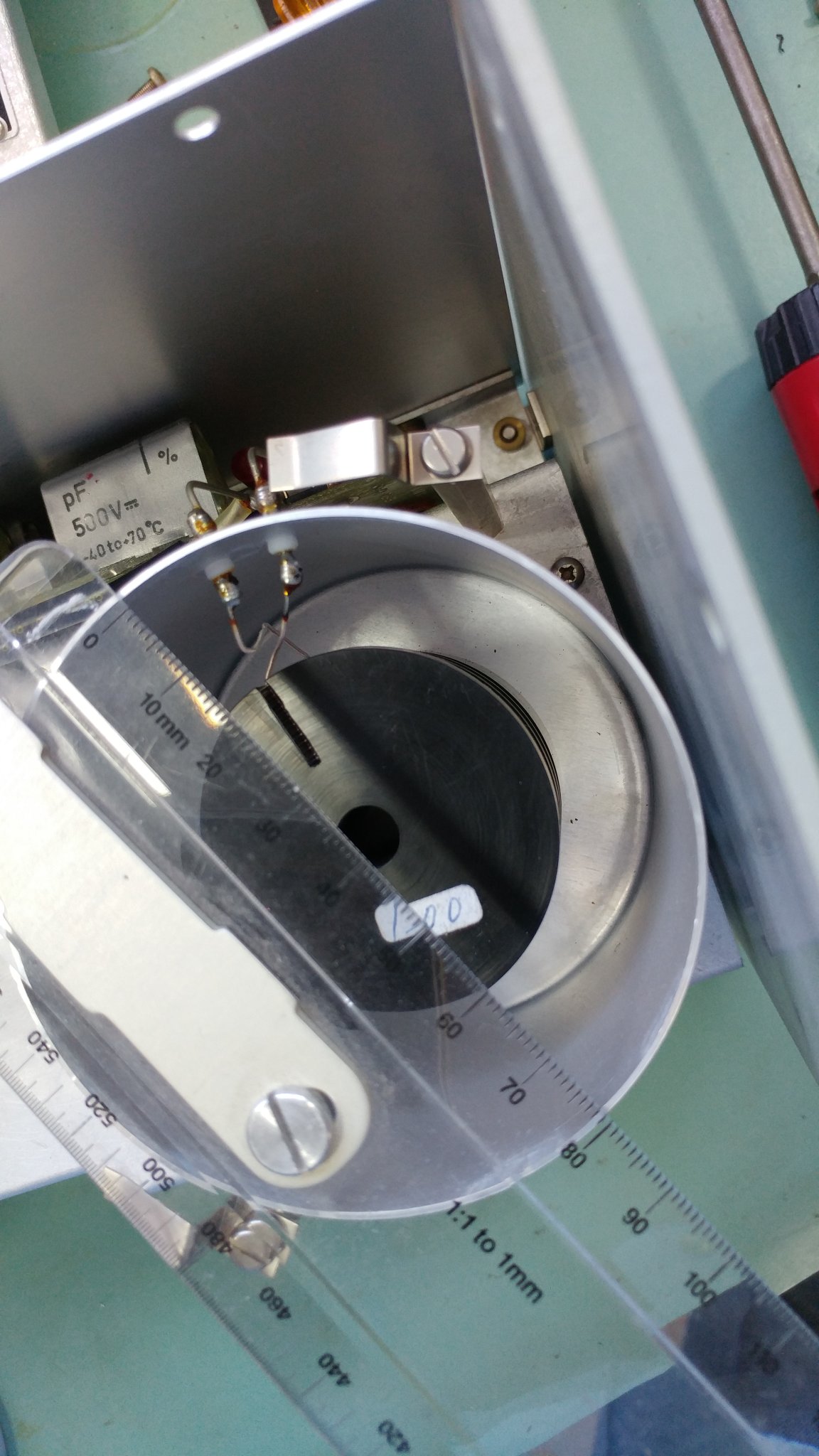

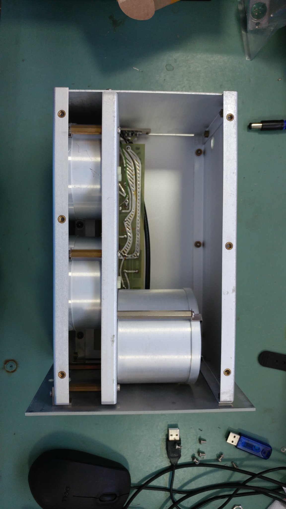

A quick check of some 10K resistors on hand- I had to go up to 30V to get out of the noise floor. The HD3 residual on 2 Dale 1/4W and a Vishay S102 were the same at around -168. I did not want to go to 100V before doing some calculations to make sure I don't fry the resistors. Basically nothing to see here.
WRT CLT-1 some pictures and the schematic for the low pass filter.
