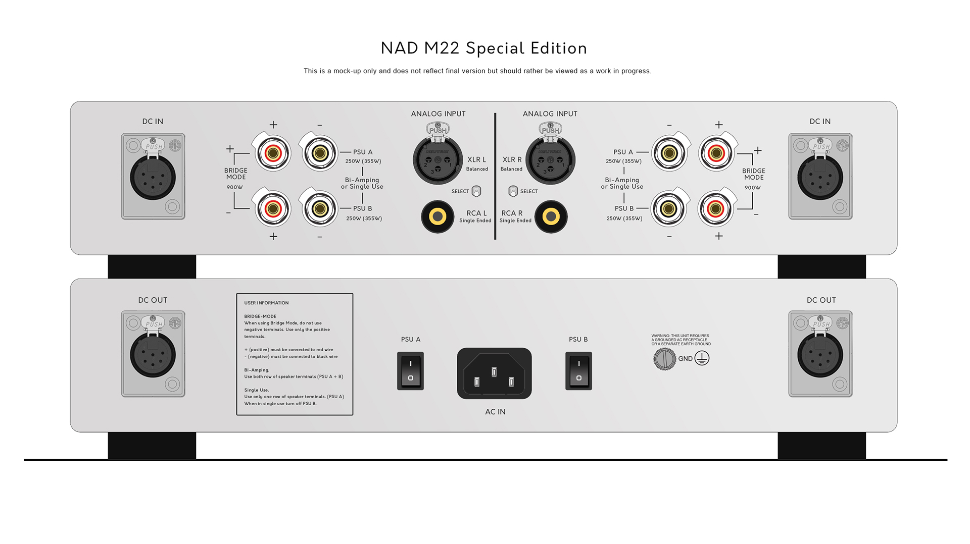

  1. The primary goal of this project is to use 2 x NC400 amp modules per channel (4 x NC400 in total) achieving 2 x 250W + 2 x 250W and 2 x 900W - a total of 3 different modes: Single, true Bi-amping and Bridge/Mono mode.
  2. I will use 2 x PSU units called PSU A and PSU B. They are connected in such a way that they individually power a row of outputs (2 x 250W) or be used in Bridge/Mono mode so that each PSU power 1 chn.
  3. The amp and PSU modules will use individual chassis.

To get things going, here is the attachment of the very first rendition of the backside of the amplifier (since that is the most existing thing right now.)

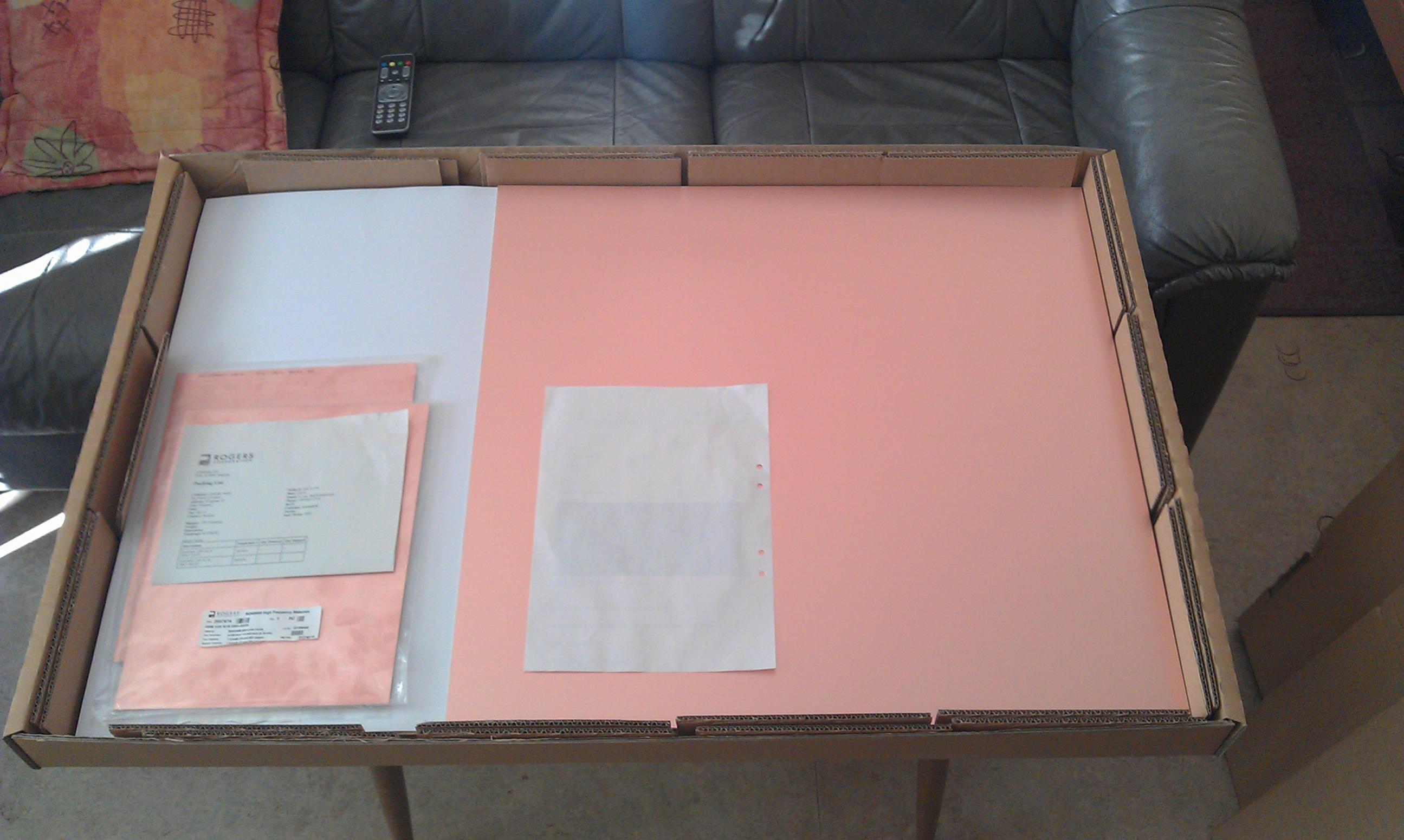

I have a big RO 4350 B panel which will be dedicated to this project (see image). As I mentioned, I am collecting / researching about which capacitors and resistors to use and I will present this work in a few weeks from now.

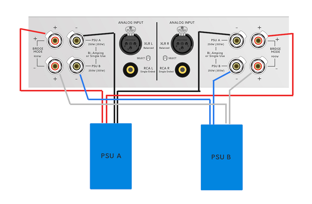

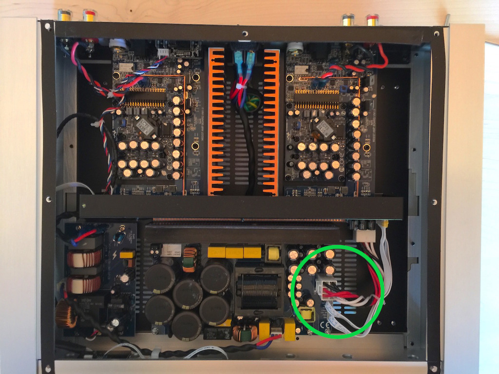

PS: I might be forced to re-think how the bridge mode will work. I might end up forced to do use the same approach as used for the original. As of right now, I'm not sure using the positive line from two different PSU's will work. Looking at the schematic, the PSU have 1 set of V+ and V- coming out of it and it is split into 2 x V+ & V- respectively - see green circle. Using two PSU's compared to one might pose a problem, but I am unsure.
Reading the user manual for the M22V2, it states: "When in bridge mode, Connect the source to the Left input sockets only. Do not connect anything to the Right Input socket when Bridge Mode is selected." - which mean that the bridge mode switch, "duplicate" the left input and send it to the right channel, similarly what the Y-XLR cable does on the original M22.
