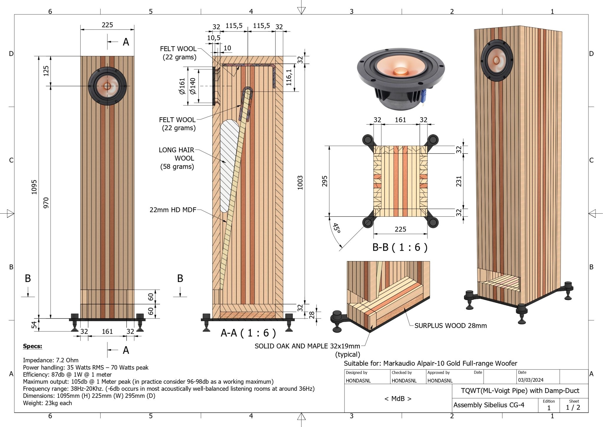

Pearl Acoustic Sibelius

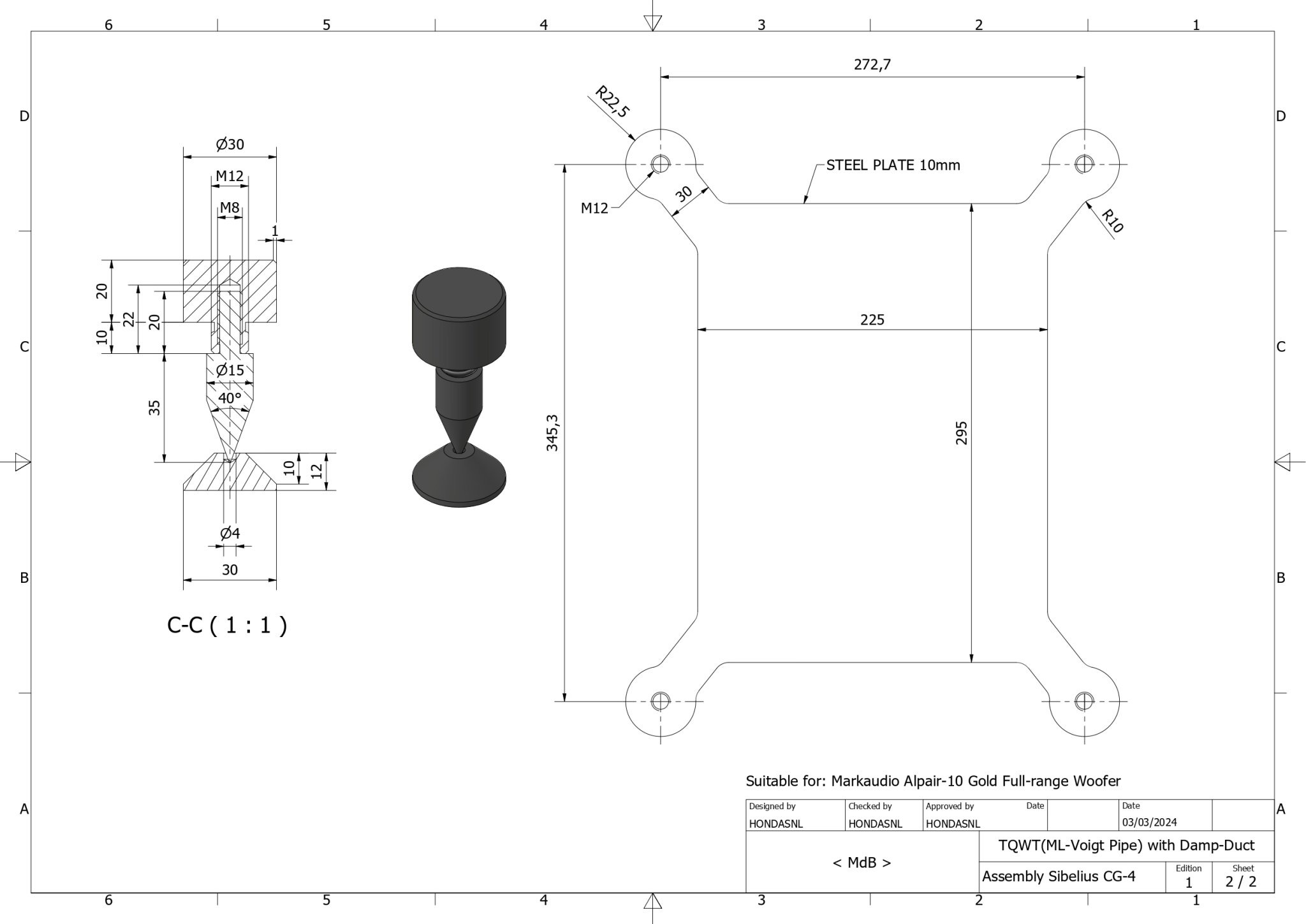

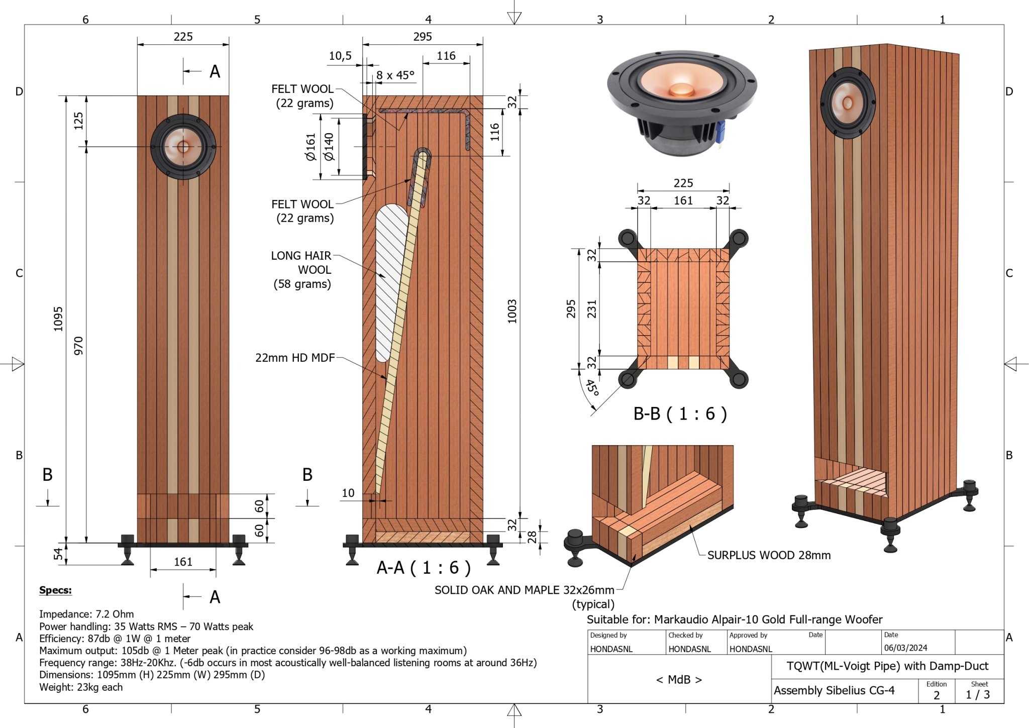

Let's go give it a try :) .
Overall I think it will be sounding good, not perfect, but maybe :D.

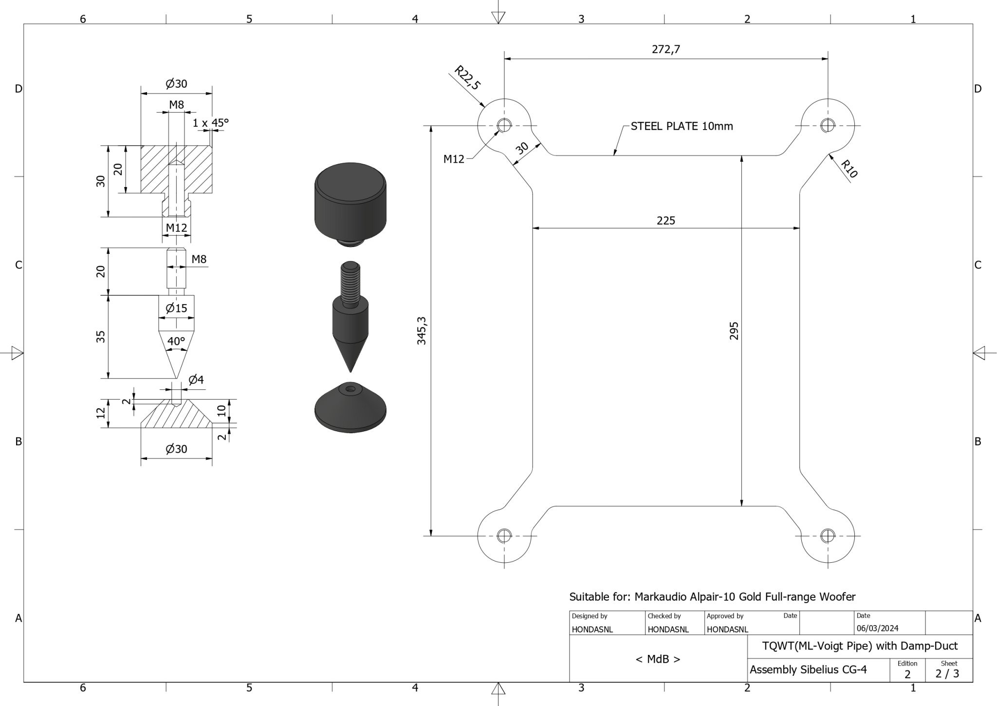

Updated with the "original" adjustable spikes.
Only the base plate I changed to 10mm, original looks like about 5mm.
Baseplate can be screwed to bottom of cabinet, holes can be added.

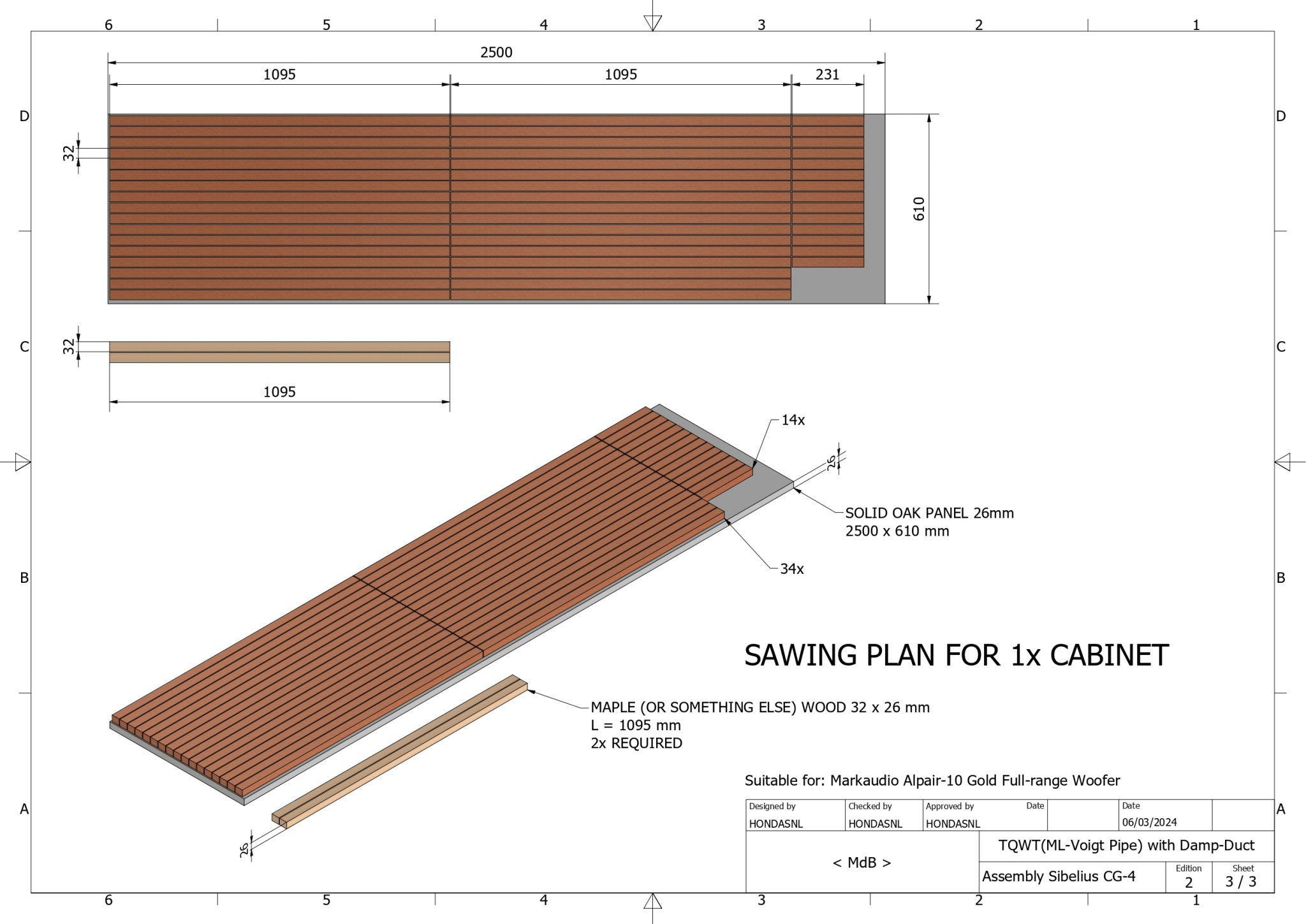

Updated the plan with 26mm solid wood panels.
Including sawing plan with standard wood panels 2500 x 610 x 26 mm panels.

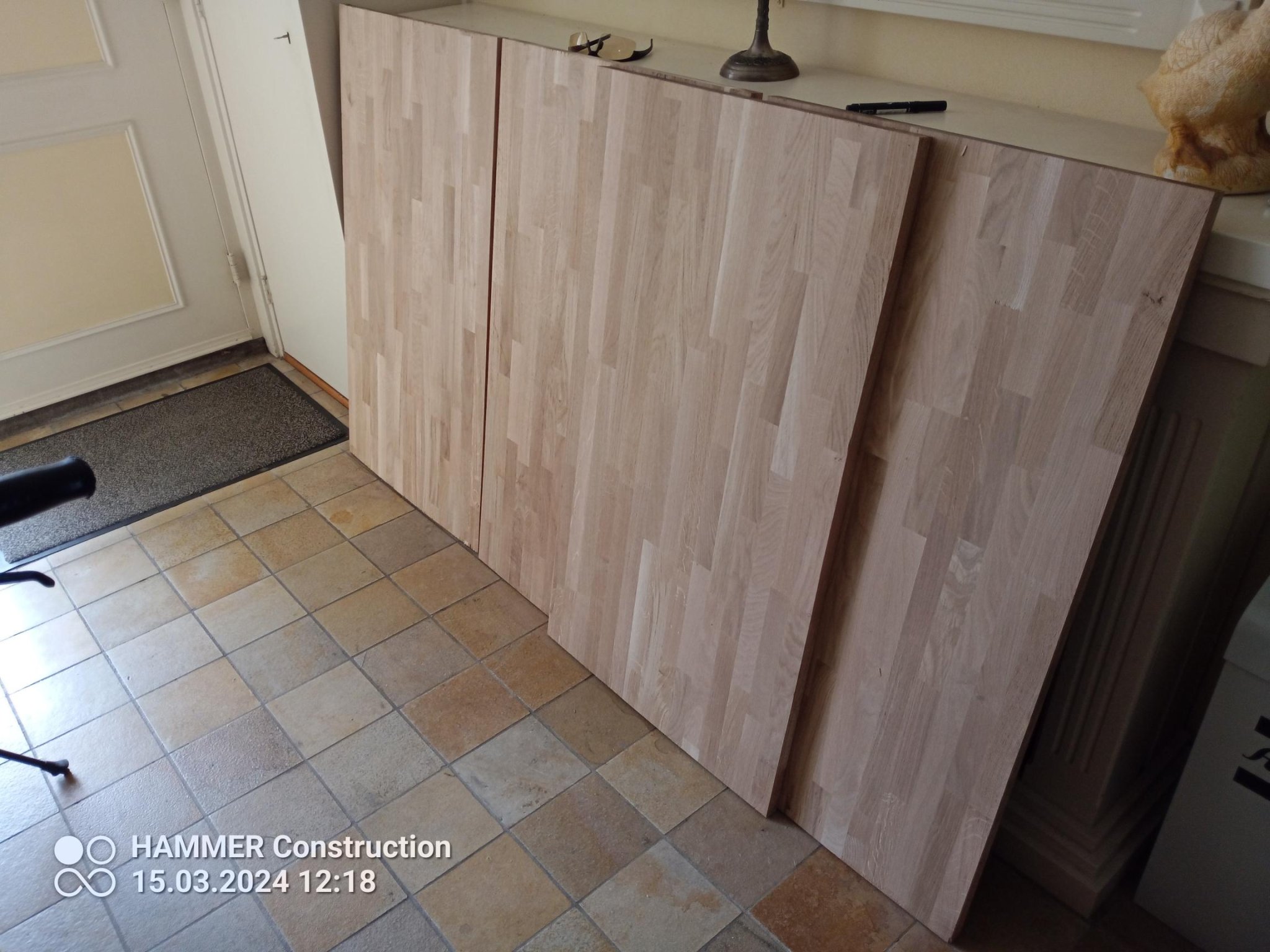

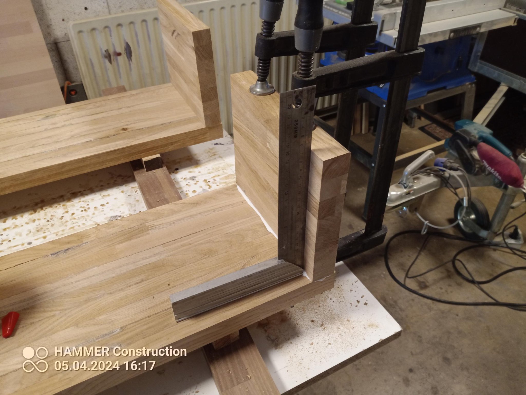

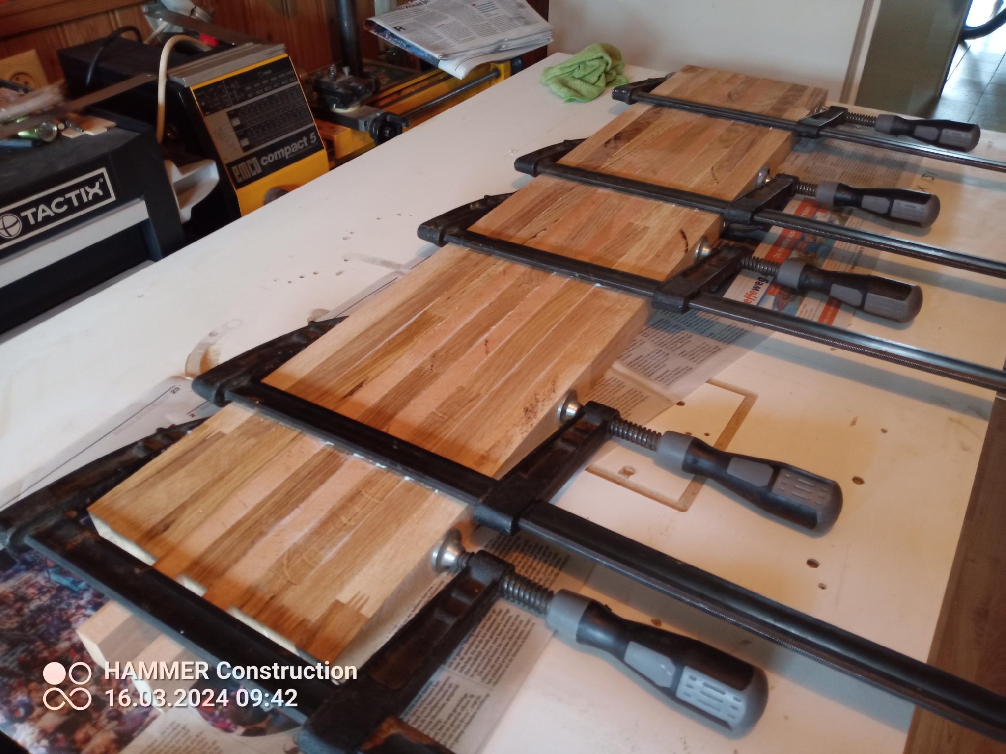

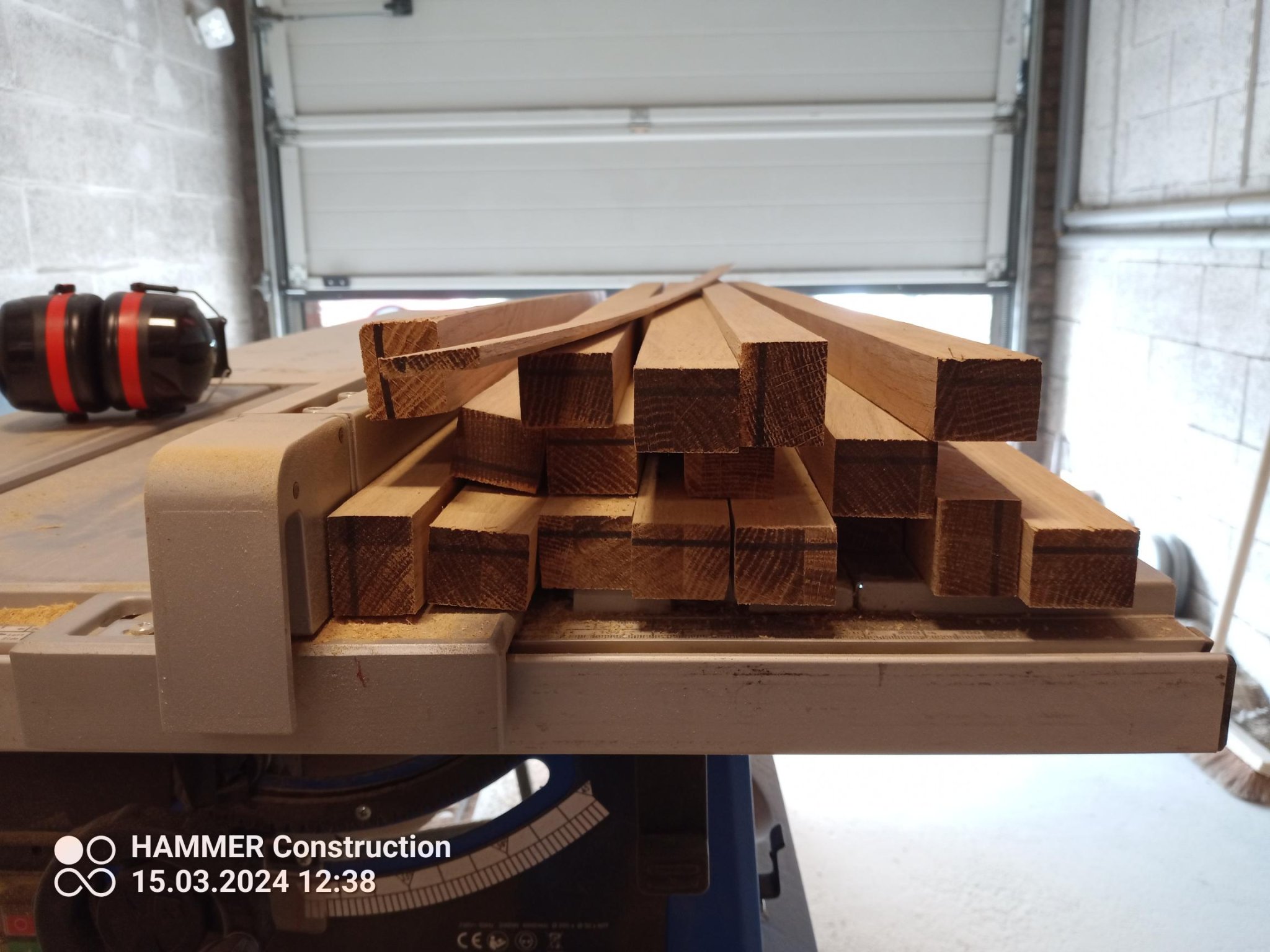

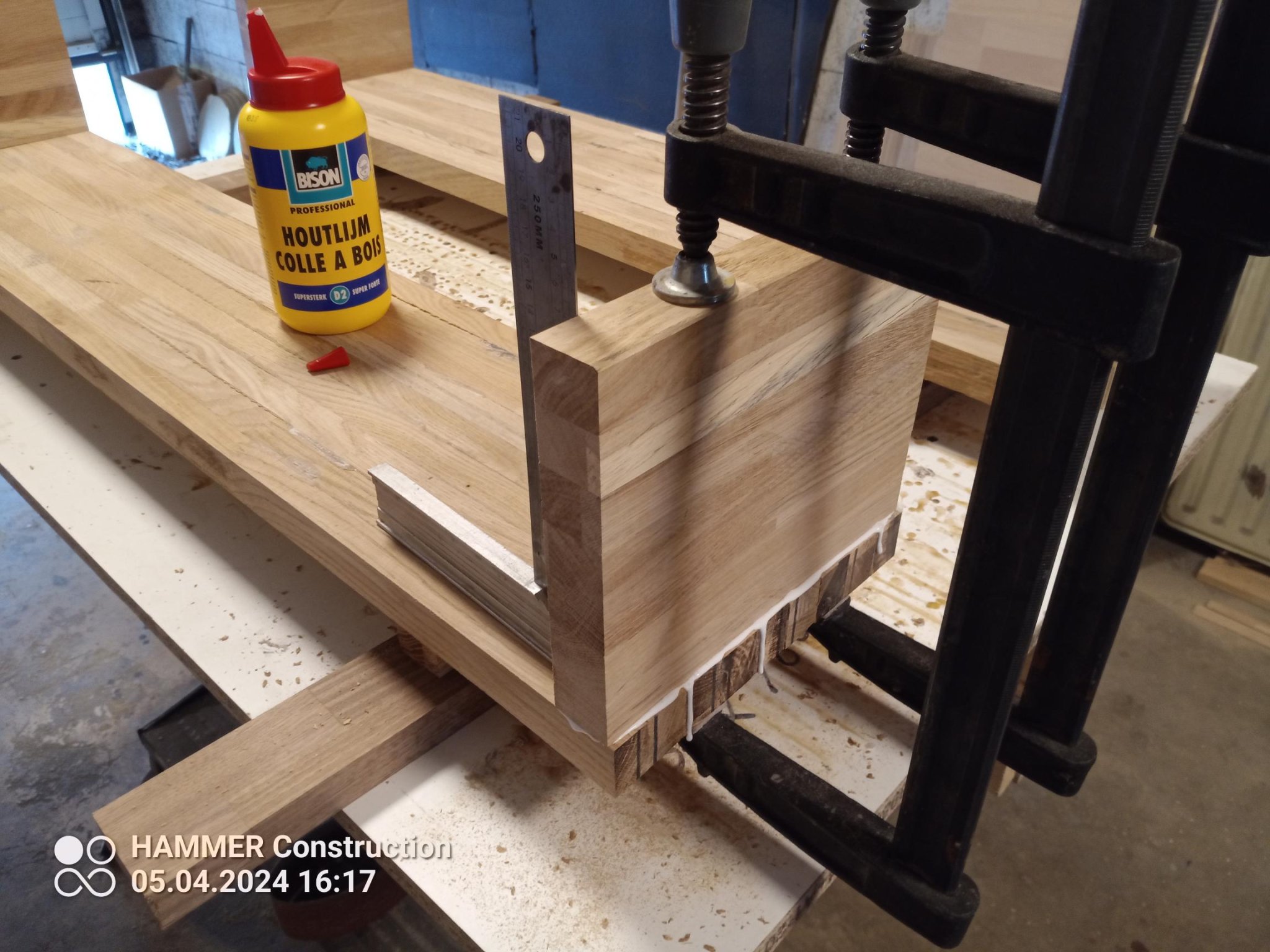

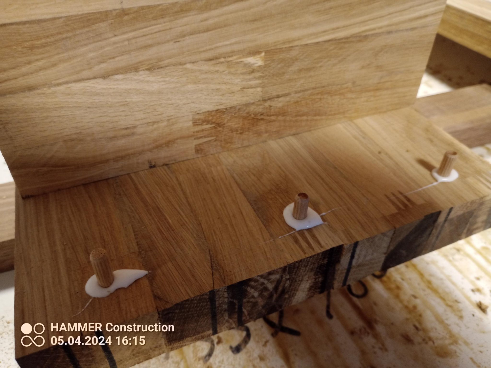

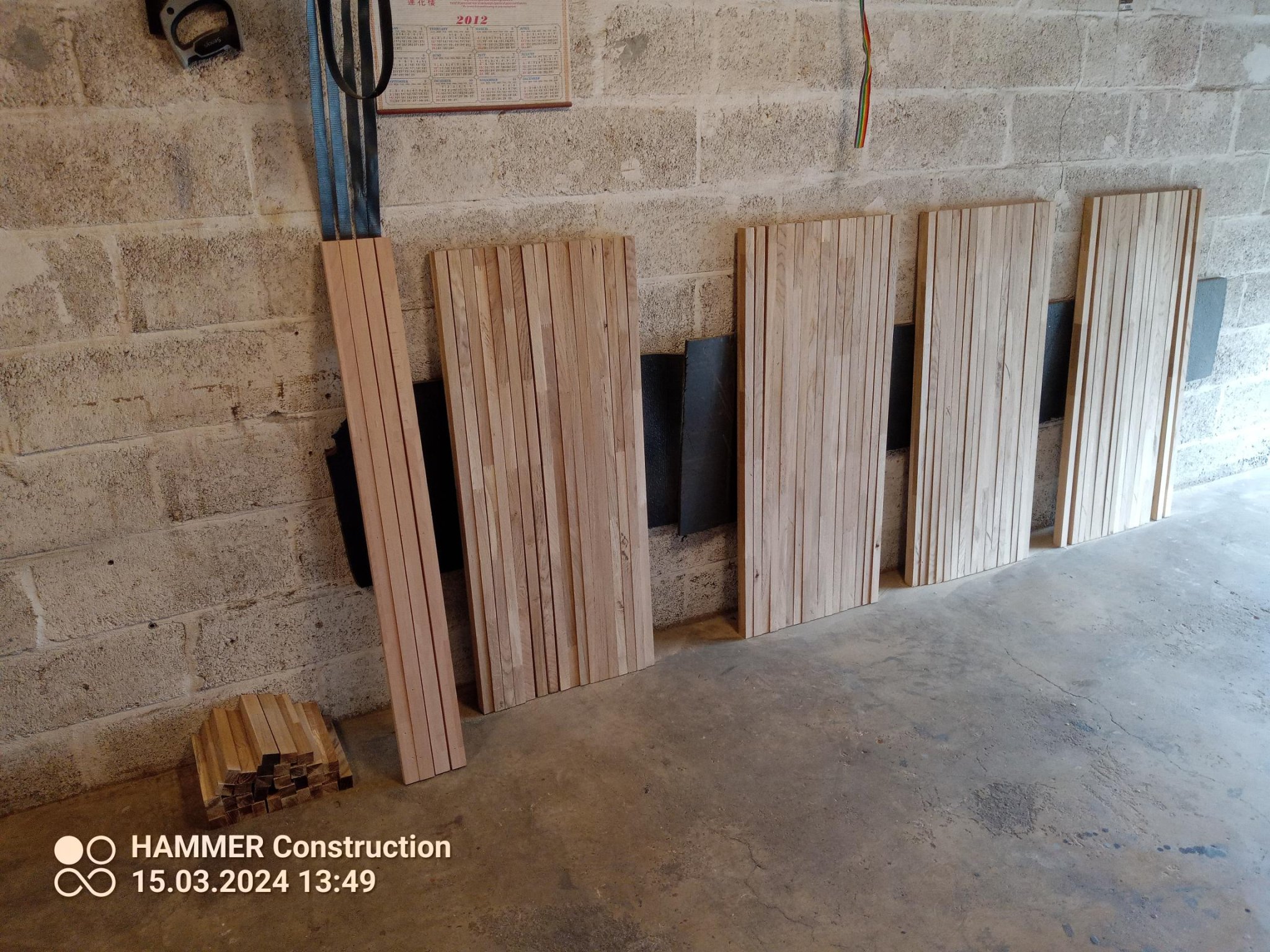

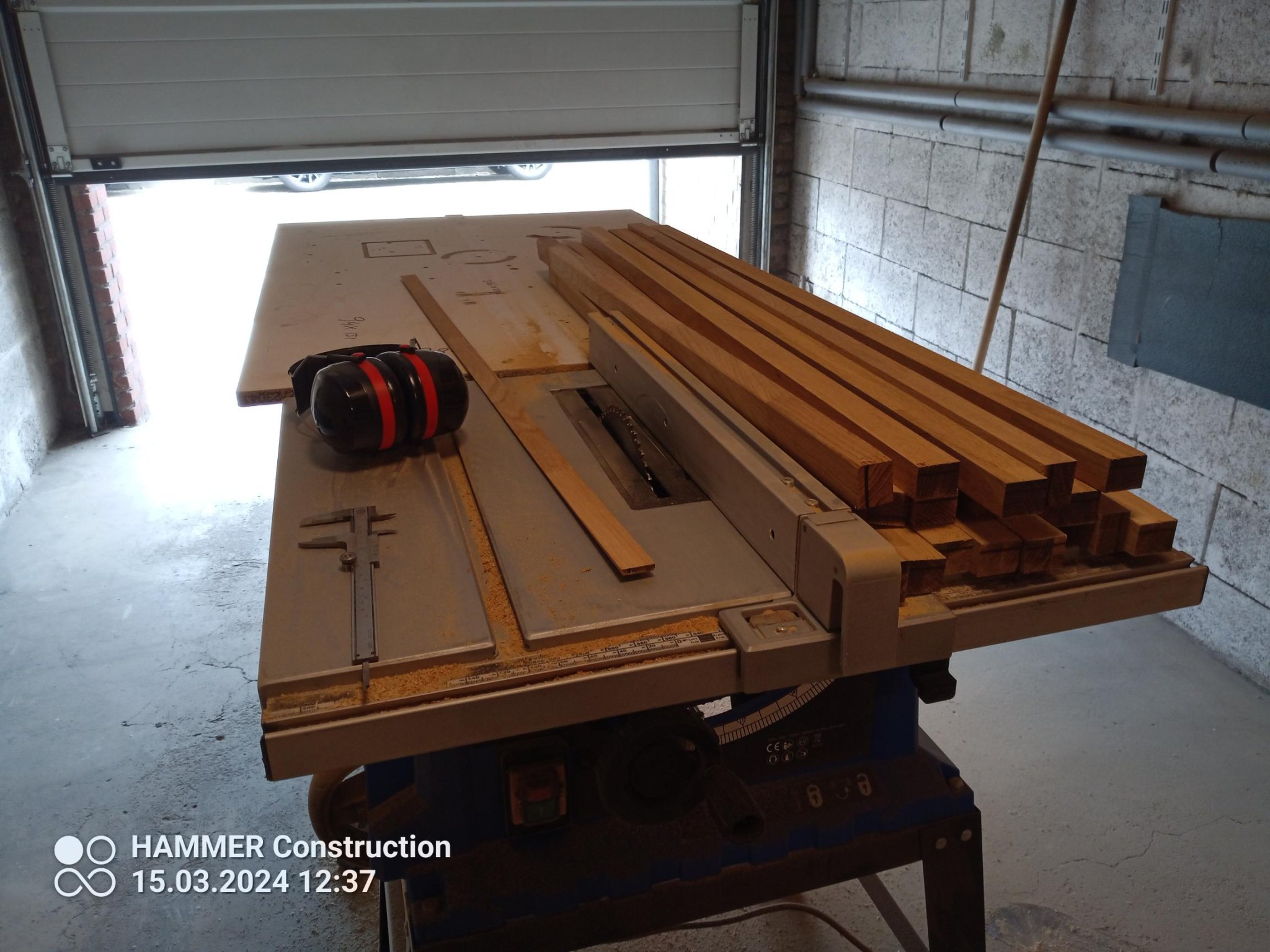

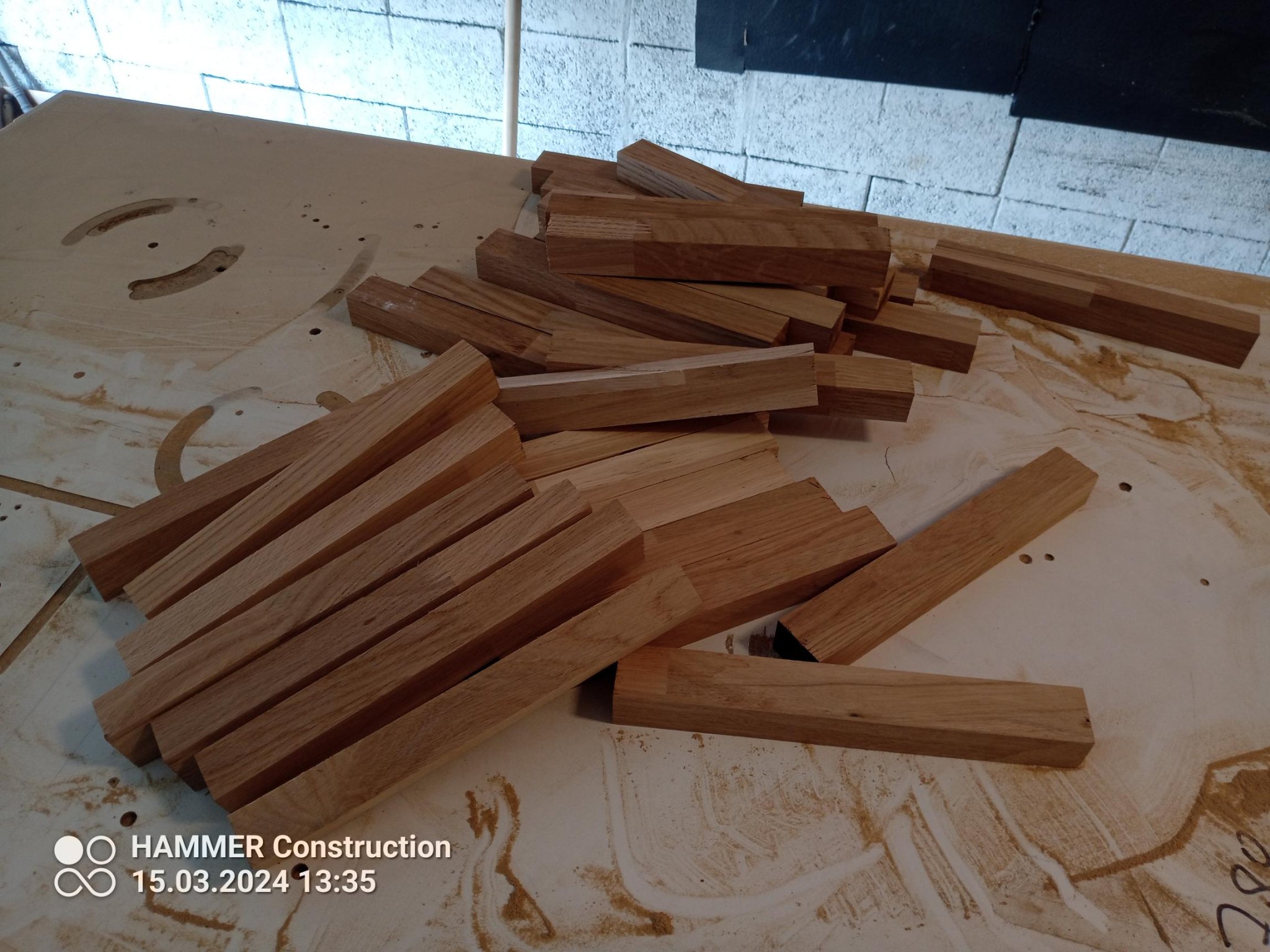

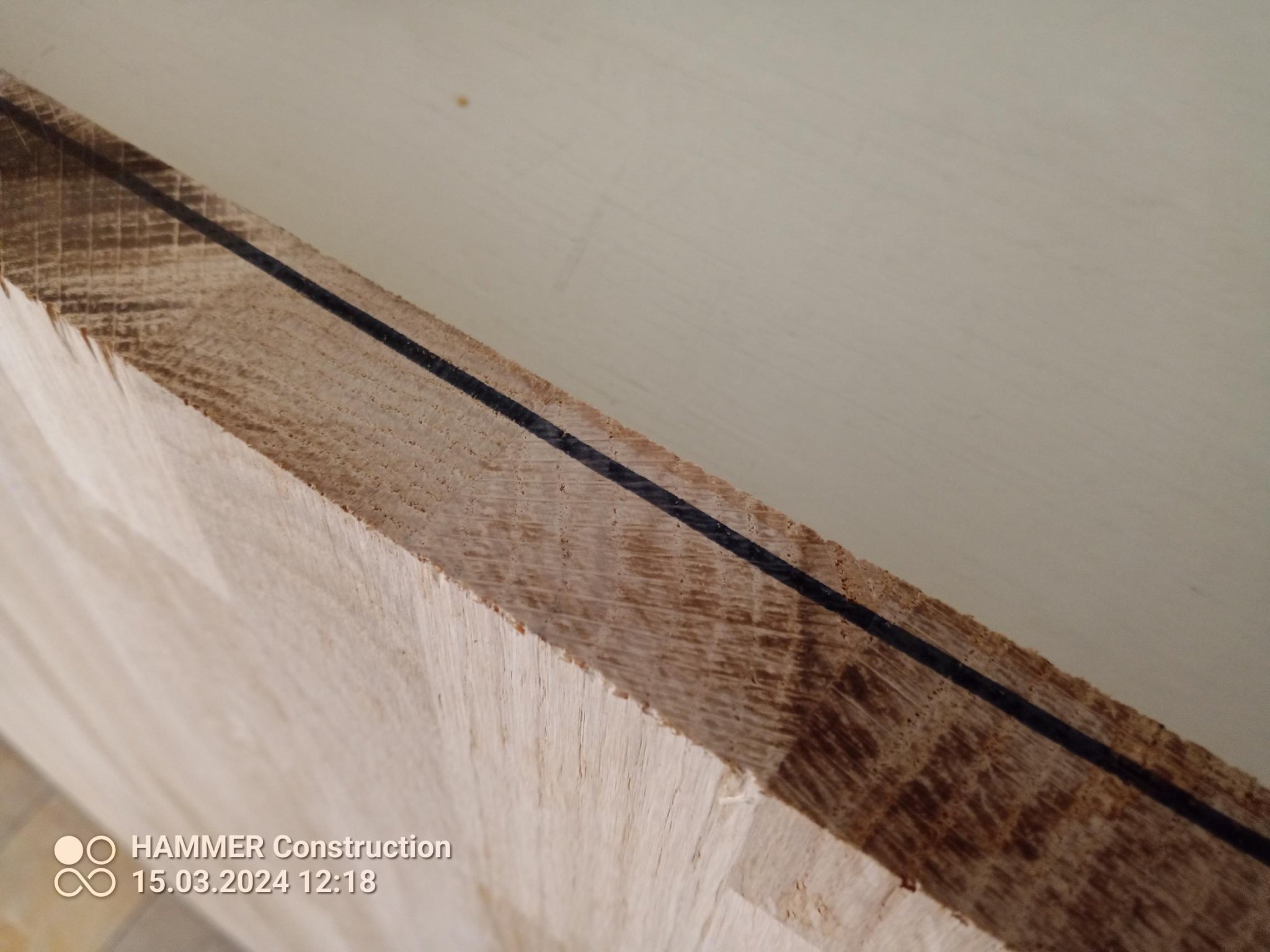

Sawn the 26mm solid Oak panels.
Thickness each about 33mm (1mm surplus to finetune later).
The next step is to glue the slats against each other alternately.
To do this, I marked the ends of the panels with a marker.
Reactions: 1 user
