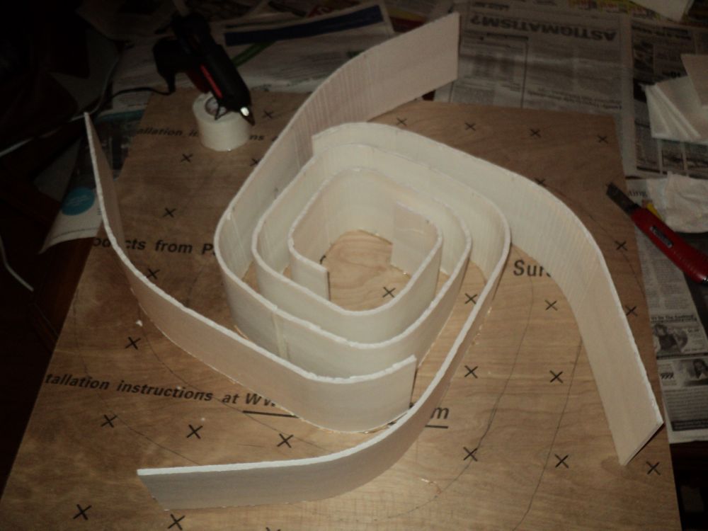

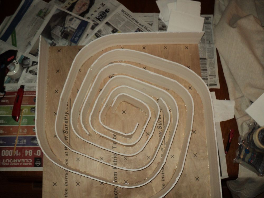

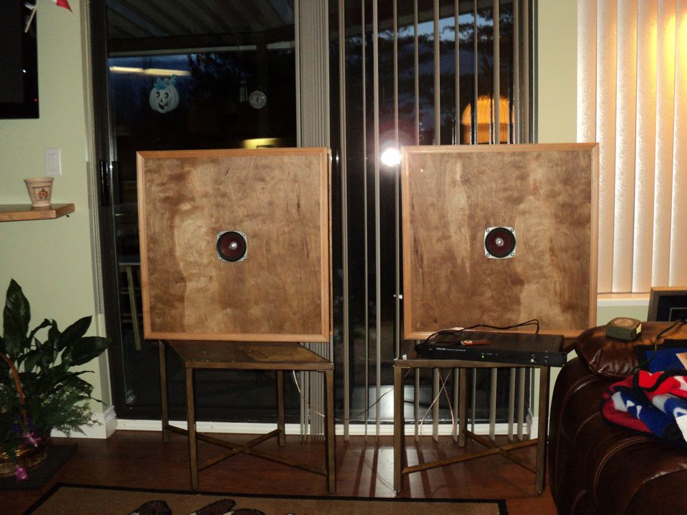

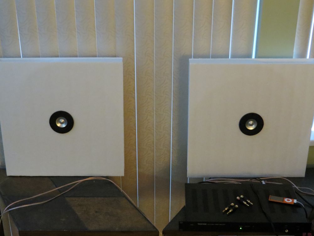

If you are looking to build, and you might run music through them as well, and you have a glue gun and a box cutter knife, along with a dollar store nearby, you can hardly do better than a Cornu style. They make even a cost effective driver shine. They are also easy and a very entertaining build

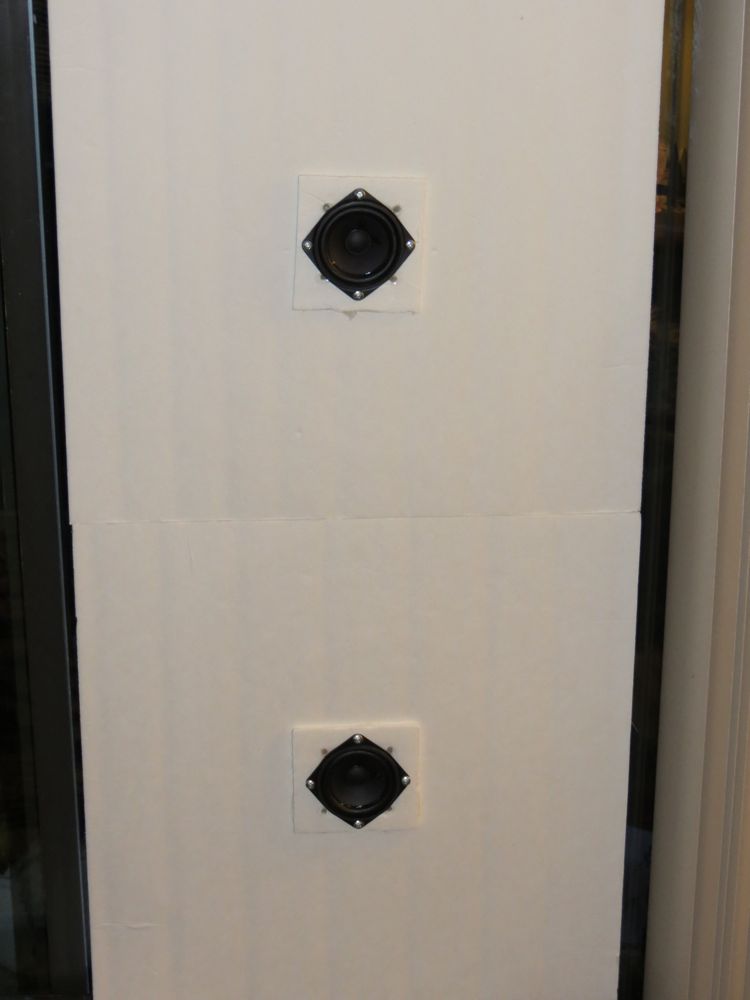

How thin can these be built?

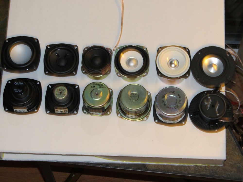

The smaller the drivers the slimmer it can be. XRK was the one who gave me suggestions on each build. He is good about responding in that thread.

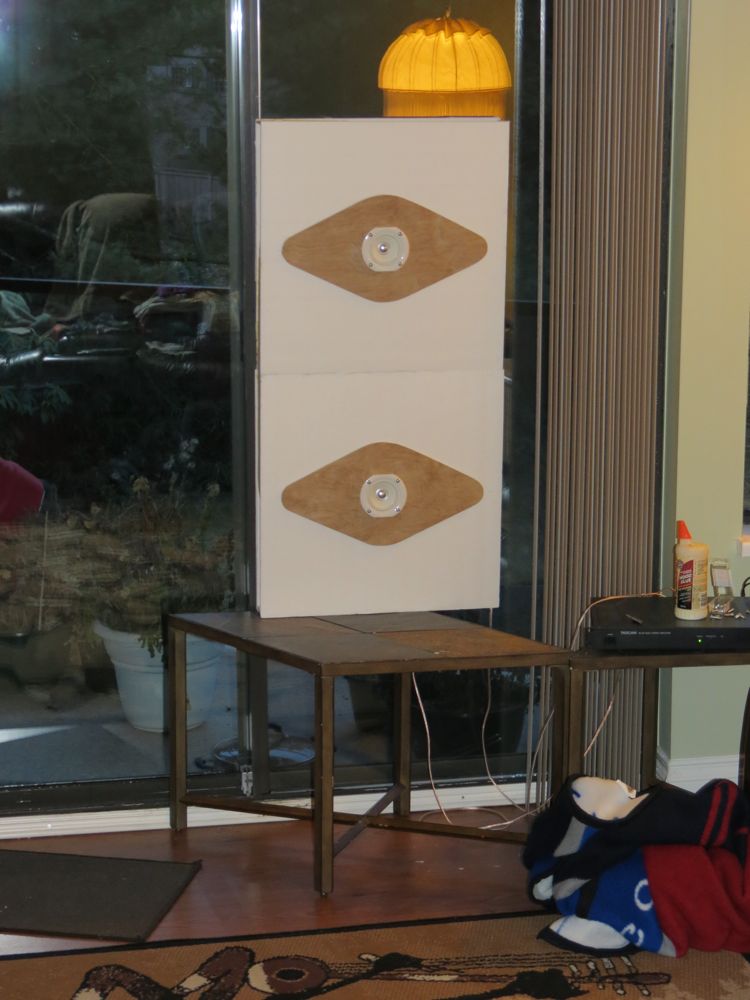

@Cal Weldon
are the diamonds in the first photos there to have something more substantial to which you fasten the drivers. or ... ?
Yes. Full wood baffle and back is obviously best but a number of these were prototypes. I made them from 20” up to 48”.

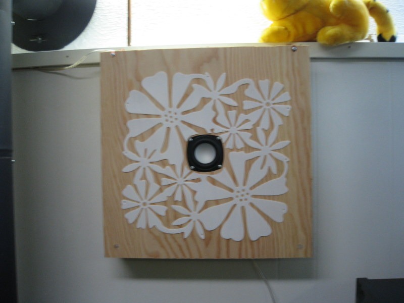

These picture frame speakers work pretty fine for nearfield listening. I think they would work well for surround as well. https://www.diyaudio.com/community/threads/dml-system-1-0.395246/post-7257014
