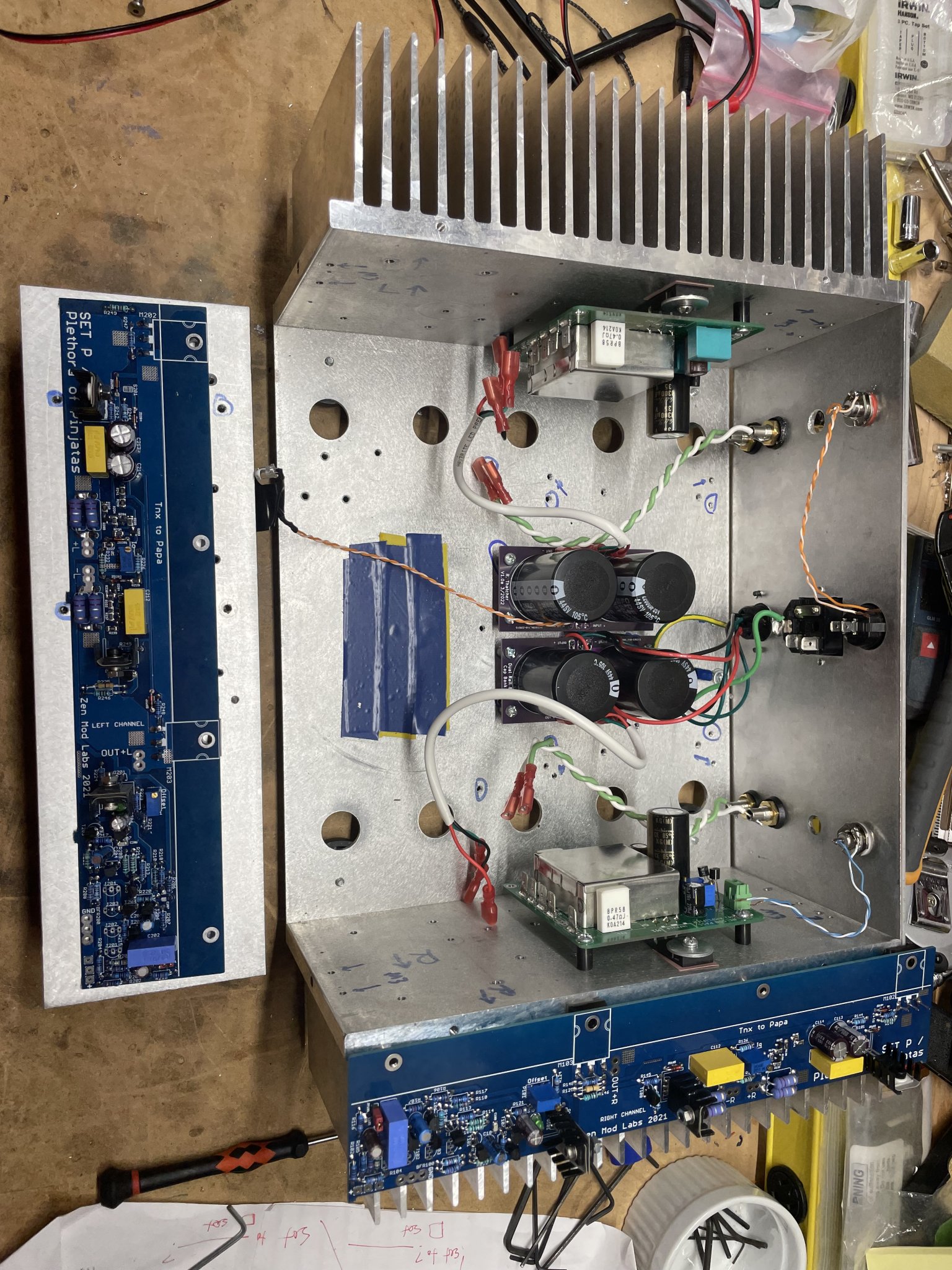

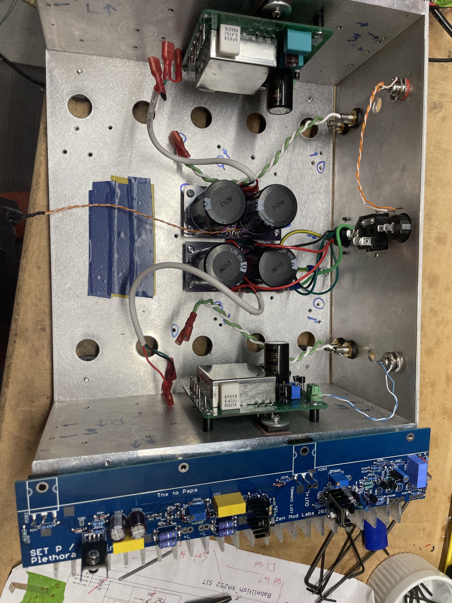

Boards done. I was envisioning installing these boards into a chassis that has M2 boards in it. The power supply is external. Oops! Chassis is not deep enough. Never fear, I have another rawson chassis that was waiting for a Juma F5 mini project. That one should work. It will get hot, but I’ll give it a go.

Joined 2010
^So says the guy with TWO SissySIT amps just laying around and a bunch of DMM... ;)
What did you do? Collapse the whole thing ( power supply and amps ) into a single chassis?
What will you do next? Build a 42 version? You know ZM has the 53 and 666 versions in the works.
The Kolosal Plethora of Piñatas...
With all of those amps around... have you given the thought of building a large, adjustable, power supply? Come up with a design like that would be most useful. I mean, do you ever run all of your amps at the same time? I know I can't given I only have two home runs ( 120VAC @ 20A each ) and the cost/heat would be over the top.
Maybe you'll be able to fit the Aleph 1.2 that way?
