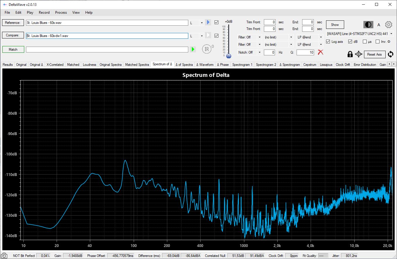

What may have gone unnoticed amidst all the noise is that the "null" reached in these recordings is remarkably good. That may be mostly due to the ADC and synchronization but no doubt Marcel's dac has something to do with it as well.

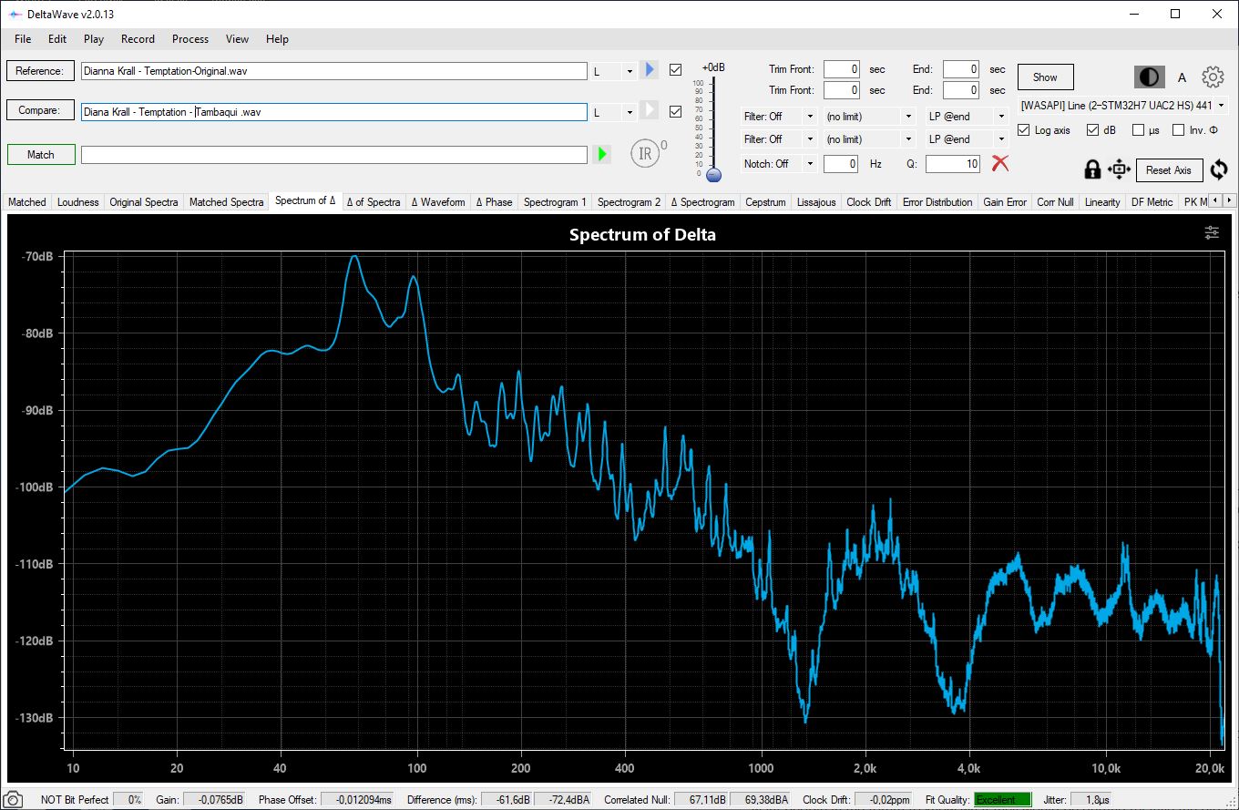

At ASR some member made a similar synchronized recording with Mola Mola Tambaqui and RME ADI-2 Pro as ADC. The DeltaWave "null" was quite different from what was reached here. Maybe the PLL clock in ADI-2 has something to do with it.

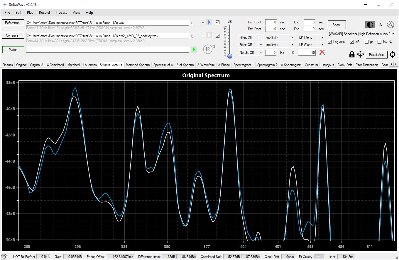

No question that a calculation can be done to match average EQ Magnitude over a fixed time period -- using FFT techniques bin by bin, of course.
But to what practical end? A calculation can be done to show the average shape and color of an orange and an apple has properties like neither the apple nor the orange did in the first place. So what?
EDIT: Marcel, do you believe merely adjusting gain and time offset in the time domain can perfectly match FFTs of two signals in the frequency domain that have clear and obvious different frequency distributions to begin with? Just checking to see if anyone around here would like to take a stab and explaining the math?
Who has suggested that?No question that a calculation can be done to match average EQ Magnitude over a fixed time period -- using FFT techniques bin by bin, of course.
There are members here who have quite a bit of experience on DeltaWave. Why don't you ask them?EDIT: Marcel, do you believe adjusting gain and time offset in the time domain can match FFTs of in the frequency domain that have different frequency distributions to begin with? Just checking to see if anyone around here would like to take a stab and explaining the math?

Not true. As I've said before if the matching of the waveforms in time domain is good the resulting frequency domain spectras will be well matched as well.so far that seems mathematically implausible.
Adjusting gain should only cause a vertical shift in a DFT plot that only shows the magnitude and does so on a decibel scale.
Adjusting offset will only affect the zero frequency bin and depending on windowing, some just above zero frequency.
Time shifting could drastically change the DFT plot if it changes the part of the non-steady-state waveform that is used for calculating the DFT. That's my latest guess, it would be nice if someone could confirm or deny it.
In my experience, how good of a null you can achieve is almost solely based on frequency response (magnitude and phase). Things like DC high pass behavior, frequency response ripples and non-linear phase filter response have a huge impact on the results. It is easy to a see a 40 dB improvement in the null by implementing a FIR filter to correct these frequency response deviations.
I agree that a -69 dB rms null is quite good.
