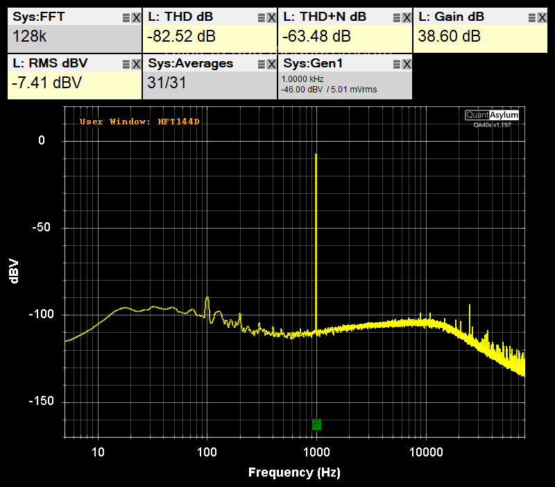

An issue with the OPA27 is that it has input bias current cancellation circuitry, meaning the current noise will be much worse than the datasheet figure in an asymmetrical circuit (such as any preamp basically!). For MM this is crucial for low noise at higher freqencies as the MM source impedance rises to high levels at higher frequencies (inductance of cartridge), so low current noise is important. NE5534A is still about the best bipolar opamp for an MM preamp, or go to JFET input opamps (negligable current noise) like OPA1656.
I have plots comparing noise spectra for NE5534A and OPA1612 (the dual 1611), using 500mH to simulate a cartridge, in a RIAA preamp:
OPA1612:
And NE5534A:
See how the large hump is very much reduced at higher frequencies, the OPA1612 is noiser from 1kHz upwards, manifesting as higher levels of hiss.

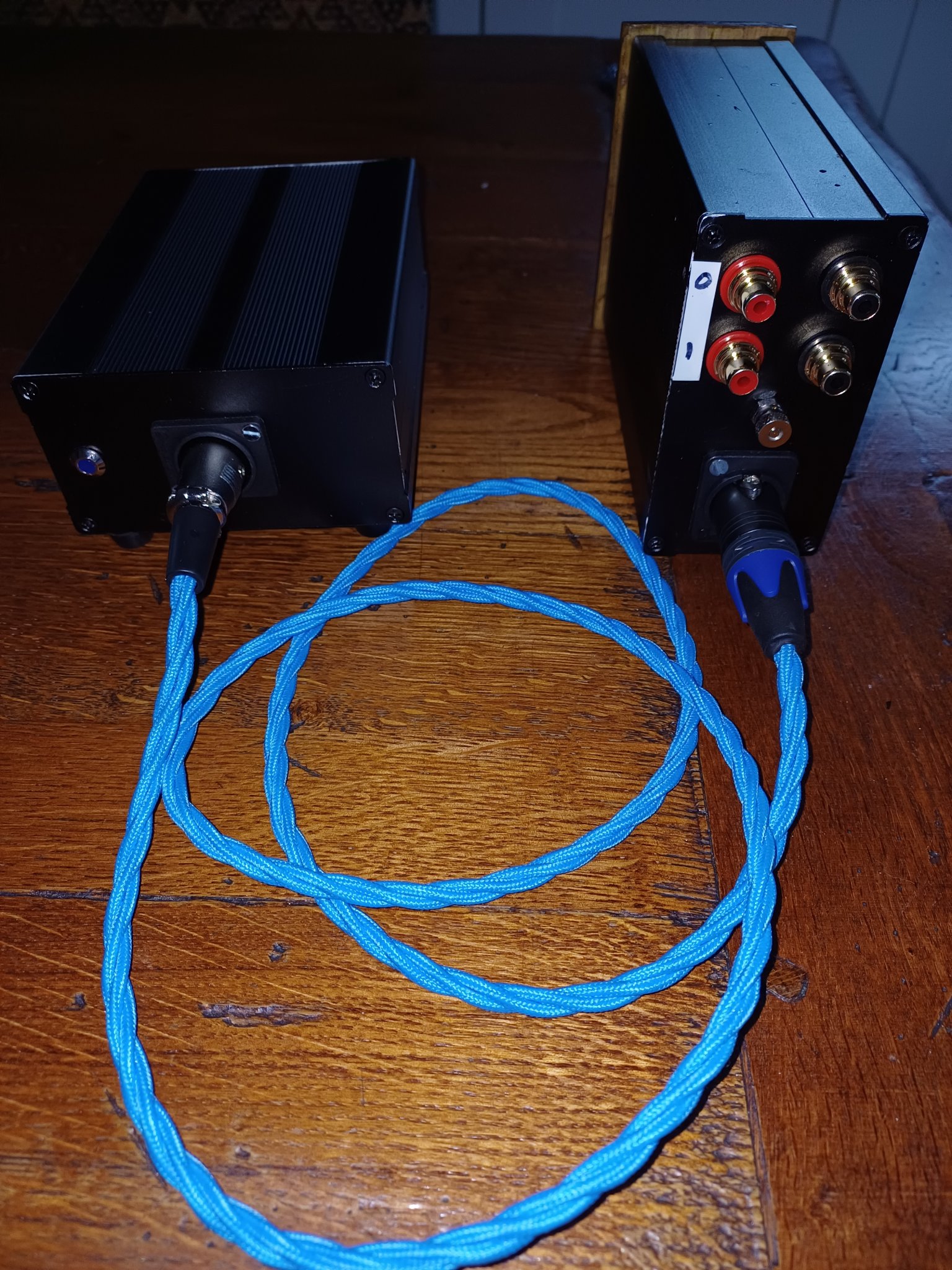

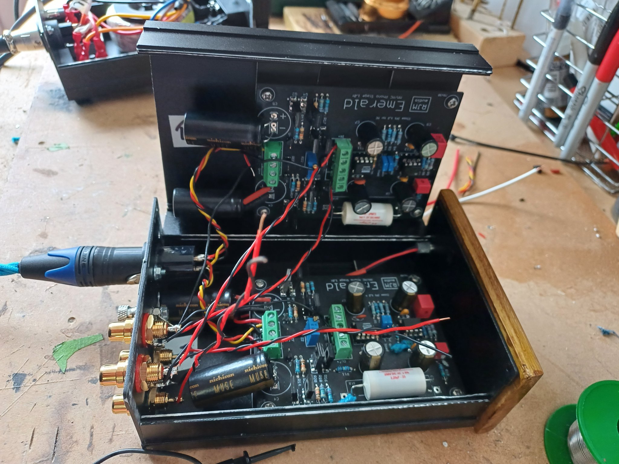

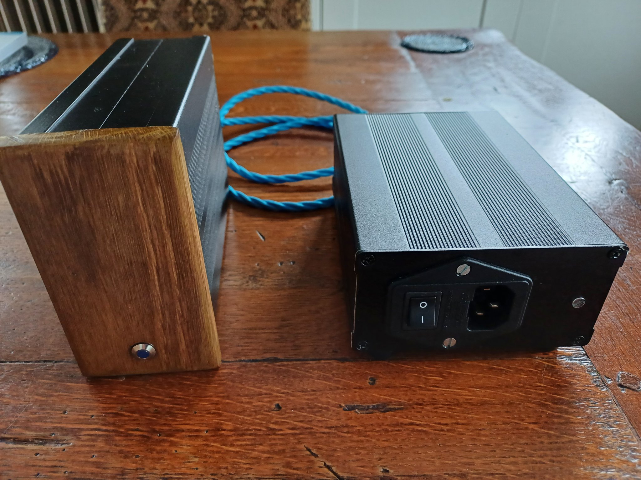

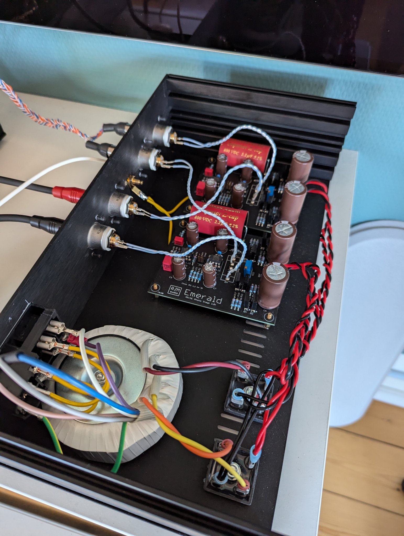

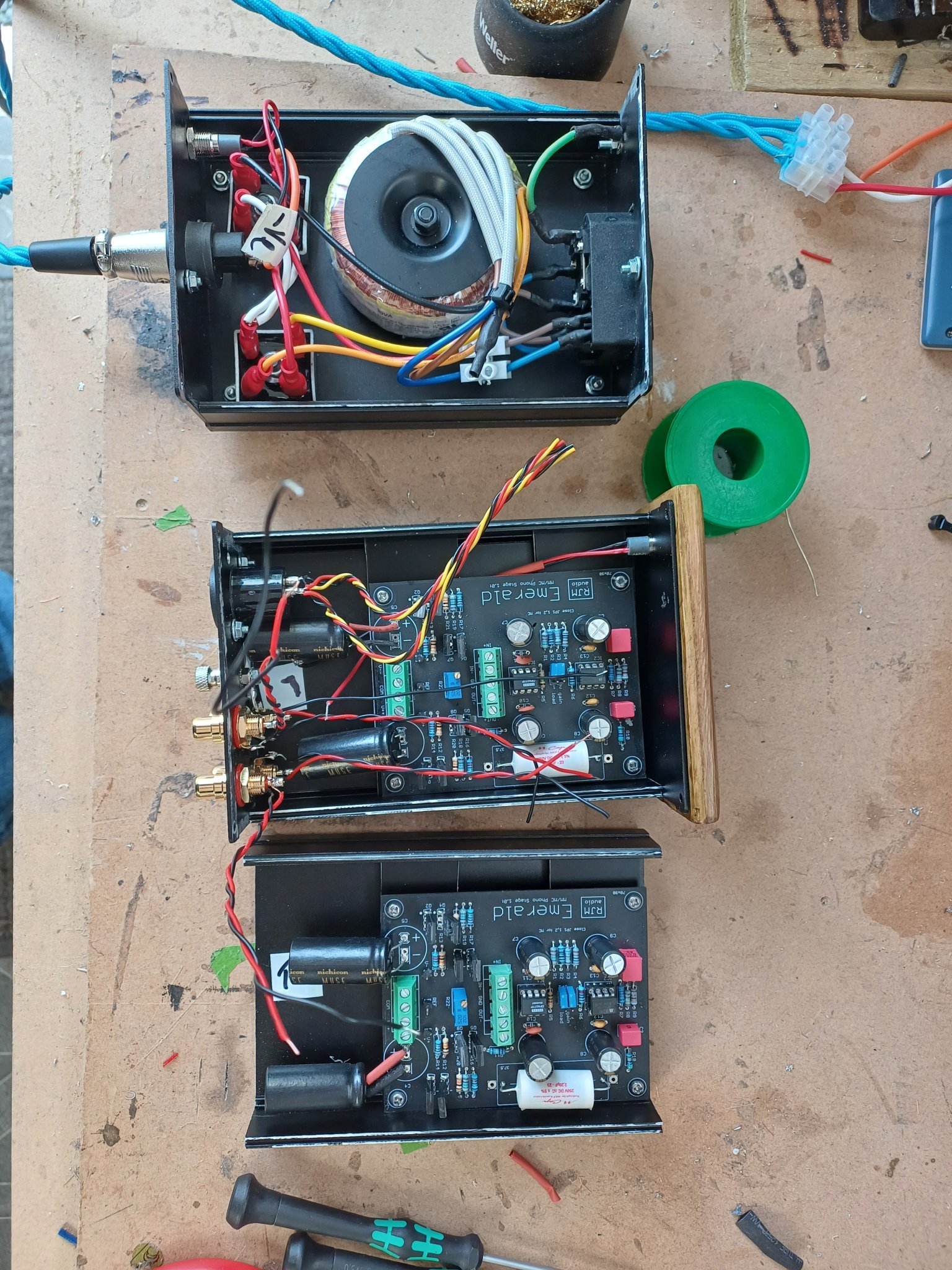

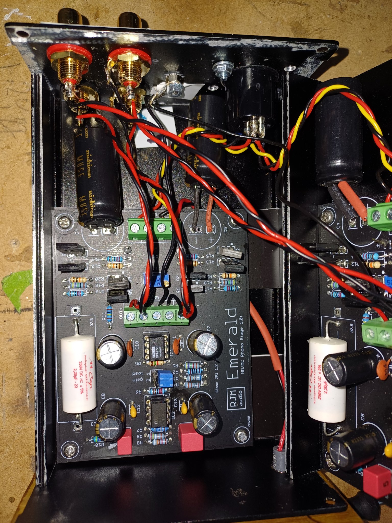

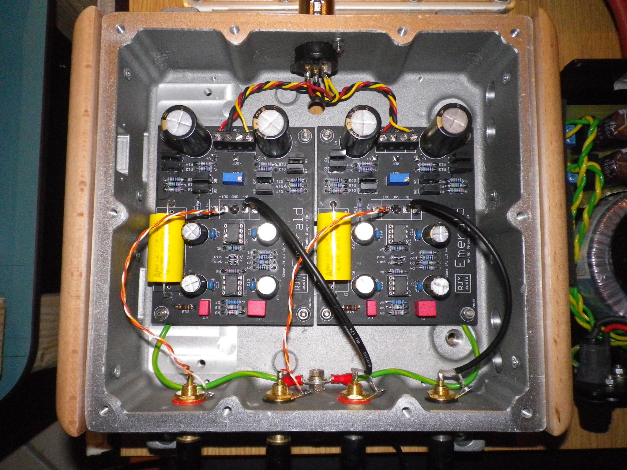

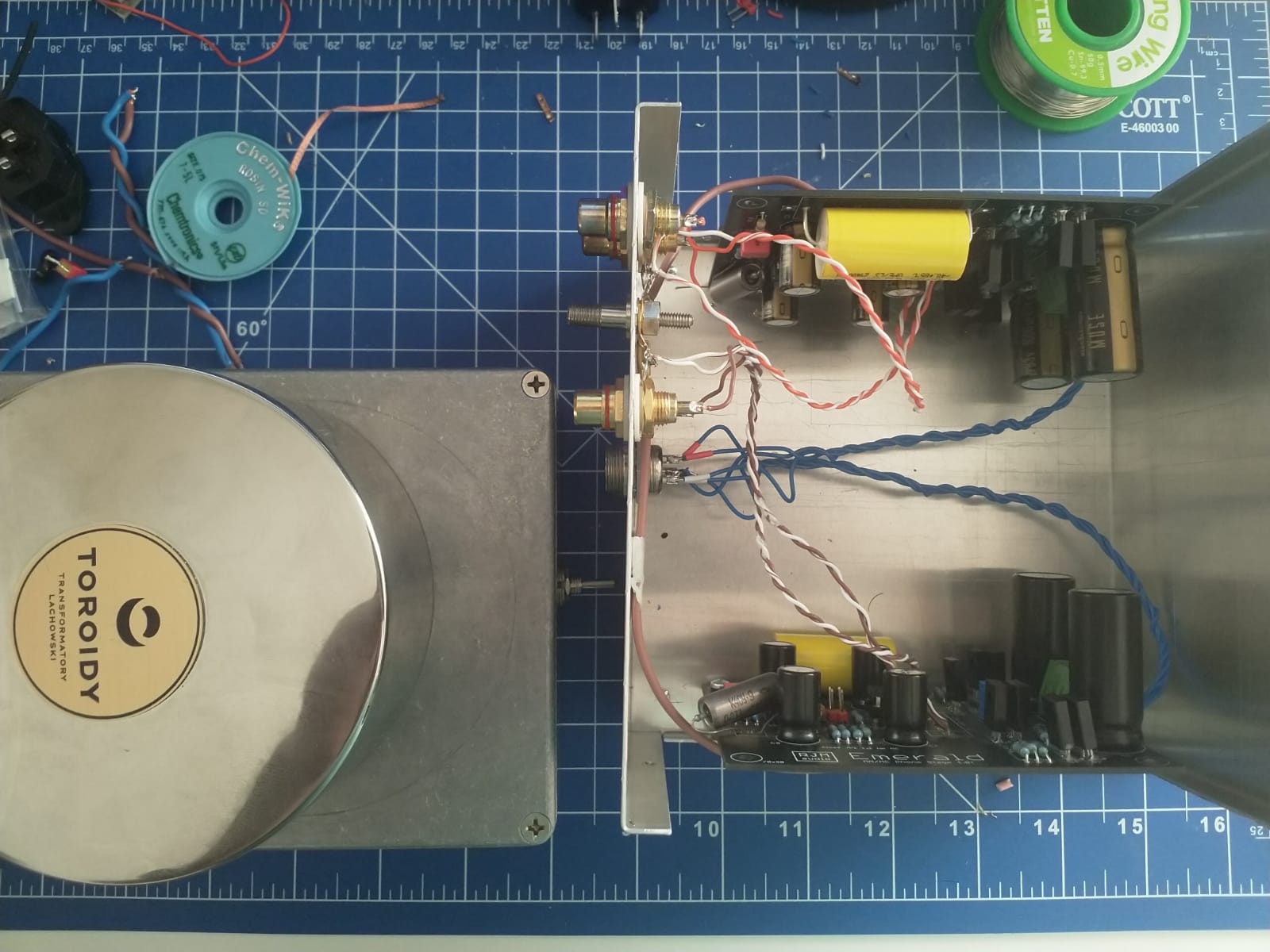

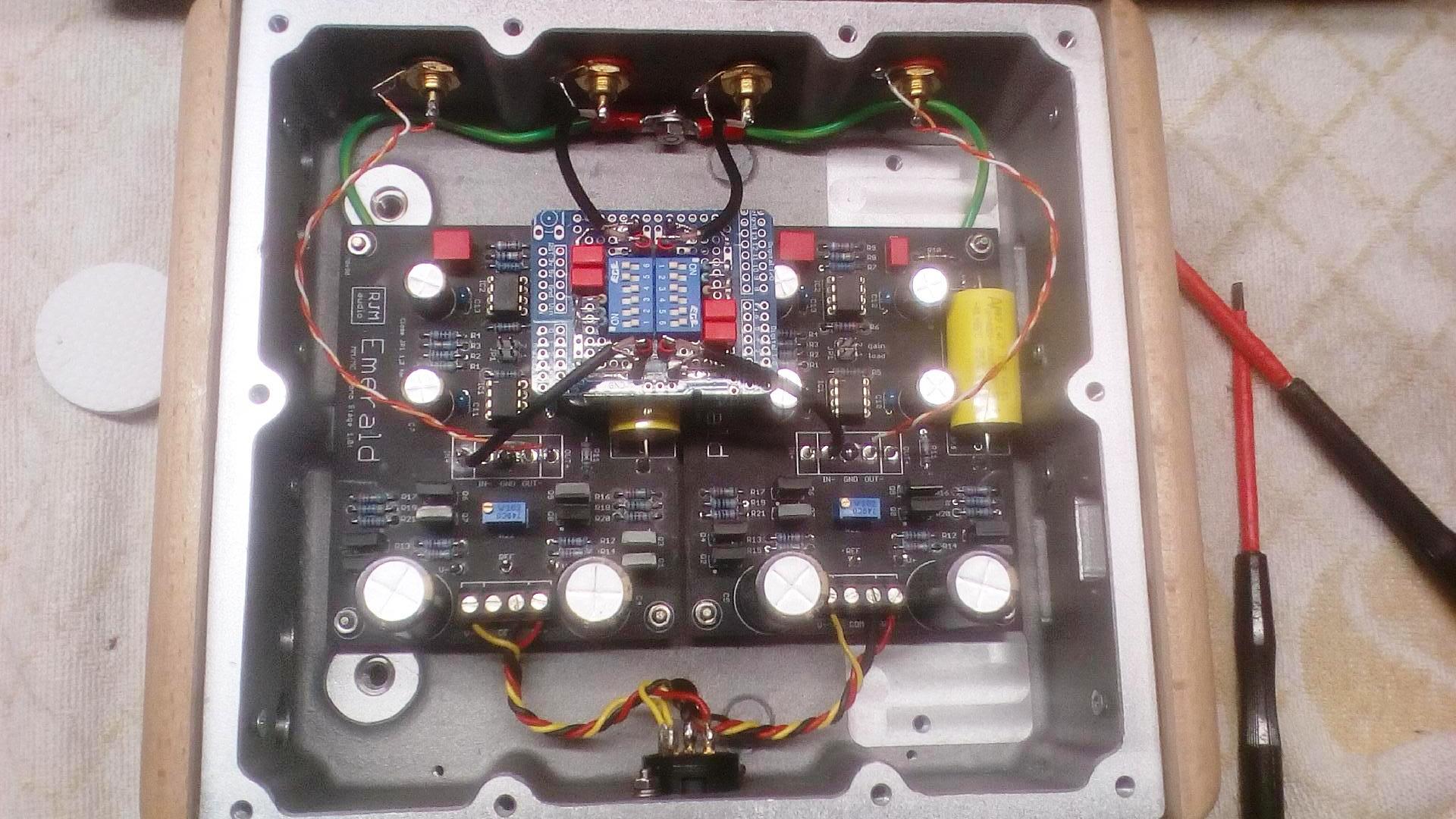

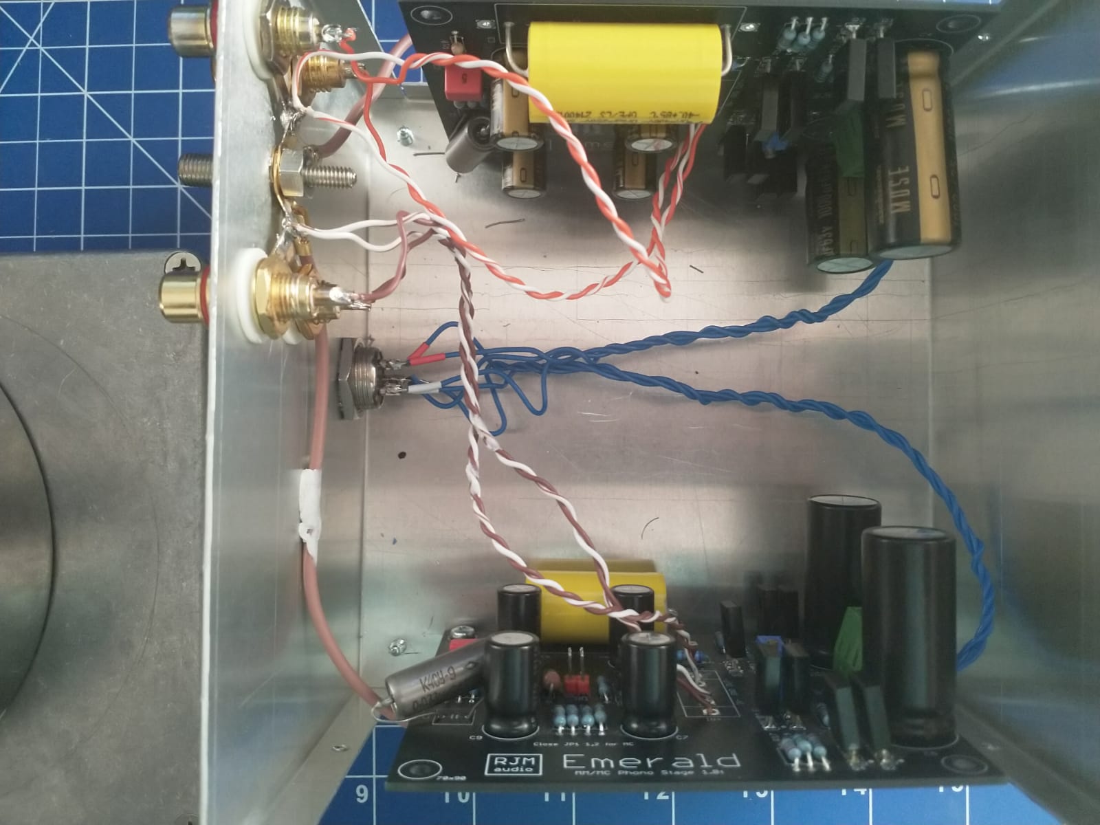

Hi All, just a quick post to share my build, I bought my PCB's August 23..
And only got round to building them up a few weeks ago! Everything went together very well with no problems, the build instructions are very clear and this discussion group a brilliant source of information.
Like everyone else I'm really please with the circuits and blown away with the result. And a complete improvement from the Pro-ject Box S I was previously using.
I've attached a few photos
