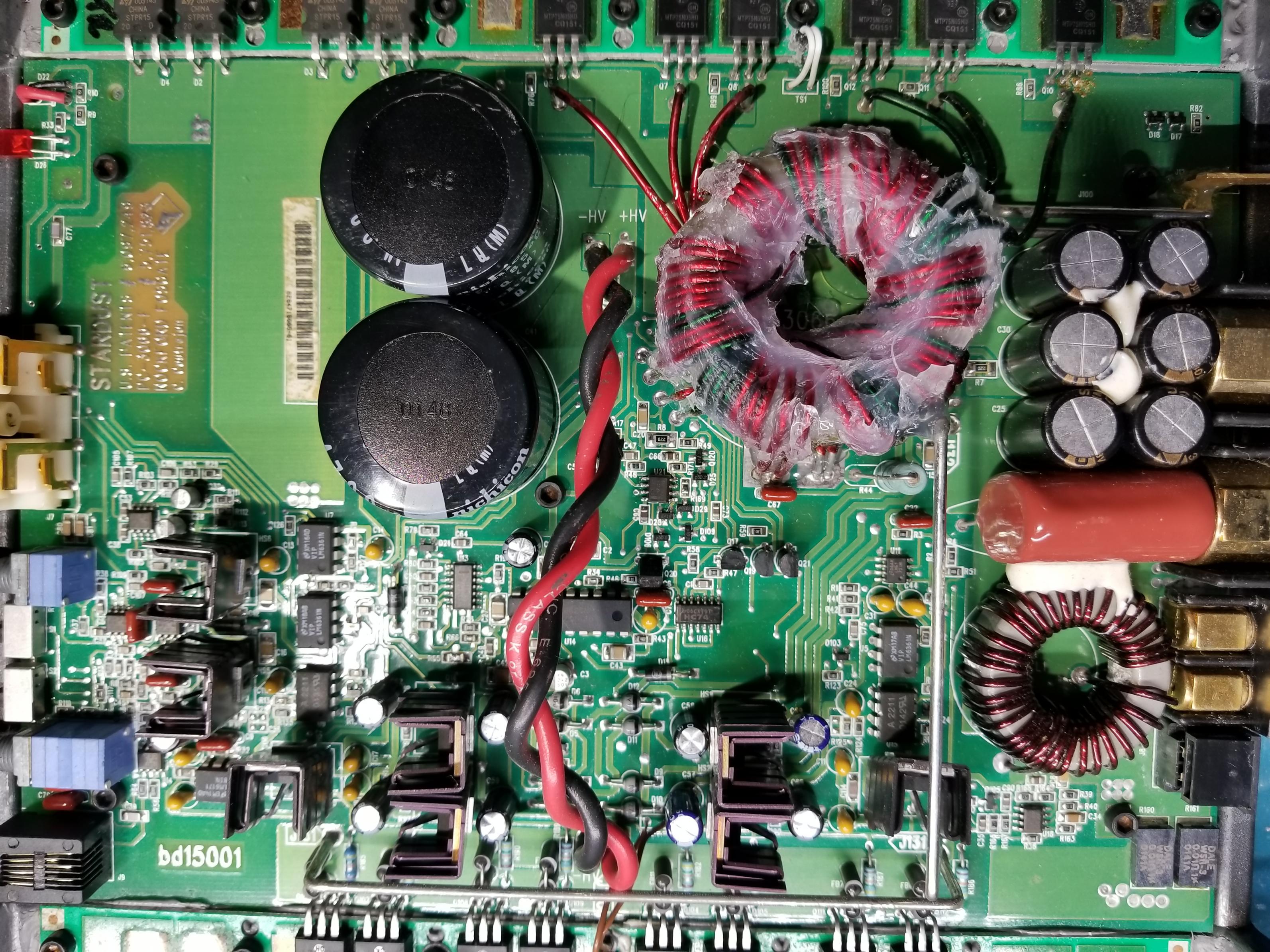

The amplifier sounds as if everything NJ is functioning as intended. Yet there is no audio output. I have oscillation, a healthy power supply.

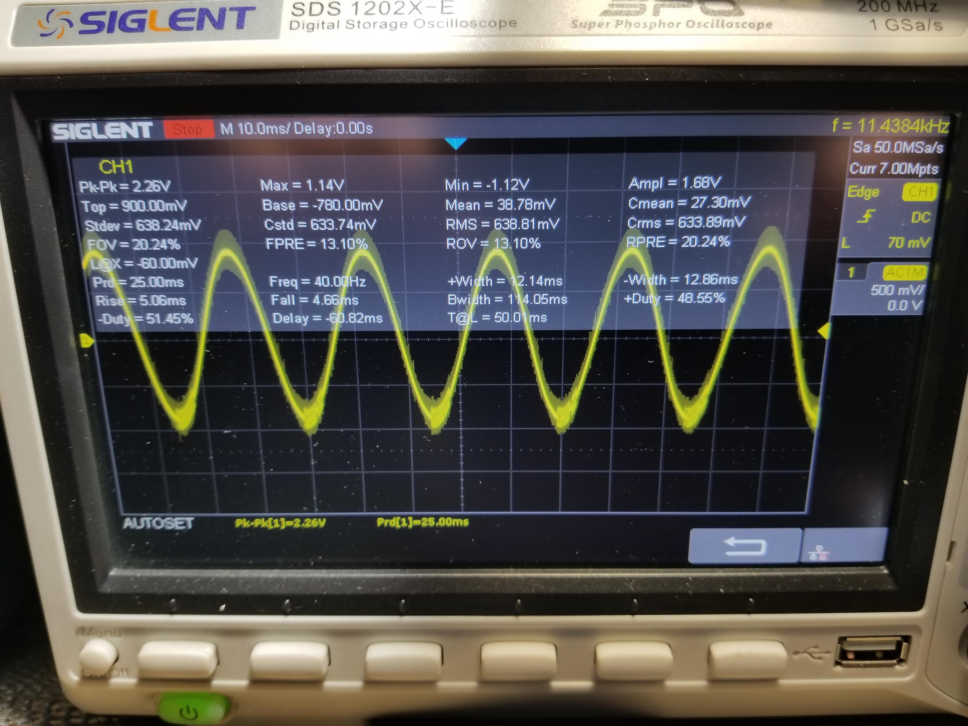

Does the amp make the noise with no RCAs plugged in?
Use a jumper wire to connect the RCA shields to the main ground. Confirm that you read 0 ohms between the RCA shields and the main ground with the signal generator plugged in.
This may not solve the problem but the amp is expecting a grounded shield from the signal source.
How does the noise (on scope and audibly) change with and without the jumper wire for the shield ground?
