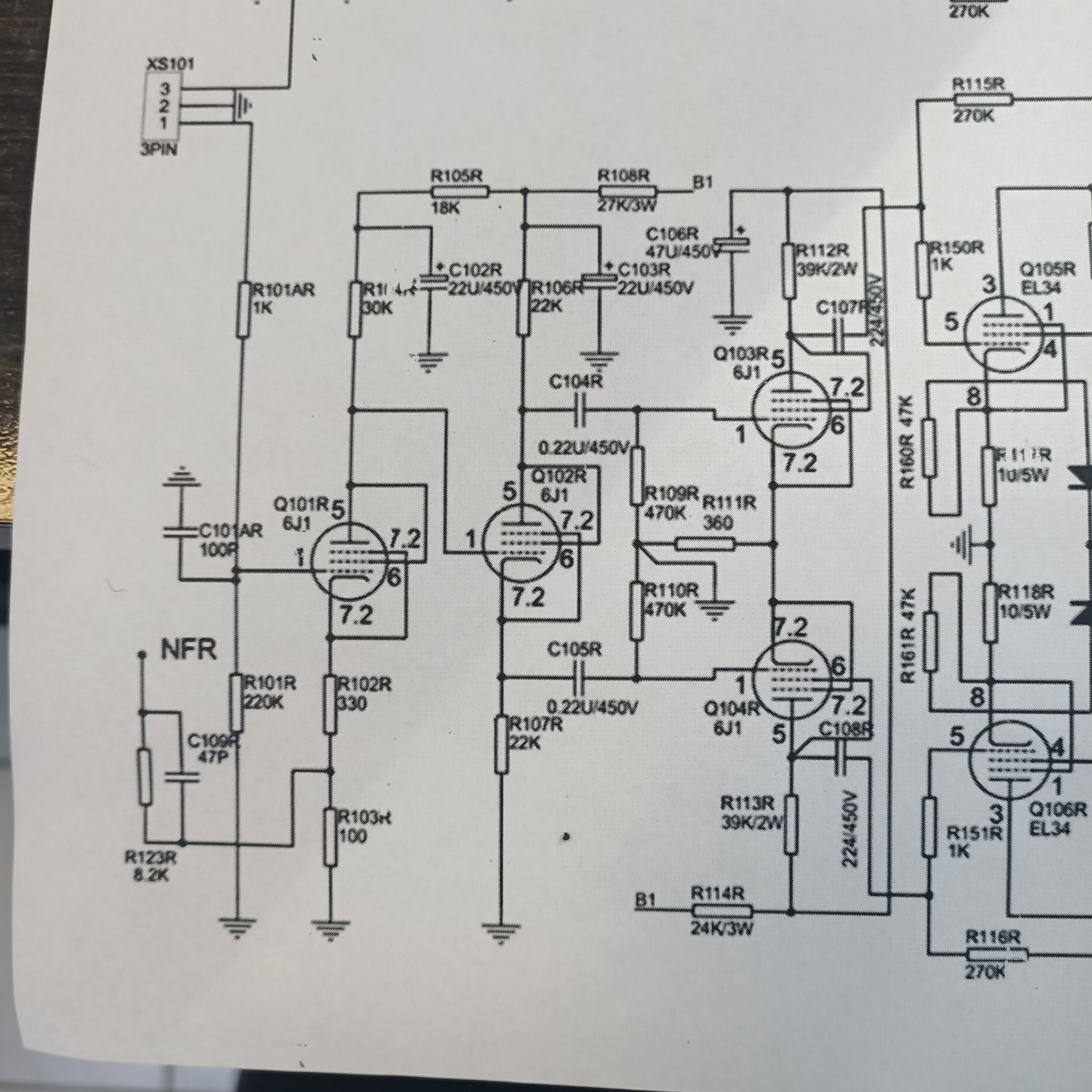

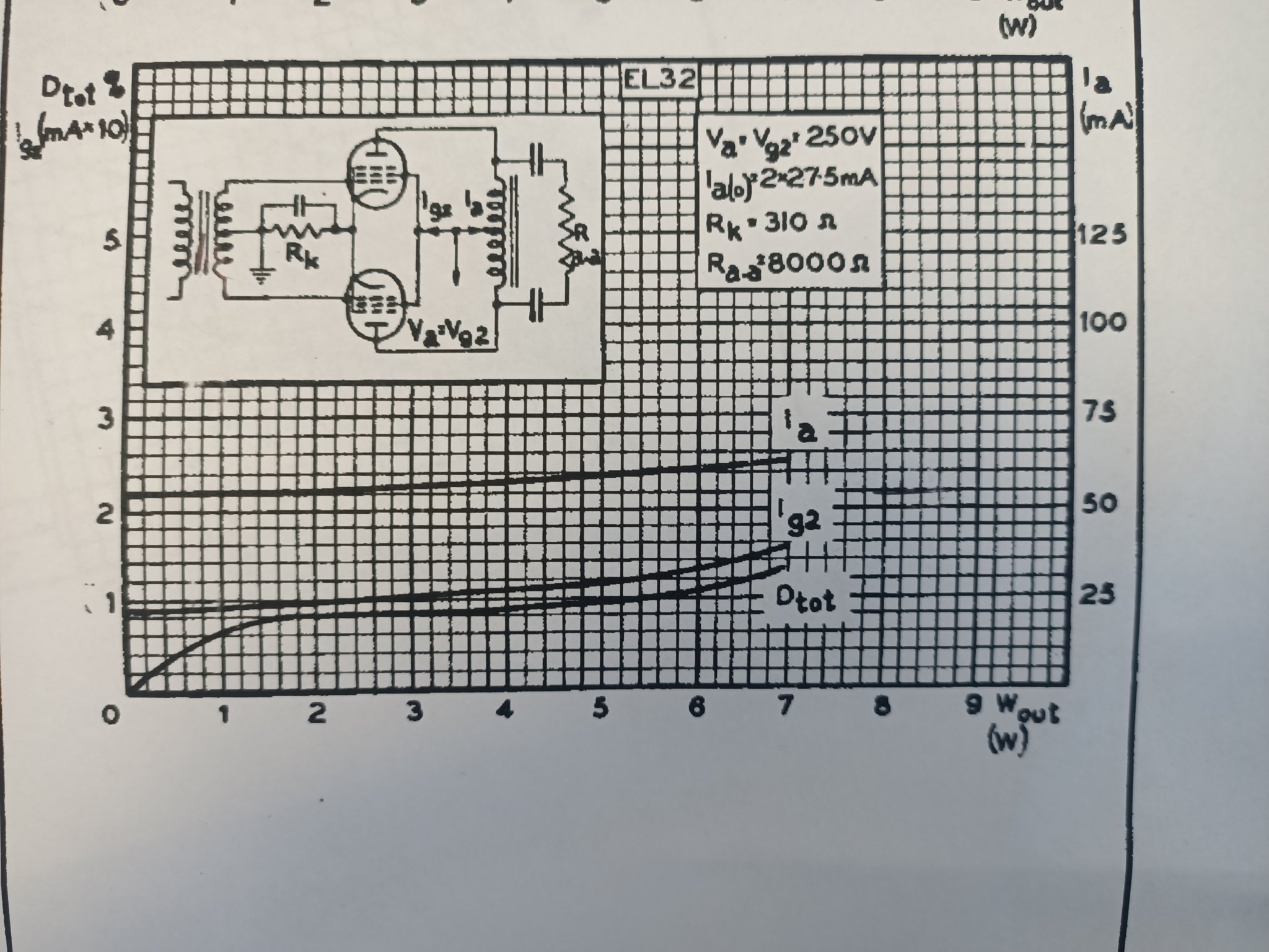

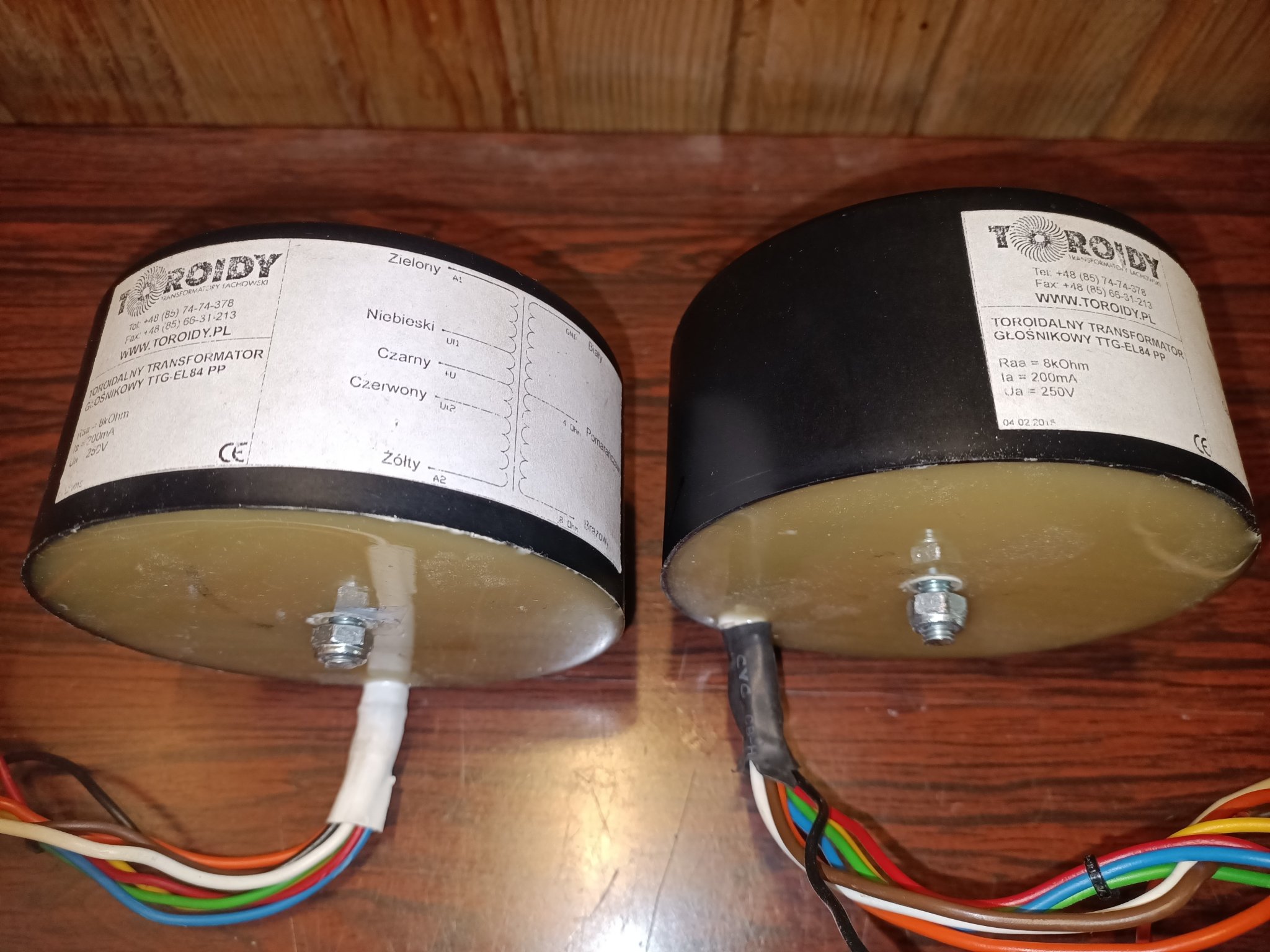

When it comes to tube amplifiers, I am an amateur. I have ECL81 at low voltage and EBL21SE (which requires a few corrections due to the hum caused by the glowing lamps). My next project will be a VT52 (EL32) push-pull with toroids at the output (as in the attached photos). As I have some new Russian lamps and the ceramic stands that go with them, I'm wondering if I could use them for the Schmitt and if they would be able to rock the VT52 Mullard

Jestem jeszcze na etapie poszukiwań. Przeglądam internet, próbuję coś samodzielnie policzyć... Na razie skłaniam się ku adaptacji części układu Yaqin MC30, który opiera się na tych lampach. Oczywiście to nie Schmitt, ale to sprawdzony system i działa.
Are you talking about Rk?I just can't find out how to calculate the resistor that polarizes the control grid of the power tube.
I'm also thinking about changing the concept. Due to the fact that I have 4 SE 7k transformers from UHER reel-to-reel tape recorders, I would make 2 x VT52 SE if I could find inexpensive tubes that, with an 8k push pull transformer, would give me more output power than, for example, a pair of EL84s
