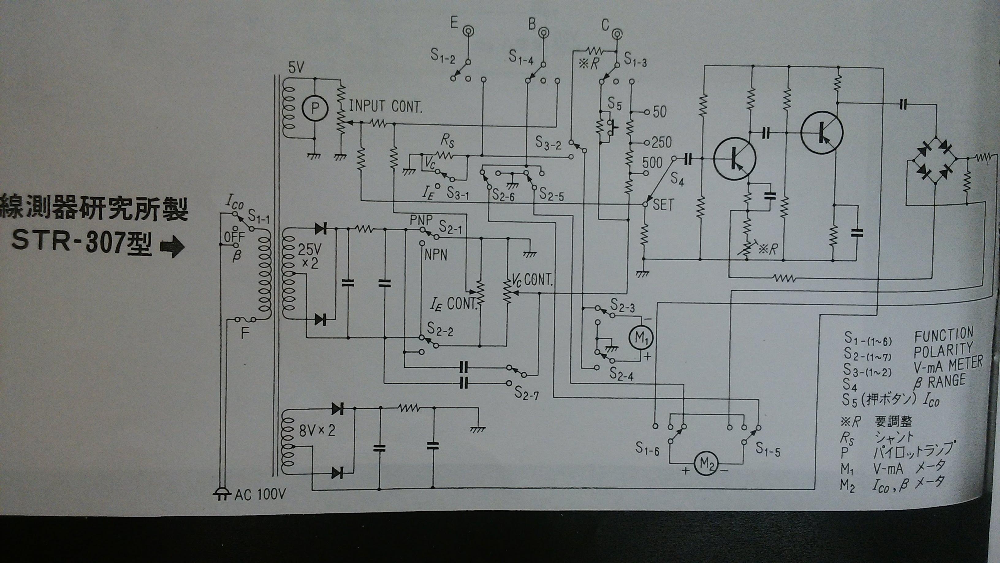

I've attached circuit diagram of solid state version. Unfortunately there is no register values, capacitor values and model number of Transistors.
But you can know all values by checking your real equipment.
Last week I got vacuum tube version at surplus shop in Tokyo Akihabara and then went to National Diet Library to find the article on "TRANSISTOR GIJYUTU (Technology),1968, March" magazine.
Please refer to some translation words as below when you see the circuit diagram.
S1-(1~6) FUNCTION
S2-(1~7) POLARITY
S3-(1~2) V-mA METER
S4 β RANGE
S5(Push Switch) Ico
*R (need for adjustment)
Rs (Shunt Resistor)
P (Pilot Lamp)
M1 V-mA meter
M2 Ico, β meter
