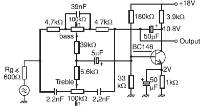

This might be the simplest active tone control circuit, but is there a way to modify the gain and frequency response?
The circuit as given gives a gain of +/-20 dB which I think is huge and distorts given today's digital sources with 1vpp output.. Is there a simple way to modify the gain to +/-10 dB?
1. What is the effect of reducing the variable pots 100k to 47k?
2. What is the effect of replacing the Emitter resistor 1k and connecting to ground?

Here is some design info, use figure 12, which is a better circuit: https://sound-au.com/dwopa2.htm
Reducing the pot resistances would raise the frequencies where the tone action starts.
The range of bass adjustment would also be reduced a little.
You don't want to short out the emitter resistor, since the circuit would not work.
And the 1k is bypassed at signal frequencies anyway.

Yes, look at figure 12 in the link.
The series resistors with each pot determine the amount of gain/cut.
Increase them all proportionately, until the gain/loss is what you want.
Don't change the pot values.
To change the frequencies as you describe, change the capacitors. Bigger for bass, smaller for treble.

I see two variants of baxandall, one in which a single treble capacitor is connected to wiper and other in which two capacitors are connected on either side...Which one is preferred
There are really four variants. On the bass side you can have one capacitor shunting the entire pot, or two meeting at the wiper. On the treble side you can have two capacitors, one leading to each side of the pot, or one capacitor in series with the wiper.
At this point I am going to refer you to the National Semiconductor Audio Handbook, 1976, pp 2-44 to 2-48, which you will find online, or the Tone Controls chapter in Douglas Self, Small Signal Audio Design, for a full discussion of the differences. They aren't great but they affect the calculations. The choice may simply come down to cost.

I have noticed that this tone control does a high midrange boost,which I don't like, If I want the bass boost to happen only below 100 hz and the treble boost only above 10khz, how to Modify for that...
My main complaint with 99% of tone controls is the bass accentuation that was normally designed in above 100Hz. A few extra components plus a switch could have made it frequency selectable.
Feel free to check out Doug Self’s preamp from Linear Audio (volume 5) to get some ideas for a really interesting tone control. It’s frequency selectable using a potentiometer. At full boost the tone stack doesn’t clip until about 4.7V peak input.
