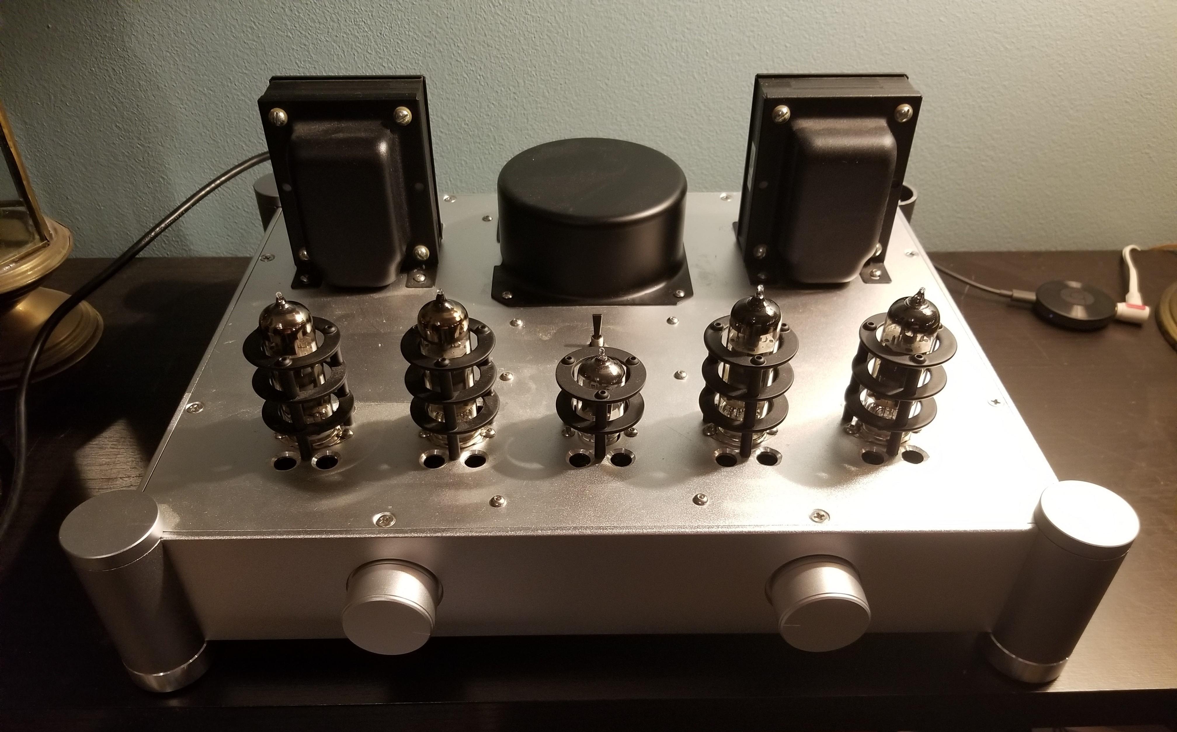

So, I built a Broskie Bastode…
…and I love it.
A bit of background: I started this amp about a decade ago. All I knew was that I wanted an Ultralinear push-pull EL-84 amp. The design began as a self-splitting output stage driven by an op-amp. It then changed to being driven by another EL-84. It changed again to a very traditional design of a grounded cathode, concertia phase splitter, and traditional grounded cathode output. I ended up going that direction with this amp I built for a friend:
Just what the world needs - another EL84 amp
I’m the kind of person that wants to try something new and didn’t want to repeat myself, so the amp morphed into a DAC directly coupled to a 6N1P differential amp, followed by a differential output pair. Progress stalled as life got hectic. About a year ago I decided that I was going to get this amp done. I had recently read Broskie’s blog on the “Bastode Aikido FET amplifier” here:

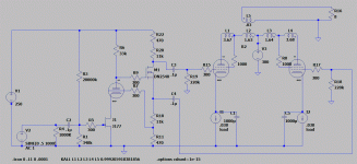

I fired up LTSpice and changed the input tube to a 6N1P (my favorite little small signal triode). I adjusted a few values to work better with the 6N1P, and then decided that the follower in the circuit was going to have to do double duty to earn its keep. I changed it to a concertina type phase splitter, and used a voltage divider on the bottom of the concertina to act as both a bias and feedback for the 6N1P. I also replaced the tube in the concertina splitter with a MOSFET (a FQPF2N80, I don’t have a LTSpice model to show it on the schematic) because in a follower role, it does everything better. Much greater transconductance, less internal resistance, greater voltage swing, no heater power or heater lift needed, electrically insulated package, tiny input capacitance, and smaller footprint.
Next, I had to decide how to bias the output tubes. I had just built a guitar amp for a friend that used a garter bias, so I didn’t want to do that again. I didn’t want to build a separate power supply for negative bias and wanted to avoid manually adjusting the bias, but I couldn’t decide whether to use bypassed constant current sources or LED bias like the RLD. I compromised by doing both. I put in a quad-pole-double-throw switch that goes from the cathodes to either bypassed constant current sources or a 5x6 yellow LED array.

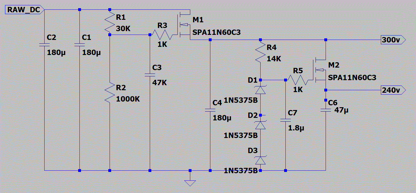

Power supplies:
I’m a big fan of regulated supplies, but I wasn’t sure what voltage the output tubes would land at with changes in the line voltage, so I made a PCB to house a ripple smoother and the LED array for the cathode. The ripple filter is a voltage divider that takes the ~310v DC and uses a MOSFET follower (some high voltage TO-247 I had laying around) to provide a fairly clean 300v for the output tubes. Another MOSFET regulator fed by a bypassed Zener string gives a very clean 240 volts for the signal circuitry. I’m using a 12v switchmode PSU for the heaters. The 6N1P uses a 10 ohm 10 watt dropping resistor to run at the right voltage. I’m beginning to believe that this is the best (but not most efficient) approach for using switchmode PSUs on heaters. The increased resistance while cold keeps the current draw of the heaters reasonable and keeps the PSU from auto turning off.

Case:
I bought a fairly large somewhat finished aluminum amp case off of ebay. I drilled a bunch of holes (I like to use Front Panel Express software to do the design, then print it out and centerpunch/drill off of that) for tubes, ventilation, tube guards, and everything else. I went with a black and silver theme, I think it turned out OK. The right knob is for volume and the left knob is a rotary switch from a lamp that is used for power on/off.

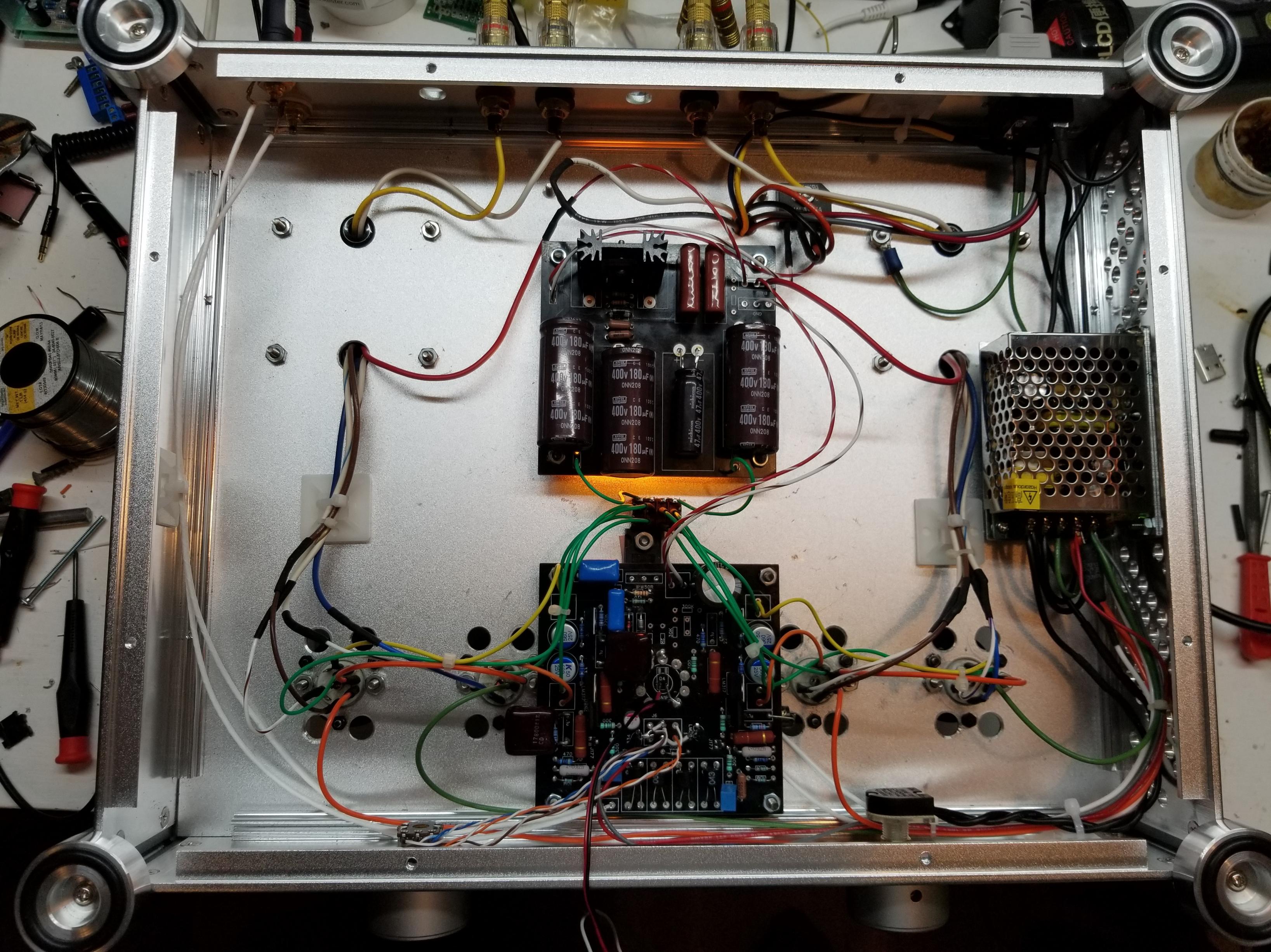

Inside:
Inside you can see the general layout. This picture was taken at the 95% completion point while doing some power up tests. You can see the yellow glow from the LED array that biases the cathode(s). It was still missing a few things like chassis grounding and some miscellaneous wiring. Not shown is the bottom panel, which might be too extreme for some of our more sensitive readers. It contains a…fan. Don’t worry, it’s a 92mm Noctua fan run at 9v off of a LM317. It produces a broad spectrum of noise instead of a single tone, and at 9v it’s inaudible from more than a foot.
Those with keen eyesight among you may have noticed four small black cylinders at one edge of the main PCB. Those constitute a LDR volume control. That’s a subject for a different post, but it works brilliantly. It’s especially well suited for devices with a high input impedance like tubes or jfets.

I loaded up some old 6P14P tubes and a new 6N1P and powered on. When cold, the 12v psu cycles 2-3 times before the heater resistance is high enough that it doesn’t trip the 6 amp limit. The first test run was a disaster – after a few seconds it sounded like I was being strafed by a Spitfire. A high pitch that descended rapidly followed by a rapid oscillation. I traced it to the scummy old tubes that I was testing with and threw them away. I tried some more used tubes and had it working, but one channel was noticeably louder than the other. After ensuring that no fire would come belching out, I borrowed a matched quad of output tubes, and voila, sweet music! I won’t try to sell anyone with audiophile adjectives, but the sound was a huge improvement over the TPA3116 that had been there before. The CCS mode is extremely bass heavy, which can be good to offset bookshelf speakers with limited bass, but on full range speakers it’s distracting. The LED biasing on the other hand is fantastic. Everything is clear, neutral, and just right.

Thanks for the detailed write-up, interesting reading :). Good use of mosfet concertina, I agree with all your arguments for it. I haven't tried the Bastode yet, but seems to sim nicely with a good distortion profile. You might want to check the grid to cathode voltage for the 6n1p, the sim says it is very close to zero. Reducing the value of R11/R22 helps, but I guess it depends on the particular tube you are using.
Interesting observations of bass response of CCS vs LED array. Running 6BQ5's ultralinear with no NFB results in quite high output impedance so there will be a response peak at the speaker fs assuming closed box, and peaks elsewhere depending on the crossover. The simulation says about 10 ohms at best (fixed bias), I guess the CCS makes this worse. LED array acts much like fixed bias.
How is bias current matching with the LED arrays? SY had variable screen voltage in the RLD to adjust current, you obviously can't do that with ultralinear connection.
I removed the noise injection because I like to overbuild power supplies. Using a regulated supply, the supply impedance is less than an ohm and ripple is trivially low. No point in compensating for something that doesn't exist in any realistic amount. To the point, I have to put my ear 1" from the tweeter to start to hear any background hiss. The price is that I burn about 50 volts at less than 20ma (about a watt) for the front end.

tikiroo - I'm not sure the J177 Spice model is terribly accurate. JFETs can range greatly from their statistical mean, which is what Spice models. I'm getting about a volt between the grid and cathode, so I'm about right. I think that there's a bit of self-bias in the circuit where reduced voltage between the grid and cathode decreases the voltage at the anode, which then reduces the voltage at the divider, thereby increasing the voltage between the grid and cathode. It's a limited amount of negative feedback at both AC and DC. JFETs or tubes that are significantly out of spec from the spice model could exceed the limits of adjustment, but so far so good.

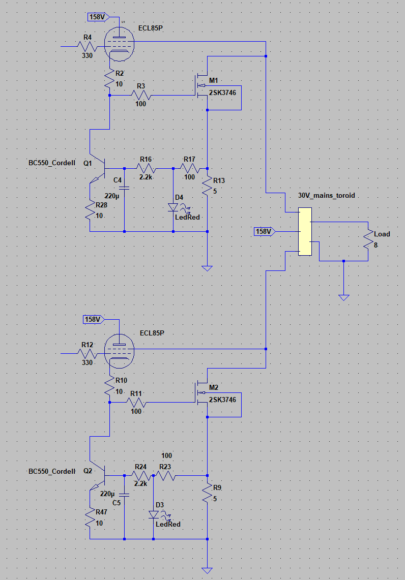

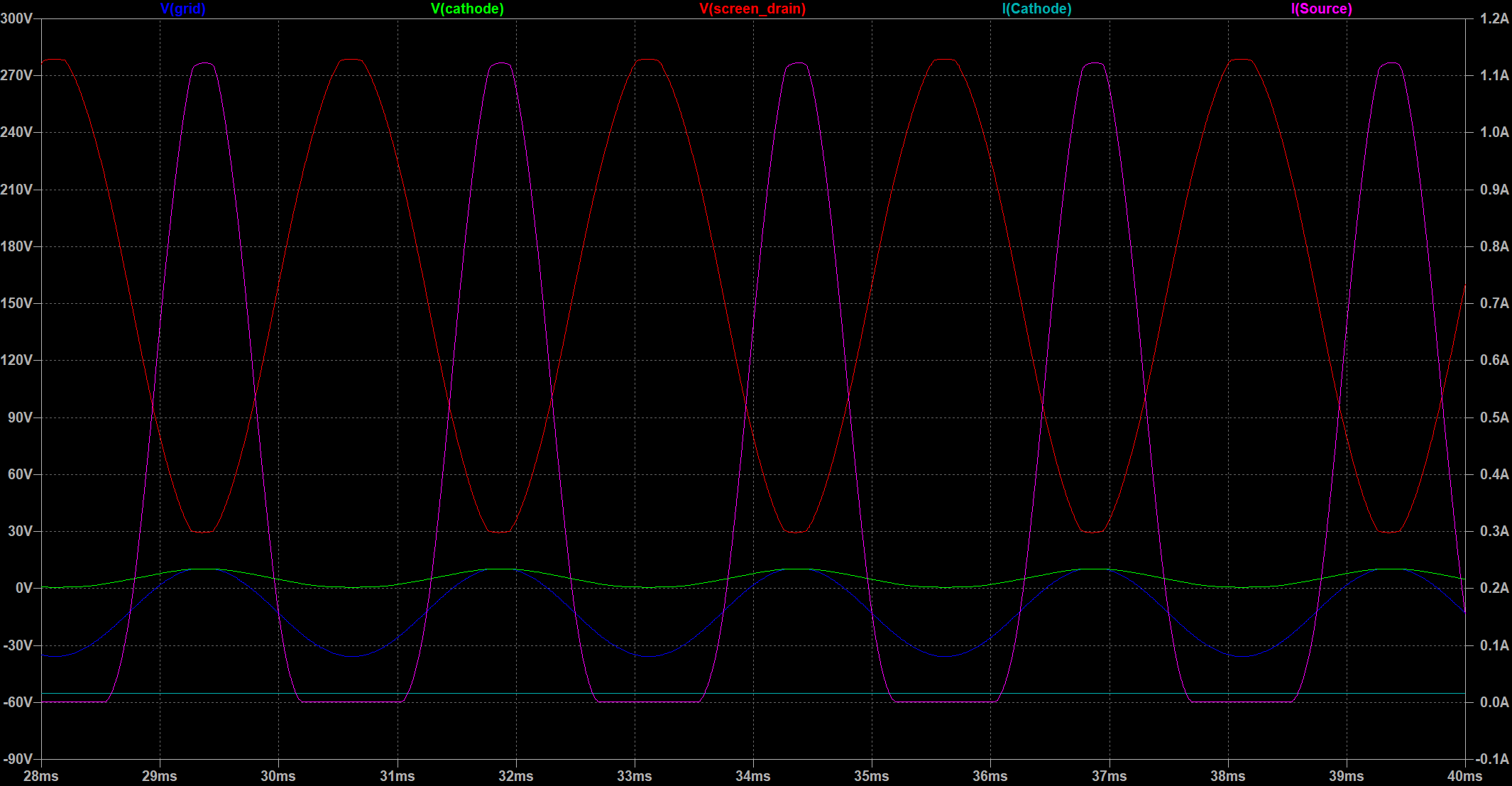

Attached is the output stage of my latest amp. It is similar topology to Stocktrader's (it's another Broskie idea) but biasing is more complex with the mosfet instead of BJT. The npn acts as a bias servo for the mosfet as well as a CCS for the pentode. The clipper LED allows servo operation into class AB. The pentode needs ~ -11V on its grid (allows trimming of current), or a larger value cathode resistor to get the voltages right for the mosfet. Feedback to the screen makes the pentode behave like a triode, without the plate current passing through the output transformer.

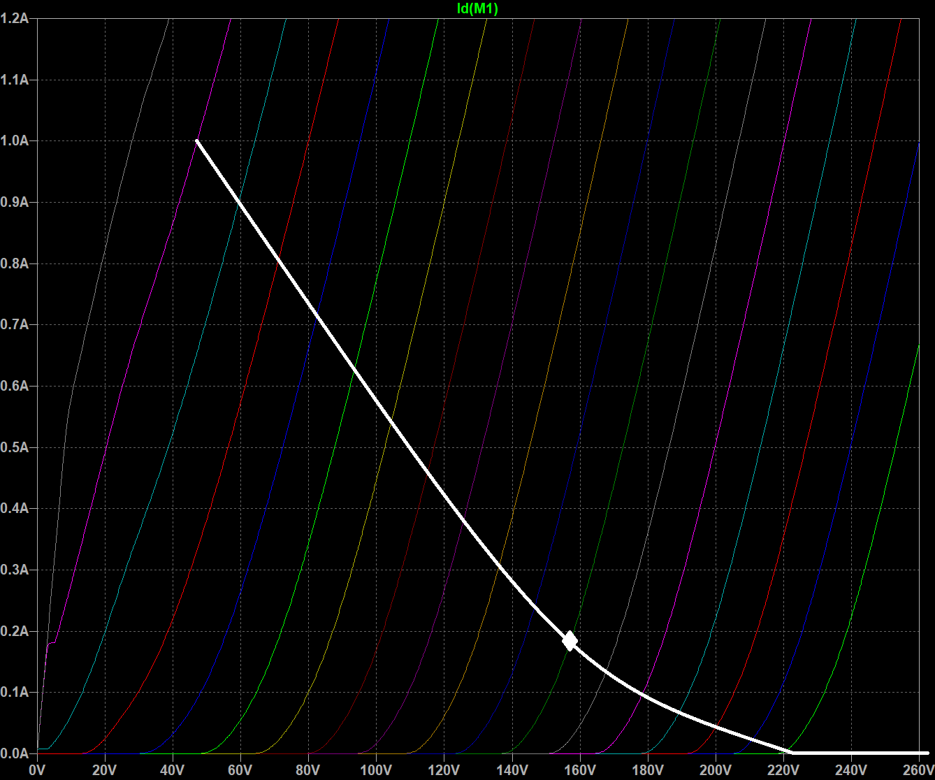

The valve/mosfet arrangement acts like a triode with gm of 150 mA/V, rp of 50 ohms and mu of 7.5. See attached spice generated curves and approximate loadline with 400:8 output transformer (a 30V mains toroid). It's good for more than 50 watts into 8 ohms. I can't fault the sound or measurements, only hassle is the heatsinks.
Sorry for the threadjacking Fenris, but you did mention "a crazy mashup of JFETs, transformers, tubes, and high voltage MOSFETs" :D

On simulator at 4ma the j177 has drain impedance of about 30k . This provokes a NFB of 6db .
Tikiroo, Your circuit will behave differently as the plate is connected to B+ and the output is driven from the mosfet and the screen (upper) grid.
I hadn't seen this done with a BJT, Broskie's supertriode setup has the mosfet transistor characteristics equal to if not dominate the triode characteristics.
A mosfet is a crappy substitute in my circuit
Tikiroo or Fenris, what is the effect on plate current using the screen grid?
for instance, it is not possible to drive the transistor into saturation because the tube cannot pass 10ma with less then 25 volts plate to cathode. I am assuming your circuit can drive the transistor right to the rails
Hi Stocktrader. The mosfet can't be driven to the rails, the valve/mosfet combo clips with onset of grid current, just like a normal output valve (without cathode or source follower driving it). The plate current remains constant by design. With positive going grid voltage there is a positive going cathode voltage which increases mosfet current and results in a negative going drain/screen voltage. The AC amplitude at the cathode is much less than the AC amplitude at the grid due to the feedback through the screen. See attachment which shows conditions at clipping.
Actually there is little difference in performance with a real triode or the pentode connected as a triode (plate+screen connected to mosfet drain) or with only the screen connected to mosfet drain. With a triode, the voltage feedback is through the plate rather than the screen. The advantage of using the screen for feedback is that most of the constant current through the valve is coming directly from B+ rather than going through the output transformer where it is not doing anything useful.
