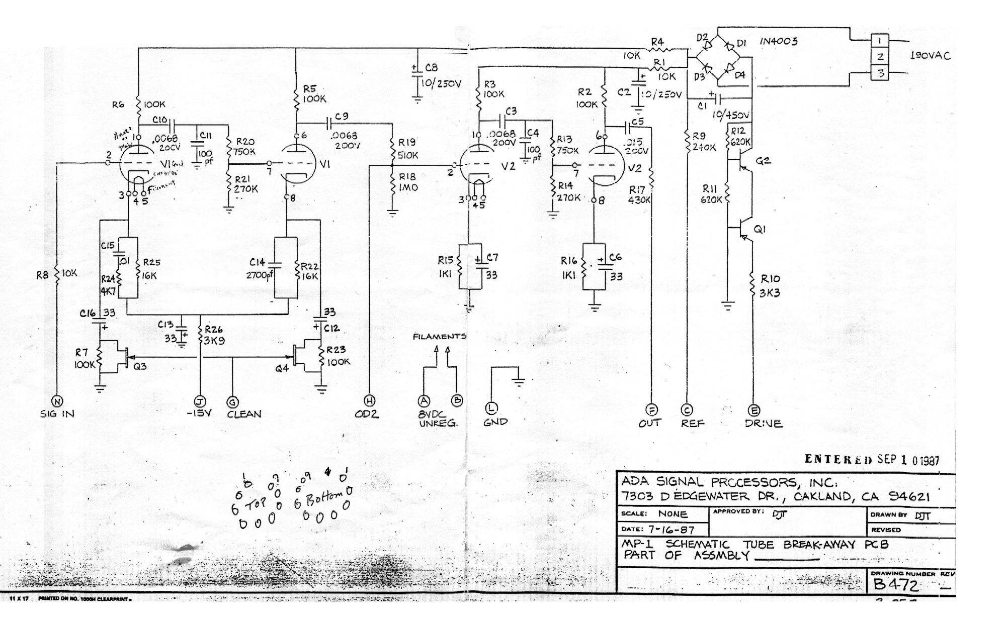

For reasons that I don't fully understand the pair of 12AX7's in my ADA MP1 guitar preamp are run off of 8 volts DC. See schematic. Next time I have my guitar preamp board hooked up I'll plug the heater power cable into a variable DC supply to see how much difference it makes.
