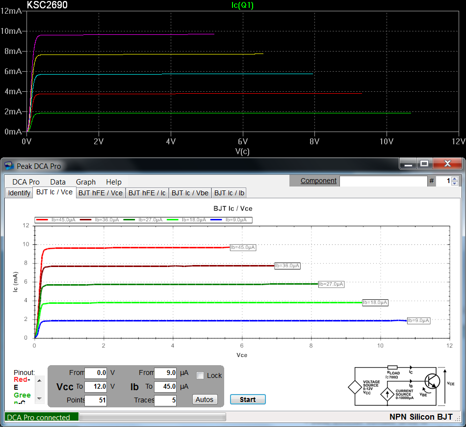

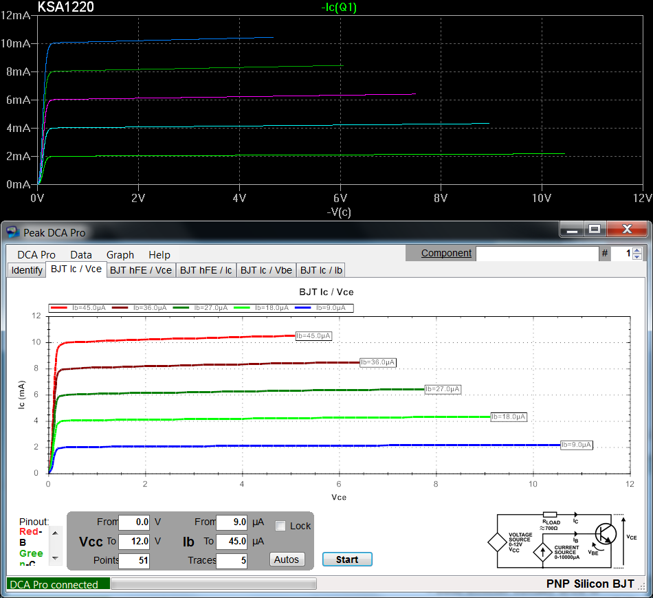

- The Peak Atlas DCA Pro provides a maximum Ic of about 10 mA and I don't really know how much you can extrapolate the accuracy of the model to higher currents. Bear this in mind especially for the VAS/driver models.
- Where I had a bunch of them, I measured beta and Vbe for the lot and based the model on the one closest to the median, but for some I only had one or two, so the model may not be as representative. Also, even where I had a bunch, the model will be representative of that particular bunch, the ones you have / buy may well be different, so ymmv. They were all pulled out of vintage equipment or bought from reliable suppliers (Mouser, Farnell, etc.). I'm not going to list all my stock, so if you have questions about a specific model, please ask.

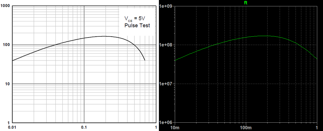

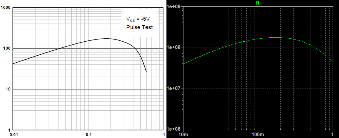

- I have measured vs. simulated curves (Ic-Vce, hFE-Ic, Ic-Vbe and reverse) for all of them. Those are the direct measurements I've based the models on. I've also tweaked to match other things like beta droop, ft, Rb, temperature effects, etc. where those were available from the datasheet or elsewhere, which isn't always the case. If they weren't, I've left those parameters as they were in the model I tweaked or at their default value. If you're interested in the curves and/or details of a particular model, again please ask.
