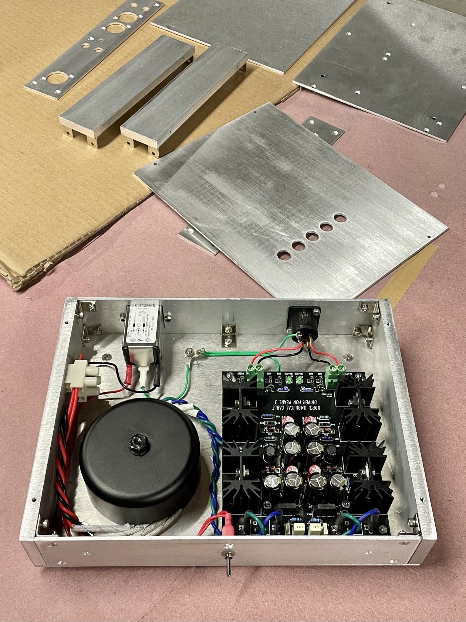

After long delay, here's my UDP3. I'd been waiting for Gianluca's nice back panel, a cable gland, and a free weekend afternoon. Also I prefer powering up stuff off of the mains only when all the fuses & shrink wrap are in place, so.

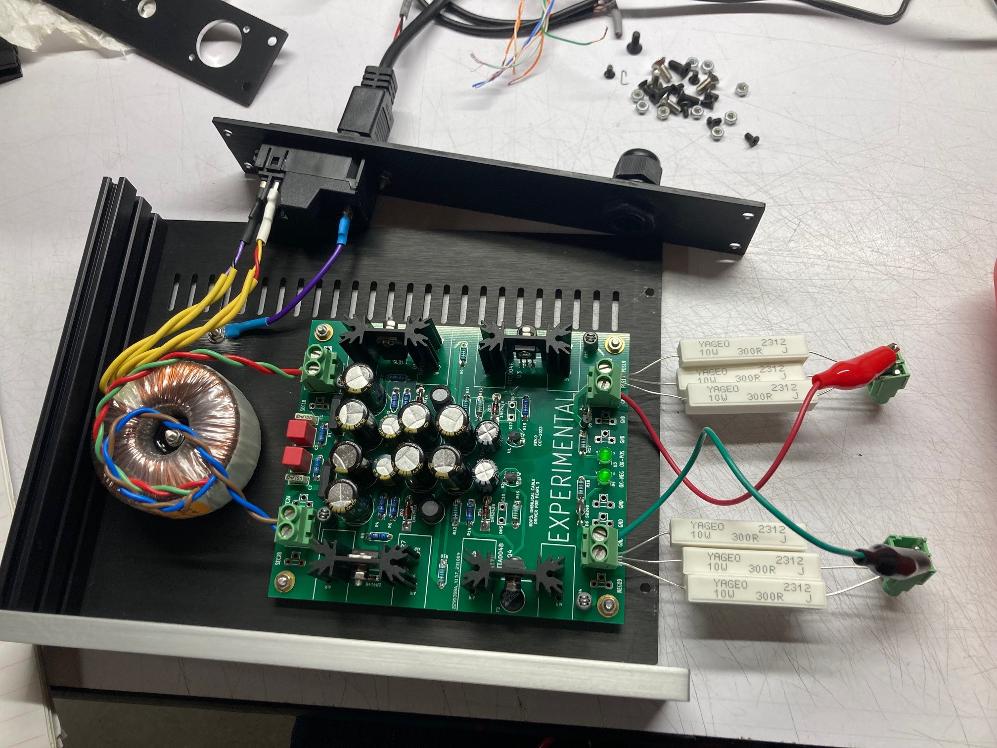

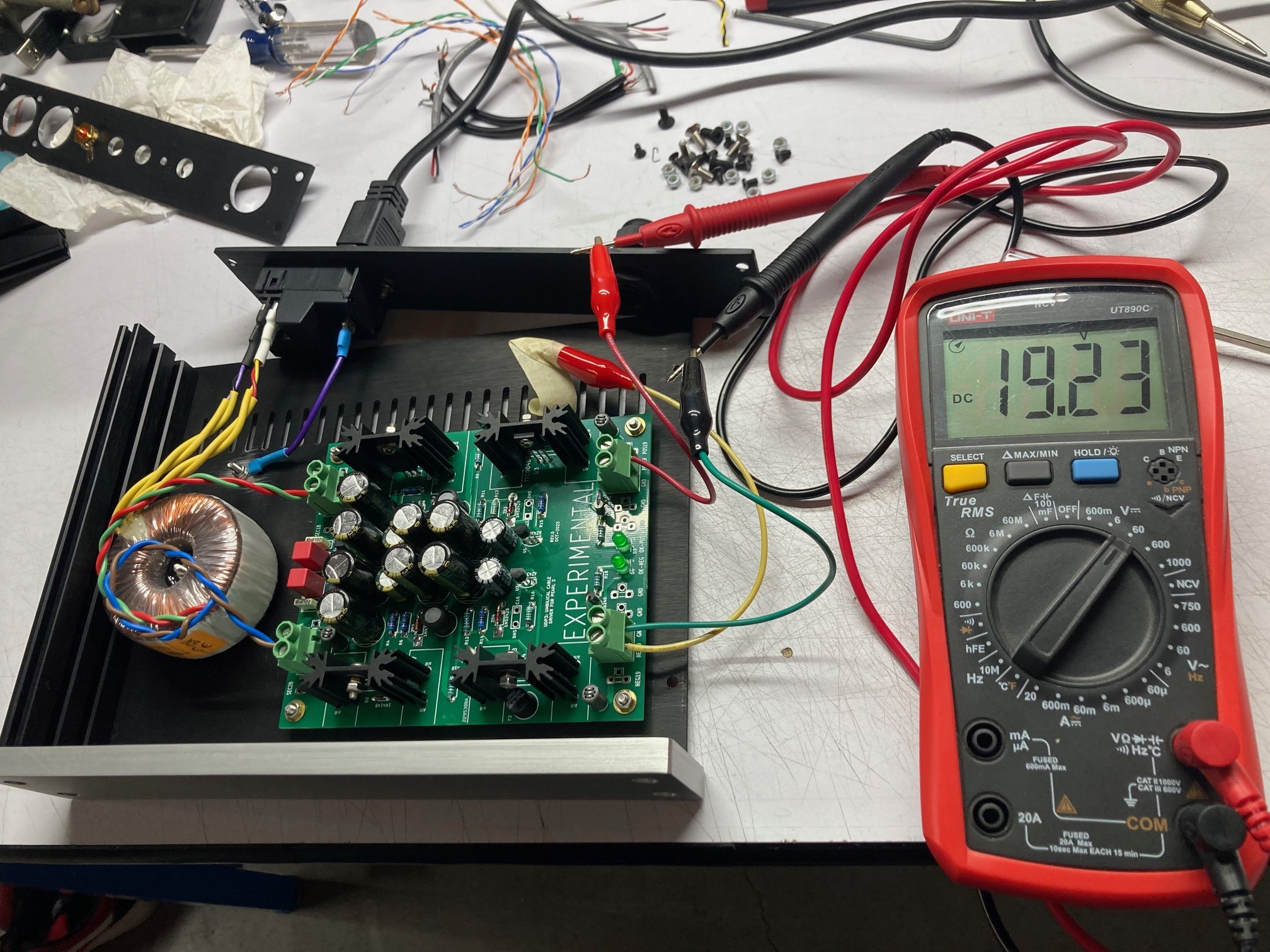

Unloaded, the rail LEDs lit & there was 19.23V between positive rail and ground, and -19.27V between negative rail and ground. With 98R7 of power resistor between each rail and ground, there was now 18.86V positive and -18.90V negative, which is just about 190mA of draw per rail. Good. I ran it loaded like that for a few minutes, the power resistors got warm and the heatsinks on Q3 and Q4 got a tiny bit warm.
So then I hooked up the umbilical & completed the box, & for sanity's sake I thought to check the voltage at the other end of the XLR I'm using as an umbilical. But I got clever, and decided to check the potential rail to rail instead of rail to ground, and may or may not have shorted the rails while doing so. Anyway that popped the rail fuses. I don't have spares (I gave my two spares away), so now I get to order more & wait. I'm pretty confident it's the rail fuses that went open because I can still measure 19+V from pin 2 of Q3 and Q4 to ground, and nothing from the ferrite beads after the fuses to ground.
I've done this before, measured from rail to rail in other power supplies and it hasn't been an issue, but then again I wasn't necessarily paying attention to rail currents while doing that, either. I'm surprised this popped both rail fuses, and again maybe I shorted the rails, but, there ya go. Everything fits & looks nice, at least.

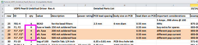

post#1 of this thread said:
... The fuse, a small thru-hole packaged device, blows if/when you mistakenly short UDP3's output(s). It is available on DigiKey and Mouser for about 40 cents per fuse. Because they cost so little, I recommend you buy at least six fuses of each of three different fusing currents. Or more. Now when you get a surprise fuse-blow event during testing, you will have plenty of spares, and they don't cost an arm and a leg.

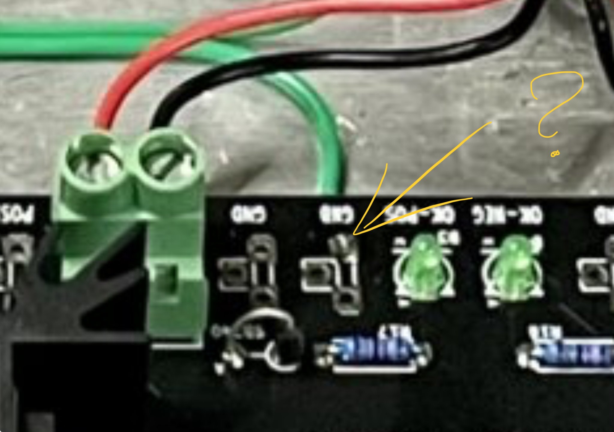

If I suspected that one or both fuses might be blown, I'd measure the voltage-to-ground (A) upstream of the fuse; and also (B) downstream of the fuse.
I'd also check to see whether the OK-POS and OK-NEG LED's are lit. If a fuse is blown, its LED won't be lit.

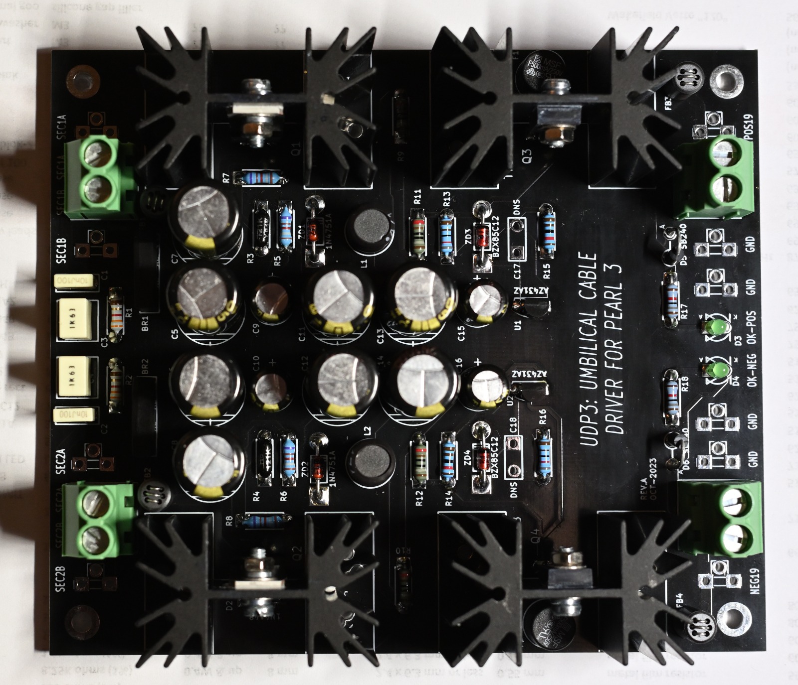

In the UDP3 circuit design, snubbing resistors R1 and R2 are selected to mate with your personal choice of power transformer. The Detailed Parts List does say, in the "Mouser Part Number" column, "QUASIMODO" { spreadsheet cell K4 } . Quasimodo is the diyAudio test jig which helps you find the optimum snubbing resistance. I guess I should have listed "TBD" (to be determined) for the resistor values, on the schematic and the parts list; that might have avoided some confusion. Sorry for that omission! You determine those resistor values using Quasimodo. Or you get lucky and joyfully discover that somebody has already used Quasimodo, on your exact transformer (!!), and has posted their results.
Many diyAudio members have tested many different transformers on their Quasimodo test jigs, and reported the optimized snubber component values to a discussion thread here on the forums: Quasimodo results (ONLY). Have a look at posts # 150 and 151 in that thread. Those are the two transformers which I suspect will be most frequently chosen by UDP3 builders. Don't sweat the precise resistance value too much; anything within plus-or-minus twenty percent will be just fine. Buy a pair of nearby, standard value resistors, at a low price, and sleep soundly. 100 ohms is plenty good enough instead of 98. 56 ohms is plenty good enough instead of 60.
