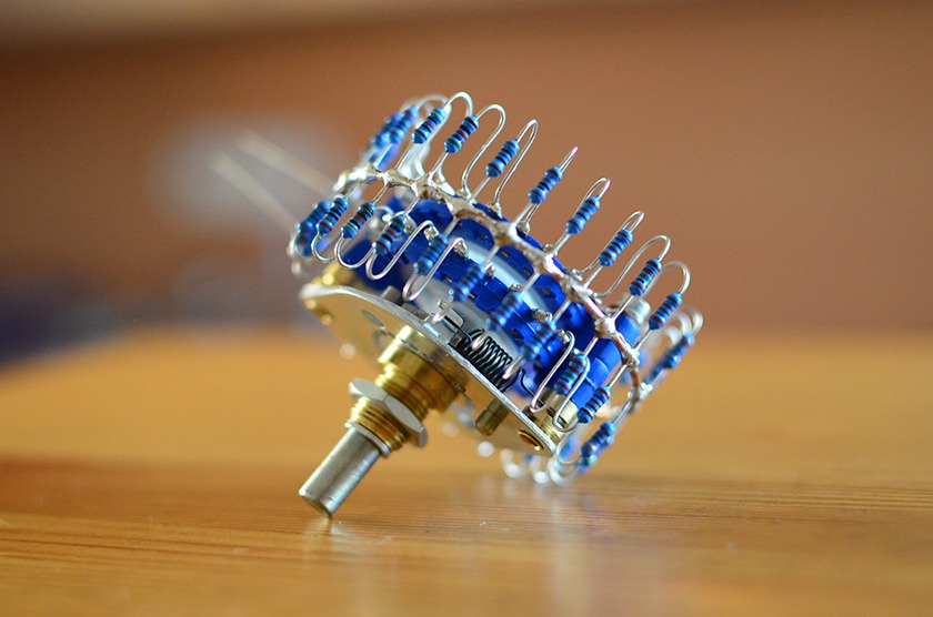

I have a few Noble pots and they are pretty darned reliable. Not certain if they are still readily available though. If you're prepared to do some calculations, resistor matching and plenty of soldering, see if you can get hold of a Plessey Type 72 quad bank rotary switch. They're not too expensive as I recall, and are extremely rugged. Ideal for making up a 2-resistors-in-the-path volume control. There is a spreadsheet available somewhere (just can't recall where I found it) to help with the calculation of the resistor values.

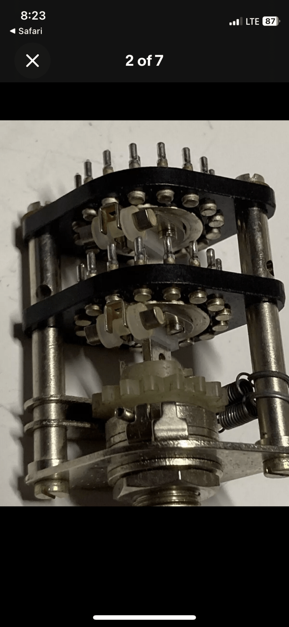

I just got hold of a 15-step plessey rotary switch, trying to make a 10% log taper log step potentiometer with it.
Want to figure the resistors required for each step. So at 1/2 setting it should be 5K Ohm, at quarter setting is 500 Ohm? 3 Quarter is 4.5K Ohm?
Could some experts show me the correct way of calculating the desired resistors for each step?
