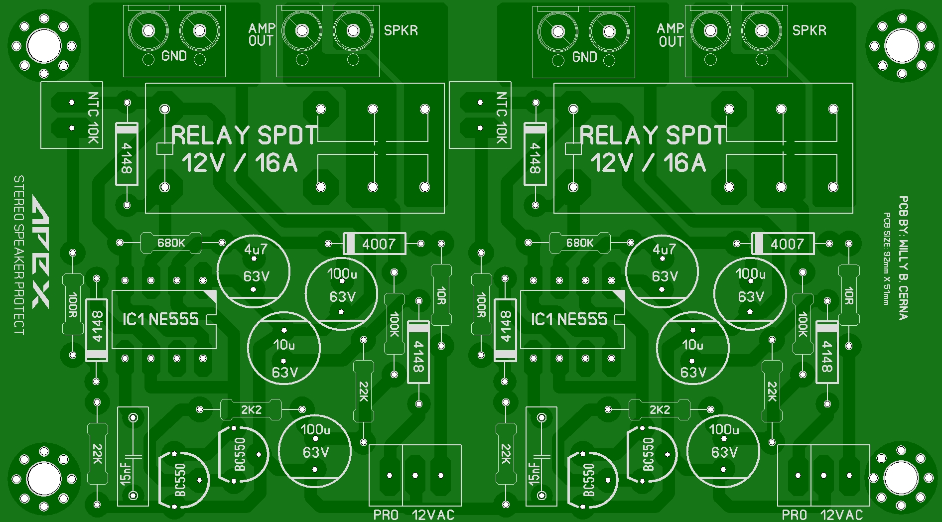

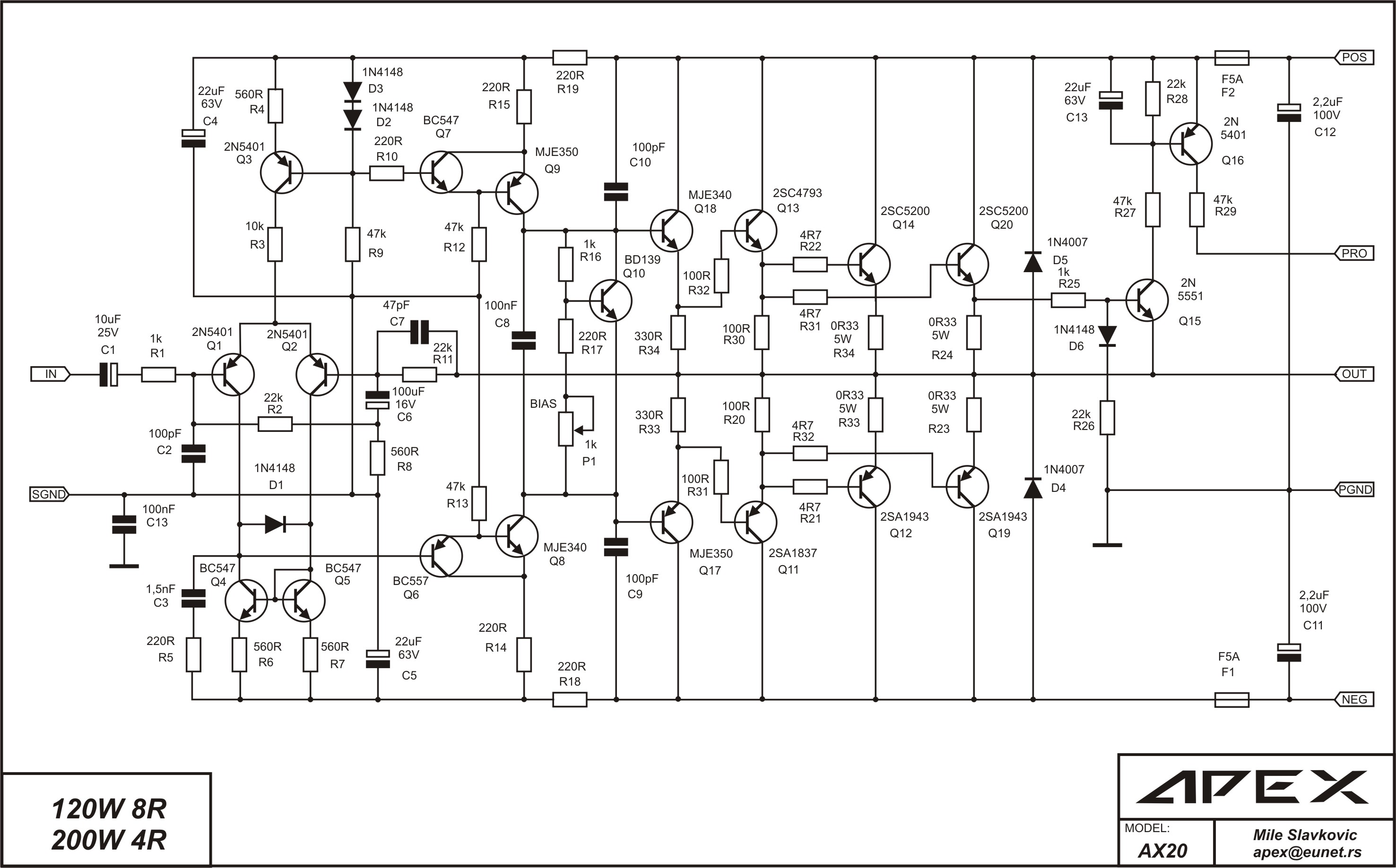

I found this protection from Willy, in the forum, I will use it on the AX20 3 pairs PCB Olafk.

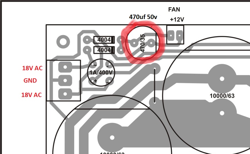

Hi mr.Mile
i have a problem with f100. marked cap keep blowin. and 2x1n4007 some times broke some times get short. i use 2x24v fan parallel in the amp and feed from fan connector.
any idea why this happening? if i change 2x1n4007with bigger one and cap voltage with 100v can fix problem? or that 2 fan having problem inside?
