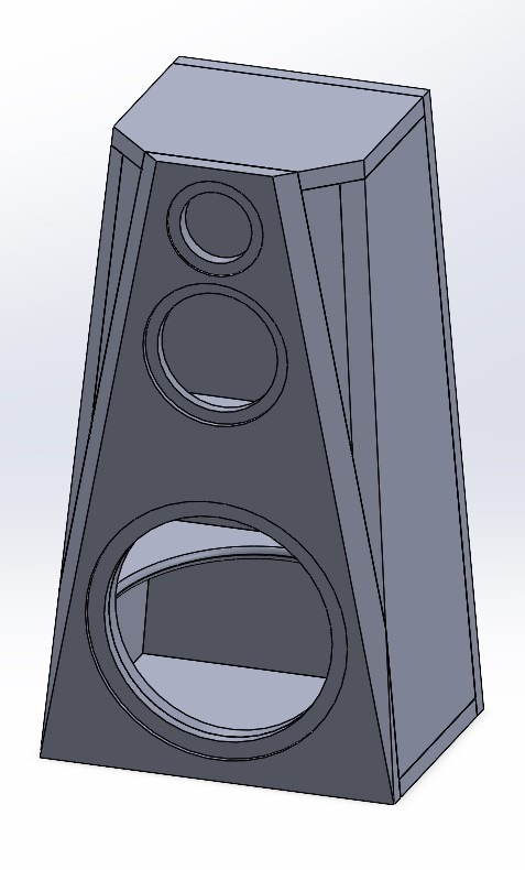

I am in the process of finalizing my cabinet design for a 3 way 10" woofer build that will be very similar to hifijim's budget 3 way speakers he has been working. The speakers will be passive, even if it sacrifices some performance away from ideal, because I enjoy the ability to mess with different amps, preamps, DACs, ect. It will use:
Woofer: RS270-4, vented 30L, Fb 32Hz, port length 18cm, port dia 5.5cm
Mid: SB15NBAC30-4, sealed 4L
Tweeter: SB26ADC

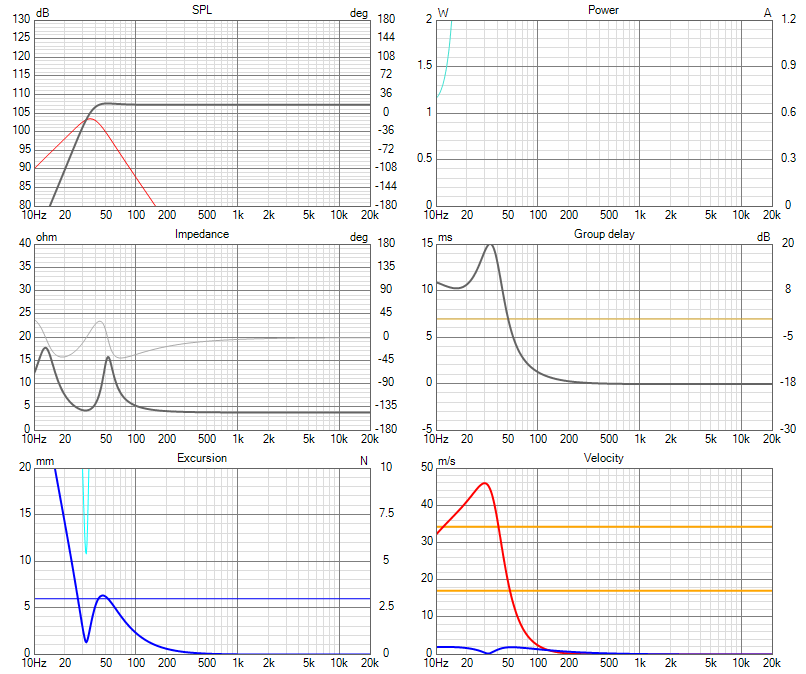

I have already used Vituix to simulate most aspects of the design including the baffle diffraction and enclosure volumes/port sizes. However, I am having trouble figuring out the ideal placement of the port based on internal geometry (not distance between room wall and speaker port). The cabinet is quite shallow, not leaving much room between the front baffle internal wall and where internal port entrance is as seen in the images.

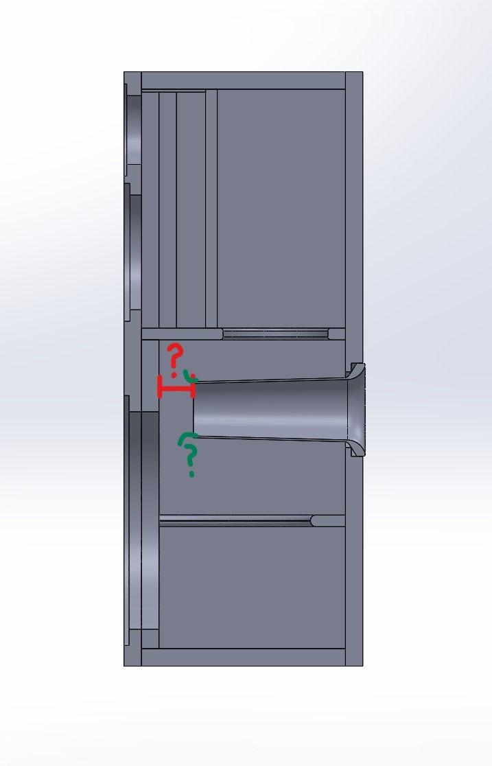

I am wondering whether this will be enough room (~1.5 inches from port to wall) or if moving to an elbowed port will be necessary. If anyone has experience/ideas for the internal port clearances or suggestions as to what I can do differently please let me know. Thanks!

The generally accepted best practice is that if the port is flared on one end, it should be flared on the other. Another generally accepted rule is that the distance from the port exit to an internal wall should be at least one radius. So with a 55 mm port, a distance of 38 mm (1.5 inch) would be acceptable. However, you are leaving yourself very little room for adjustment. When you measure the port response, you may find it is several Hz above or below the target. If you need to make the port tube longer, you will have some complexity to deal with.

1) I'm not sure I'd be too concerned with the 1.5 inch distance, but as Jim pointed out, you make not get the tuning you are targeting
2) If you can add a flare to the internal end that will help

Not to be controversially critical but I've always understood that the clearance between the internal end of a port and an internal wall should be 1 diameter, not 1 radius? "Fudging" a little is okay, however.The generally accepted best practice is that if the port is flared on one end, it should be flared on the other. Another generally accepted rule is that the distance from the port exit to an internal wall should be at least one radius. So with a 55 mm port, a distance of 38 mm (1.5 inch) would be acceptable. However, you are leaving yourself very little room for adjustment. When you measure the port response, you may find it is several Hz above or below the target. If you need to make the port tube longer, you will have some complexity to deal with.

Probably true...I've always understood that the clearance between the internal end of a port and an internal wall should be 1 diameter, not 1 radius?

1) I have ran a port simulation with a max air velocity of 30 m/s at Xmax. With the flared port I am less concerned about turbulence but will take the tip and move to a larger diameter due to responsiveness.

5) Ideally keep port distance 1 diameter (worst case 1 R) from cabinet wall.
A couple of comments...
30 m/s is almost surely too high. The one caveat I'd mention is at what frequency? If it is at 25hz then this is probably not where you should be looking as there isn't much music content that low and your speaker is probably pretty far down at that point. My guess is that with the RS270 it was in the 30-40Hz range and it does matter.
With a large flare I usually target 24 m/s max. Not scientific evidence showing that is a good number though. The typical "rule of thumb" is 17 m/s but I never target that.

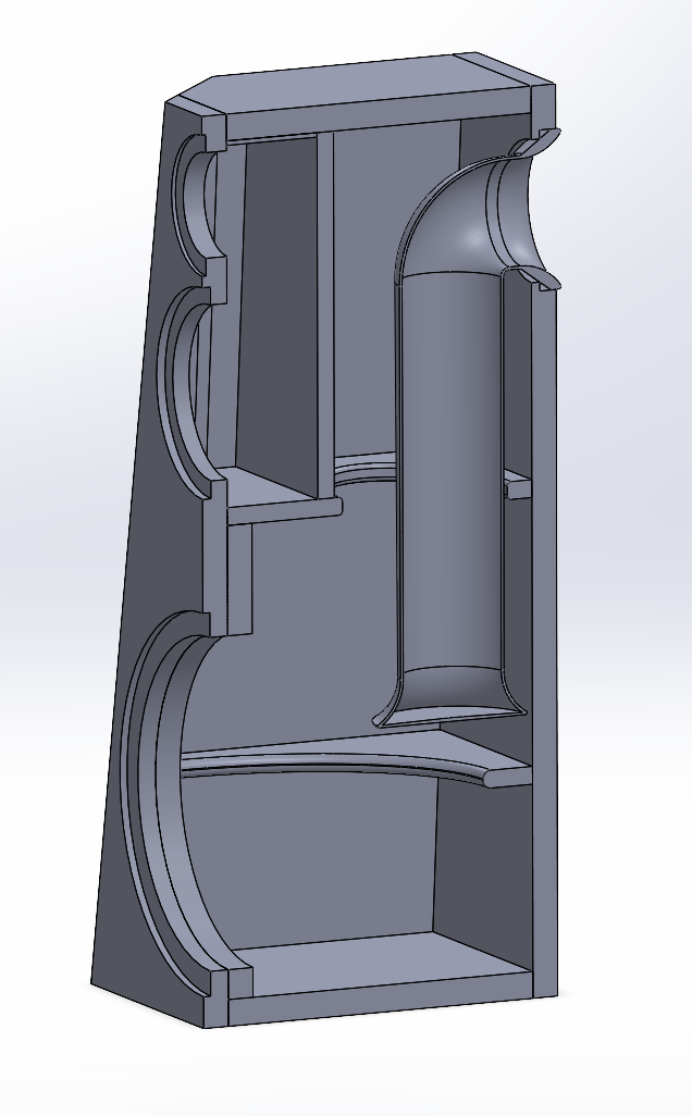

The new port diameter is 3" and ~14" long based with a correction factor of 1 due to a prior comment stating ~0.9 is reasonable for double flared. Figured double flare + elbow would be close to 1, but again I can change it once the cabinet is built. With this port Vmax is ~24 m/s like you mentioned at Xmax, happening at the tuning frequency of 32 Hz.
I have already updated my model, due to the large volume of the port I had to extent the depth of the box by 0.5". The total main chamber volume for the RS270 is now 31L instead of 30L, I figure I will be adjusting port length anyway so I can tune how I want then. I have checked clearances and there is enough room between the internal port flare and the driver, although its a bit close. Hoping that the port entrance being near the driver will lead to some better loading and not set up a funky pressure system in the box.
This may be looking too far forwards as well, but I would also like to gather some ideas about damping. My current plan is to use butyl rubber on all faces in the assembly to increasing damping and then fill with polyfill or wool. I have also heard good things about denim fill or rockwool. If anyone has some good recommendations, that would be great to guide my decisions.
Does anyone see any lapse of judgement or critical flaws I may have missed in the new revision?

A 90 degree elbow immediately before the flare will almost certianly increase port noise. A gentle curve would be better, as will a more gradual flare over the ports length. Time to get a 3D printer or use a service 😉

Here's your RS270-4 enclosure design with 130 watts, to reach RS270-4 Xmax. Note the port velocity:
If you want to maintain tuning, and get the port velocity down to ~ 17m/s peak, then you'll need a 53cm long * 9.0cm diameter port, or if 4" is the standard, then a 4" (ID) port that's 69.2cm long
