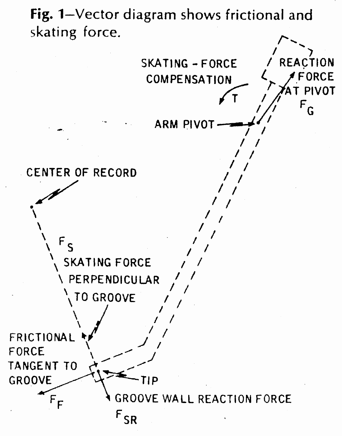

What is the skating force? Let’s look at the classical definition by James Kogen in his article, The Skating-Force Phenomenon.
Friction between the stylus tip and the record produces a force, Ff, tangent to the record groove at the stylus tip. The reaction force of the arm, Fg, must pass through the arm pivot. The two forces Ff and Fg combine as vectors, leaving an unbalanced force, Fs, which is by definition the skating force.
The mechanism to generate skating force consists of many components, i.e., groove, stylus, headshell, arm wand, and arm pivot. All the components are integrated and linked parts to produce a skating force. If you take one component out or break, (or in a fancy word, decoupling), the linkage. You will have the following consequences.

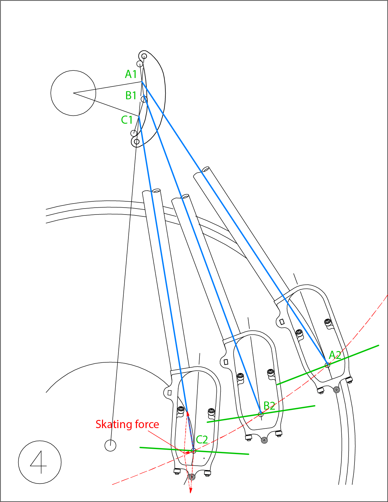

The arm travels across the surface of the record. Please see the diagram. The path is a red dot line in the diagram.
In theory, the linear rail has a different position at every point, such as A, B, and C so on in my diagram. The green lines in the diagram represent the positions of the linear rail. Since the position of the linear rail is changing constantly, the linear rail is always not in the same direction as the skating force. The skating force will pull the headshell against the front ball bearing, therefore, the arm moves inward. Again, this is the connection. The headshell and arm are two separated parts, but they interact with each other in order to move the arm. Since the direction of the linear rail is always not in the same direction as the skating force, adding a linear rail doesn't help to avoid the negative effect of the skating force on the cantilever.
Furthermore, let me assume that the arm sits on the record at the beginning without any movements. Everything is fine. But once the record starts to move, the groove will apply a force on the stylus. The stylus will pull the arm toward the center. The cantilever will be displaced. So is the headshell. Once the headshell is displaced, it will send a signal through the Hall effect sensor to the torque motor to generate a counter force. When the torque motor starts, the displacement of the cantilever already happened. The process repeats again and again. So, the correction happens after the cantilever is already displaced. The deflection of the cantilever is inevitable for all the arms in record playing back. The question is how much.

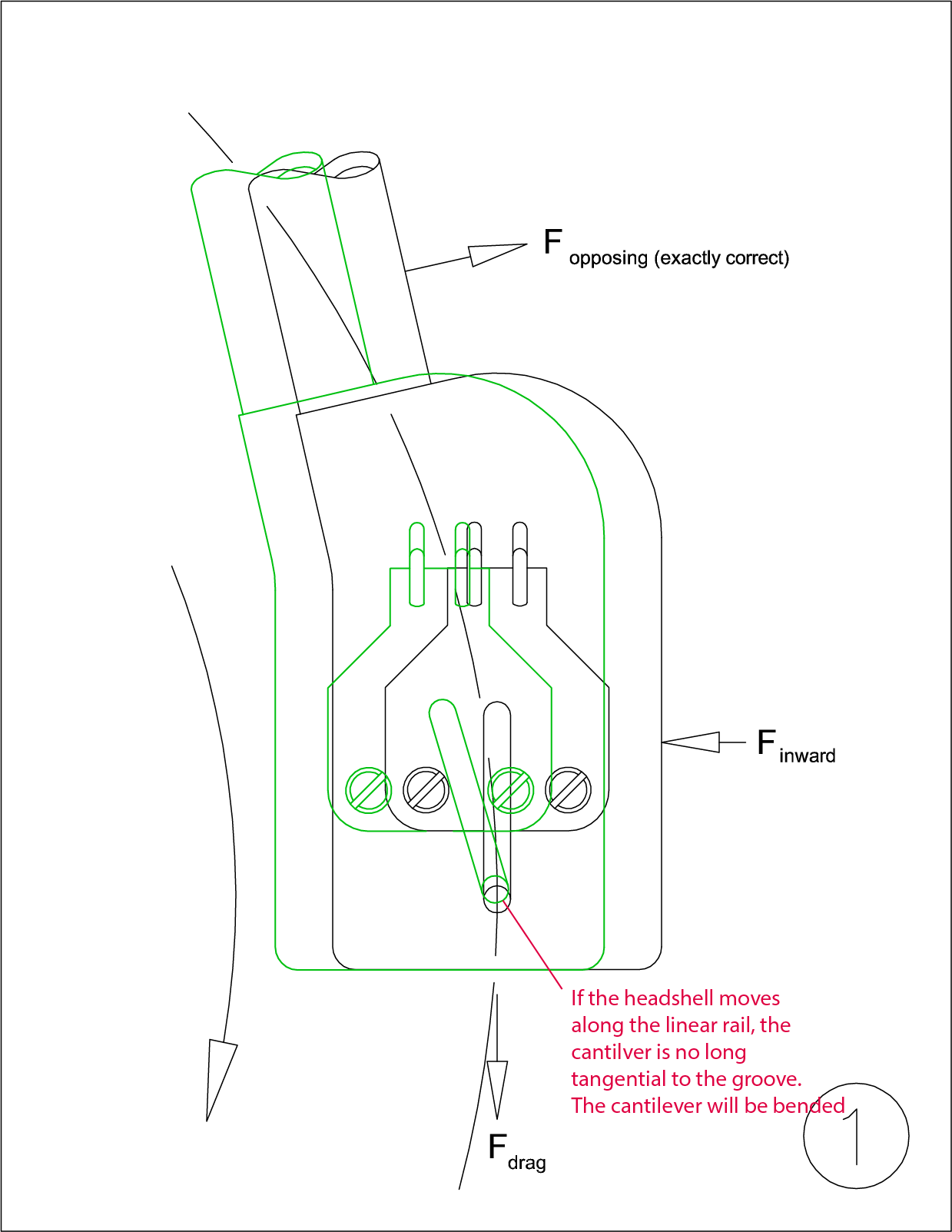

Let's assume you are right for a moment and take a look at the following diagram.
In the diagram, the headshell's original position is drawn in black lines. The cantilever is tangential to the groove. No problem here. Now, if the headshell moves along the path of the linear rail, the new position is drawn in green lines. You can see the cantilever is no long tangential to the groove. Clearly, the headshell can't and shouldn't move along the path of the linear rail. In fact, such linear movements don't exist due to the cam system.

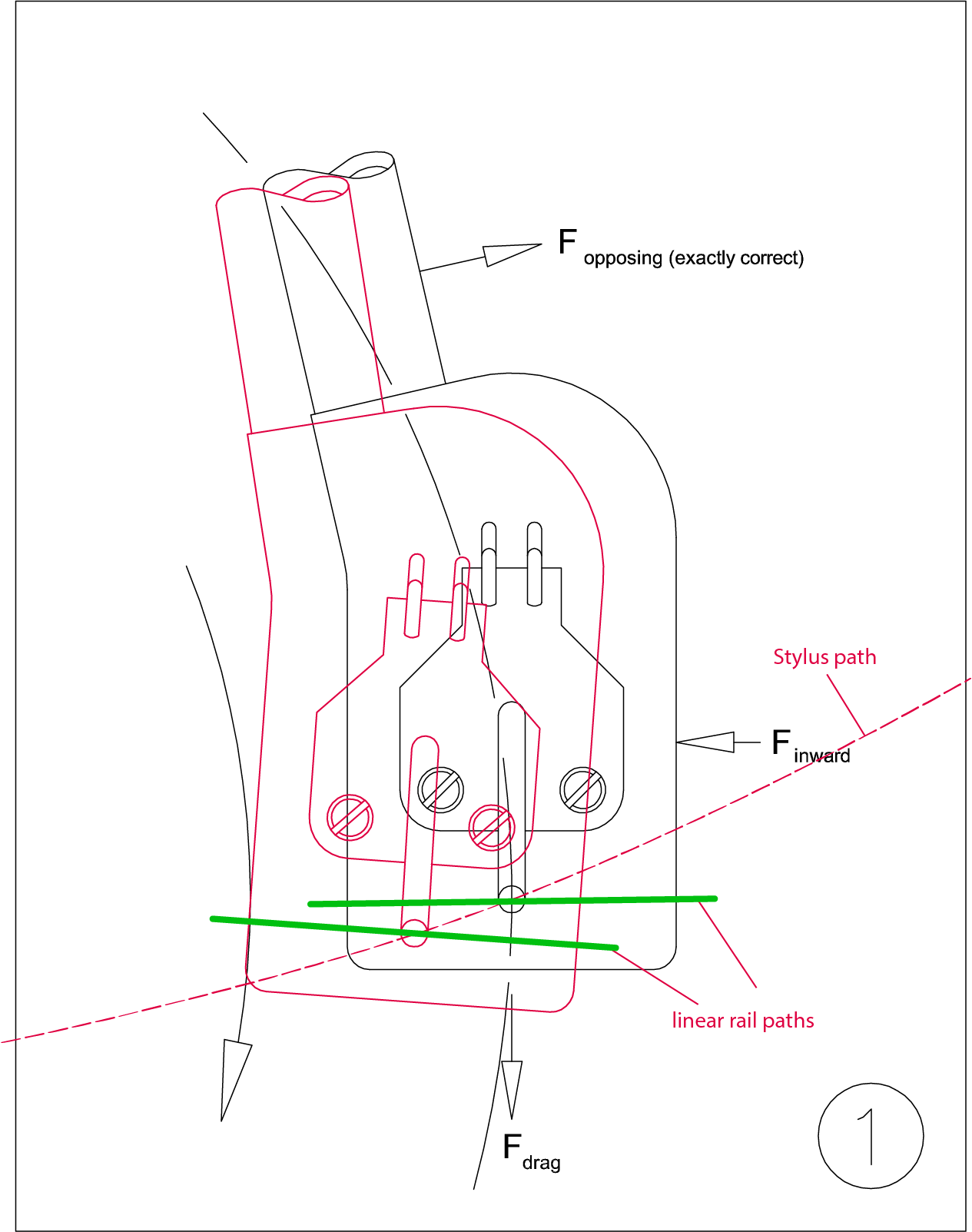

Now, let's take look at what is actually happening. Please see the following diagram.
For a tangential pivot arm, such as Ralf's, every point on the path of the stylus has a corresponding point on the cam system, A1 to A2, B1 to B2, and C1 to C2, etc. Once the headshell is driven by the spiral groove inward, the headshell can't move along the linear rail, green lines in my diagram. The correct positions are indicated in the following diagram.
The headshell in black lines is the original position of the headshell. Once the headshell is driven by the groove, the headshell will move along the stylus path. The headshell in red lines is the new position of the headshell. The line rail in a different position is not parallel to each other. Please see the green lines in the diagram. The conclusion is that the headshell on Ralf's arm can't and shouldn't move along the path of the linear rail.
Based on that, my question will be
What function does the linear rail have?
I don't know and can't see the need for a linear rail. This is why I said many times that a linear rail does nothing but causes problems.
