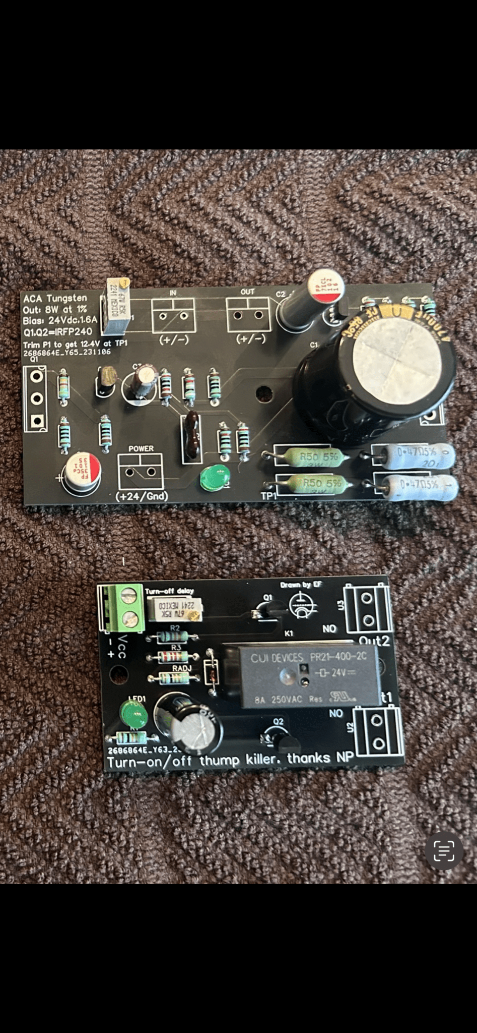

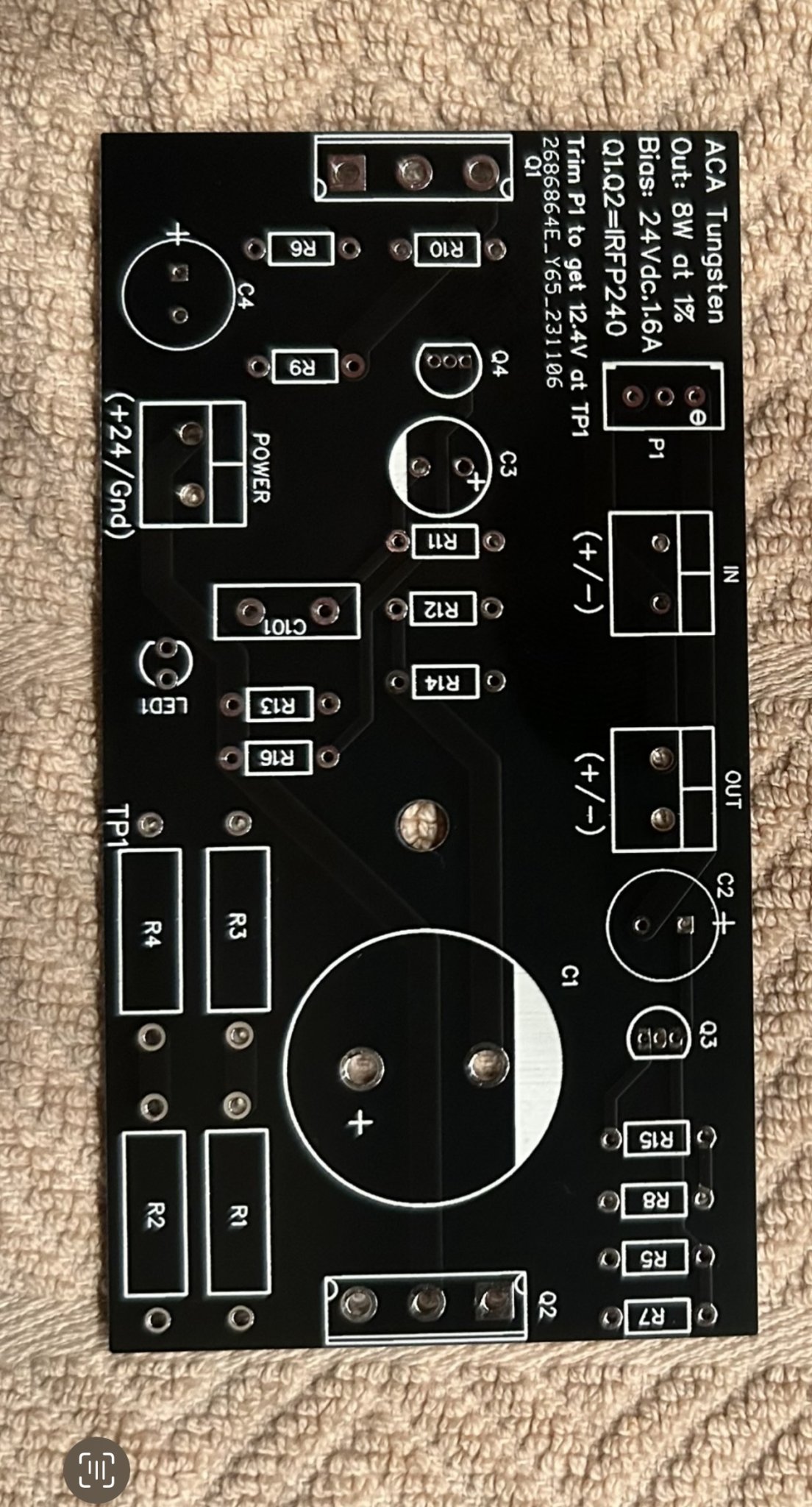

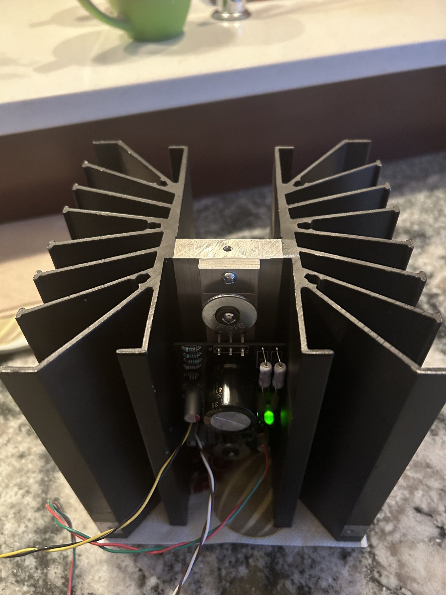

I have finally created my own PCB and also the thump stopper. Thanks to Mr Pass and Tungsten Audio for everything.
Below are a few pictures, both PCB have been tested and are working great. Drop me a PM if you want the Gerbers files.
The first pic is showing the almost completed ACA monobloc amp 😀. My outputs are FQH44N10.
Yep, same heatsink as my monobloc VFET.
Eric

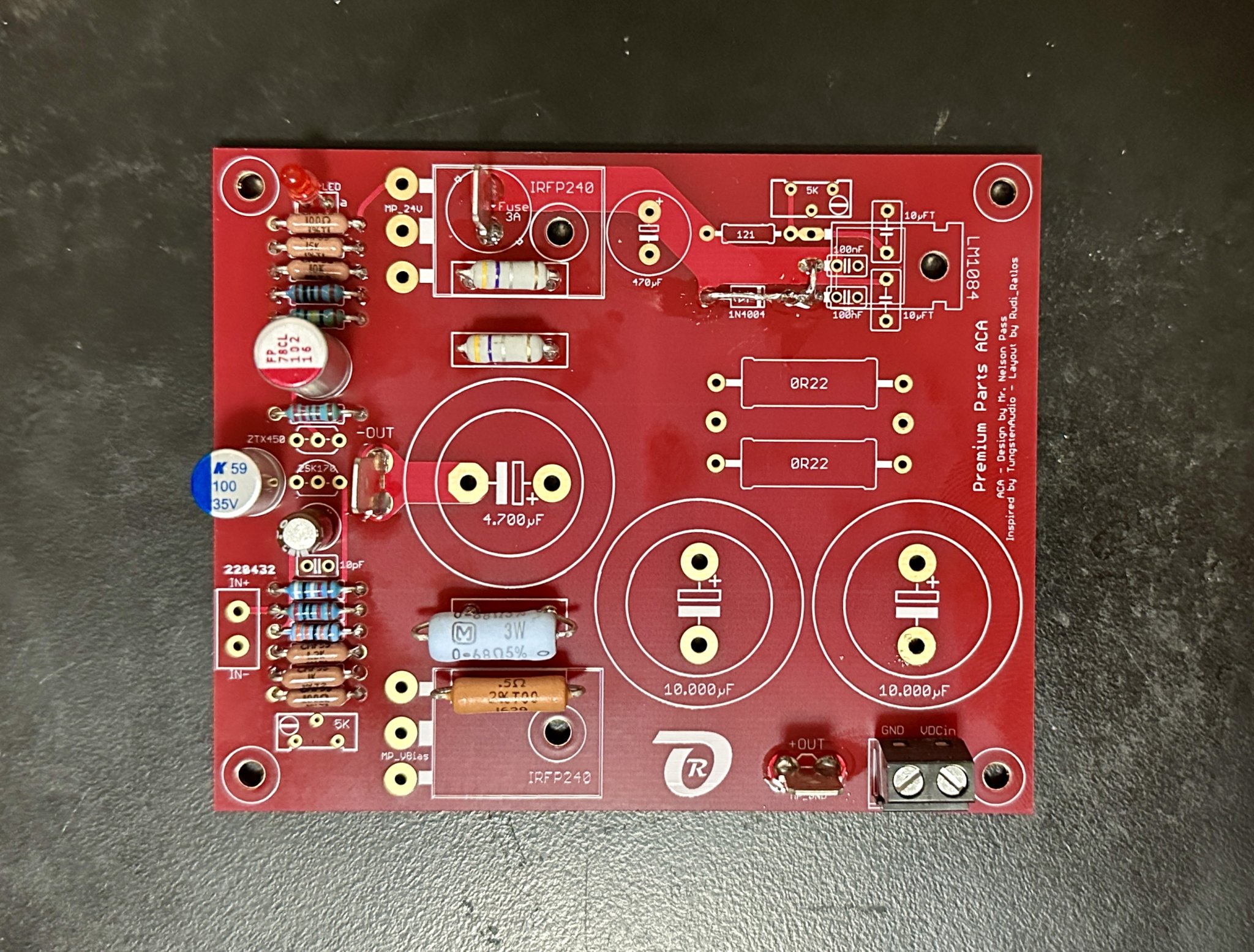

Here is an example of the ACA boards I am currently working with.
These include the last portion of the CRCRC filter that I use. The original filter caps were just 10,000 uF, but there are newer 15,000 uF parts available now that fit into the 25mm dia footprint. There is an option to use either a pair of 0.22 Ohm resistors or an inductor with a resistor in parallel to control the Q factor. Note that the unused regulator footprint needs to be bypassed by wires.

A pair of these boards will go into the same chassis that I recently tweaked. These should still run at 1.65A bias current with 29.5V power at the Drain of Q2.

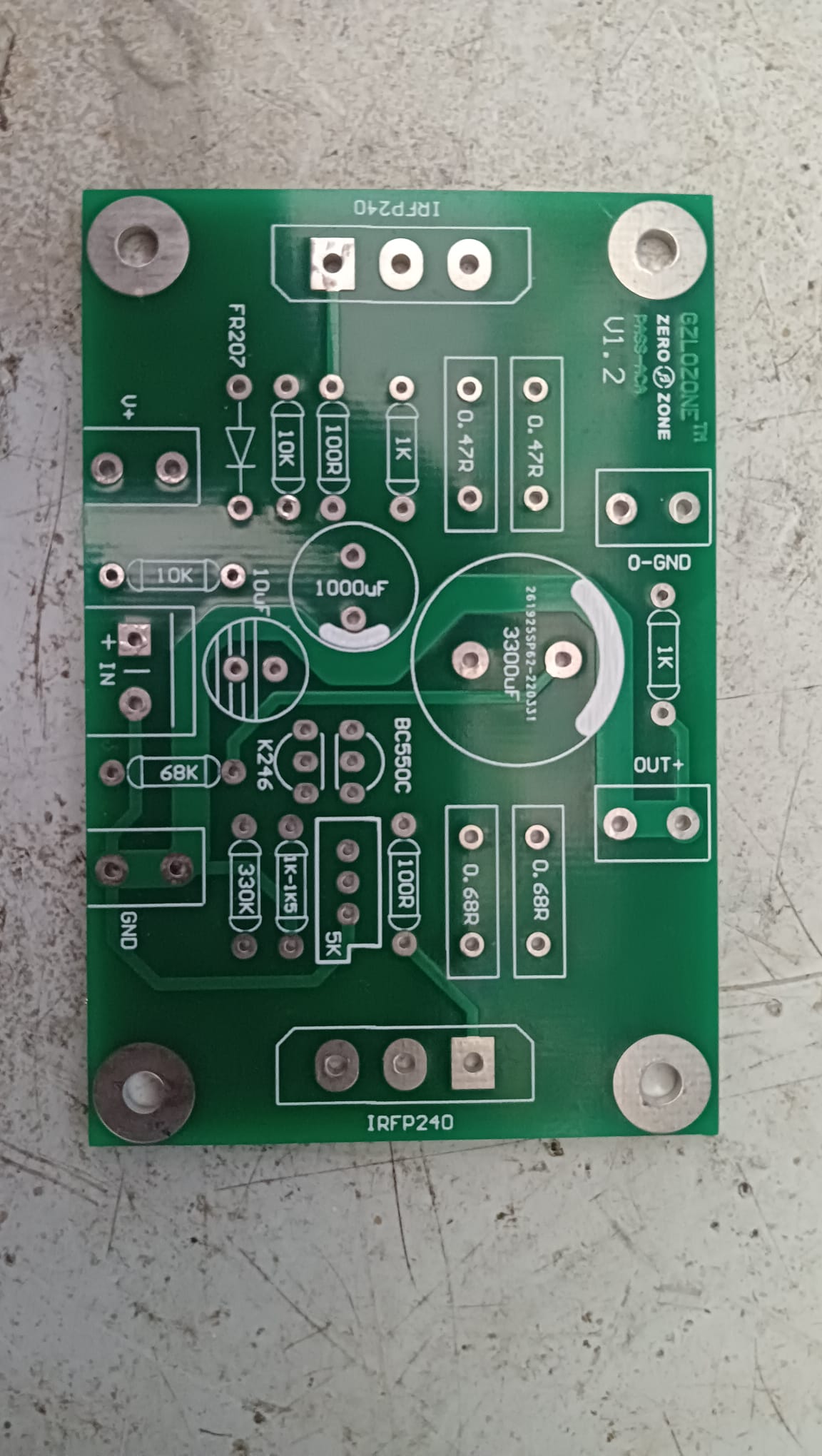

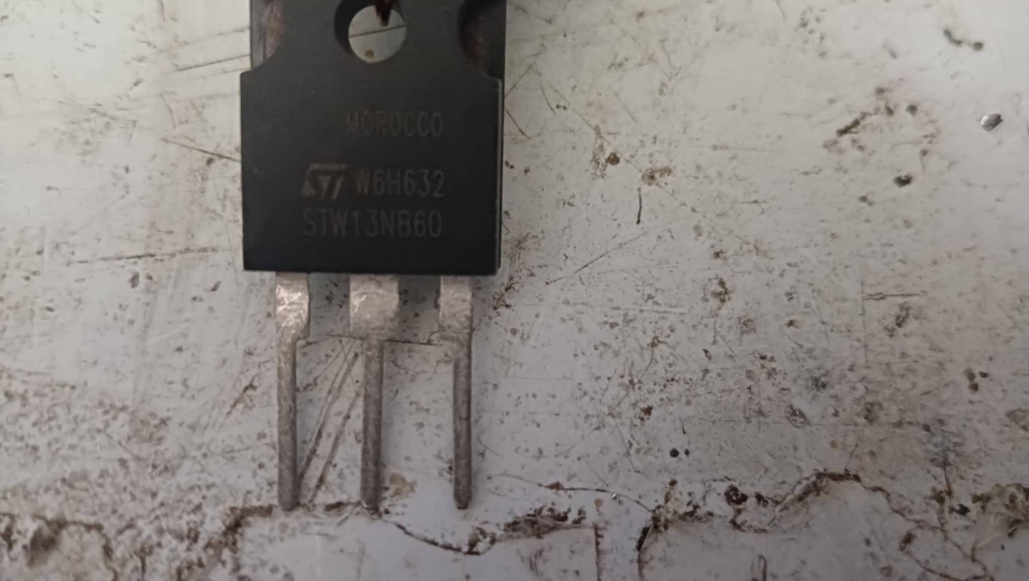

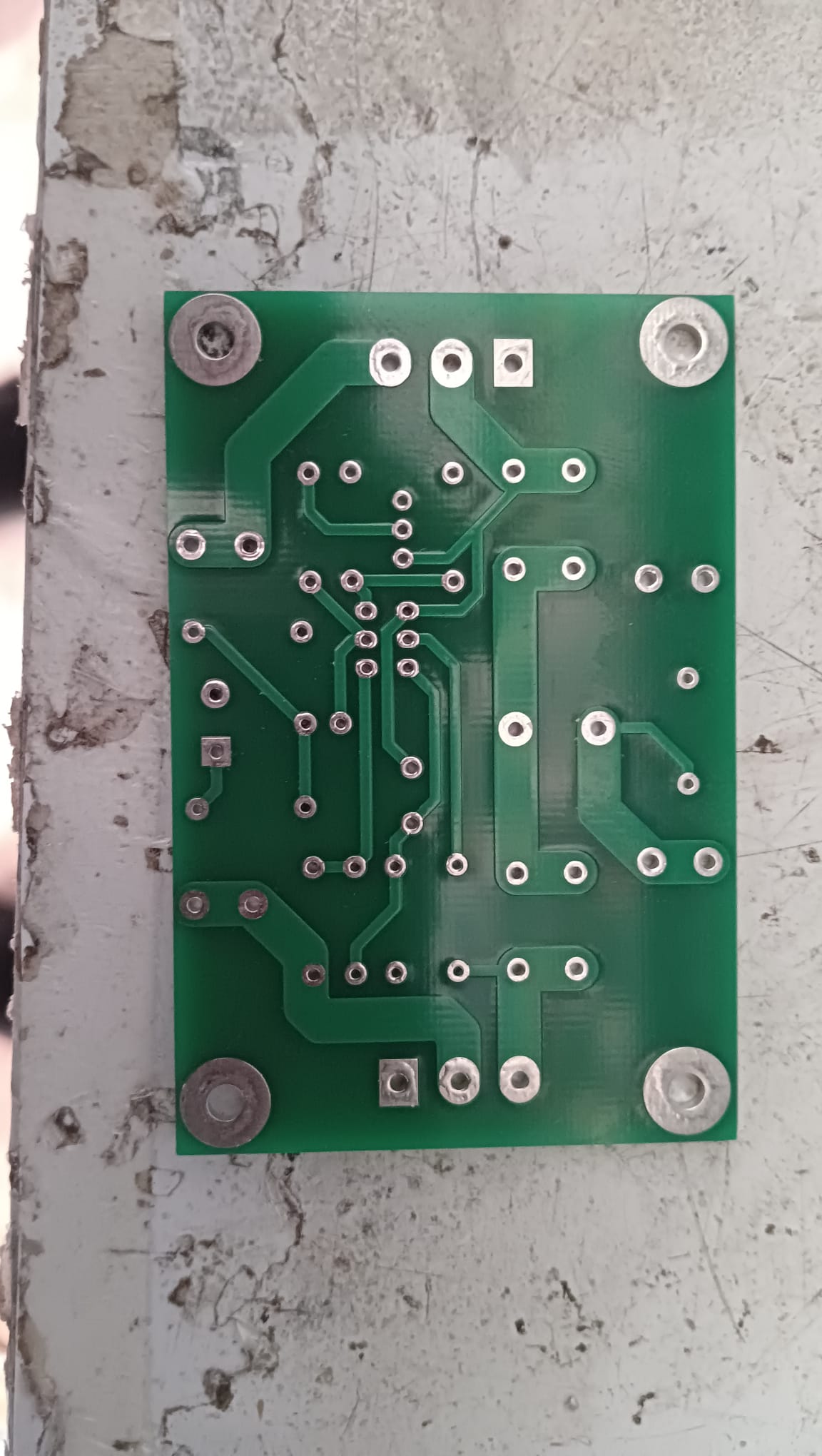

Hello and Happy New Year everyone. I have two pcbs from Aliexpress, as I will show you below, but the schematic is somewhat different from anything I found online. An FR207 diode appears and the 2k21 resistor is missing. Does anyone know this variation? I also have 4 STW13NB60 transistors and I would like to know if I can mount them here. Thank you in advance and I wish you much health and happiness!!
I think you can either solder a link in the position of the diode or that would be a convenient place for a resistor in case you want to increase the supply voltage and limit the voltage across the input jfet.
The 2k2 resistor you'll have to solder yourself according to the schematic. Not difficult at all.
Just check the build guide somewhere here on this site.
I also think you can use that power fet although it's a high voltage device with a rather high Ciss. Maybe someone else will chime in with a more educated opinion.

The STW13NB60 has a high Vgs, called the gate threshold. This will make it difficult for the ACA circuit to achieve the right bias current. The high gate capacitance Ciss may prevent the amp from sounding good, even if can be biased with enough current. If you can find IRFP240 or IRFP140, those would be much better.
Buying Zero Zone boards from Aliexpress is an unfortunate choice. Zero Zone has a bad reputation for making poor copies of Nelson Pass amplifiers. Aliexpress does not offer support for the products they sell.
