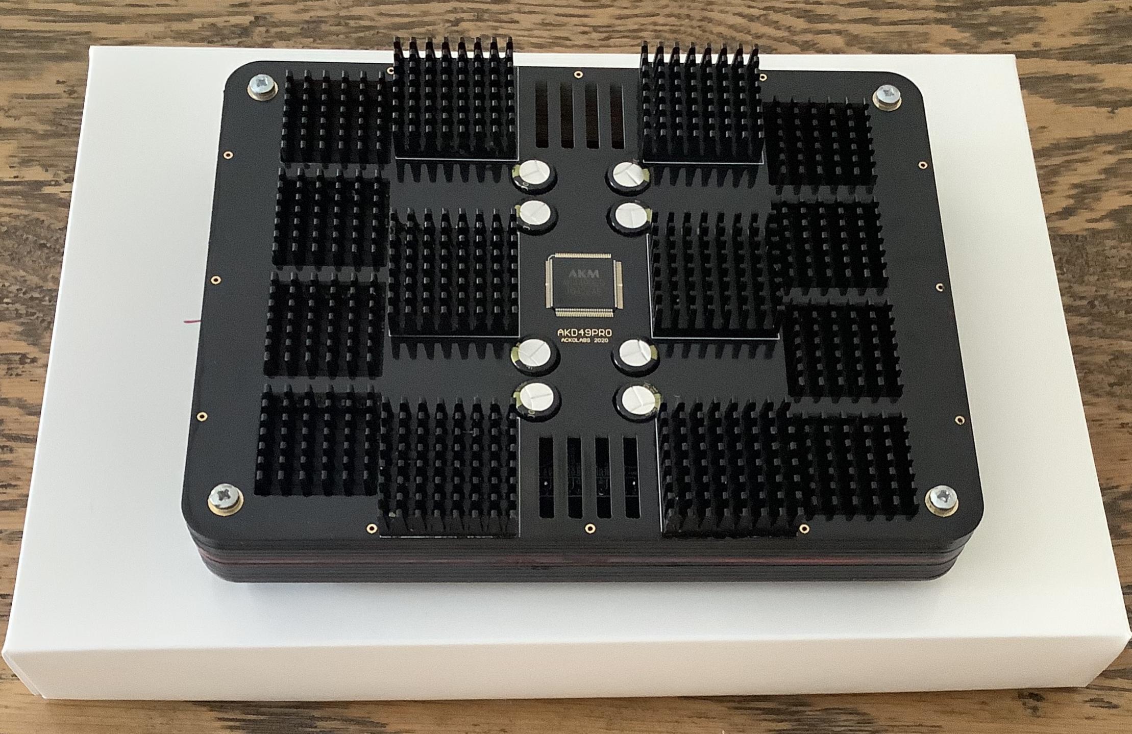

The pic actually shows the module with its gnd shield that has some impressions of component positions. Underneath is the actual DAC board with all the components (more than 100) mounted. So nothing really to assemble here and you just need take it from the simplified interface for power and I/O:). Those who have pre-ordered will get more details of the board assembly and its interface. Basically rolled out as an oem module but also suited for diy work. A single module can be configured for 2ch stereo (or 4 ch). For dual mono you will need two of the modules.

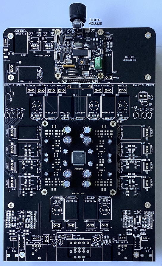

The good news: things are looking up with updated stereo solution now in fab as shown. Won't be long ...
Then Dual mono and Multichannel versions. Really complex designs but pressing on!
