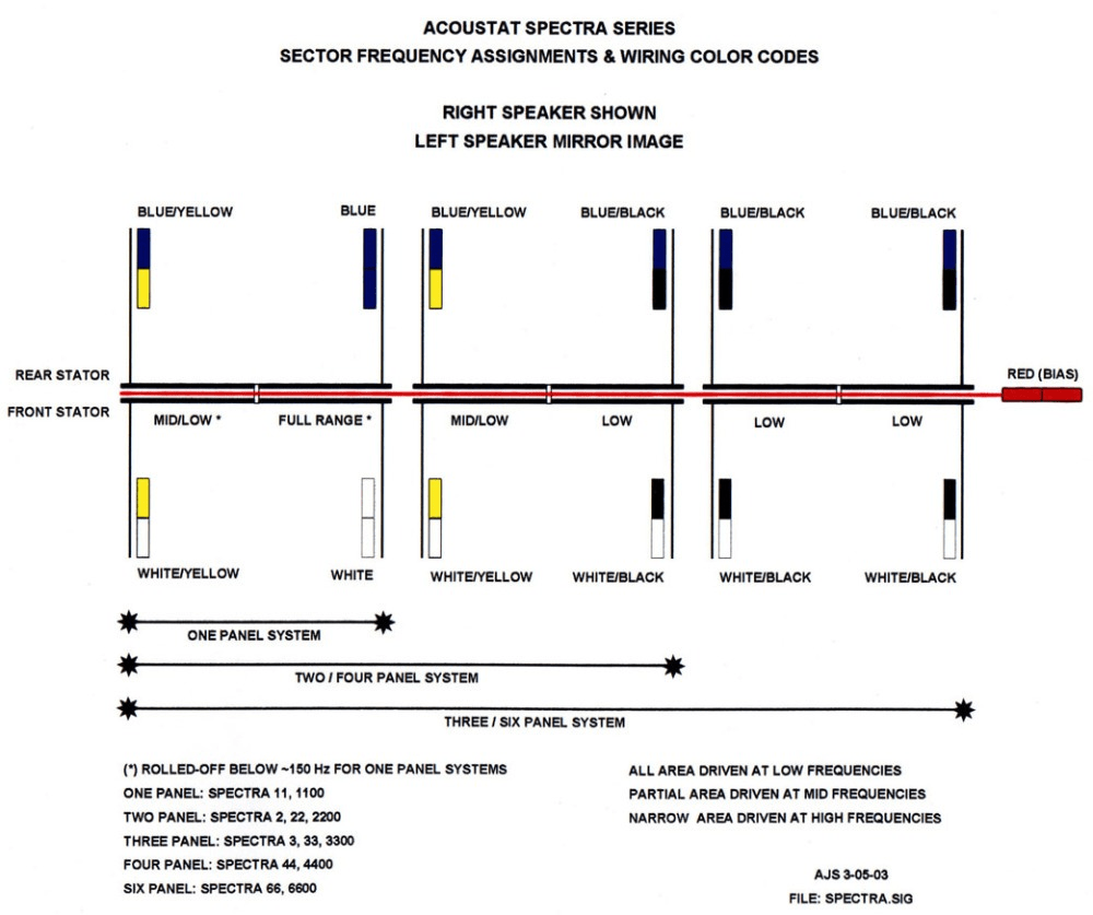

Thanks for your reply. How would it be different?
Here's the diagram for the Spectra series. As I understand it, it shows how the panels are wired if 1, 2, 3, or 4 or more panels. With 4 panels, it would seem to be a set of two panels on top of two panels, with the top two panels wired the same as the lower two panels. Please explain how it differs...Thanks.
That is just the panel wiring diagram.
The pre-spectra models had 3 different bass transformer taps, to reduce the amount of bass, as number of panels increased from 2, to 3, to 4 panels. (whether 4 panels were all side by side, or stacked 2+2)
The Spectra interfaces do the same by having 2 different transformer taps for 2/3 panel systems, and different transformers with 2 different taps for the 4/6 panel systems.
So, panel wiring is the same, but the gubbins that feed the panels are different, as the number of panels increases.
Cheers
Gn
Bugger me you must be right.
Identical then. Get some Spectra 44 badges and you are done, just like a factory pair then.
Gubbins is the stuff inside the boxes, resistors, transformers etc. They are different values and turn ratios respectively, but you must be right because how can that be making any difference when the diagram above of the "panel wiring" is the same.
Best of luck.
Cheers
Gn

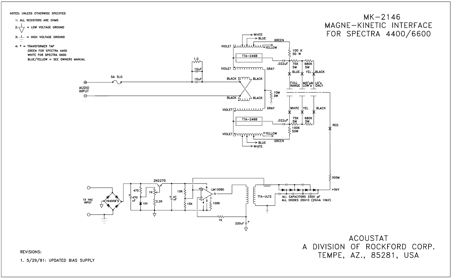

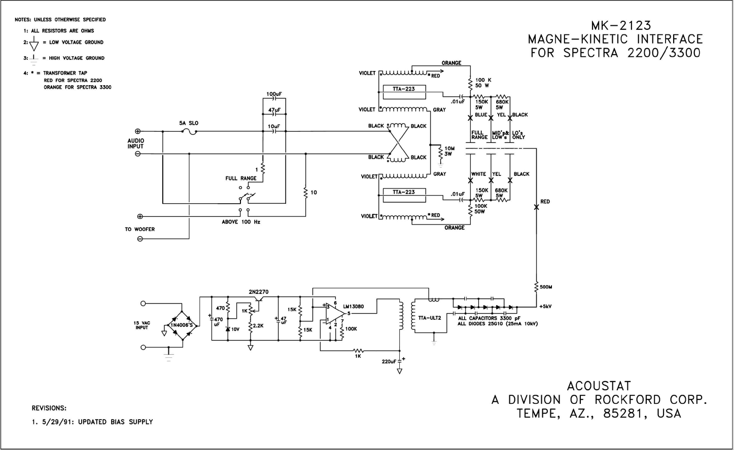

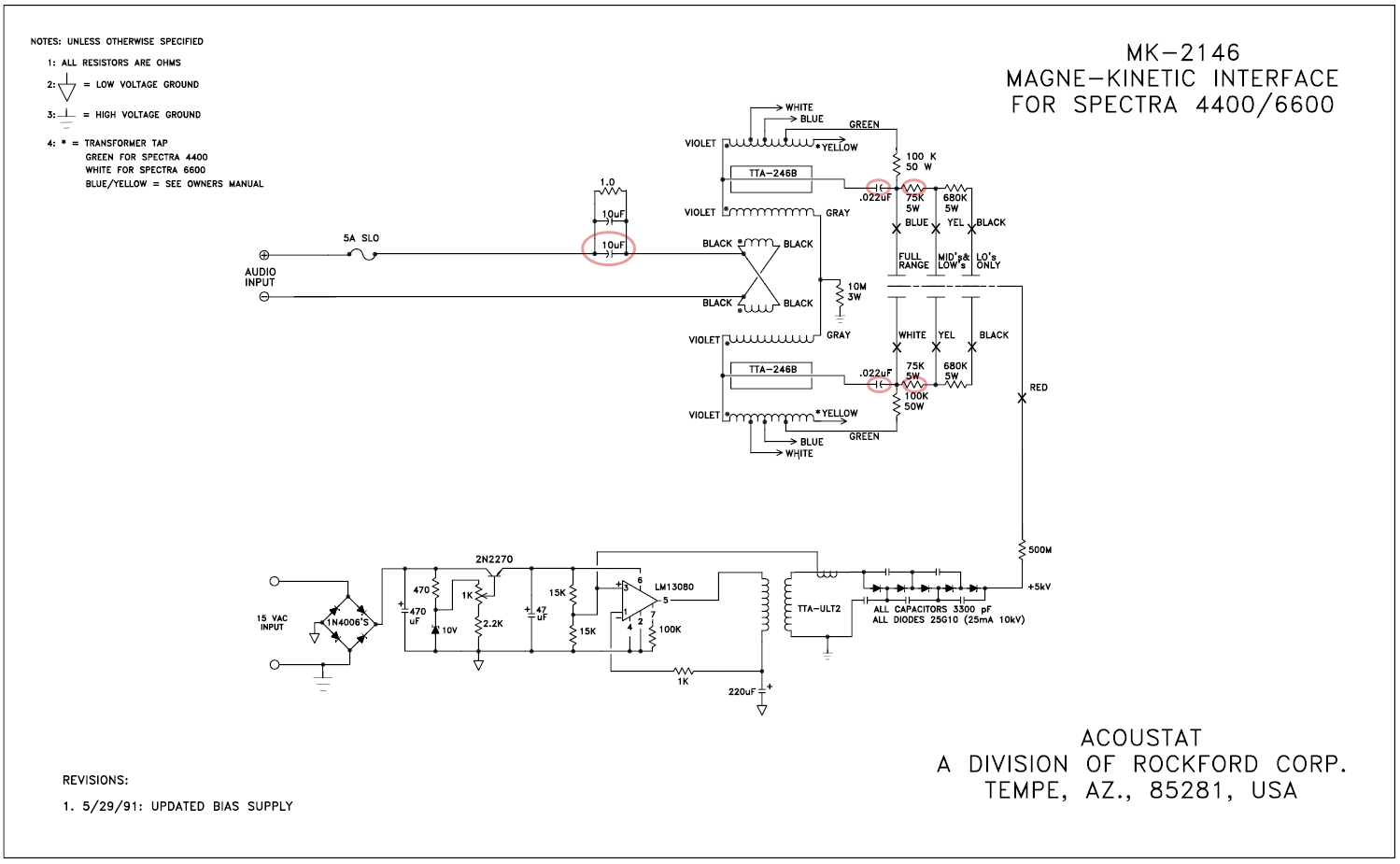

There are some differences between the internal components(resistors capacitors) used in the Spectra22 and Spectra44 interfaces.
They are different to provide the appropriate EQ for the acoustic response of a shorter(22) or taller(44) line source.
But, as gnnett already mentioned, you could leave the Spectra22 interfaces as is and just use upstream EQ to tailor the response to your liking.
The most appropriate bass tap to use when stacking a pair of Spectra22s to emulate a Spectra44 would be the orange wire.
* NOTE *
Many of the previously posted Spectra22 Schematics have orange/red color labels for the bass taps incorrectly swapped.
Reactions: 1 user
That makes sense, thank you!
So, is the schematic for the 2136 interface which you have posted above correct with respect to the orange and red wiring indications, or does this schematic have the red and orange labels incorrectly identified as well?
Is it possible to swap components in the 2136 to make it compatible with the 2146 for use with 2 sets of stacked Spectra panels?
Thanks again.

As I said above, your explanation makes sense, but after considering this a bit more, I should think that if there was a different eq being applied by the interface in the MK-2146 for upper and lower panels, the wiring diagram I attached above would not only differentiate between panels side to side, but also top and bottom, yet it makes no mention of the latter. How indeed would the two upper and two lower panels be wired in the Spectra 44? Any ideas @AcoustatAnswerMan ?
No it is not eq'ed differently vertically.
Please re-read what I said there about the original MK121 series.
In the original dual transformer series (MK121) the driven panel area dictated bass eq. The original 4 panel wide version has the same bass eq as the stacked 4 panel 2+2. The 2 panel (single height) model 2, uses the same bass eq as the stacked 2 panel 1+1.
The same applies to the bass eq of the Spectra series, with less bass for each increase in number of panels.
Interestingly, because this can vary with room size etc, the Spectra 44/66 (refer schematic above) provide 4 taps, two additional to allow modification of bass output, to suit room and taste.
To duplicate the 44/66 you would need to modify the resistors, capacitors AND swap out the transformers.
You could try it and you may have a large room that soaks up the extra bass energy, or it might suit your personal taste. Alternatively you could use DSP, or other eq methods, to achieve an even better outcome than factory. YMMV.
