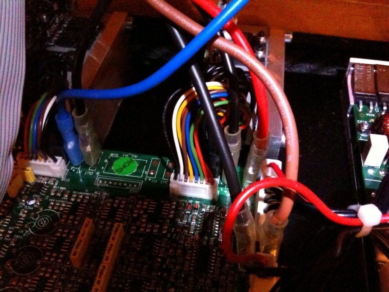

Yes, there is indication on the board and it is wrong, which I find interesting. Both because one of my ribbon tweeters is wired backwards (black is positive) and also with both Speaker A and Speaker B (and also that of another S3A user online) the midrange speaker is wired with black having to be the positive, otherwise the speakers have no bass. I confirmed on the woofer side that e.g. red is the + but it is incorrect.

Why should it be wrong ? At least you should have equal polarities in both channels.
Wiring on the drivers itself should be unchanged by the repair workshop and can be
assumed to be OK as it came out from manufacture. You have to consider that tweeter
polarities are frequently reversed with certain forms of crossover.
The + symbol of post 191 does not apply. Red is "positive". Do not mess everything up.
You can safely assume that they did not open the driver side.

It's 'wrong' because for the full range driver, the black must be connected to the + on the green filter board, otherwise the sound is extremely thin - less bass than NS10s. It's placing the sub only and full range driver out of phase with each other.
Further - the tweeter in speaker B is reversed polarity re post 191 - I'm afraid it must apply for speaker B as it simply throws everything out of phase if connected the other way. I tested all the combinations in my studio and it's not subtle when they are out of phase.
The Adam Repair person connected it as would be logical - coloured on all three +tive filter board connections without actually listening. Again, this results in an out of phase sound. The black on the full range driver must be connected to +tive. This is also how it was on Speaker A, unlike how it was on Speaker B when I got it back.
Here is another photo (from a different angle) from an old post from a user on Gearspace.com showing his Speaker A with the same configuration - the black is connected to +tive and red is on negative, same as mine.
Brown is on positive and black is negative in that case. This is the sub only woofer connection.

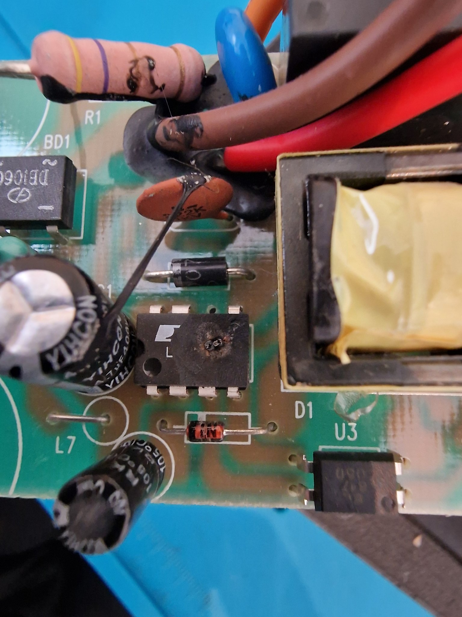

One of the 2 made a pop and the power cut off. So far, I have received the power and standby circuit from Adam directly. (willing to share with you if you would like)
So far, I have repaired the 4R7 2W safety resistor and the LNK364PN IC. This IC was obviously damaged.
When I reassembled the speaker I got power and audio again. After a few minutes a noise/hum started which was getting louder. I had to cut the power again to prevent any further damage. Could you point me in the right direction, and if possible with more schematics of the full speaker?

What I see on the picture looks like a switch mode power supply.
Perhaps it can be bought second source.
The glue you see, black in the meantime, is corrosive. it has to be
removed completely if possible. Look for damaged wires etc under
the glue.
With a SMPS it is essential to find all bad components.
the glue.

After replacing the IC (U1) and the safety resistor (R1) In the stanby section I got power and audio again. However after a few minutes of playing a humm/noise started to come up. I am assuming there is something else failing in the other circuitry what caused the standby circuit to overload.
I will also remove the black adhesive to further inspect.
