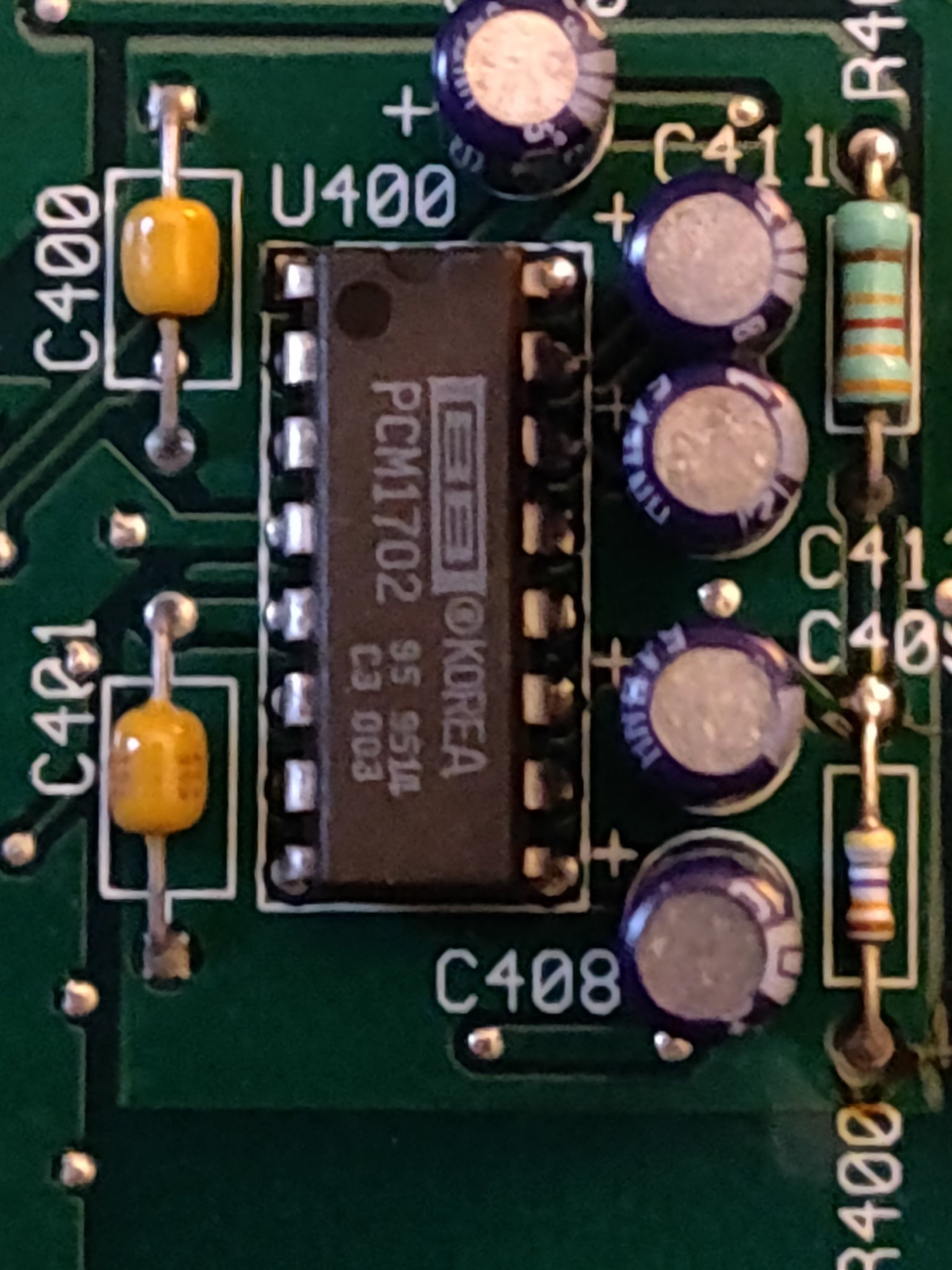

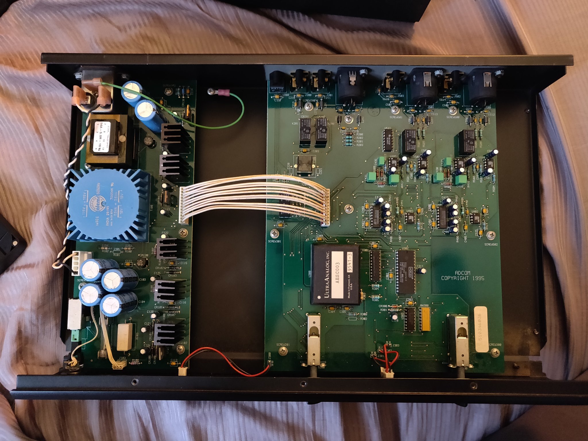

Yesterday I received a great condition Adcom GDA-700 DAC. My first experience with the PCM1702 chip, I like it! I have a Audio-GD R-1 NOS already and while it is pretty amazing, I've never felt like I completely vibed with it, mainly because the sound stage is so very in my face all the time. Now with the Adcom, I am hearing pretty much all the same detail but with a much more dispersed and pushed back soundstage. And for about third of the price, this is a win for me.
So I figure now that I have it, it would be worth it to tinker with OP amps and replace some parts since this guy is from 1995 😎.

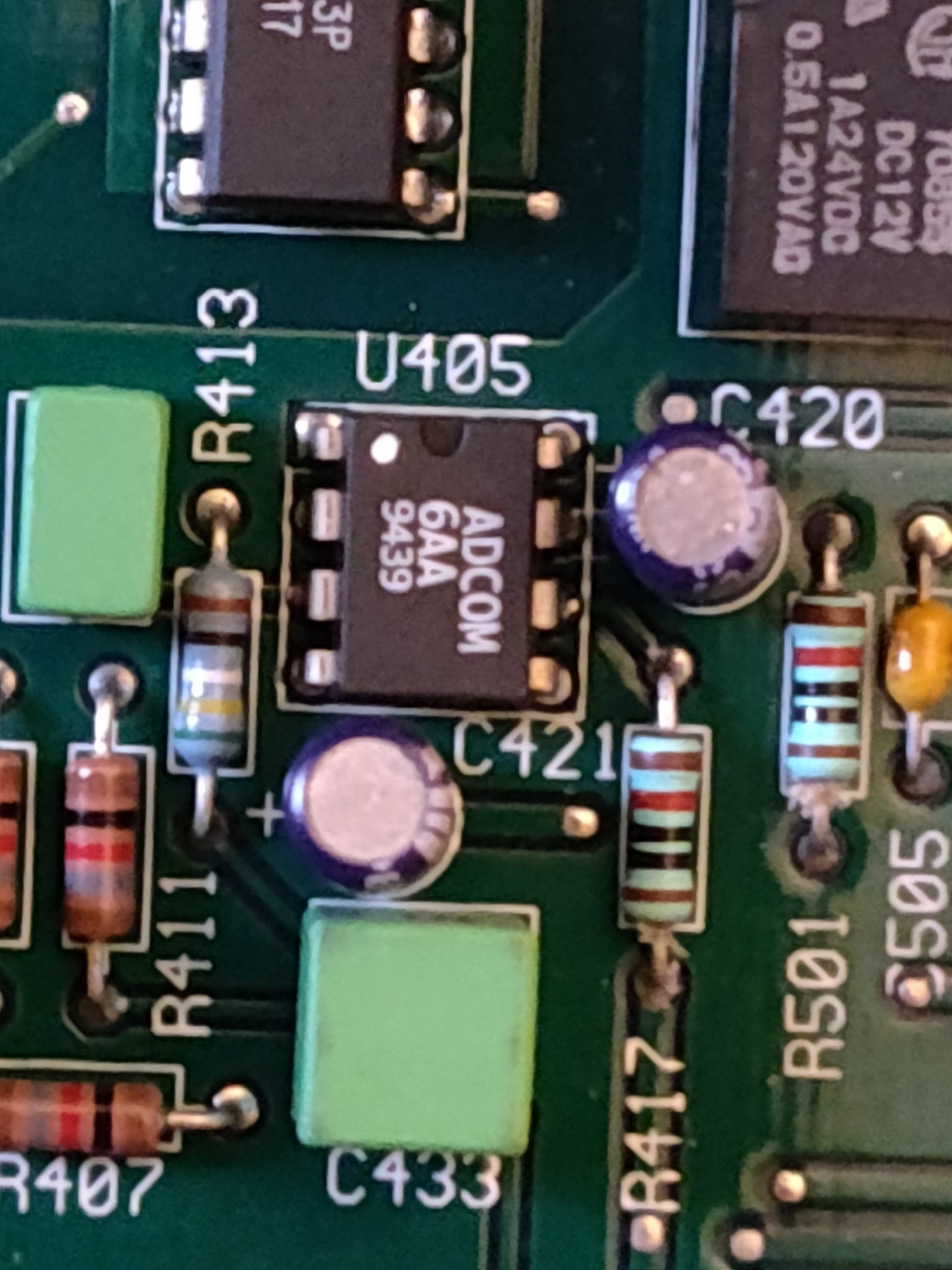

I figure the sound quality can only go up from here. Problem is I don't know/don't really understand how to choose replacement OP amps. I get the general principle but frying my new dac would really suck. I did some digging and found this post for modern OPA alternatives: https://www.diyaudio.com/community/threads/adcom-opamp-semiconductor-replacements.339904/
The ones in the GDA-700 are ADCOM 6AA 9439. According to the chart I can use OPA604 or AD711. I would love to use some sparkos SS3601 OPAs but I need to know if they aren't compatible.

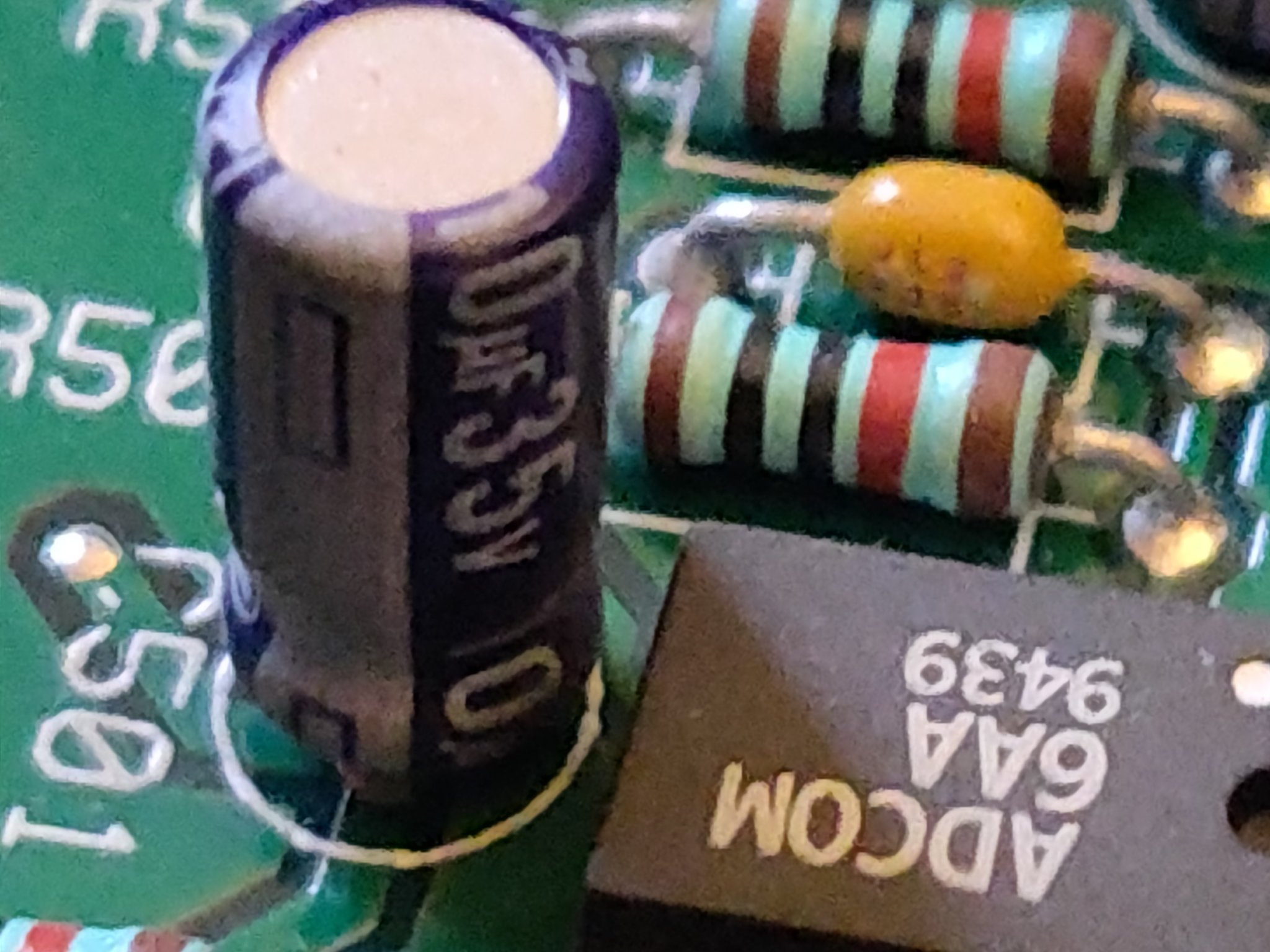

Other than the OPAs, is it safe for me to order all new caps with matching uf/V ratings as the ones already installed? A quick search led me to these caps:
https://partsconnexion.com/products/elna-capacitor-10uf-35vdc-roa?_pos=1&_sid=c38316f85&_ss=r

Rather than OPA604 or AD711 (which is what the 6AA already is) rather choose something more modern and lower noise. Probably you would need to use it in a SOIC-DIL adapter as the more recently designed opamps tend not to be available in DIL. OPA1641 like this : https://www.aliexpress.com/item/1005006537987334.html
