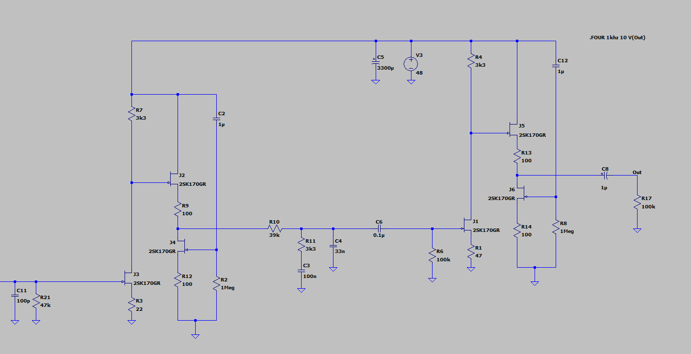

I want to have a schematic from this FET RIAA Preamp for removing unwanted AM reception:

Thank you for upload schematics from oTTo's jFET version like to see in the attached images

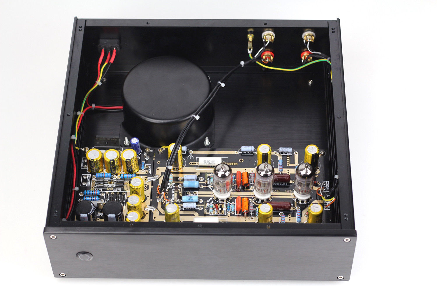

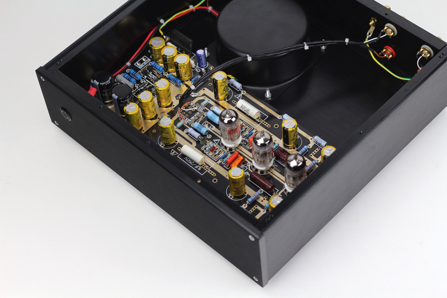

Since you have the pictures of both sides of the PCB it is not that had to make a drawing of just the first stage. Add an input filter to stop AM reception that does not interfere with the device its qualities and you are done. Yeah those old fashioned input filters, no one seems to need them these days It was a long time ago I was busy with phono but I guess ferrite beads in the signal inputs could also be sufficient. A 100 pF ceramic disc type cap for each inputs GND to chassis might also help in case AM reception is coming via the screen of the cables. Do you use the GND screw as mounted at the back of the device?

according the circuit description schematic looks to those under
http://diyaudioprojects.com/Solid/JFET-Phono-Preamplifier-Kit/diy-jfet-riaa-phono-preamp.html
but with additional buffer-jFET like here
https://phonoclone.com/diy-pho6.html
an complete other approach (here from Renardson Audio) is the use of NFB RIAA network
https://www.renardson-audio.com/phono2.html

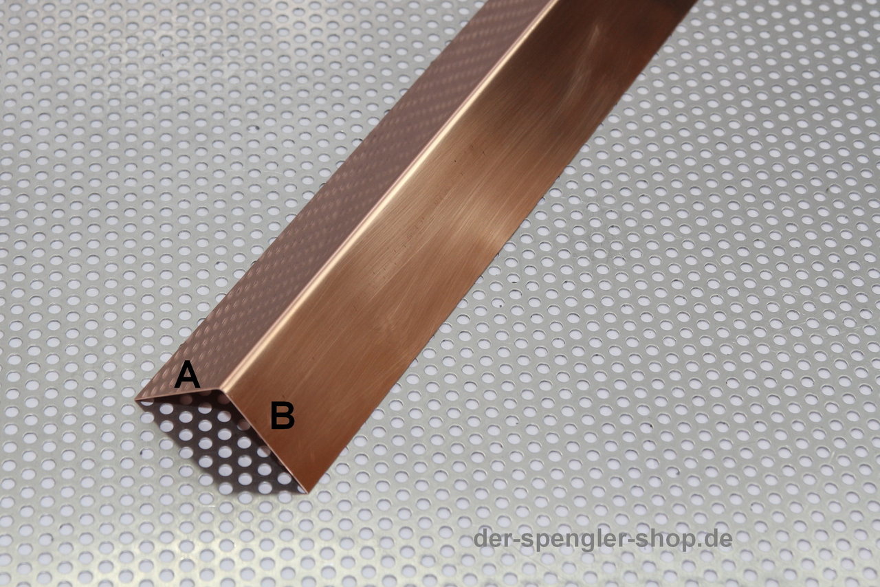

helps sometimes. But most effective solution is a very low (zero) induction connection between ground-plane of PCB and the aluminium enclosure (chassis).
This means no usual cable wire as to see in the attached images (last attachment go to page 2 last image) because the envelope operates as RF antenna due the cable inductivity of this cable. A copper angle profile is the best solution - so I think.
