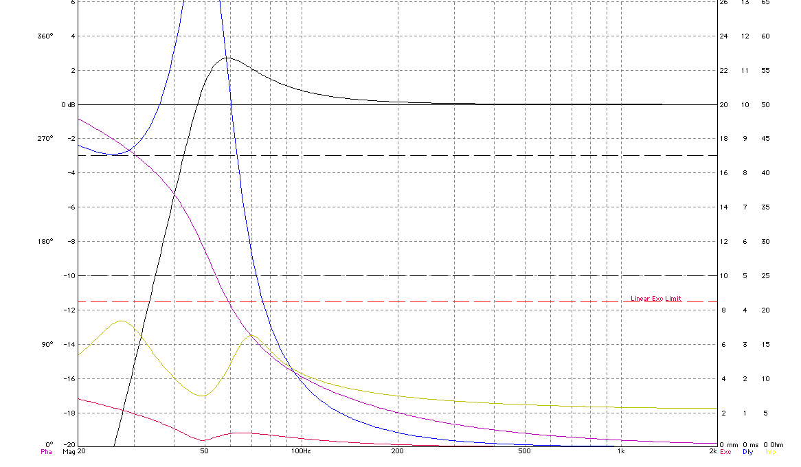

Interested in building some enclosures to run some tests.
Sealed Enclosure (Sphere) 1.25 cu.ft
Egg Shaped Rectangle 1.6 cu.ft staggard with a 3" port 7" long below it.
Testing some builds to try and accomplish flat response across entire bandwidth 20-20khz possible thinking of using a passive radiator to assist the driver.
Please Advise ......

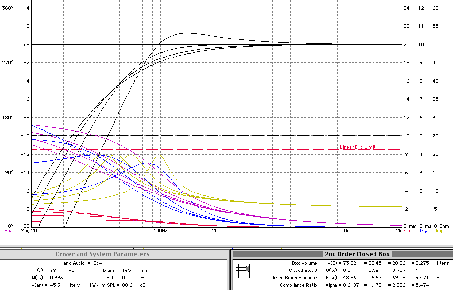

You are unlikely to achieve that. The A12pw. Scott’s ML-TL reaches into the low 20s F10. The A12pw is a wide range and starts to fade above 10k. Still very listenable as a full-range. And a very nice one. I like it better than the A12p.
We already have an MTM in Scott’s ML-TL with an A7x. We are also working on one with the A10p in our large Mar-Ken enclosure.
1.25 ft^3 ~35 litre, you’ll get in the low 30s F10.
The reflex enclosure has a pretty ungly bump at resonance, it needs to be tuned lower.

I will probably use a egg shaped to tear drop type enclosure to reduce backwave, diffraction, drag but my question to you would be the optimal airspace to accomplish flat broad range response even if its starts to fade on upper and lower end?

To achieve the bass performance of which this driver is capable will need something much larger than a small box of any shape and PR.
