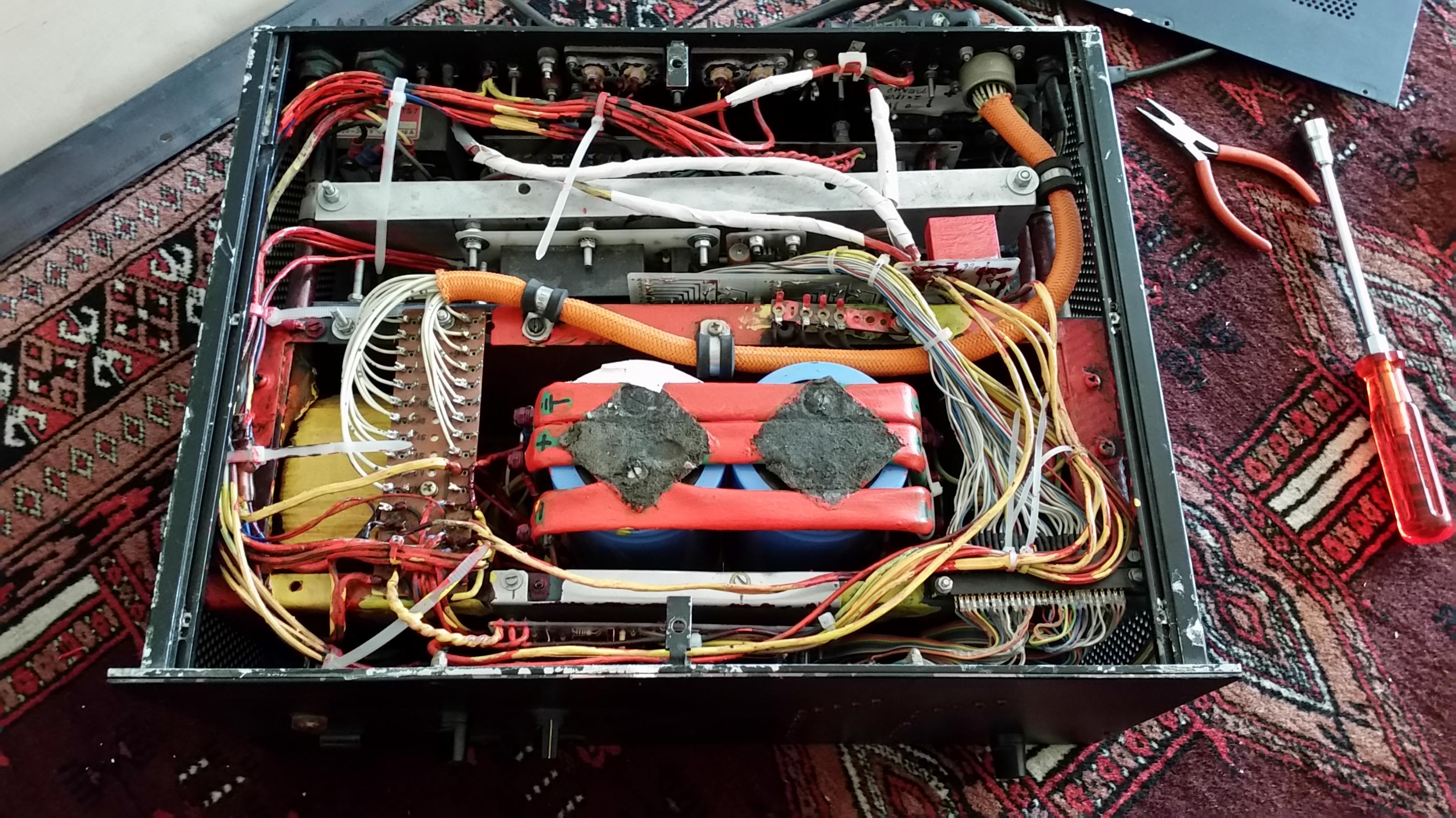

I just bought a buzamp from Germany.
It looks like **** inside, even if parts are of good quality. Someone really likes paint :)
I fixed some bad contacts and would like to adjust BIAS, trimmers were firmly glued and difficult to replace, but my questios is, what is proper BIAS?
One channel was about 80mA and the other about 8mA
I would have thought 100-200mA is good?
Supply is 2x55VDC and there is a big enough heat sink.

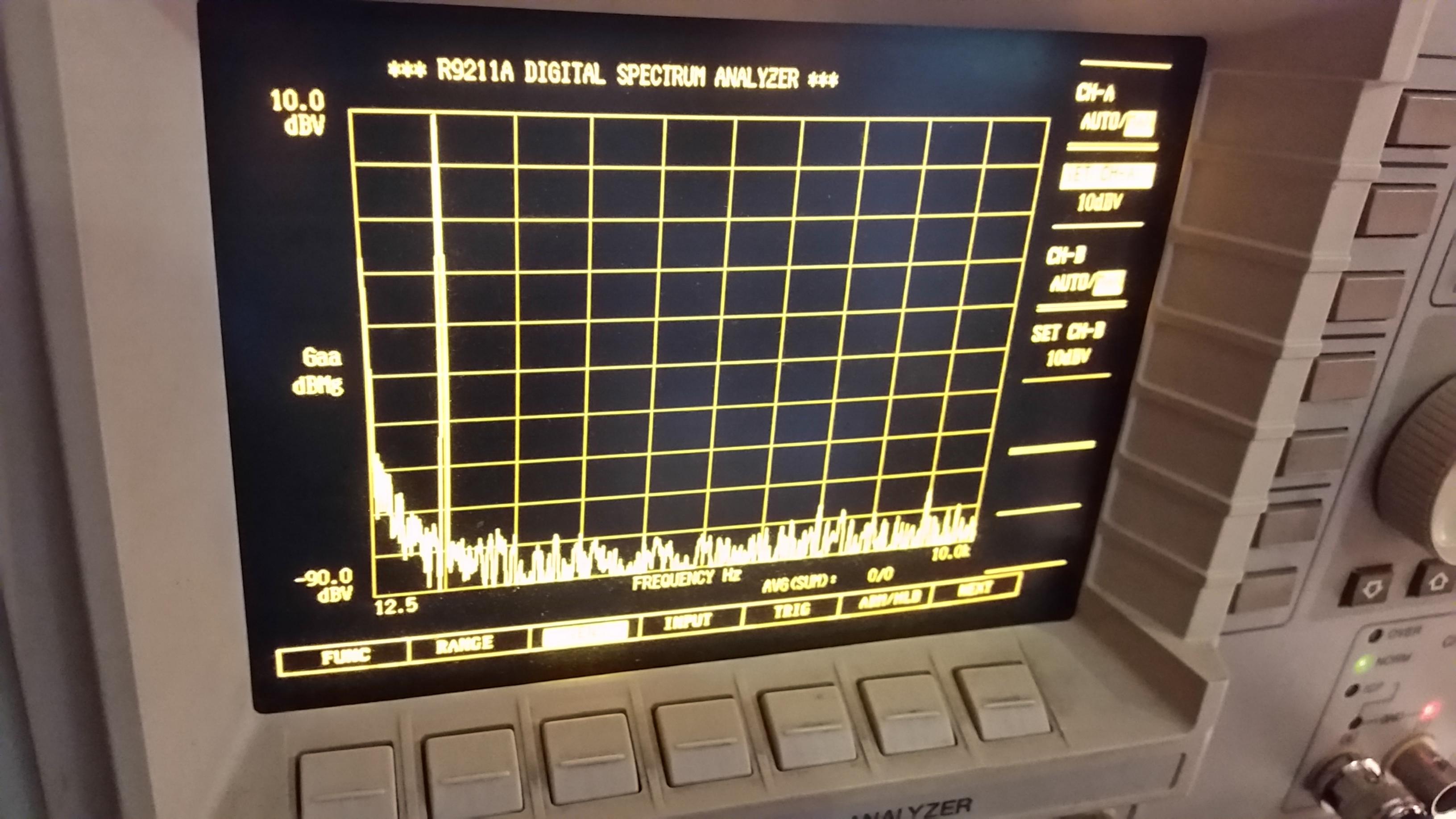

Still wondering what the BIAS is meant to be, but I got quite far by measuring and tuning :)
Anyway power fets were far from matched, but I adjusted so that lowest voltage over 1/4ohm resistor bunch was 14mV = 56mA
I guess the highest was up to about 200mA then.
Results are pretty impressive for such a garage build. 1W 1kHz 7ohm
Must say I am also impressed by the simplicity of the signal route.
Maybe this is a good design after all!

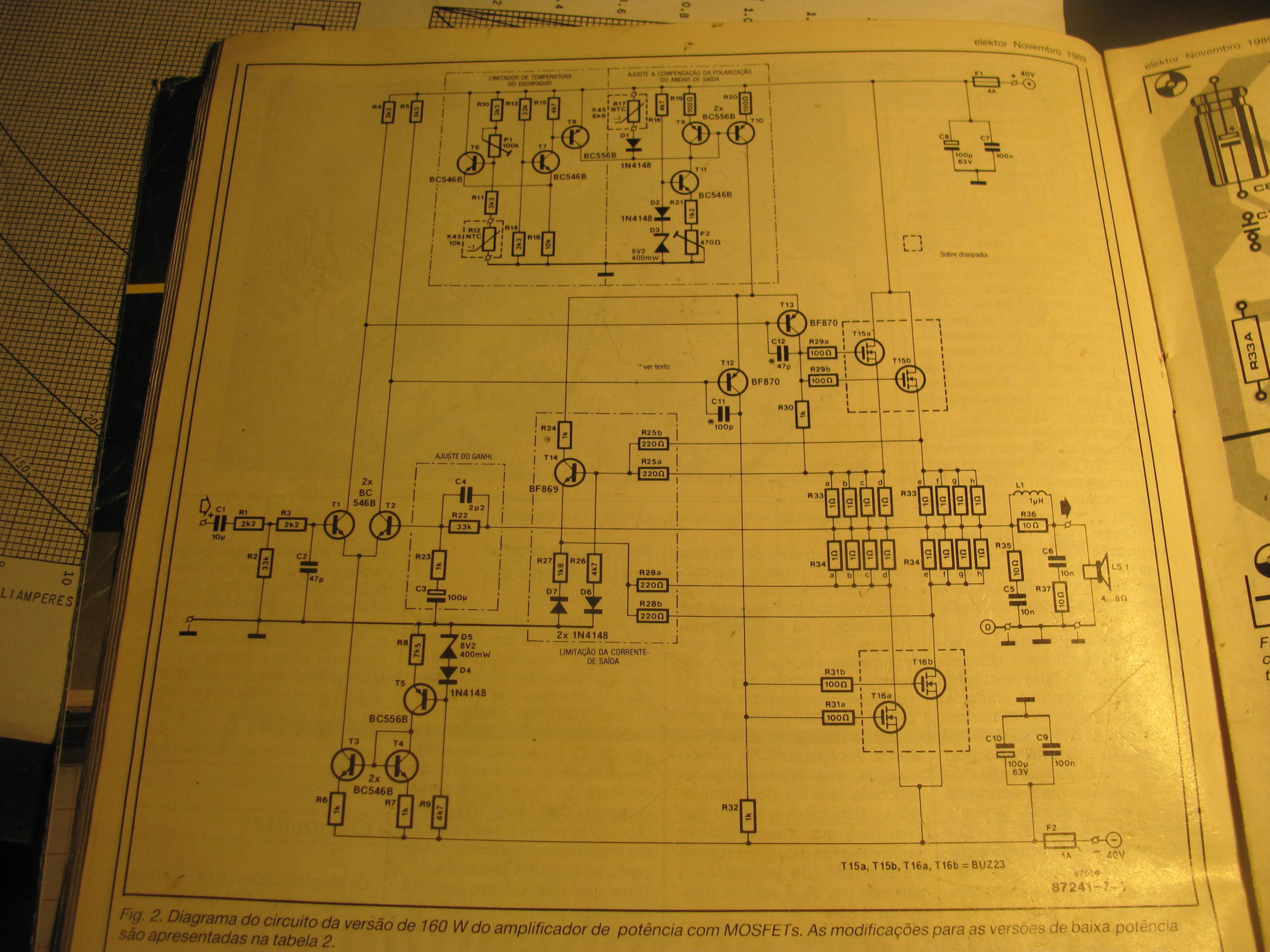

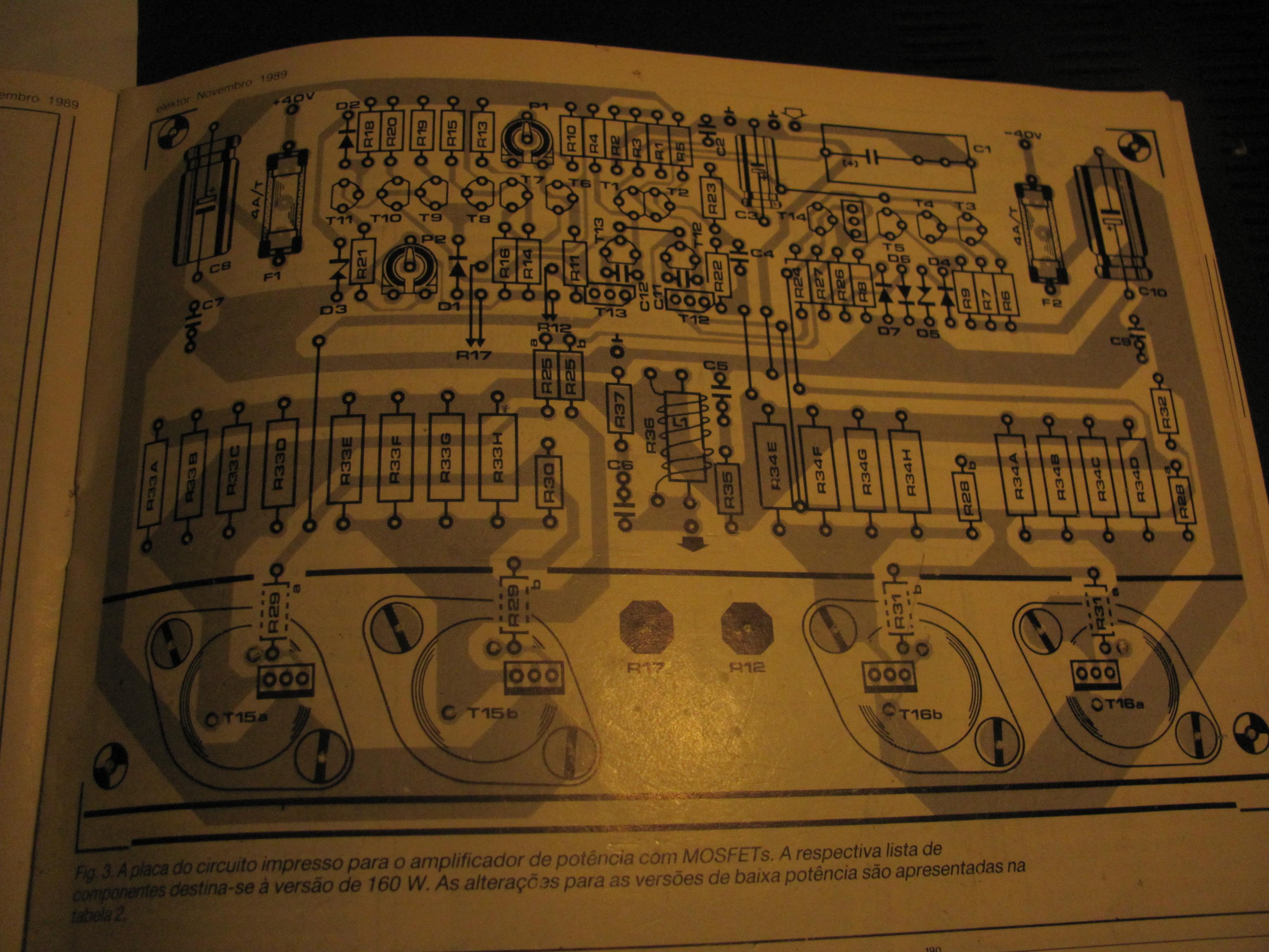

Oh it was in Portuguese. Well if you find the BIAS value please tell me. And also how to adjust the temp protection. I guess I could figure out this much myself too from the text if I had it.
On some forum I found some text in German, but it had to be missing something, as I did not find any mA values.
Sorry if I was unclear in the beginning. My buzamp is the one with two BUZ23 FETs in parallell as in el156s photos :)
