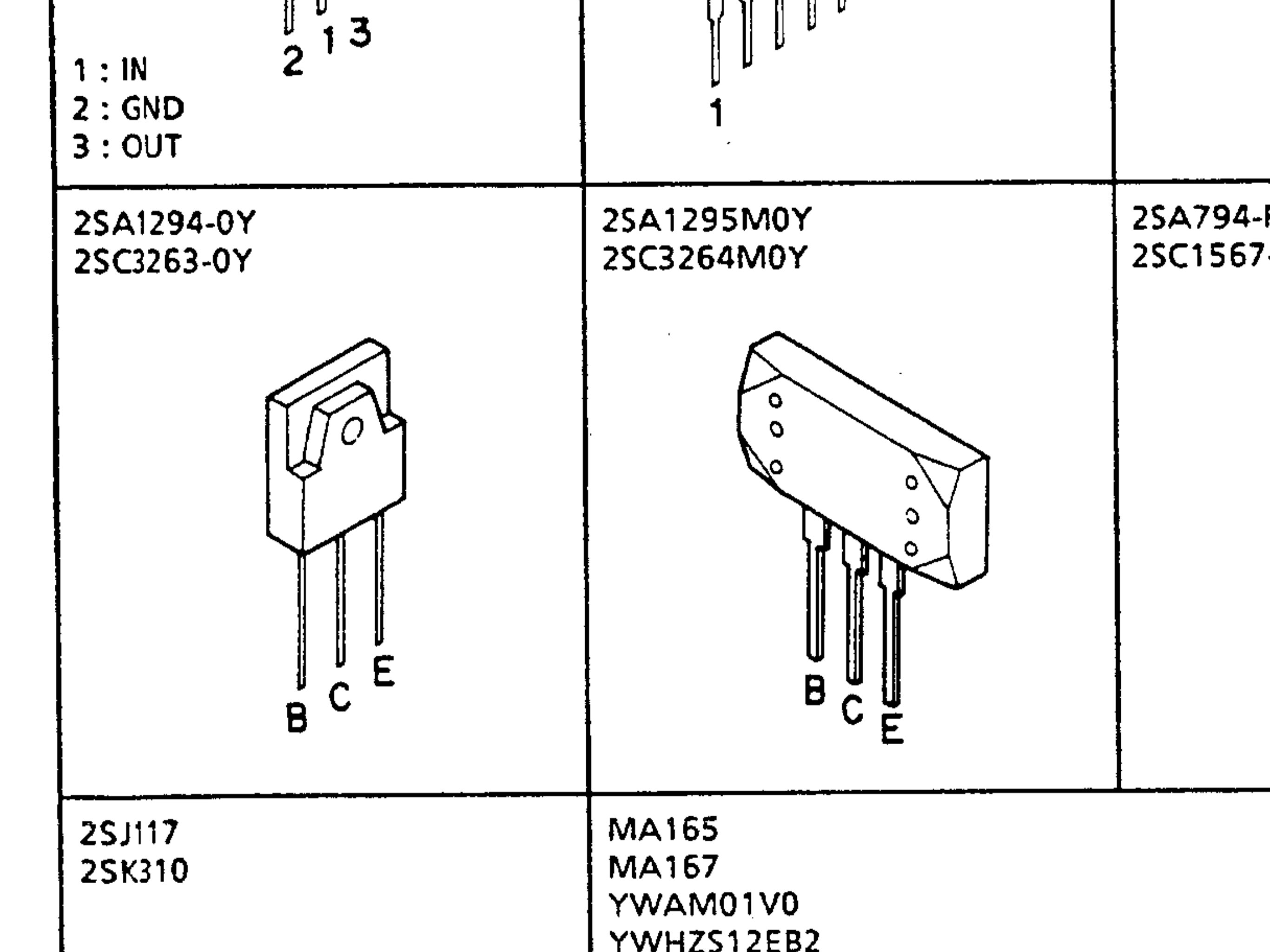

Update on the situation: unsurprisingly there's unwanted voltage all over the output stage. I measure about 44v on the emitter pins of all transistors (the transistors themselves do check out though when tested on diode setting and I measure +55 v and -55 v consistently on the center pins). The same 44v is measured in the little white sockets that are apparently used in the factory to read out bias transistors.

Usually centre pin of output transistors are the collectors- where power supply voltage is 3rd pin is Emitter
See pic - most outputs are either of these formats
