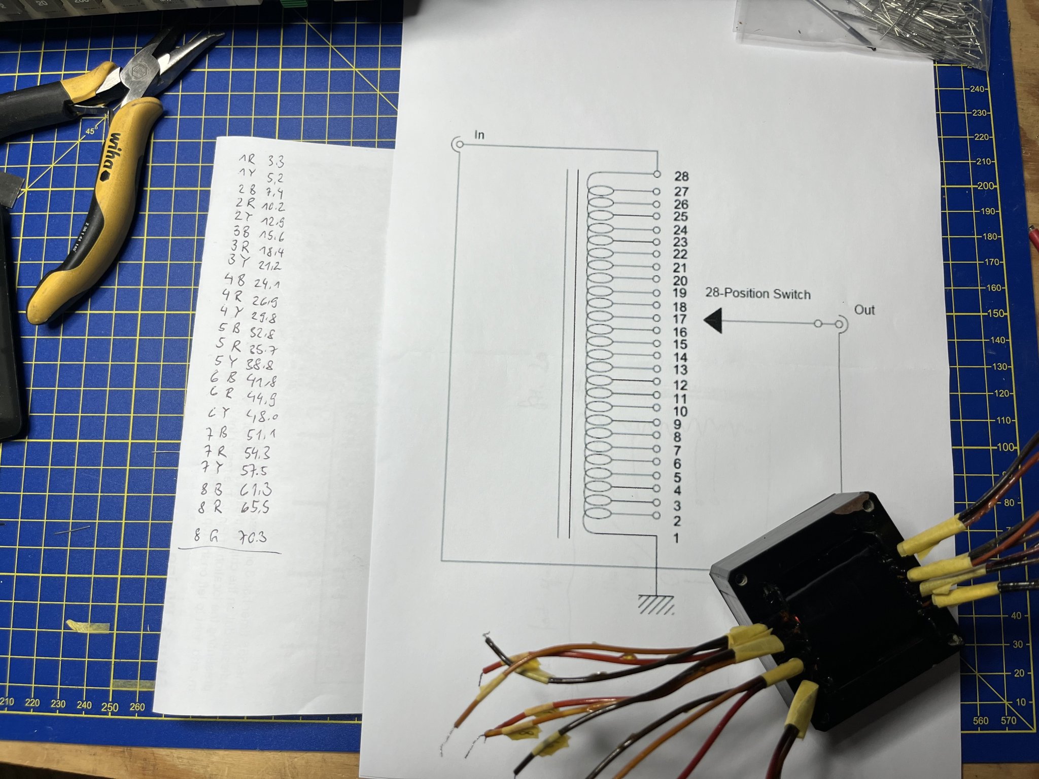

AVC - is this the right way to connect?
Joined 2017
Good morning to all!
While I'm wading through my various other things, I found one that's bugging me:
the build of a AVC, with autoformers (23 positions) I got from a serious guy in germany.
He's not very responsive though, thus I'm asking for confirmation here:
The correct connection of the Autoformer to the switch seems scary easy. So, according to the schematic from a different place, is it
  • first wire to input hot,
  • 2nd - 23rd wires to the positions 2 - 23,
  • switch output to next stage/output
  • in/out GND tied to AVC #24
While writing this, it seems to make sense, like being pretty close to the schematic.
Right?
