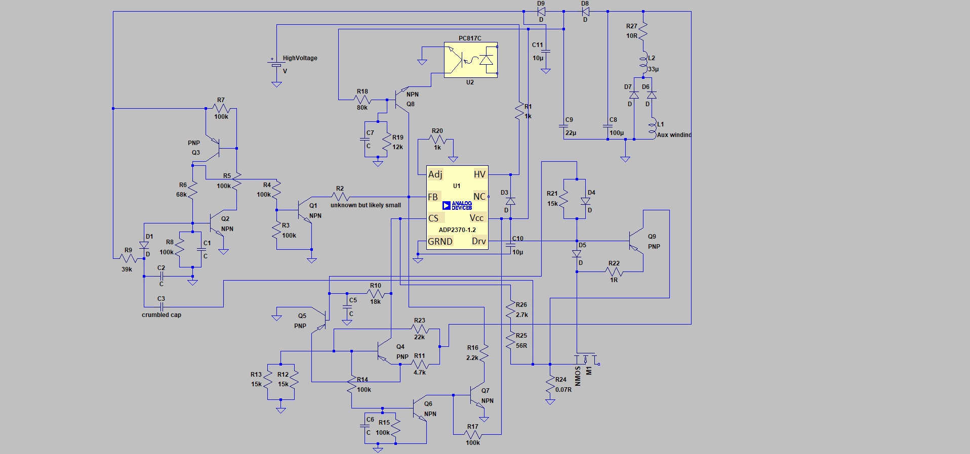

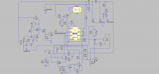

Ok time to bring this up a notch as I've finally managed to make a schematic of the circuit surrounding the NCP1203 in the power supply. B&O certainly didn't keep it simple!
The capacitor values are obviously unknown. If necessary I can pull them from the circuit and measure them. Obviously really small values are a pain to measure.
In removing the sense resistors for the schematic C3 crumbled away, which in hindsight is probably a good thing, otherwise I wouldn't have known it was busted. Either way I have no idea what value it should take.
D1 is most likely a zener, it was dead on arrival and I've no idea what value it should be. Other things were also broken, but as far as I can tell, I've replaced them successfully. Hopefully all the replaced, small signal, BJTs are the correct polarity.
The circuit doesn't start up. I've had it started by powering the NCP separately and I've had it regulating correctly too. But alone, it wont start.
So anyone any ideas?!
As far as I can see I should be able to disconnect a decent amount of the supplementary circuitry around the NCP1203 without affecting its ability to actually regulate the primary supply and current limit. I have tried the circuit without R2 in place and this makes no difference. This kind of leads to me to believe that even if I replaced D1 it wouldn't make any difference as, as far as I can see, the point of the circuitry around D1 is to drive FB low under a fault condition.

@ 5th element
Post 13. That via may not actually go right through the board. I have a Ver K open at the moment whick looks much like the unit you don't have :) If I measure between the transistor pin you indicate and pin 2 on the IC, I get 10 ohms. But there is no resistor in series that I can see.
Further, the via is inline with another via more or less centred between 2 pins on the transformer, so a nice reference to look for when flipping the board. The via you want traced in nowhere to be seen. Either it comes up under the controller IC, or it is a blind via and goes into the internal layer. If you shine a torch from behind you can see this board has at least 3 layers, maybe more.
Your crumbed capacitor you make reference to, is that the large smd ceramic between the mosfet and the transformer?
Yeah I have had the IC off and investigated there are vias that come up under it.
In my case the crumbled capacitor is a small one that sits next to the three current sense resistors next to the main MOSFET switch.
The large 100nf is fine in my case.

I have drawn out my ver. K (just the primary as you have) which is in some ways quite different to yours but maybe will give you a new perspective. Component values (where obtainable) are correct as this is a working board. It's in PDF format. Problem is I can't log in with my computer as I don't remember my password. I emailed the PDF to myself on my iPad but there is no way to upload it from here. In the past, requests for lost passwords have always failed and I end up creating a new identity which for some reason does work. But now I have 3 (none of which I know the password for) and don't want yet another one. I could always email it to you direct. Will try and find a way to recover password in the interim.
Benefits of hoarding email - seems there was once a successful reset and the PW is still good :)
Hopefully there are no stupid mistakes. If anyone spots anything off, please let me know and I'll amend it. Who knows, if everyone chips in a section, one day we may even have a complete schematic :)
