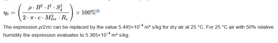

As I already explained , you do not consider BL/Mms ratio but (BL)²/(Re x Mms) ratio . If you devide it by 2pi ,you get the fundumental frequency which is equal to Fr/Qes that you can find on most datasheets. The efficiency of a driver is AirZ x MechnicalZ x (Sd/Mms)² . That is
5.445x10- x (BL)²/Re x (Sd/Mms)²
