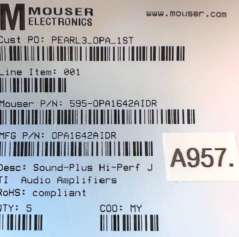

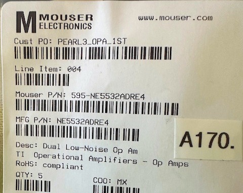

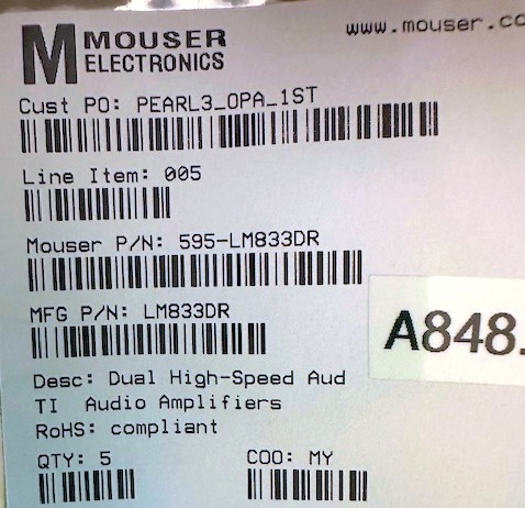

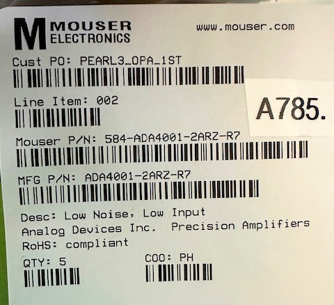

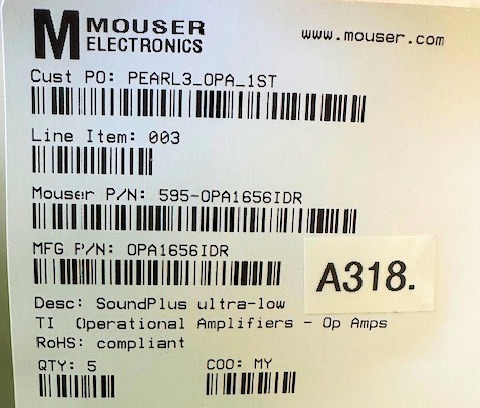

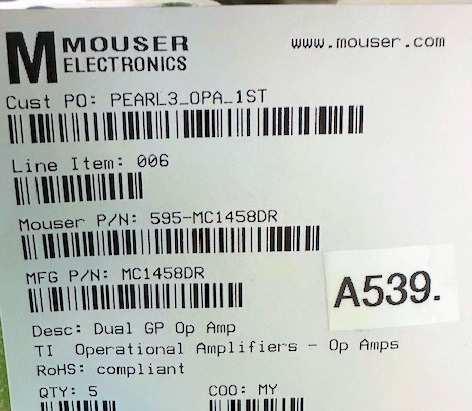

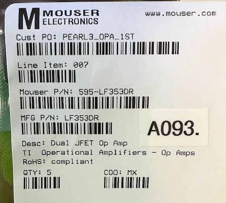

The decryption password for the .zip archive attachment to Pearl 3 post #1,817 is below. There are four repetitions, giving you four opportunities to copy and paste.
On the other hand, in case members find the decryption process to be tedious and tiresome, I have also attached the final, unencrypted image files to the bottom of this post. Smile at the Customer Purchase Order Number.

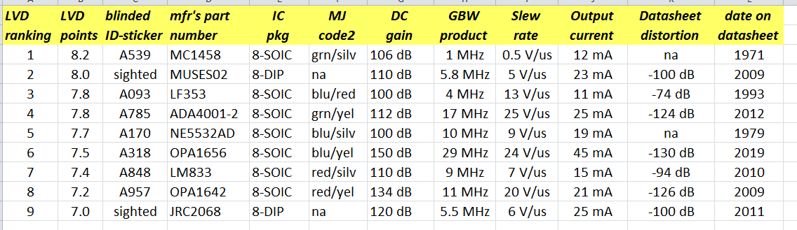

This actually reminds me (again) of the history of Ortofon cartridges.It makes me immediately wonder if the objectively poorest-performing chip was making the biggest subjective difference, and lots of difference is perceived as “good.”
Started out as mellow and (IMO) really good sounding VMS 10/20/30, Rondo Bronze etc.
In their pursuit of high freq. revelation and definition (again IMO) they lost musicality on that behalf MC2000/3000/5000 and further up the scale.
But that may be only me
Would you still wonder this if the devices under test were speakers instead of opamps?It makes me immediately wonder if the objectively poorest-performing chip was making the biggest subjective difference, and lots of difference is perceived as “good.”
Here are the others for your ease and convenience
This is quite fascinating!

@6L6It makes me immediately wonder if the objectively poorest-performing chip was making the biggest subjective difference, and lots of difference is perceived as “good.”
But this is almost impossible to answer, because what difference is there?
Do we know the difference we have heard, have we seen it at the same time? Seen it on an analyzer? What does the watermark or fingerprint look like?
So the first subjective result doesn't surprise me at all.
Thank you very much Mark Johnson for the idea.
Kind regards,
HBt.
The problem from now on is hat expectations have been set. You were the first and as such you were not prejudiced.Boy oh boy, getting really curious about results of other testers....
I can state objectively that we stand by our subjectivety!
I am very grateful to diyAudio member @Lvandoorn and his team, for the hours and hours of diligent effort they spent, listening and comparing. I'm also sorry that nobody else tried the experiment. Regrettably, no other members agreed to the listening test proposal in post #1,396 . Only @Lvandoorn .
Please let me encourage anyone and everyone to create a blind listening test for themselves, where the listener doesn't know what gear s/he is auditioning, and the experiment creator is thousands of kilometers away during the evaluations (where s/he cannot influence the test subjects either directly or indirectly). You'll have fun and there will be delightful surprises. However I must caution you: it takes significant time and money to create the anonymous test opamps, and it takes significant time and concentration to evaluate their sonic strengths & weaknesses. This is a major commitment, not a weekend diversion. I'm happy to pass the torch to the next set of brave experimenters, and I wish you great success. I'll be an enthusiastic spectator, watching intently from the sidelines.
