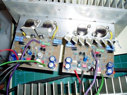

I got my second board finished tonight and could finally try it with two speakers. I'm chuffed to bits! Sounds absolutely great, clear and detailed, very musical. Even my wife was impressed!
Here it is playing Simon and Garfunkels "Sounds of silence".
The heatsink will be uprated on the lefthand BD140's shortly:eek:
Heatsink wizard
I got my second board finished tonight and could finally try it with two speakers. I'm chuffed to bits! Sounds absolutely great, clear and detailed, very musical. Even my wife was impressed! Here it is playing Simon and Garfunkels "Sounds of silence". The heatsink will be uprated on the lefthand BD140's shortly:eek:
Soon there will be an outbreak of highly effective comb-fangle looking heatsinks all over diyaudio.com. :D Congrats, and THANK YOU for showing that right side heatsink. That heatsink method (the comb looking "L-channel" piece) is preferable just like L-channel with holes drilled and T-Channel with holes drilled. That is the rarely seen "hot top heatsink" type referring to air movement having to go around+through a shelf, and they are remarkably good. Mine has insulator pads (for safety, for insulation and to block parasitic capacitance) on modified L-channel (very similar to the photo).
I'm also grateful to see the demonstration of output devices mounted on thick aluminum channel available at the hardware store. A vast array of re-cycling can be done that way, since whatever metal object is pasted and bolted to that thick channel will form a heatsink, like a row of square channel antenna tubing, a row of CPU heatsinks and really almost anything thermally conductive with significant surface area can form the heatsink fins.
I'm collecting data that gets used for documentation.
I'm curious, what all transistors did you use?
Like BD140?? ST, Harris, Philips, or something else?
P.S.
Photobucket (and similar) photos are prone to turning up missing, so I attached your photo to the forum so that it won't go missing in the future.
Thanks for the kind words.
The BD140's are ST, MJ15003 are ON Semi and the 2N3019 are ST. The rest were in stock from 20+ years ago.
Hope that is of use.

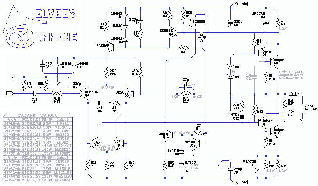

This post has replacement graphics displayed at post 1. Previously some graphics were at an off-site server; however, attaching graphics to a post makes a more durable presentation.
I'm documenting C11, just in case someone wants to use output devices faster than the preferred devices listed in post 1. Extra speed is unnecessary for outputs; however, a reason to do it is if you happen to have some conveniently sitting around.
Just now I was told the common name for Q12, Q13 is "Negative Current Sensor" and that bit of documentation has been added at post 1, since it might assist discussion. This area of the Circlophone is sensitive, so one wants to use good quality authentic devices there.
Some people had trouble viewing the post 1 schematic on a tablet or netbook screen, so I put the schematic size at 1024x600 so one can use full screen display on a netbook and it will display clearly.
Here's the replacement with these three minor touch-ups.
