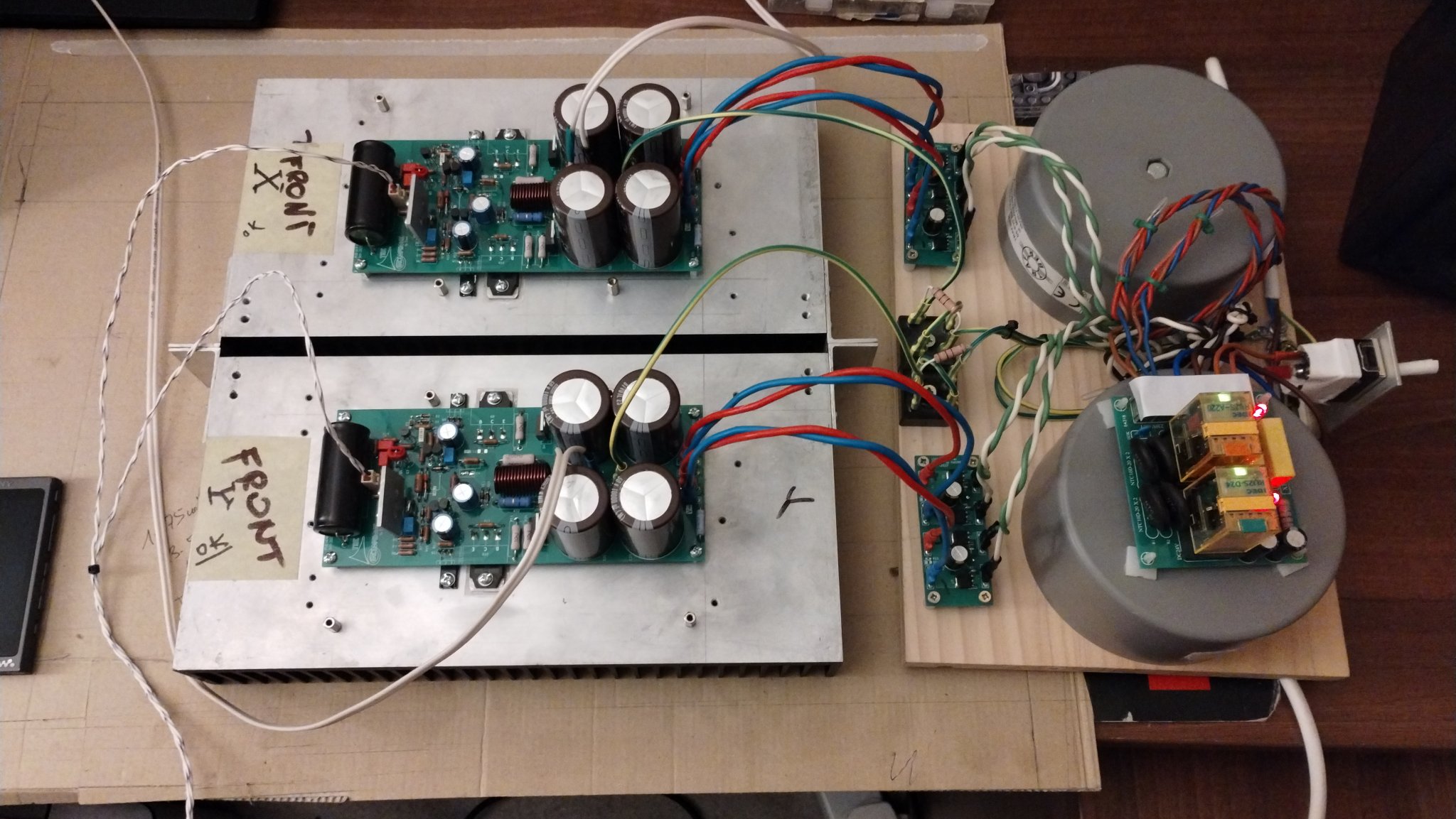

Two channels together - finally. I must say it's a quite pleasantly sounding amp :) I will listen some more and compare to other amps, but first I must make it more portable :)
Elvee, thanks again for sharing the project and for the support!

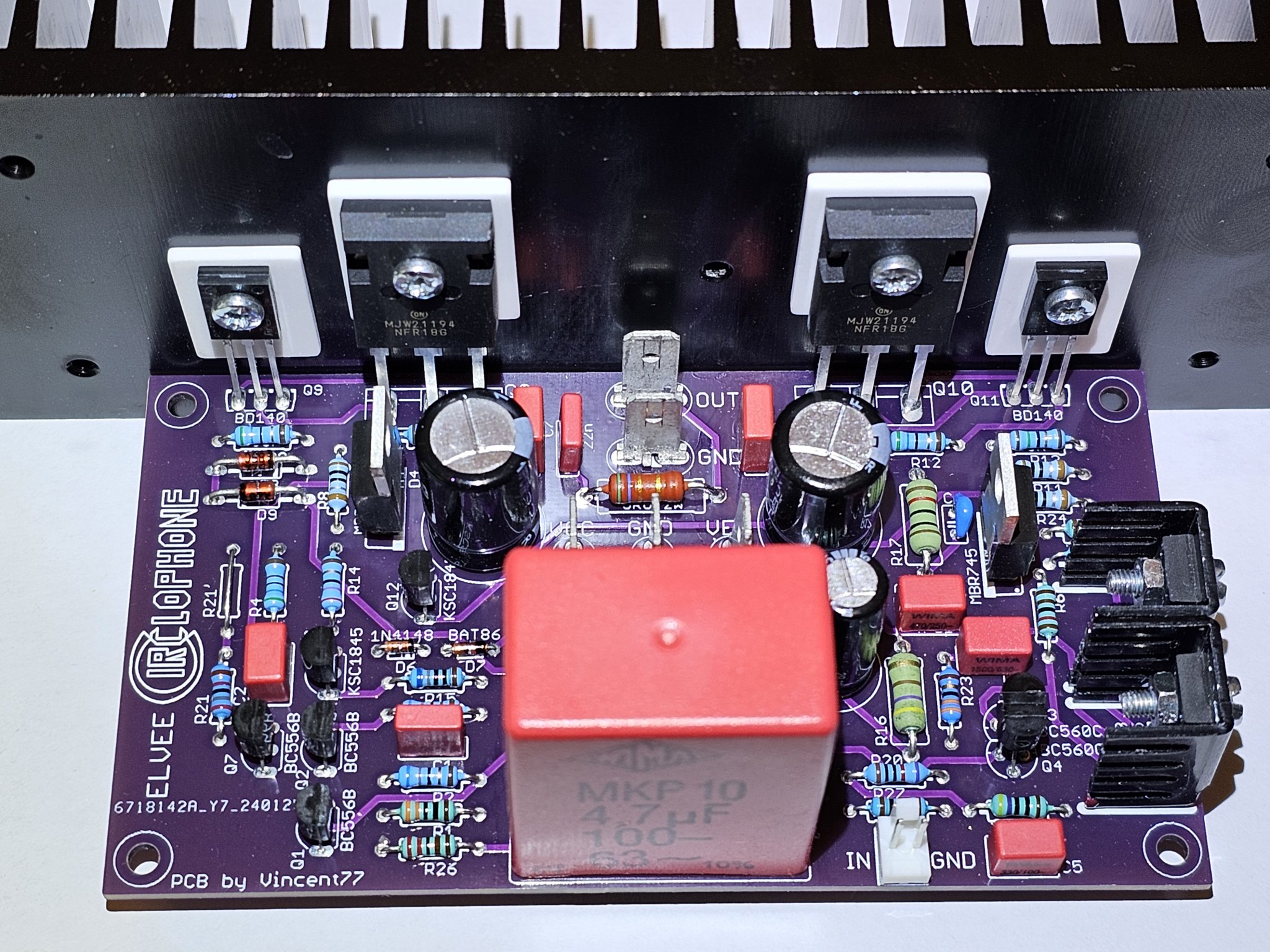

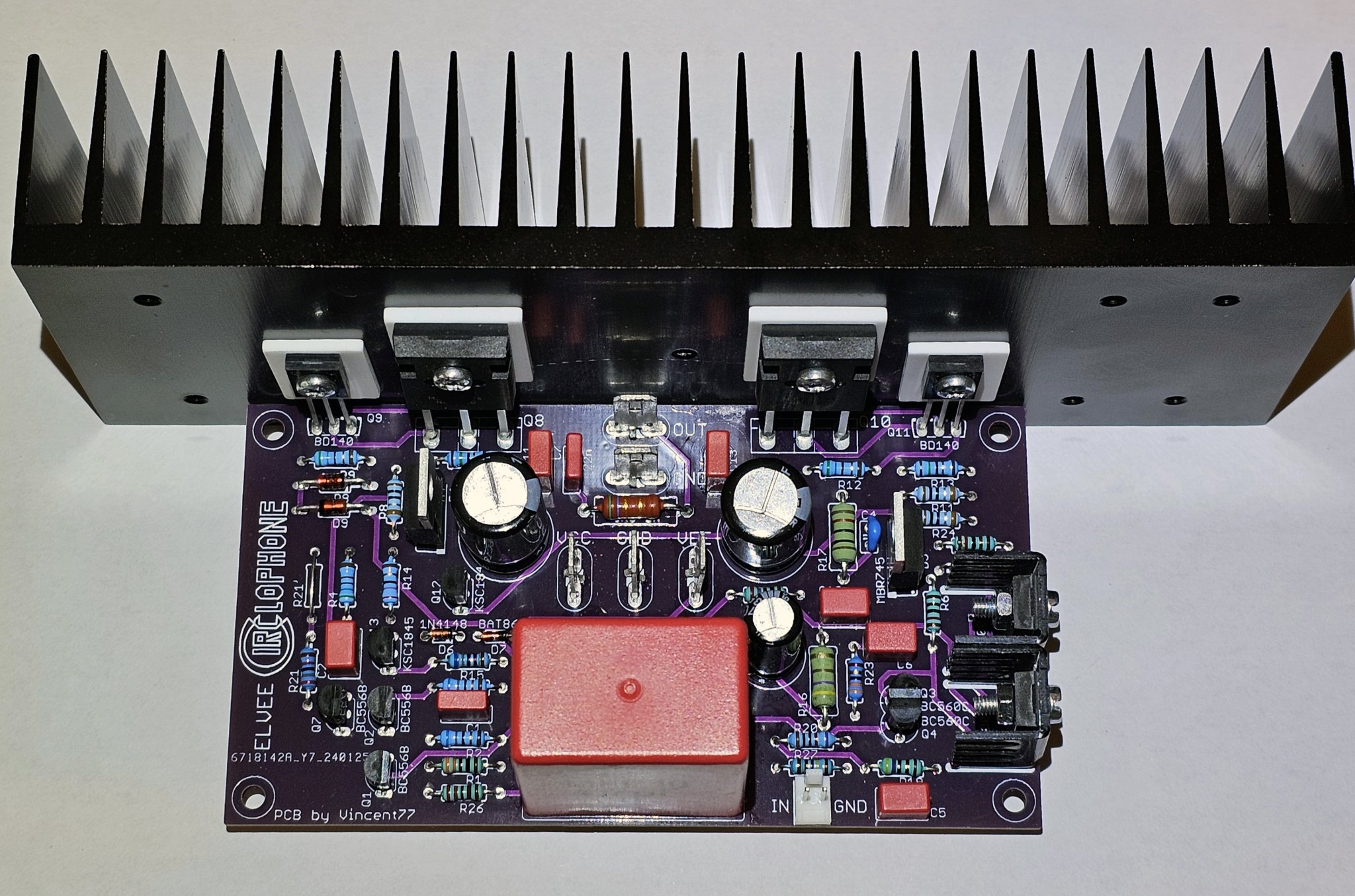

And another Circlophone is alive!

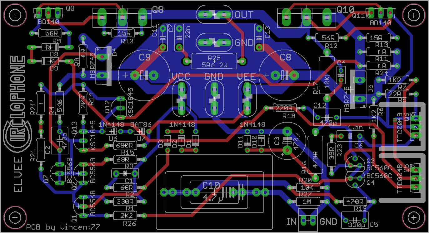

I made my own PCBs. The sources (Eagle) and the PCB fabrication files are attached here, in case they might be useful for the community.
R21 is made of two series resistors on the PCB, which makes it easier to get the necessary value, depending on the supply voltage.
I used MJW21194 power transistors, BD140-16 drivers, and TTC004B VAS.
It's a pretty good amp - it sounds clear, fast, good details, powerful and tight bass. When I first turned it on, I found the treble to be on the harsh side - but, surprisingly, it got better after a couple of days. So it needs some burn-in time before giving its best.
It is powered from a pair of simple cap multiplier PSUs, +/-21VDC. It draws 21W from the mains when idle. The heatsinks barely get warm. It's completely silent with the input shorted. DC offset is negligible (0.7mV).
I think I will keep it for daily listening while working on the computer, and the next step is to make an enclosure for it.

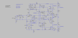

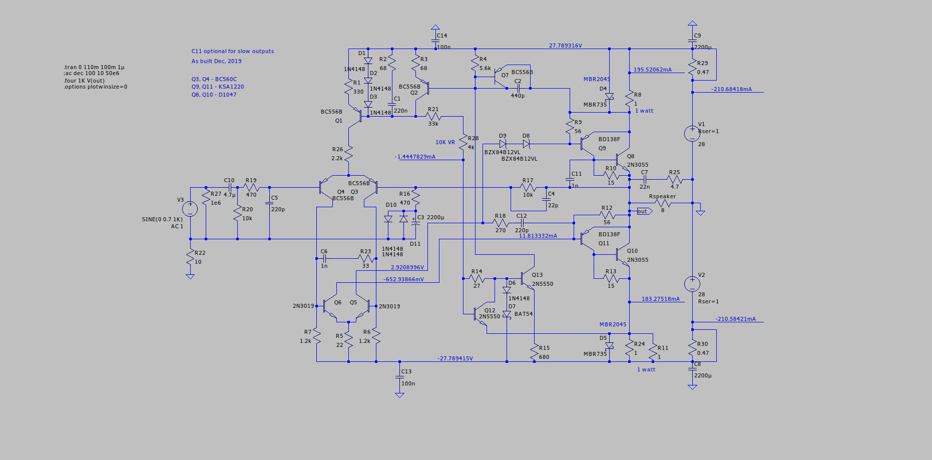

The left channel on my working Circlophone has malfunctioned. There is no discernible bias current in the output stage, the heat sink is cool.
Here's what I could measure:
input shorted, speaker out open
V+ = 27.7V
V- = 27.7V
I(R21) = 1.515 mA, R21 = 33K
There is no voltage drop across R8, R11, R24
Q5 collector = 0V
Q6 collector = 3.4V
Attached is my circuit as built, and the numbering should match Elvee's original schematic.
Please let me know how to go about debugging this.
some more measurements:
Ve(Q1) = 27.5
Vb(Q1) = 27.5
Vc(Q1) = 0
Ve(Q2) = 27.5
Vb(Q2) = 27.5
Vc(Q2) = 27.5
When not powered, R4 measures zero. Isn't it weird?
Can this happen when Q2 is shorted between the collector and emitter? Simulation seems to agree with measurements.
