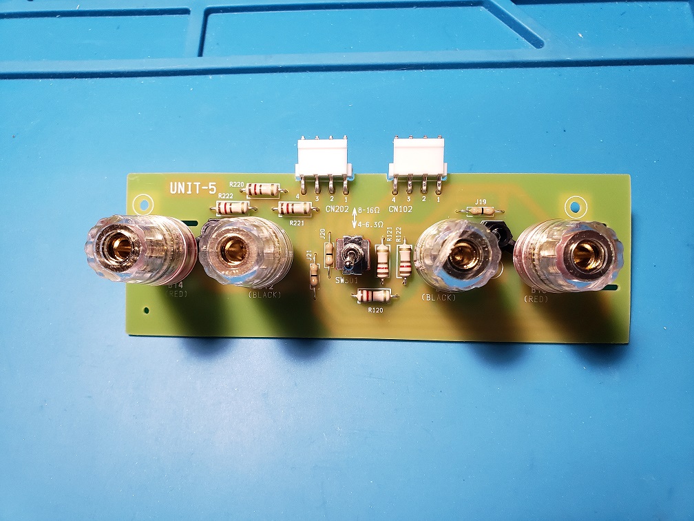

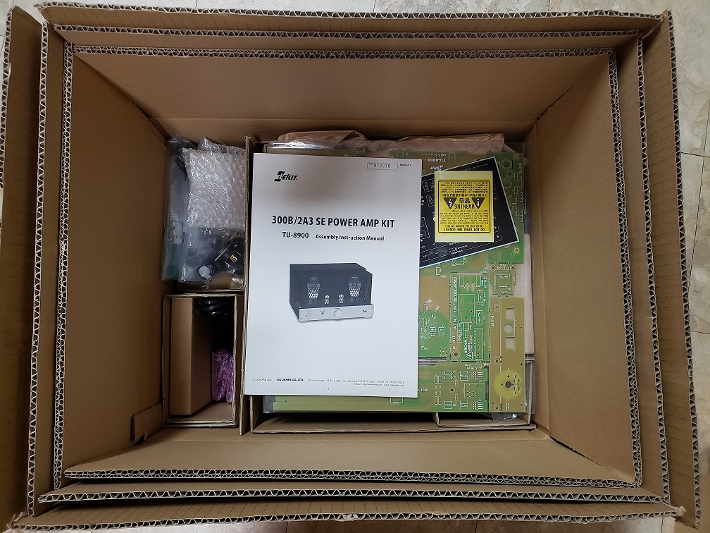

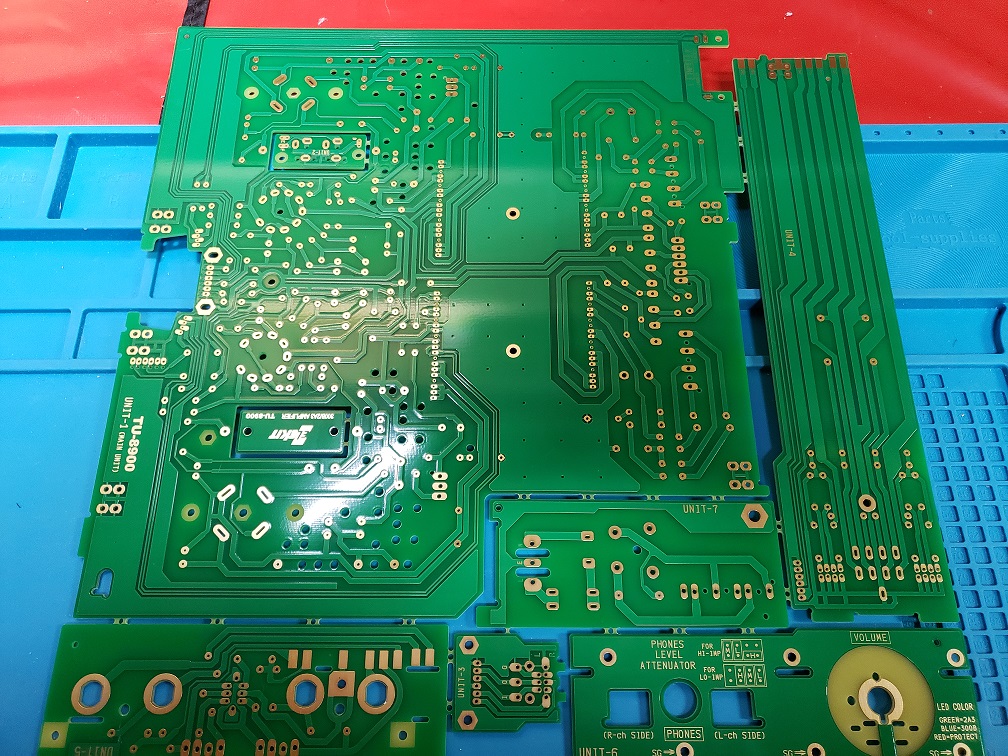

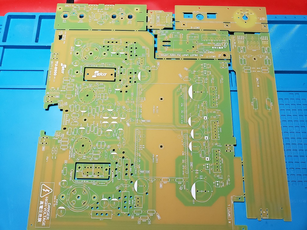

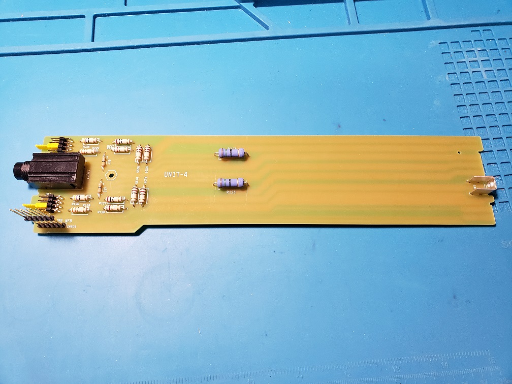

This 1st pic shows 3 layers of packing. Impressive !!!! The outside box was almost pristine. 2nd & 3rd pic shows just how beautiful the PCB's are. I was telling Victor, I really didnt want to touch them because they were so nice :) You also have to "break" off about 8 pieces that had me nervous. I lost count but pretty sure I had to sandpaper about 40 perforations There are 2 rectangular sections in the main pcb that need to break off and this I believe is for the caps.

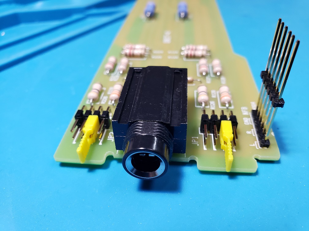

Pic 4 is the speaker connectors, 5 & 6 show the headphone jack.

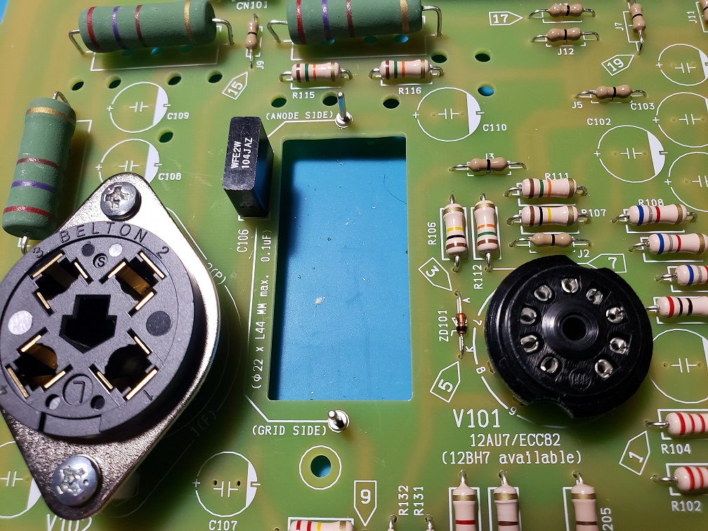

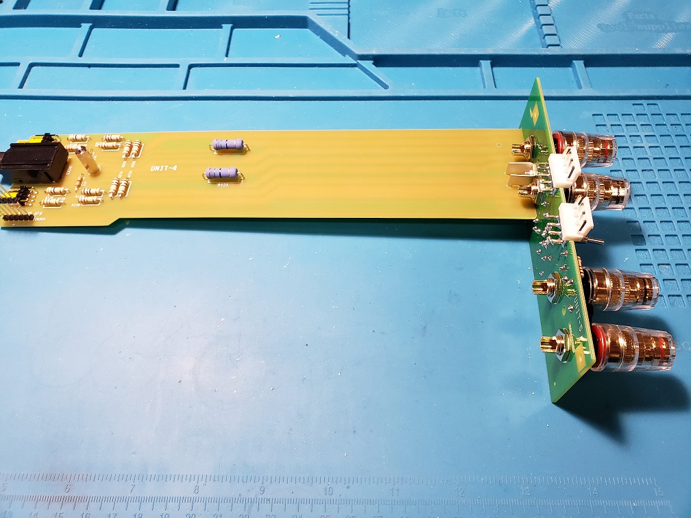

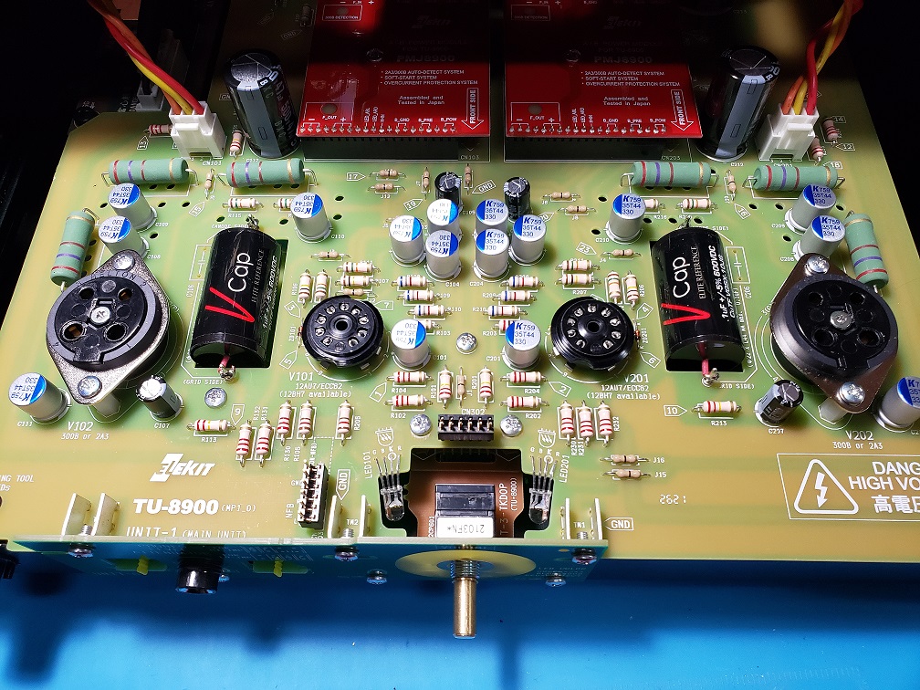

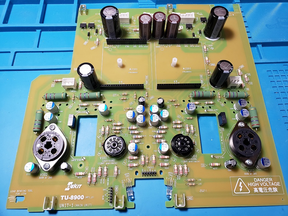

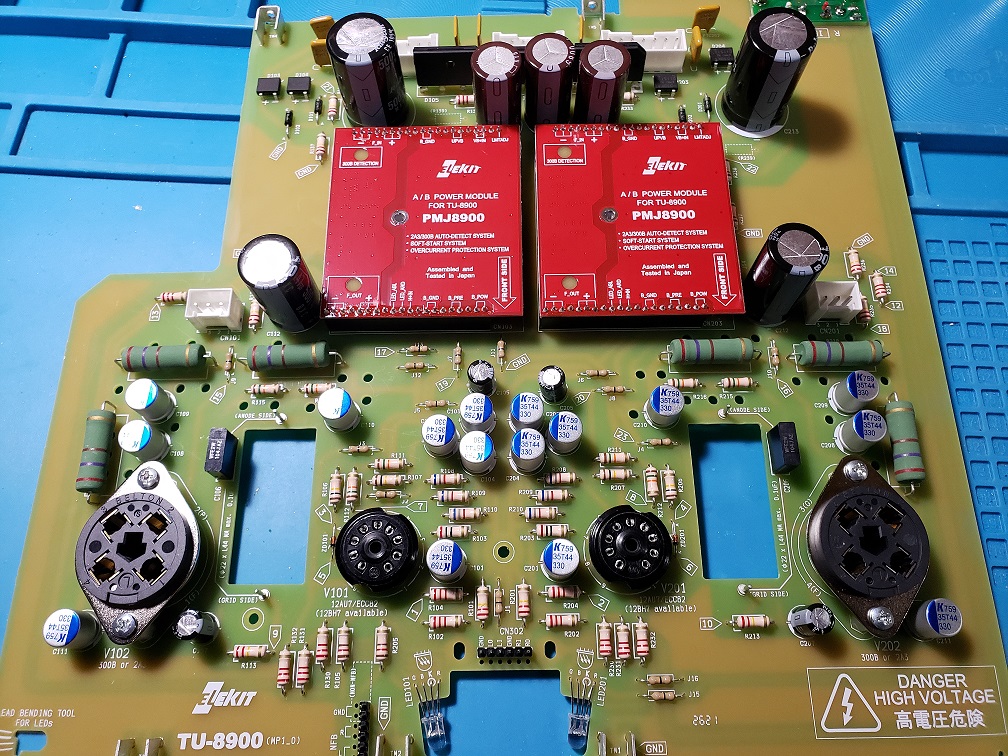

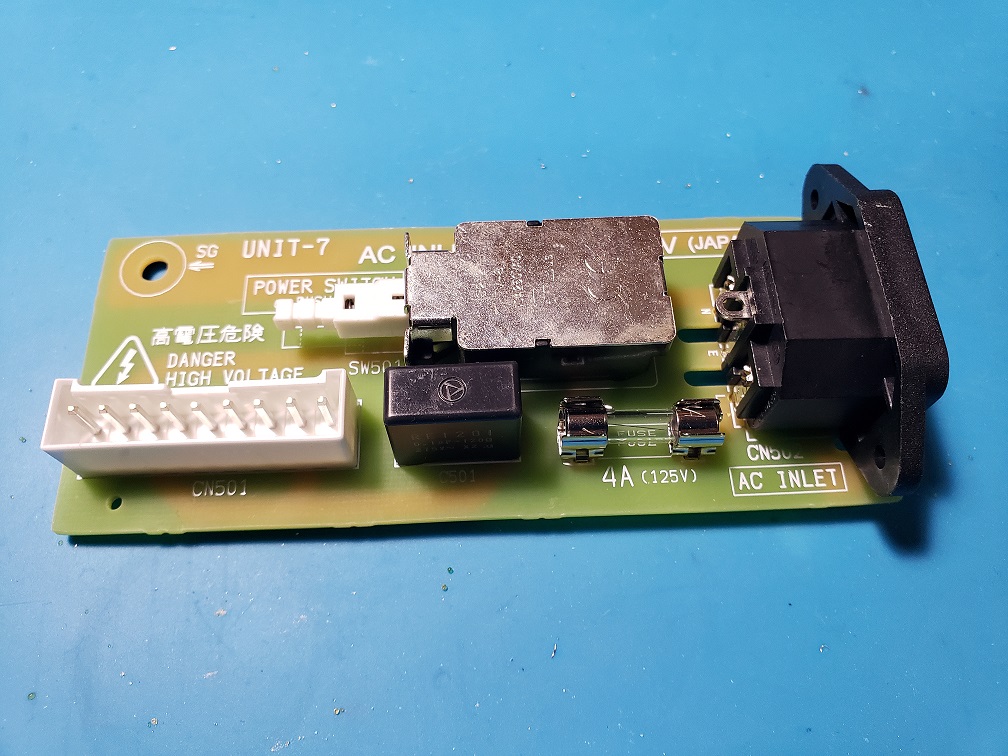

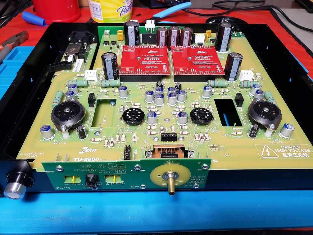

Made good progress this evening. Pic 1 shows AC Inlet pcb. Pic 2 shows the headphone and speaker jack pcb attached. Similar to the 8600 but if I recall the speaker pcb for 8600 spand almost the width of the chassis.
I zoomed in for Pic 3 because I wanted to show the flexibility in this area. To the right of the 4 pin tube socket is the standard signal cap provided in the kit. They provide turrets on the top and bottom for larger caps. I really like this instead of eyelets. Unfortunately I only had 1 9 pin ceramic socket not in use and quick measure with the chassis showed there could be space issues for the socket to protrude, so I just used the stock sockets.

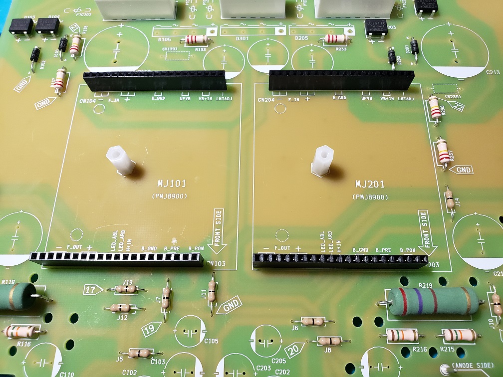

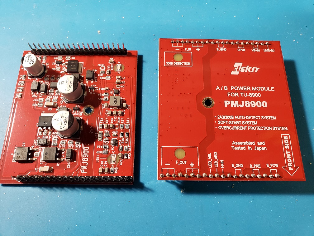

Here in Pic 4 you have the section that will be populated with the "auto power tube selector". Looking around you can see a lot of test points :)

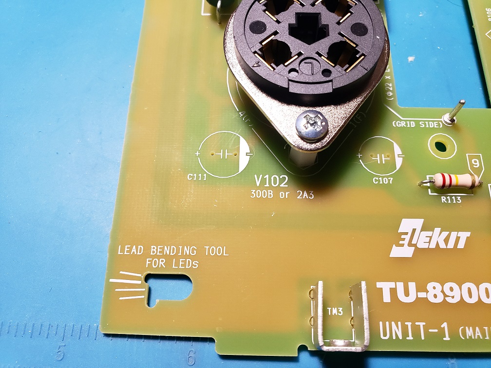

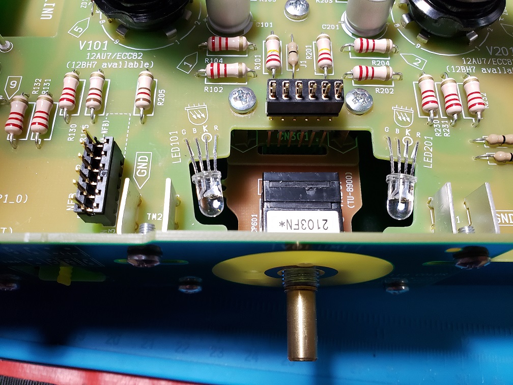

I thought this was a really good idea, in Pic 5 they actually have a tool to bend your led's. Dont forget orientation.
The final pic is the main pcb almost completed. I still need to attach input rca pcb on the far top right and couple more parts.

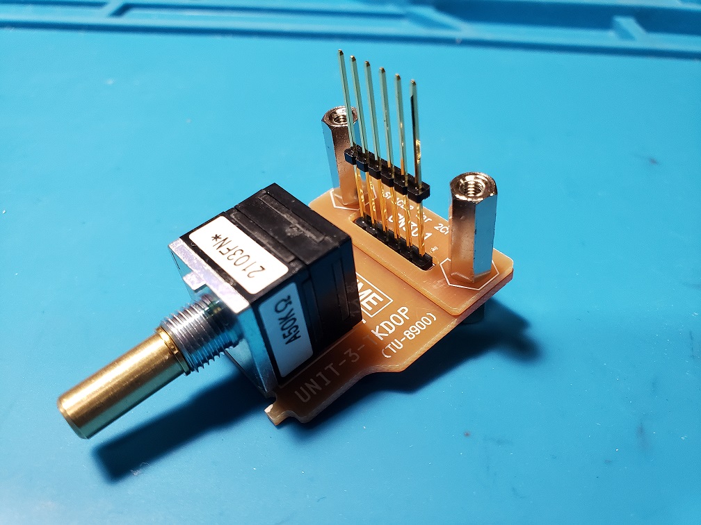

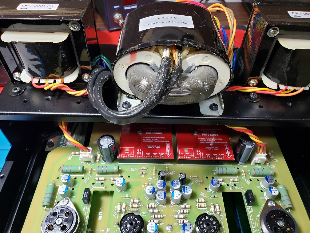

I left the volume for last because I was unsure as to how to mount the TKD kit. There is an spacer pcb where the original pcb does not have Pic 1 shows the ALPS which comes with the kit and the TKD on the right. Note in pic 2 the spacer pcb sits on top of the TKD pcb. Without this added spacer, the volume shaft protruding to the front will be uneven.
Pic 3 and 4 show the auto power module and it attached to the main pcb. These change colors according to the manual based on the tube.

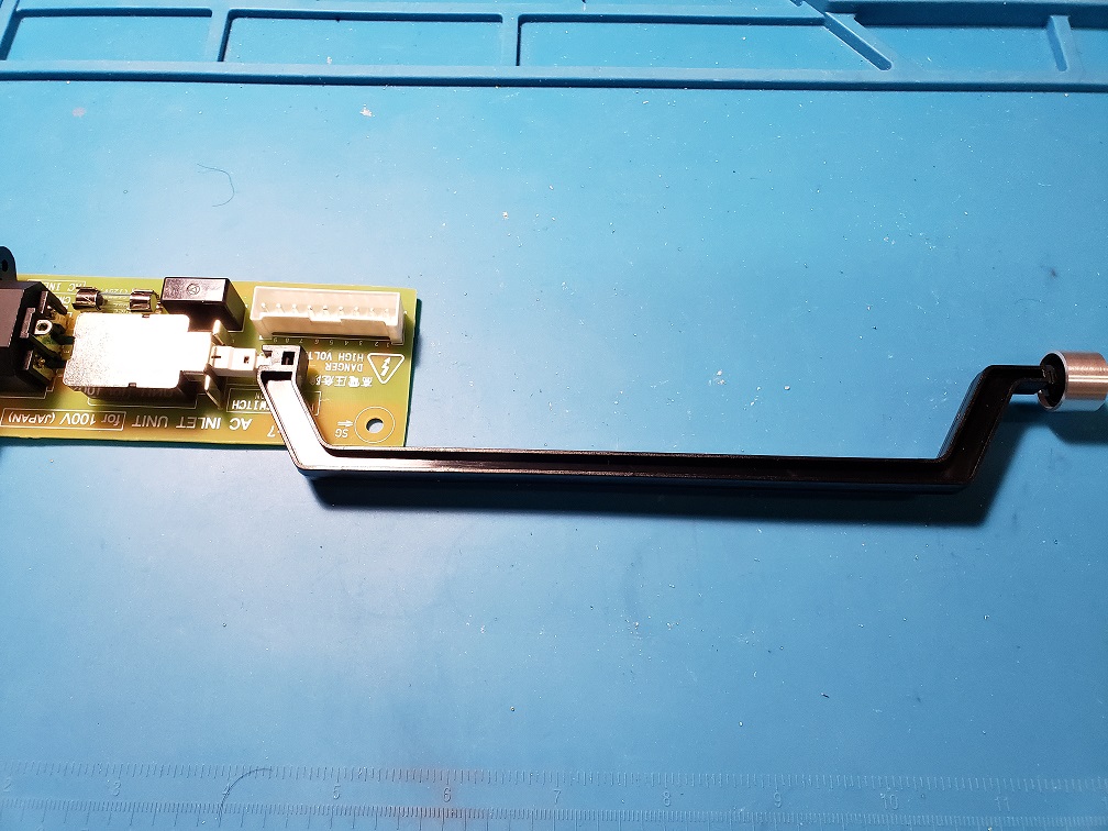

Pic 5 shows the power switch attached to the AC inlet pcb. It was difficult getting the extension attached to the switch but a little force did the trick. Later on after it was assembled and added to the base chassis, I found that the extension bent when using the power switch. How will this last in the long run, not sure but I would prefer more sturdier metal type.

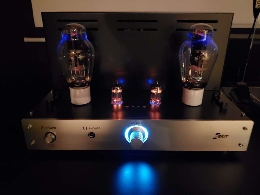

Its all coming together and looking quite snazzy to me in Pic 6.

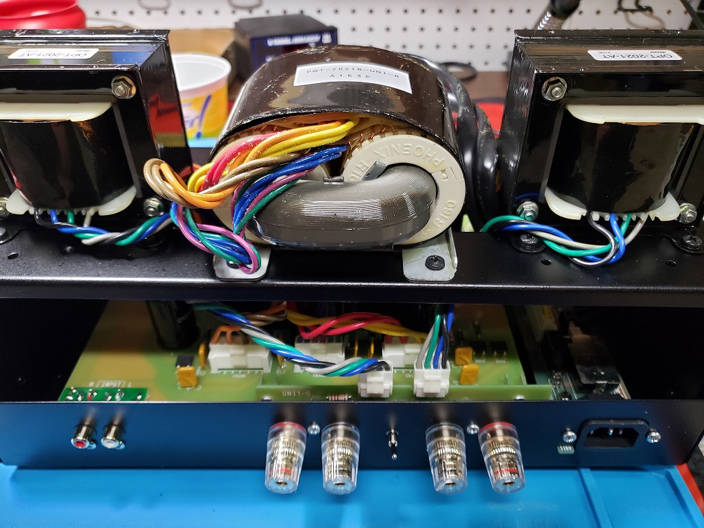

Its been several months since I opened my 8600S and if I recall, there was ample space to disconnect the power connectors and even perform first time voltage checks. Not so much here as you can see in the last 2 Pics. Its pretty tight. I made the mistake of connecting to the AC inlet last and had to undo them all to get there. There is also a lot of play when inserting into the AC inlet pcb since its only held by 1 scree on the side, so be gentle here.
I started screwing down the metal tube socket cover only to remember that I had not even powered it on and perform the needed steps documented.

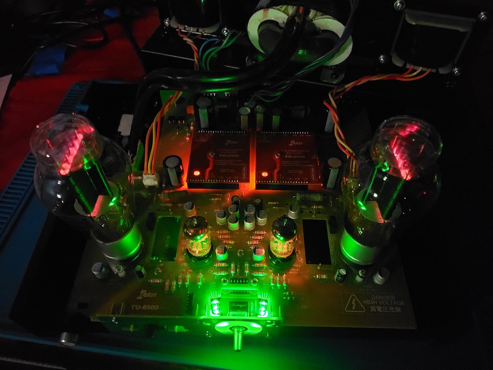

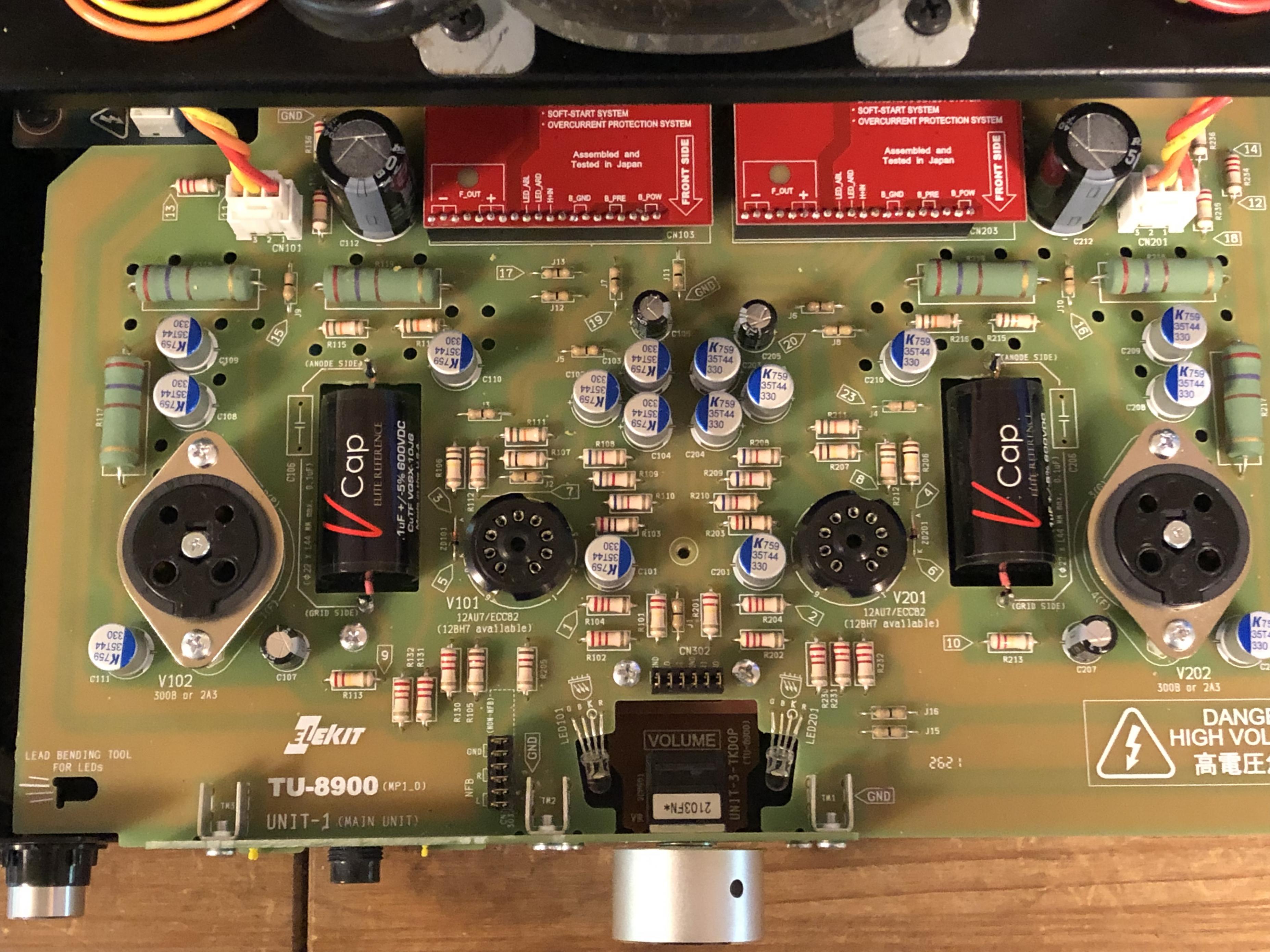

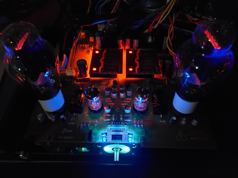

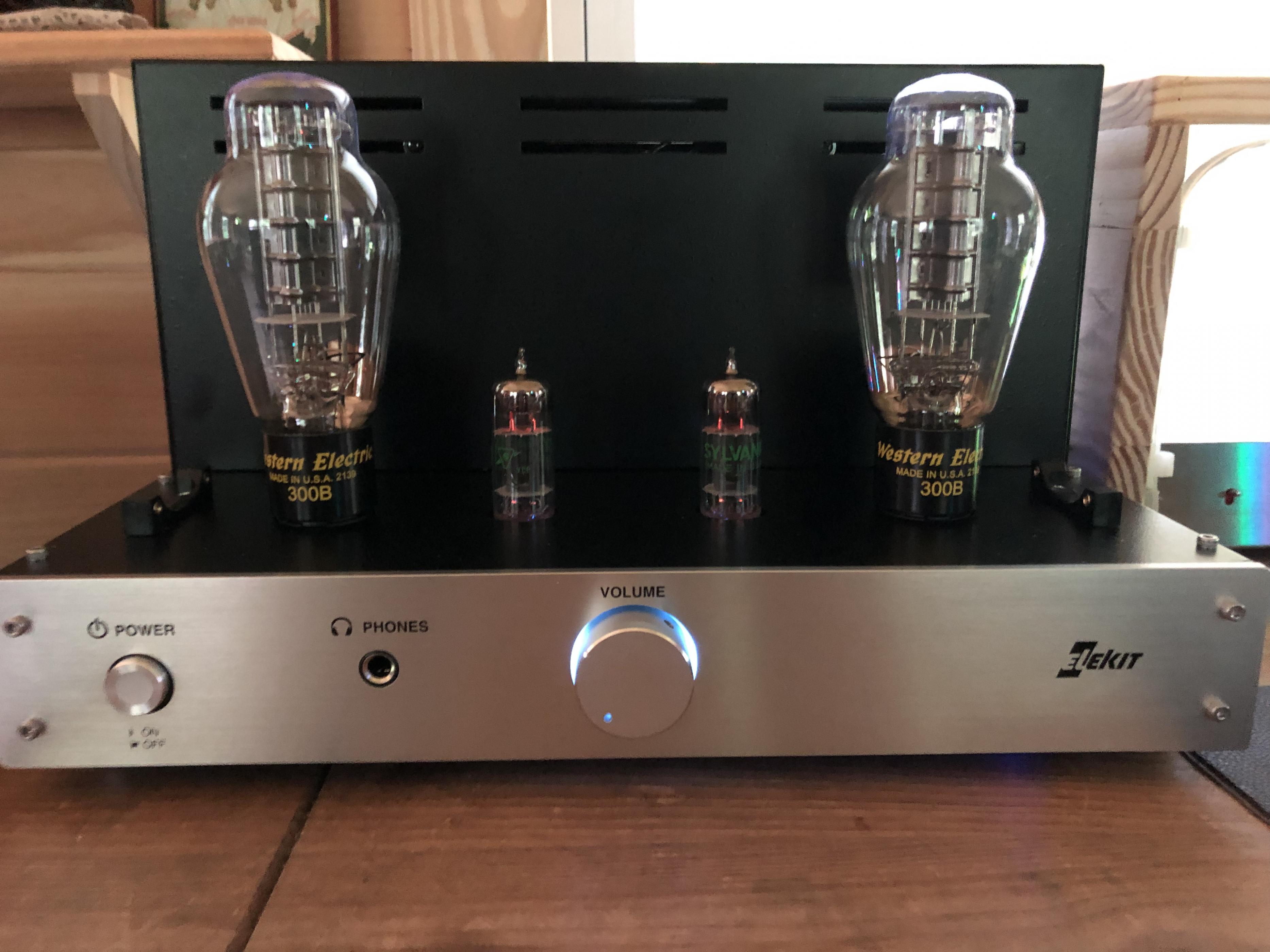

Got started on just the simple tests of removing certain power connectors and checking for tube glow and power led. My Cossor 2A3 and vcaps showed up at this time. So I used the 2A3 with GE 12AU7 tubes and followed all the test points. Swapped out 2A3 for my Cossor 300B (used in my 8600S) and performed same test points. You can see pic 1 is green to reflect 2A3 and Pic 2 is blue for 300B. Test point values will vary from 2A3 to 300B and even 12BH7. Overall with either tubes my values were very close.
3rd Pic shows vcaps installed. I was little hesitant as to which direction they should be installed. I know there was much confusion in the 8600S thread but I think I have it right based on what the manual says. Outer foil to Anode.

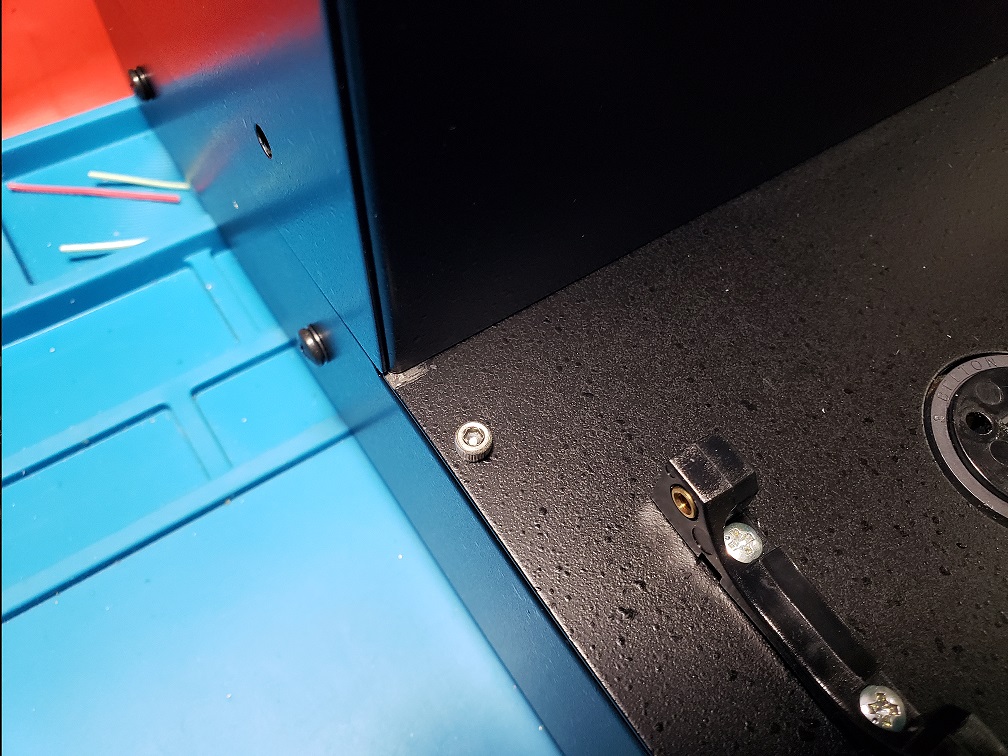

Putting the covers on I did see edges of the chassis that did not have any paint. It should be hidden with the cage but I never use my cages or covers so might have to just use a black marker.
The overview shot of the pot and led's was to show you where the nfb and non-nfb jumper is located - left of the GND test point.

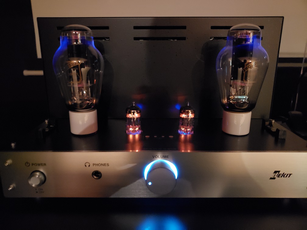

And finally my 8900 is in my main rig and playing. I was using a knob from another project and then found the one that came with the TKD kit, which can be seen in the last picture.
How does it sound ? Well give me a few days to compare this and 300B to the 8600S and 300B (of course) then will try 2A3. I am not sure if its even an apples to apple comparison. Comparing the 2A3 sounds to the 300B sounds in 8900 seems more reasonable - same chassis, parts, caps etc.
Anways let me go back and listen for a few minutes before I call it a night. I will follow up with my thoughts on building this vs the 8600.
Oh and Thanks to Victor for replying to my emails within minutes :)

Since I have given the other amps to friends I cannot do a direct comparison, but my first impressions is that the 8900 has better sound quality than the 8600.
That is, with both the WE300Bs and 2A3s.
I am not sure quite what to make of the Non-NFB setting. Besides the increased gain I do not hear much of a difference. Anyone else try that yet?
