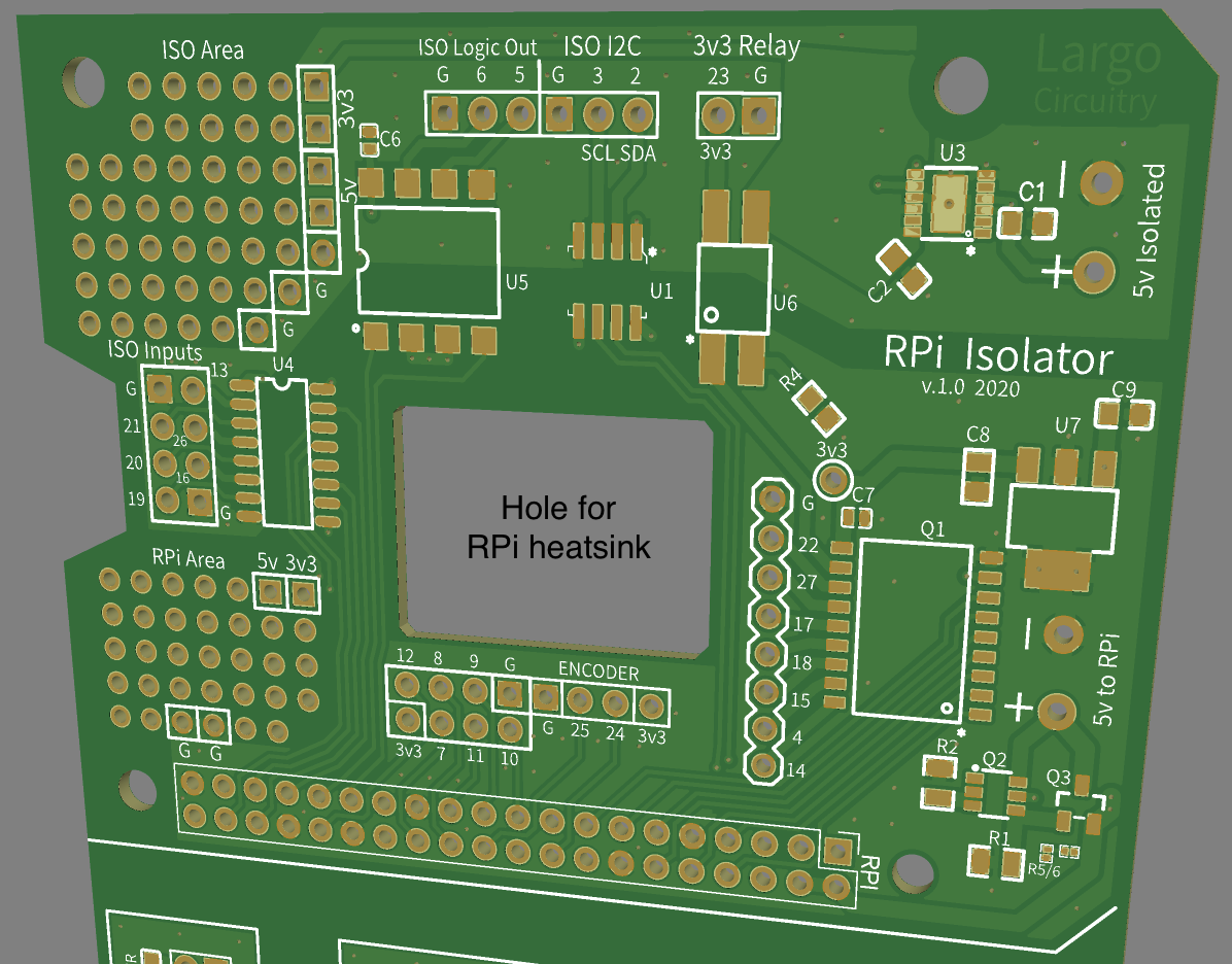

Greetings Branko,
Thanks for your kind words. The USA is not well prepared for what is to come, but as a retired medical professional I'm fine. ...and also working on my own B3Pro project during these quiet times! :)
Perhaps you were inquiring about the C++ code, but it's quiet so here is an update on the Python-based project: The interface boards to provide galvanic isolation are all designed and ordered, and they should arrive in about 2 weeks. For my projects, I feel that a front-panel display would merely duplicate information that is more conveniently given in other formats. However, I realize that a nice OLED adds credibility to an impressive chassis and so I applaud those who wish to include them. :)
The interface board uses the 2X20 GPIO scheme from the Raspberry Pi because it has been adopted by many other SBC makers. [The Raspberry kernel is easiest to work with among those I have tried.] The board is very generalized in function and would allow either SPI or I2C control of small displays (along with all of the isolated functionality to/from the B3Pro). For my own project, I am bringing the RPi HDMI connection to the chassis back panel, should there be a need for a serious GUI, or even video display.
That's all for now. It will be several weeks still before any control code is written.
