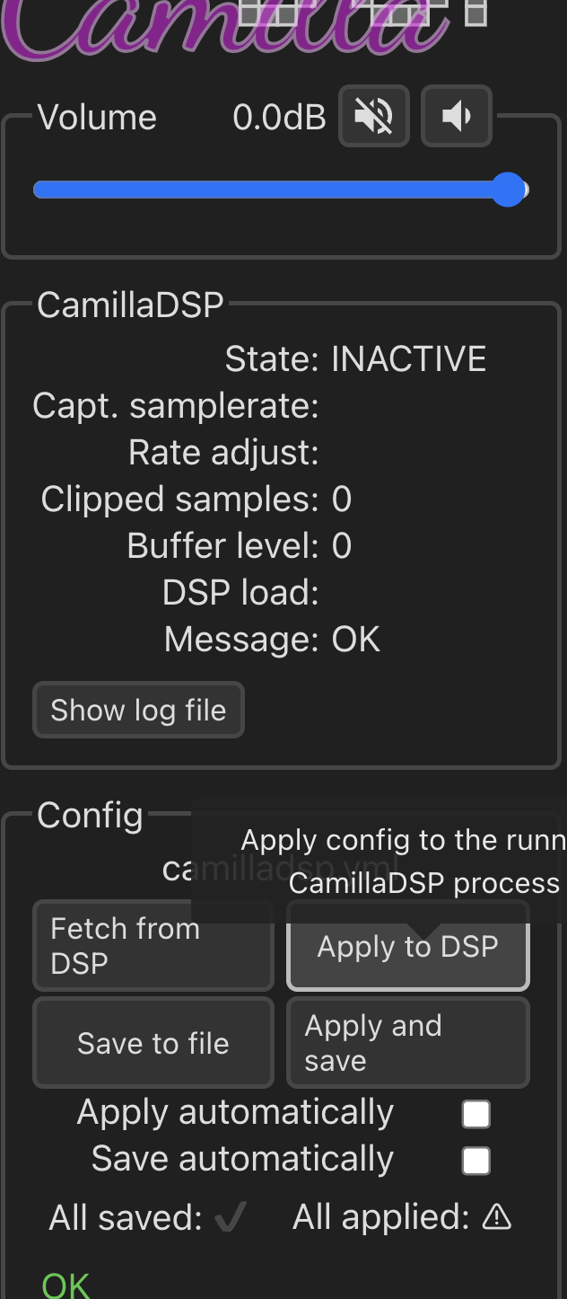

That looks OK. Now why should the card be gone? If the card were taken by pipewire (have you disabled your cards in pipewire/pulseaudio?), the error should be EBUSY. But ENODEV (no device) should mean no device was recognized by your string specifications.
I do not understand your description. How does "going to camilladsp gui" fix the problem?
It says "Inactive" after reboot, but as soon as I press "Apply to dsp" it starts running.
Well then IIUC the initial CDSP config uses some nonexisting device and only after applying your correct config to CDSP the new config overruns the initial non-working config. You need to manage to configure CDSP correctly from the start - that's something I cannot help with but others will certainly help.
Reactions: 1 user
Voila, did a second (or third) look at systemd service file as suggested. Thanks.
I have used User=pi in the file but had to remove it. Then it works...

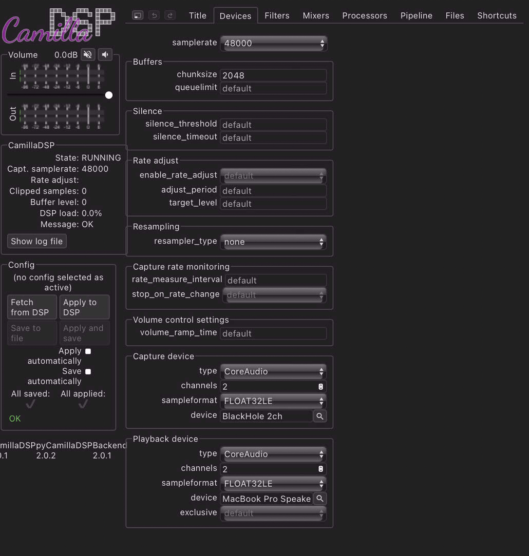

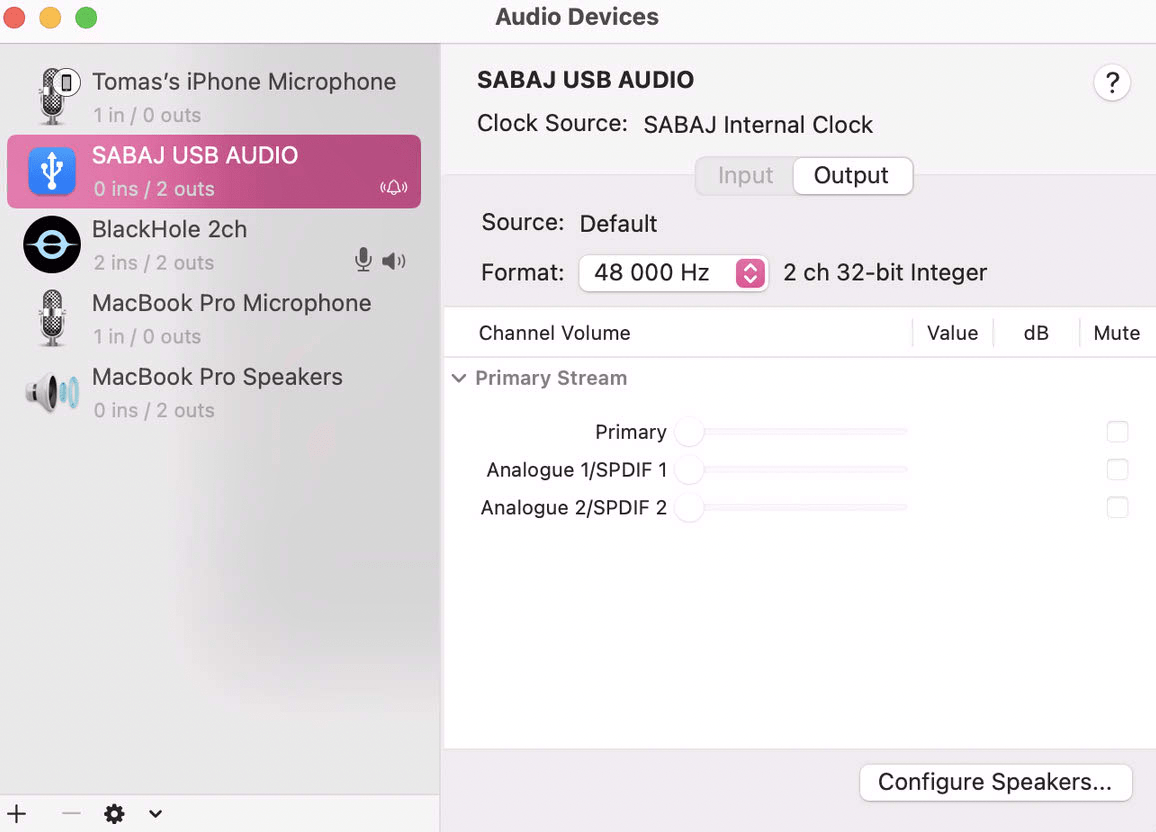

Hello,
After 24h of wrestling with this, looks like I need some help.
I can't get CamillaDSP to produce any output.
  • Setup: CamillaDSP on MacOS Ventura 13.3.1, 2019 MBP. Configured to capture audio from "BlackHole 2ch" and output through "MacBook Pro Speakers" or "SABAJ USB AUDIO"
  • Problem: No sound output. I'm able to run CamillaDSP, but is not capturing input and/or not producing output (gui shows no input/output signs of life)
  • Current config:
devices:
samplerate: 48000
chunksize: 4096
capture:
type: CoreAudio
device: "BlackHole 2ch"
channels: 2
format: FLOAT32LE
playback:
type: CoreAudio
device: "MacBook Pro Speakers"
channels: 2
format: FLOAT32LE
Attempts so far:
  • Ensured BlackHole is functional with other apps.
  • Ensured sample rate consistency in Audio MIDI Setup.
  • Restarted Core Audio and CamillaDSP multiple times.
  • Tested audio routing through BlackHole.
  • Adjusted chunk sizes and sample rates
  • Tried Soundflower
  • Tried changing formats or omitting them
  • Tried different outputs incl. SABAJ USB AUDIO
Attached: Debug logs. Screenshots of Midi sound device setup and CamillaDSP gui.
I'm looking for suggestions on how to troubleshoot this further. Is there something I'm overlooking in my config or setup? Any advice would be greatly appreciated.
