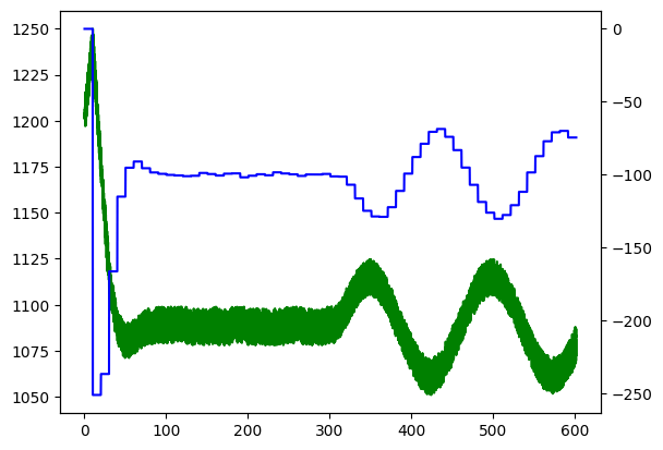

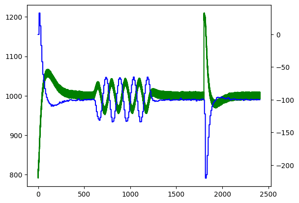

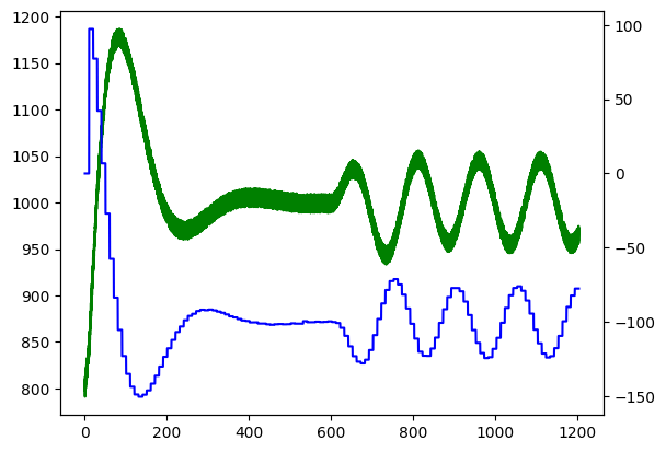

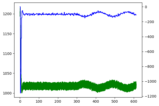

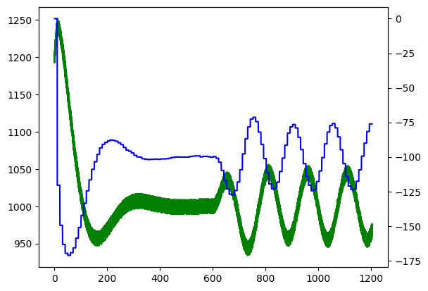

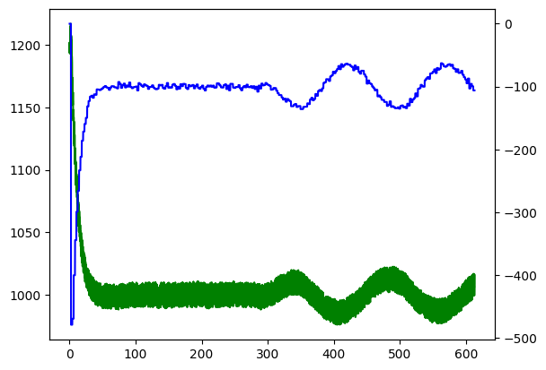

Here are some simulation results for rate adjust. The conditions are that the playback device runs 0.01 % slower than capture, and that the level is 1200 when the simulation starts. There is some random noise added to the buffer level measurements. The target level is 1000. After half the simulation has run, the playback rate starts varying, which is modelled as a slow sine with a 150 s period and amplitude of 0.003%.
Note that some sims run until 1200s while others stop at 600s. The blue curve is the rate adjust divided by a million, and green is the measured buffer level (fuzzy because of the added noise).

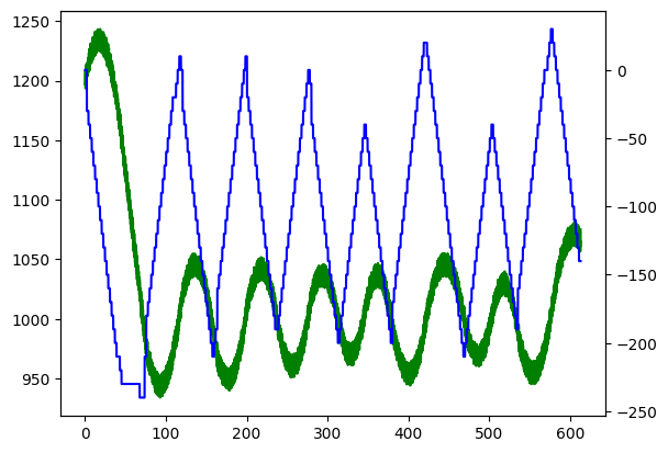

The old controller, used in v1.0 and v2.0 for all backends except Alsa:
10 second adjust period:
2 second adjust period:

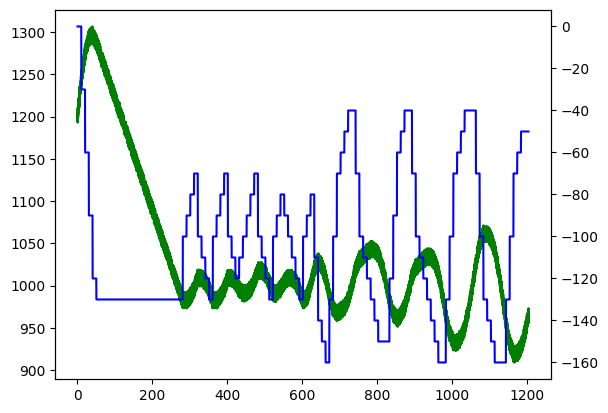

The new controller, used for Alsa in v2.0:
and 2 second period:

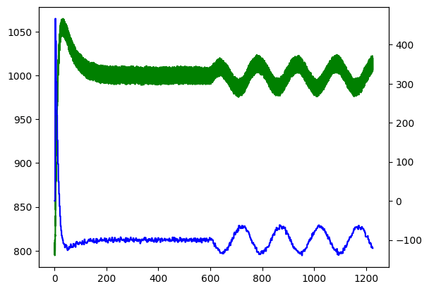

Here is the current leader:
2 second period:
The v1 controller makes larger adjustments than needed, especially at low adjust periods. It's a plain P-controller, so it never reaches the target level of 1000.
v2 is supposed to be a smarter controller that makes small adjustments to find the optimal steady state rate. Unfortunately it has a tendency to never quite settle and instead hunt around the target. This is not a simulation problem, it often does this in reality too. The adjustments are small, but still unwanted. It also react slowly at the start, so that the buffer level has time to increase a bit more before it starts decreasing towards the target.
v3 is a PI controller with lower P-gain than the one in v1, and the I-part means it is able to reach the target. The rate changes while fixing the initial offset are about half as large as for v1.
For fun I tried a PID controller as well. It can give a somewhat nicer step response at the start but it adds too much noise to be worth it.

Great test, thanks a lot! I like the v3 10s result as it has small overshoot in the rate adjustment. The rate adjustment is "innocuous" in non-resampling chains. In async resampling it directly influences (in fact damages) the resampled signal.
IMO it's not critical to reach the target level exactly, it's just a number nobody cares much about to be exact, unless some fixed latency were required e.g. for video adjustment for lip-sync (but it consists of other delays, not just the buffer level - e.g. processing time which may vary depending on the CPU load). Maybe we can ask what is important. IMHO (unless a specific stable latency is critical):

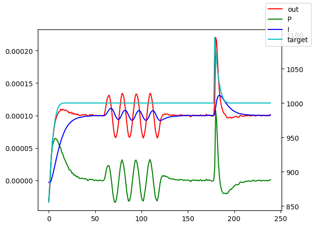

Right now I'm experimenting with something that looks kinda promising. I use the PI-controller, but added some logic to for the start-up that makes it smoothly ramp the target level from the current level to the desired one. It also triggers this ramp if the level somehow ends up far away from the target (with a configurable limit for what is considered far away).Perhaps a weighted two-input PID with some built-in safety "sidekicks" would be a way to go. It may support both scenarios above, by changing weights to the respective input variable.
Here is what this looks like, with a 10 second adjust period. I added a step to the level after three quarters to trigger a new ramp. The ramp gives a much smoother return to the target, without any big overshoots.
And the internals from the controller (the target uses the scale on the right side):

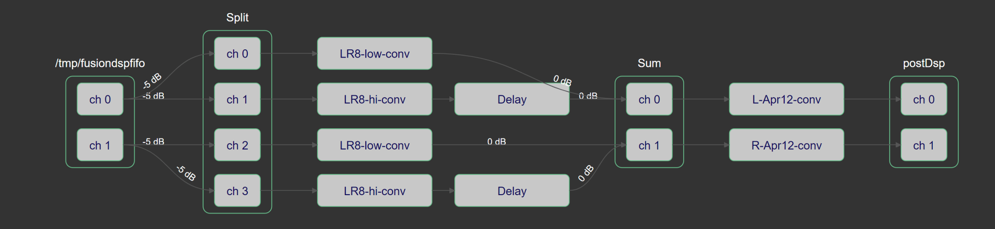

Hello, I'm reaching out to see if anyone might have a solution to the issues I am having with camilladsp.
I use Fusiondsp/camilladsp on RPI4 streaming from Volumio.
I need to do more complex dsp pipeline than possible in Fusiondsp, so I turn on Camilladsp GUI
I have various test configs that share some common issues:
1. Whan using shortcuts to select a configuration, I have noticed that I must press the config selection button twice to get the dsp loaded. The first press shows the config was loaded and activated with the two check boxes "all saved" and "all applied", and has the name of the config at the top of the config panel. But it's only when I press the config selection a second time do I hear the changes.
2. In the config panel, sometimes the config changes to "no config selected" without me initiating a change.
3. Sometimes, when switching configs, usually on the second press, the music plays in slowed down audio, like slow motion. When this happens, I have to re-start the song to recover.
4. When a song finishes, the dsp status shoews "stalled" rather than something such as "ready". I'm not sure if this reflects an isse.
5. The log file does not show any useful errors
Thats the background, now the meat.
4. Using gain on the mixers works e.g. -5db. However, the mute functions, both on the source and the destination do not work, and neither does it work in the Gain filter Songs play normally even though one channel is muted.
5. Here is a typical pipeline
Thank you in advance for any assistance. I'm stuck at the moment in implementing time alignment with convolution EQ from Rephase.

These things all depend on how Fusiondsp is implemented. I don't know the details here, can you ask the fusiondsp author?1. Whan using shortcuts to select a configuration, I have noticed that I must press the config selection button twice to get the dsp loaded. The first press shows the config was loaded and activated with the two check boxes "all saved" and "all applied", and has the name of the config at the top of the config panel. But it's only when I press the config selection a second time do I hear the changes.
There have been a few rare reports of this issue, but I have never managed to reproduce it. Can you attach a complete config file where it happens?4. Using gain on the mixers works e.g. -5db. However, the mute functions, both on the source and the destination do not work, and neither does it work in the Gain filter Songs play normally even though one channel is muted.
