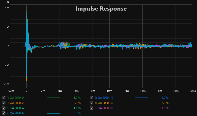

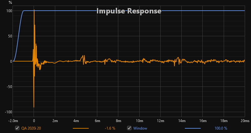

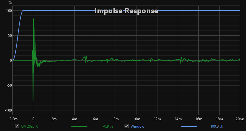

Just to start playing around with real data and to try and understand how to implement different types of beamforming, I took measurements of a speaker (QAacoustics 2020i) at 10cm distance increments on-axis (with the tweeter) starting from 100cm and ending at 160cm, resulting in a total of 7 measurements. This was done in a room where the closest boundary was the floor which was about 125ish cm down from tweeter height (this is probably better done outdoors where the single reflection from the floor is the only issue)

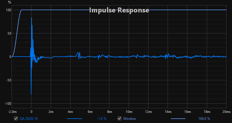

Here is how the impulse responses look like:
100cm
110cm
120cm
and so on..
After doing Align SPL, estimated IR delay-based compensation, resulting impulse response overlay is given below
As seen in the above pics, the first reflections occur in the 4ms to 5ms region. As the distance of mic increased, the reflections started to come in closer towards 4ms, as expected.

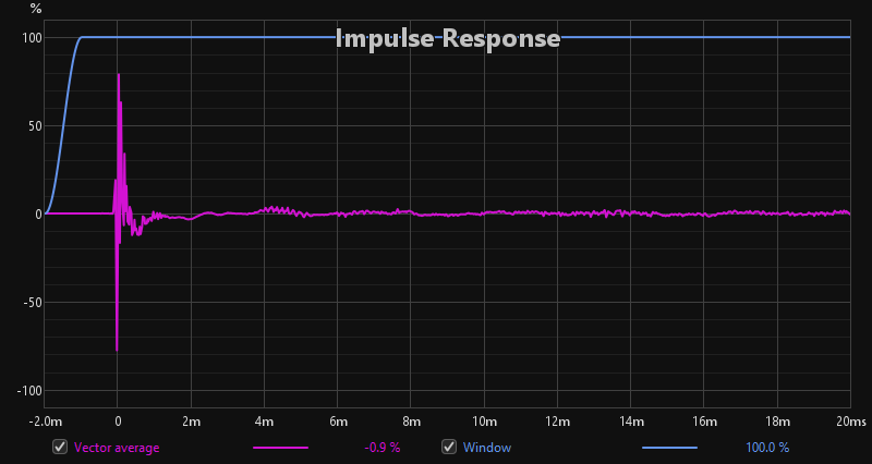

For trying out delay-sum beamforming, I did vector averaging of above responses giving the following impulse response
As per expectations, now the overall SNR seems to have improved with diminished amplitude for the reflections everywhere most evident in the 4ms - 5ms region.

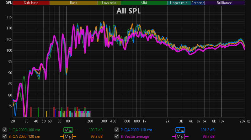

Here is a comparison of the frequency responses corresponding to 100cm, 110cm and 120cm distances and the vector average/Delay-Sum beamforming (All ungated but 1/24 octave smoothed).

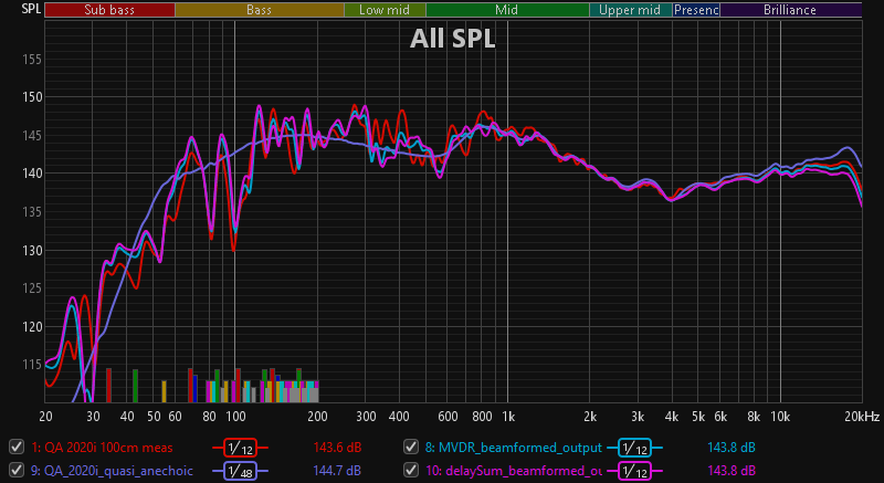

I have so far tried out writing Matlab code for delay-Sum beamforming and MVDR beamforming.
The MVDR beamformer is a data-adaptive beamformer whose performance depends on the training data given to it for estimating the beamformer weight vector.
My initial experiments use the above mentioned 7 measurements and the resulting "Mic array" in an endfire array configuration.
For MVDR beamformer training, I just used the data from the tails of the above impulse responses. This is in no way an optimal method and the results may also reflect that suboptimality.

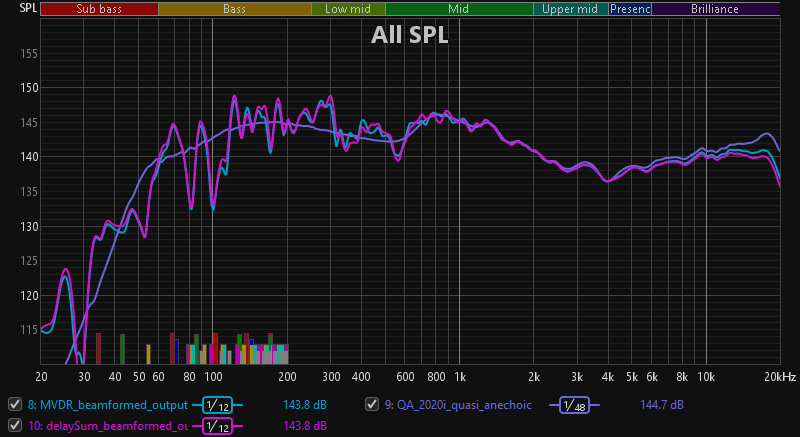

Since I don't have access tp high resolution anechoic data for this speaker, I am comparing against my own quasi-anechoic measurement of the speaker for the time being.
Here is a comparison between the quasi-anechoic measurement, MVDR beamformer output and delay sum beamformer output
Note that the array configuration I have is also not the optimal one and probably once I have about more measurements of the speaker, the averaging might kick-in and smooth out the variations better (Just as a visual aid, I am using that 1/12th smoothing for now on the beamformed data. It will be removed later on).
PS: Ignore the absolute SPL levels which has something to do with impulse response import into REW. We will focus on getting it right later on
Reactions: 1 users
Here is a comparison of the above measurements with a just 1/12 octave smoothed in room measurement of the speaker from 100cm away

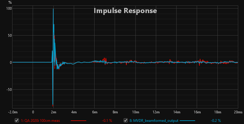

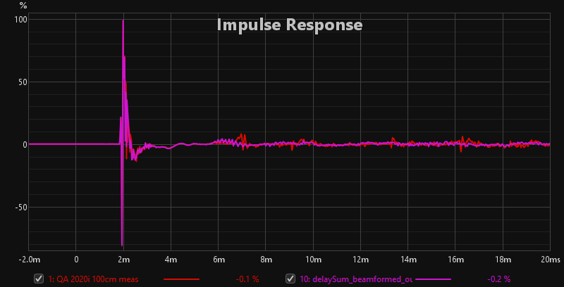

To understand the effect of the beamforming and reflection suppression, here is an impulse response overlay for the original in room measurement from 100cm away and the beamformer output
In room measurment as it is vs Delay-Sum beamformer output
In room measurment as it is vs MVDR beamformer output

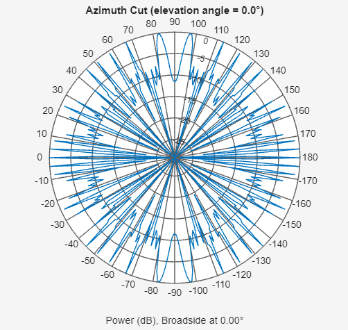

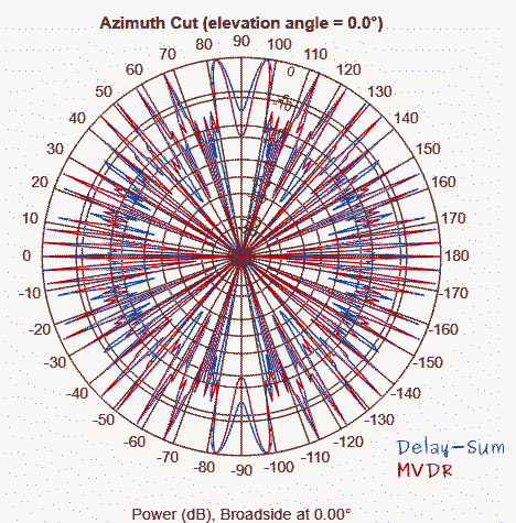

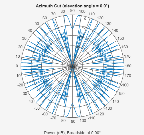

To understand what the beamformers are doing, let us study their polar patterns.
Here is how the Delay-Sum beamformer for this configuration is focussing during signal reception
We have a spike around 0 degrees (on axis with the speaker) and a lot of nulls and spikes as angle increases in the horizontal plane. Ideally we would have liked to have a single spike around 0 degrees and heavy attenuation everywhere else.
Here is how the MVDR beamformer for this configuration is focussing during signal reception
As of now, with this basic experiment, we dont have much difference between the polar patterns of the two beamformers. The nulls are not well focussed towards directions from where reflections are coming from.. It is just randomly spread out as of now.
In coming days, let us try to understand if this can be optimized in horizontal and vertical dimensions by creating different array configurations and using different algorithms.. :)
Reactions: 1 users

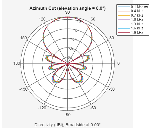

Differential beamforming, used in hearing aid kind of applications with closely spaced array elements (mics) looks like a promising candidate for our purpose until.......... (Let's look at that aspect in the end).
I think, probably, someone has already tried out this beamforming method.
The good part of the algorithm is that the algorithms are already implemented and available in Matlab.
Very nice polar patterns can be designed with few mics:
This link shows more details and how to use it in Matlab
https://in.mathworks.com/help/phased/ug/introduction-to-differential-beamforming.html
With such algorithms, the directivity pattern can remain invariant over relatively wide frequency ranges compared to regular beamforming with fixed spacing of array elements. and with an N-element array, N-1 nulls can be placed at desired angles. Again examples are available in above link.

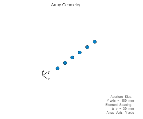

Here is a 6 element array and its polar pattern over a frequency range that we are all interested in
The array elements are spaced 3cm apart (or the same mic moved in 3cm steps each time).
Here I specified the nulls to form at 0 degrees (broadside direction), 30 degrees, -30 degrees and 90 degrees.
Now the bad part.. :D
The SNR (gain over white noise) significantly reduces as the number of elements increases
Here is it for the above configuration. SNR is very bad at low frequencies
But I think even a 2-element array is worth trying out to eliminate single reflections like floor, ceiling etc..
Anyway, I will try this method out when I get some time.. :)
