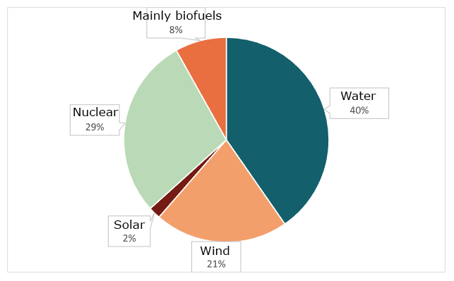

Electricity production Sweden 2023
Coal, natural gases and other non renewable sources are included in the "Mainly biofuels" and are under 1% of the totals.

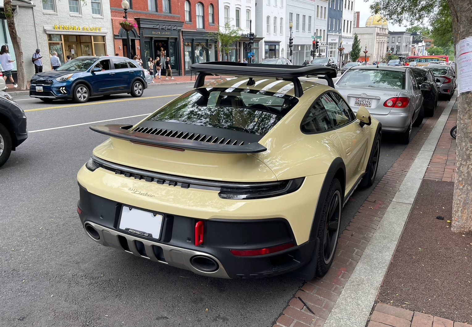

Very cool but also very clean so either new or never used for what it was built for....a bit of chipping, scuffs, small dents, dirt, mud, would be more like it
It is a pretty current model so maybe not fully "broken in".
I really hope such a rare car is not just being used as a status symbol.

Not impressed with the owner, might not even know how to drive worth a crap as many with fast cars are horrid drivers, I got tired of them getting in my way on track days, time trials, etc....why I gave my very quick, highly modded, 40mpg, 400HP Fiesta that much power, same power to weight as a Porsche Turbo when I built it up so they could not drag race me out of the corners they were creeping around and usually not in the right line to go fast anyway, it worked
Still a very cool car, just needs a real driver to own it.

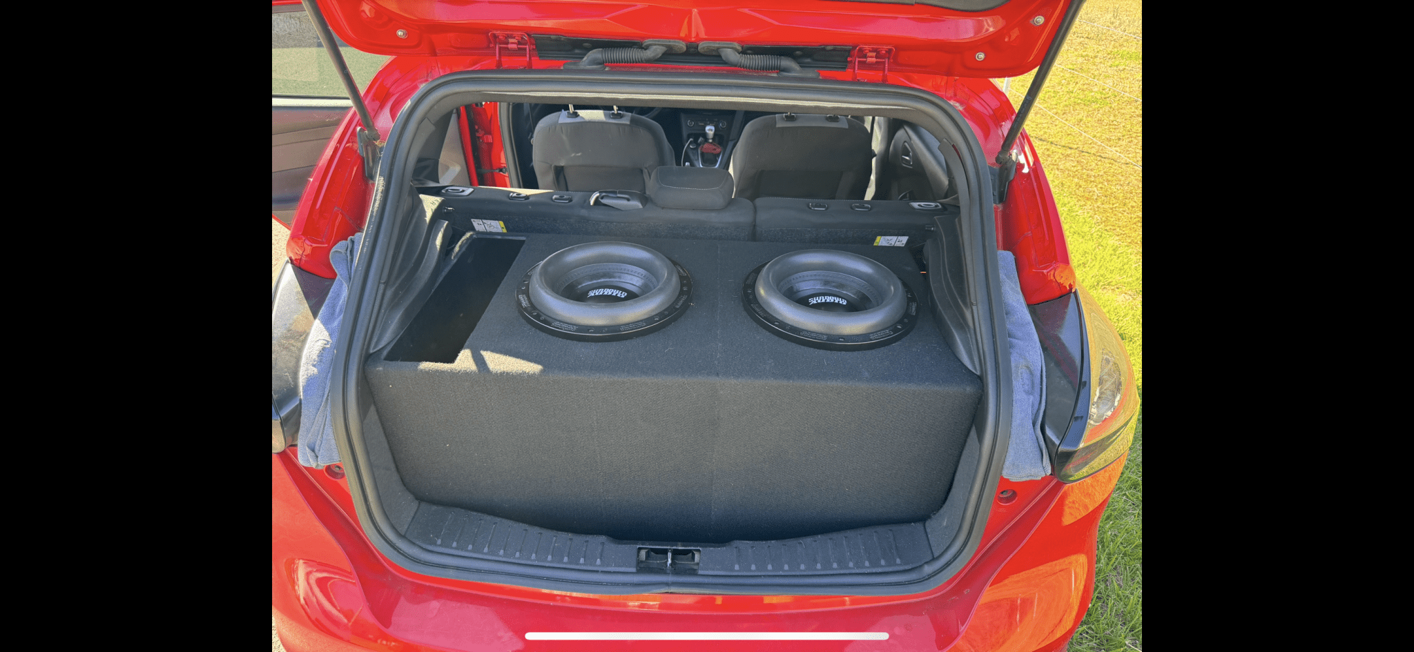

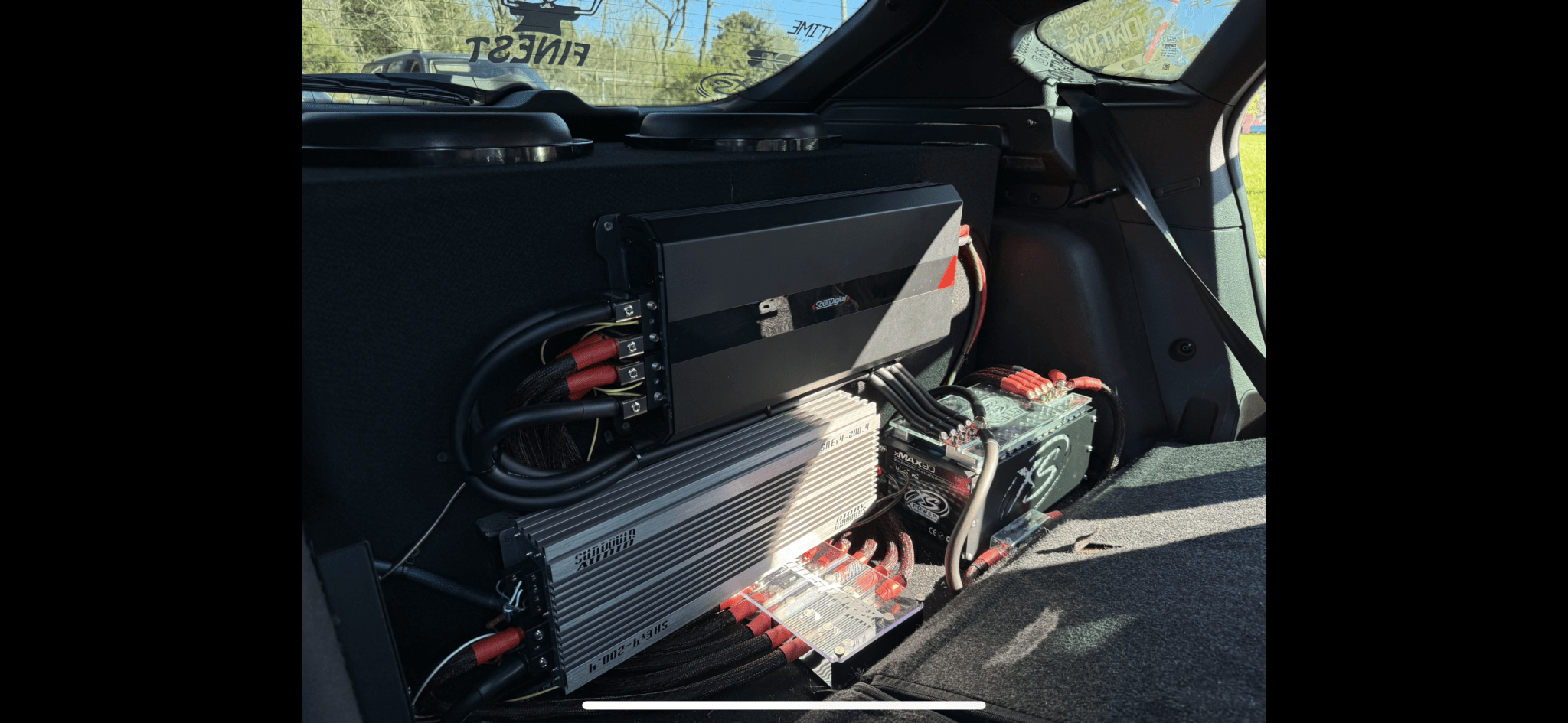

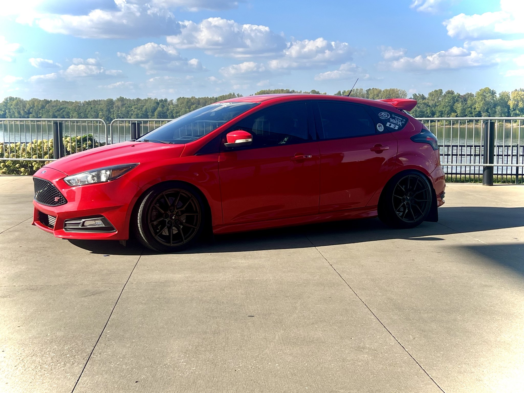

Ah! A car audio car thread.
One of my favorite hobbies is car audio and more specifically competing. I’ve been competing for about 2 years now in DBdrag here in the states. Finishing second at last years regionals.
BUT I don’t compete in SPL formates I compete in what’s called bass race / top dog. To summarize you have 30 seconds to be at a 139.9 db inside the car. You can’t be in it or touch it.
This requires the car/system to be built so it plays extremely flat. I spent about a year designing my box to reach this goal. It’s essentially a very basic slot ported box but with some specific supports added on the inside to hinders it peak out put and flattening out the response. It only does a 148 @ 10k watts, but it’s in useable range there’s only a 3 db difference from end to end.
Here are some pictures

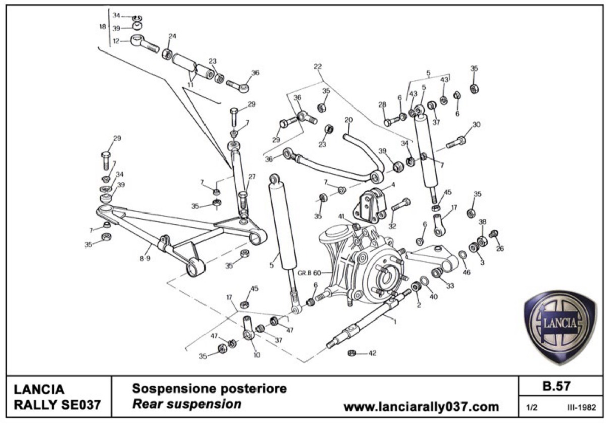

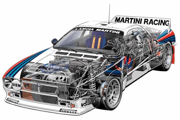

Look at all the technical details you can get on the Lancia Rally 037 here.
http://www.lanciarally037.com/e-home.htm
Full specifications down to timing angle and spark plug gap, Weber carb jets used, drawings, etc. Very cool.
twin-choke carburettor type 40DC NVH 12/250.
Diffuser : 33
Main fuel jet : 33
Min. fuel jet : 50
Air jet : 160.

Cool car audio project!
What always amazed me was how thick the wires for car audio amps were. Like crazy 4 gauge or something like that.

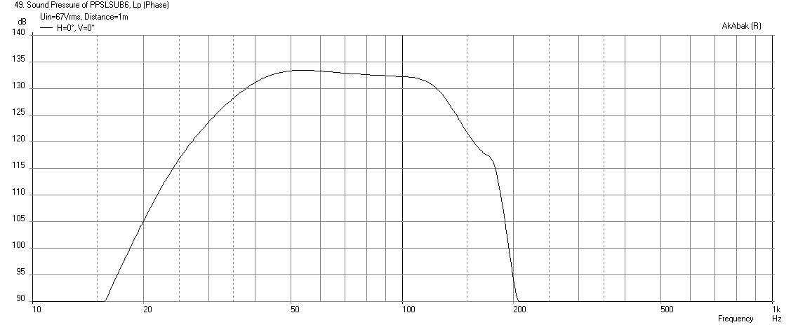

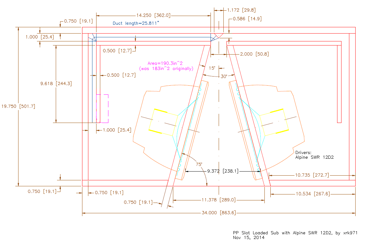

I have some subs you may be interested in. I designed a 6th order slot loaded bandpass using two Alpine 12in drivers. Design goal was something line 133dB recall - this was for someone else who must have been on competitions.
https://www.diyaudio.com/community/threads/pp-slot-loaded-sub-with-alpine-swr-12d2.264737/
105dB at 2.83v sensitivity. Output was a duct that went through the backseat ski flap from trunk. These sims are for open space 4pi, so when inside an enclosed car cabin, the boost is at least 12dB.
It won’t let me quote your previous post XRK, but anyways.
Yeah most power runs from alternators and batteries to amps use 1/0 sometimes 2/0 if your going crazy.
My SD12k has 4 1/0 runs from 90AH of LFP lithium. It’s a tad over kill but Brazilian style class D is pretty dirty and likes tons of clean power.
It clamps around 10k watts @ 12v so around 820 amps under full loads.

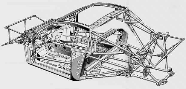

That Lancia chassis reminds me of the last pure track car project I was building, 2,300 lb 95 M3, only two more lower bars and it would not need a body....I went pretty nuts on it, 3-way custom Olins, all tubular suspension, fully built diff, trans, shifter, Tilton pedals, same steering column used in NASCAR, fully forged LS1.....I had to stop 90% finished when we decided to go full time RVing, now way to properly transport and support it even with a stacker trailer and pusher motorhome....then the financial issue happened previously mentioned. One part I really liked it to make it as stealthy as possible, nearly a full upside down wing when looked at under the car, just the center floor plan was left to rebuild. Bottom of trunk we cut out and a huge dual plan fully adjustable diffuser built in its place. I was actually working with a former F1 aerodynamics expert on the project.
